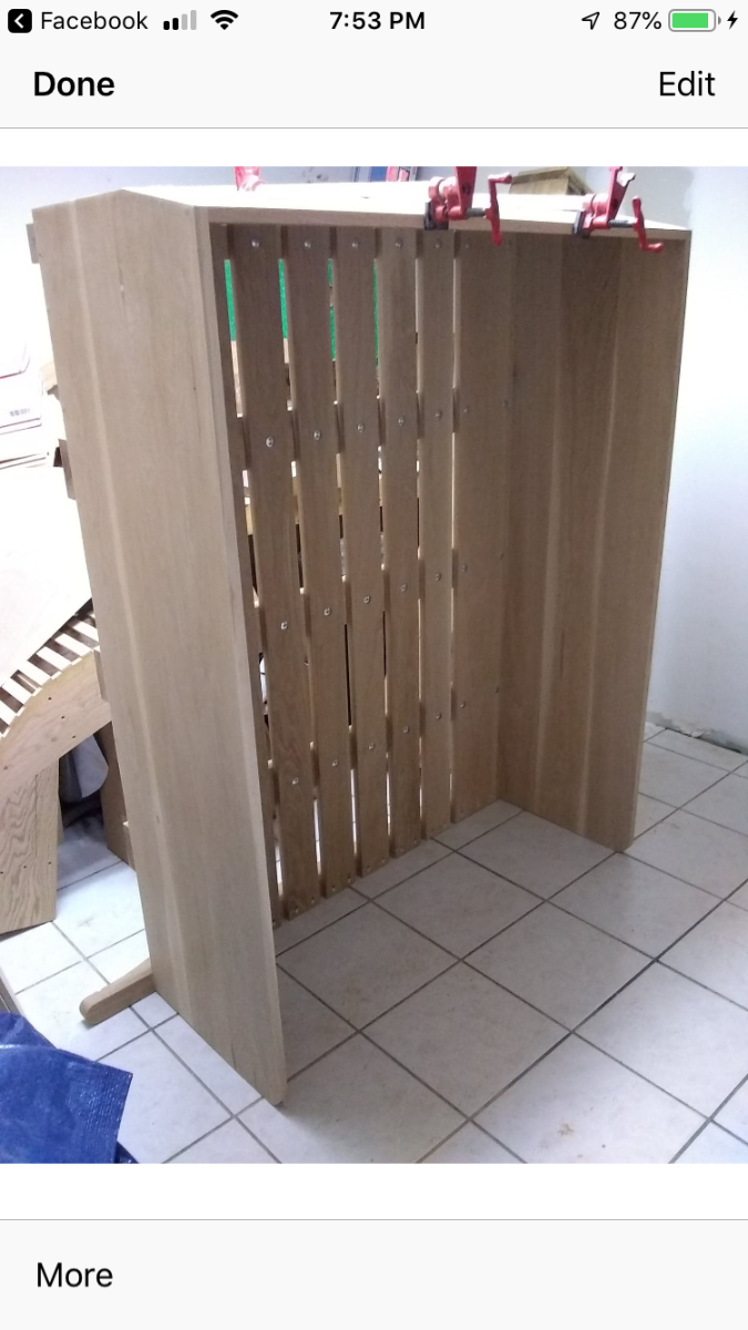

I am building a 15 model T based ALF fire truck and the bed is made of white oak. I was told today that white oak is difficult to get paint to adhere too. Any truth to this? Any one have experience painting white oak?This is a picture of the hose bed on it end. Thanks!

It should take paint fine. Start with a good primer.

My advice would be that if you are starting with fresh/new white oak I would NOT make the surface smooth as glass before painting.
Finish it out at 140-180 grit.
Do you or don’t you want the chance of grain bleed in the finish product?
If you do, any alky primer would be good as an exterior finish. If you don’t then I’d go shellac based (zinsser bin exterior).
The next trick will have eyes roll. Roll it on using Mohair rollers. For the alky one coat maybe two max. For the BIN, follow the between application times to the letter and add coats until slick as glass.
You will want a good enamel for your finish. The trick is to find one formulated to work best with the specific primer below. Also, do be careful of the open time on the primed surface before applying finish coat. There’s a science to that “after so long” and “before so long”. They warn you on the can with the proper times for the product.
The possible problem with White Oak is sheeting due to lack of bite of the base. Read the above, it bites. Some say that grain bleed leads to thermal splits in the final coat which eventually fail. That is not my own personal experience, good bite is good bite!
I’m a believer in BIN’s...be quick, it dries fast!

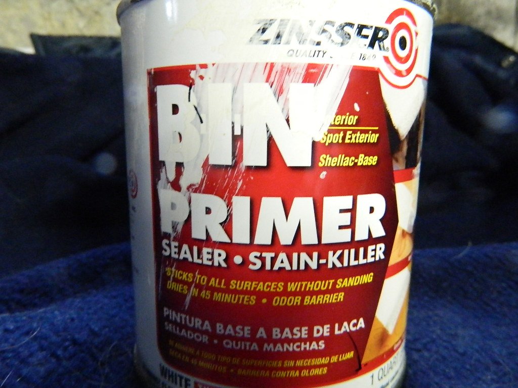

BIN....???
Am I the only dummy that needs to read whole words? I HATE acronyms!
TFan
- Posts: 415
- First Name: Jim
- Last Name: Riedy
- Location: Sandusky,Ohio
Re: White oak bed
I believe this is what they speak of. Jim
