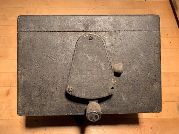

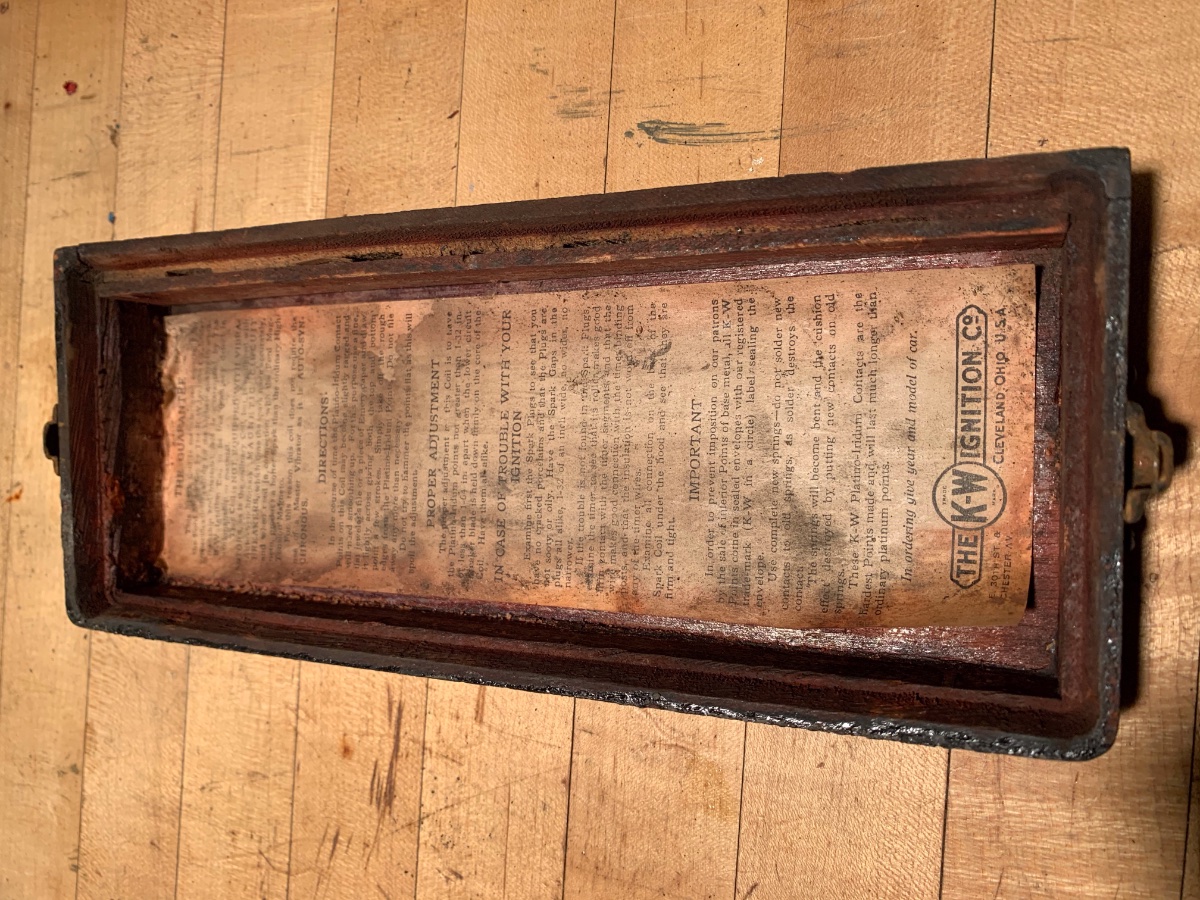

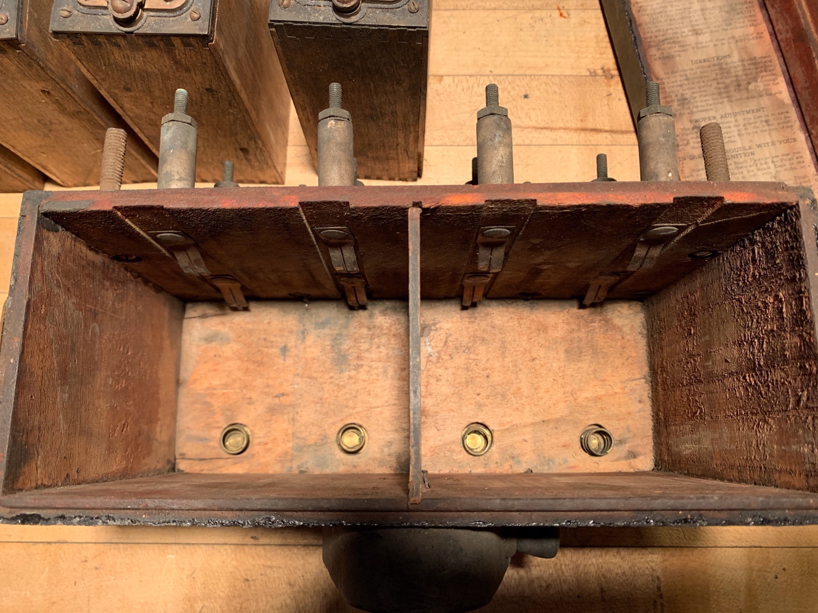

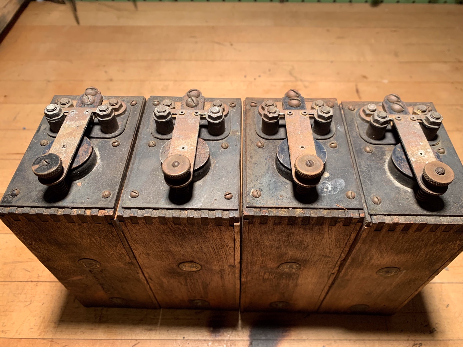

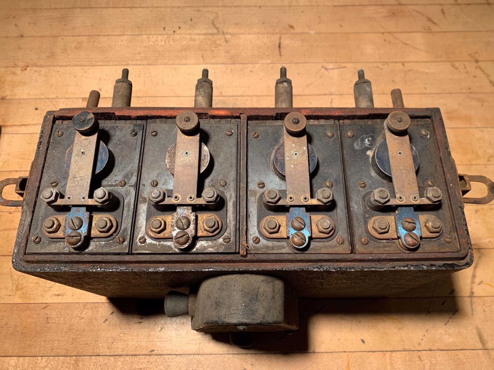

I recently acquired what appears to be an original undisturbed 1913 KW coil box with coils. It appears to have been sleeping for a very long time, maybe 100 years. The coils are 6 screw with flat "blued" brass tops. The box has original finish and KW instructions in the lid. It was interesting to see brass springs for the bottom contacts inside the box. Pictures are attached.

John T, Nice! Thank you for sharing such nice pictures of those coils and box!
Are the points on those coils basically the same size, fit, and dimensions as the common later points? I can see that they are very early versions of the points. But I have heard (not sure about it though) that some earlier style points for earlier coils look similar, but don't quite fit. Most styles of coils before the mid '13 changeover used totally different points, although on some, the common later points can be altered to fit and work. Yours do not look altered.
Nice find!
Nice find!

The bridges on those coils date from before early 1916, so there's a very strong likelihood they have never been changed. They will interchange with the later ones, though their construction is a bit different in that they use separate rivets to attach the contact spring rather than the metal of the bridge itself as in the later ones. Further, they have a different KW logo with no "PAT. 1914" in it.

Nice to see your photos of your original unrestored 1913 KW coil box. I've had a couple like yours. They are very good units. I have them on both of my 1913's, a runabout and a touring. Always a good idea to have a couple of spares under the seat too, just in case.

Wow John! Those are fantastic!
Interesting how the K/W coils also used the same apparent spring
arrangement on the bottom just as my Heinz coils have for
my '13. So after seeing that, if I see a '13 with K/W coils that
use the brass strip on the bottom, even though the outside
of the box looks "correct", I'm wondering if technically that it
isn't, or maybe somewhere along '13 they switched to the brass
strip on the bottom? Be fun to find out when it happened.

Heinze, Kingston, and J-B all used the same springs. They differed only in the method of attachment to the wood panel. That's why I had a run of 1000 made; they sold out, and I am now about 1/3 of the way through the second run.

CORRECTION: I meant to type "K-W", NOT J-B. J-Bs were totally different. I apologize.

I appreciate the comments from folks knowledgeable about coils. I'm planning to use the coils in my 1913 touring. I currently have 4 screw brass tops in it with an original coil box. I will likely replace the capacitors and replace the points with new ones in order to save the old points.
