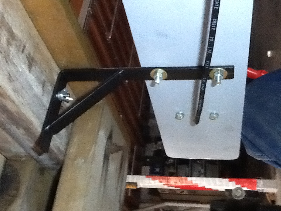

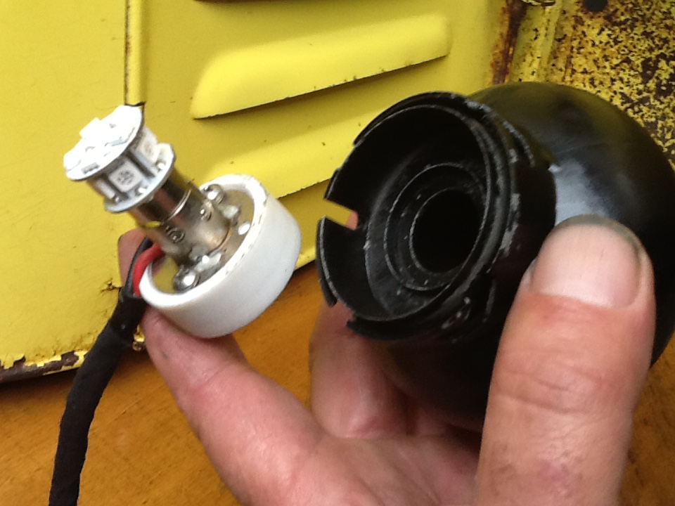

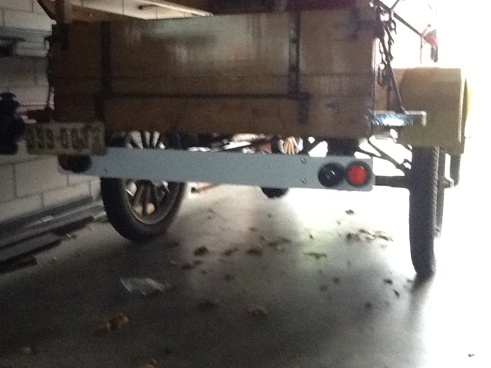

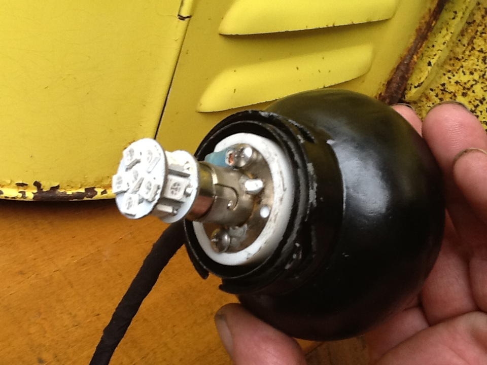

My solution was to convert my side lamps to blinkers in a way that allows me to return them to petroleum in two seconds, and to affix a white board with brake and turn signals under the rearend with two wingnuts and a trailer connector plug so it can be taken off so all looks original for show purposes.
Safety First, i've never been rearended and hope to keep it that way !
