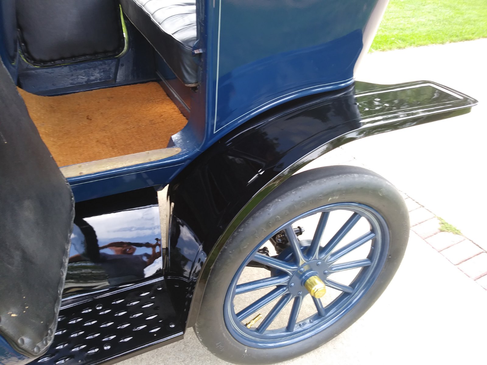

John...I'm not awake. Here's one of all the fenders I painted on my former 1912, and the splash shield. I used one of those
little Preval Glass bottle sprayer outfits. Used Concept black paint, cut it with the appropriate thinner and a dash of this
stuff to help give it the "wet look". Turned out pretty good. The paint of course was the most expensive part.

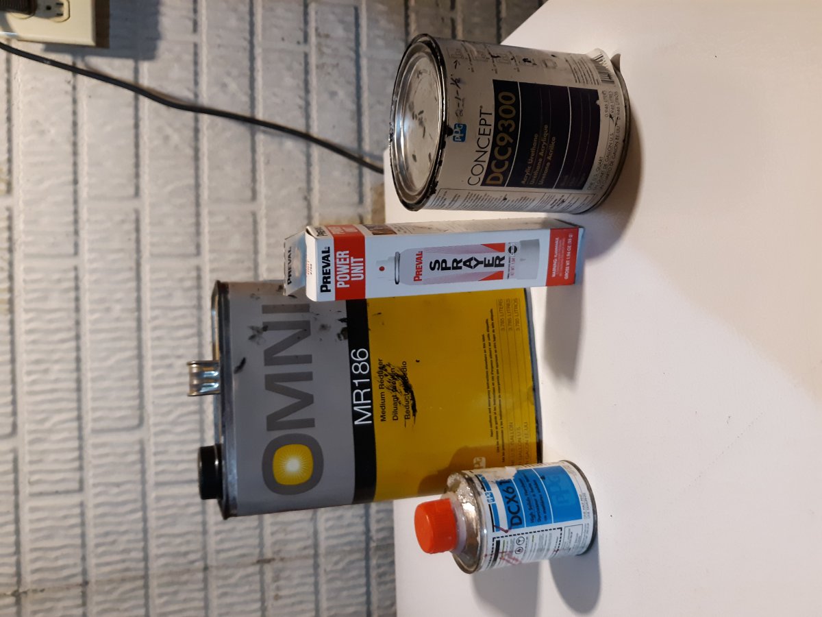

John...I apologize for the delay. Heres a pic of my "paint system" that I use for relatively small jobs. Or pieces parts like a fender at a time! The small can is the "dash" of hardener/wet lol stuff that I use. It's not cheap but a necessary part of the formula. The Preval sprayer pictured is just the replacement air can, the first kit you would get will also have the reusable glass bottle. They also make the air cans in a small and a large size. I can paint an entire fender with one bottle of pain mix, and get 2 fenders with one big air can.
Thinning the paint with these little critters is key. But once you do get it down, you can produce a very good result.

Re: RATTLE CAN ACRYLIC LACQUER
Hit the wrong button! Heres the picture!!
Aaaand upon preview, I see its sideways again! Click the pic and it will upright itself.

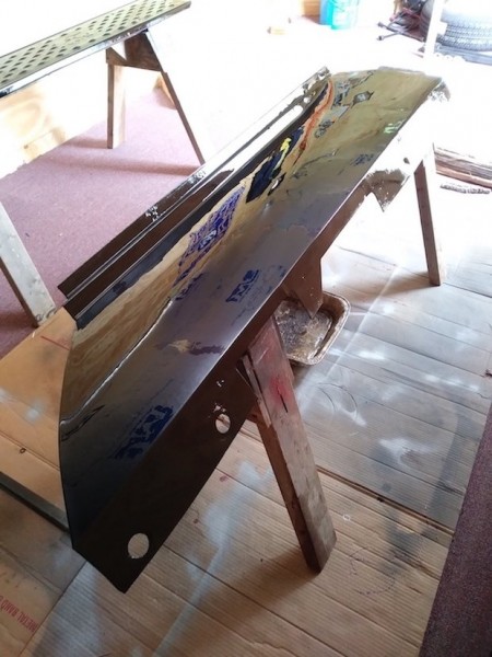

I have had great result using Rustoleum gloss black appliance epoxy. The fender shown was painted by me in 2010 and still looks great. Jim Patrick.

- Posts: 3743
- Last Name: Wrenn
Jim, that is a fantastic job. That post was two years before I got into the hobby. Had I seen it, I might very well have tried it.
I know I would! Next time, I definitely will! I'm relatively lazy at my young 65, and would just as soon do it from a single can!
