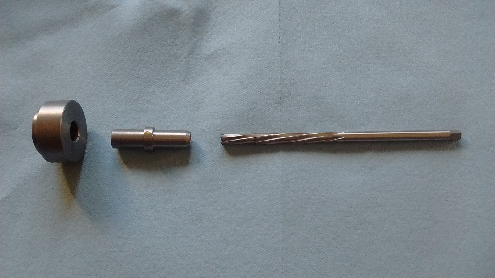

Be aware that the reamer requires a guide that fits in the valve head hole. Otherwise, the reamer can get tilted during the operation. Any machinist should be able to make one for you from mild steel, so that it's a "light" fit in the portion of the hole that is straight. After installing the guide, you simply run the reamer through the hole in its center, insuring a straight path. Go easy, never backwards and blow chips out as the reamer goes down.

This is what George is talking about. Just did a quick refresh on a pretty good engine that came with a blown up Mag. Engine ran very well with no oil burning except for a "puff" of smoke when it was first started. Decided to renew worn guides while I was at it. This is my setup...Use of the piloted reamer by hand requires diligent attention to keep it cutting with each revolution. This will cut a true-sized hole. If you just fart around and talk to your pal while lightly spinning this reamer, you will end up with results that you will not be happy with.

These sorts of reamers come specifically for either bronze or similar material, or for Cast Iron. You want Cast Iron. To make a true hole .002 larger than your stem, this is what you want...call them, give them the true diameter of your valve and application, and I am sure that this is what they will suggest: https://www.cylinderheadsupply.com/kl1136.html.

I am set up pretty well for "valve jobs" in that I cut modern 3-angle valve seats with a very nice Neway carbide valve seat cutter outfit, and I very accurately reface valves with a very old fashioned (but very accurate) manually operated valve refacing fixture that also has a carbide cutter. In fact, I firmly believe that I can do as accurate a valve job as any auto parts store back-room machine shop, it's just that I probably take much longer to do a valve job. But that's okay, being long-since retired,....I've got time, right? I can say that I've done several valve jobs with this equipment and they've all turned out very well.
However, I've never reamed or knurled valve guides and I'd like to add to my "valve job" equipment (and skills) with whatever it takes to accurately deal with valve guides that are somewhat worn, but not to the degree that they need replacing. So, I'm very interested in George and Scotts posts above in this thread that addresses accurate reaming of valve guides. Accordingly, I have a question for either George or Scott, or whoever else might chime in on this:
George Andreasen mentioned that the valve guide reamer needs "a guide that fits in the valve hole", or, I guess I'd say "port".
Conjecture here for sure, as I mentioned that I have no experience reaming valve guides. However, I would think that having the reamer "guide" index off of the existing valve seat rather than the "hole" or the port itself, for a couple reasons:
First, the valve guides, altho' worn, originally did (and still do) remain concentric with (or, in line with) the existing valve seat. And second, the "hole" or port, is just a cast opening,...with just rough cast surfaces rather than a machined surface.
Again, never done this, but I really think there is a good chance that guiding the reamer with the guide positioned in a way that is not necessarily concentric with the existing valve seat might necessitate having to totally re-cut a new valve seat, which could conceivably entail removing a lot more material from the engine block,....really not a good thing in my opinion.
So,....does this make sense, or am I "overthinking" the issue,...??? I seem to be able to "touch-up" existing valve seats quite successfully with the 3-angle, narrow valve seat method, with the Neway expandable pilot WITHOUT a guide to stabilize the top end of the pilot, but I agree with George & Scott that it sure seems that reaming guides should not merely be done "freehand" but that the top end of the reamer should be "guided" and stabilized for accuracy,.....harold
