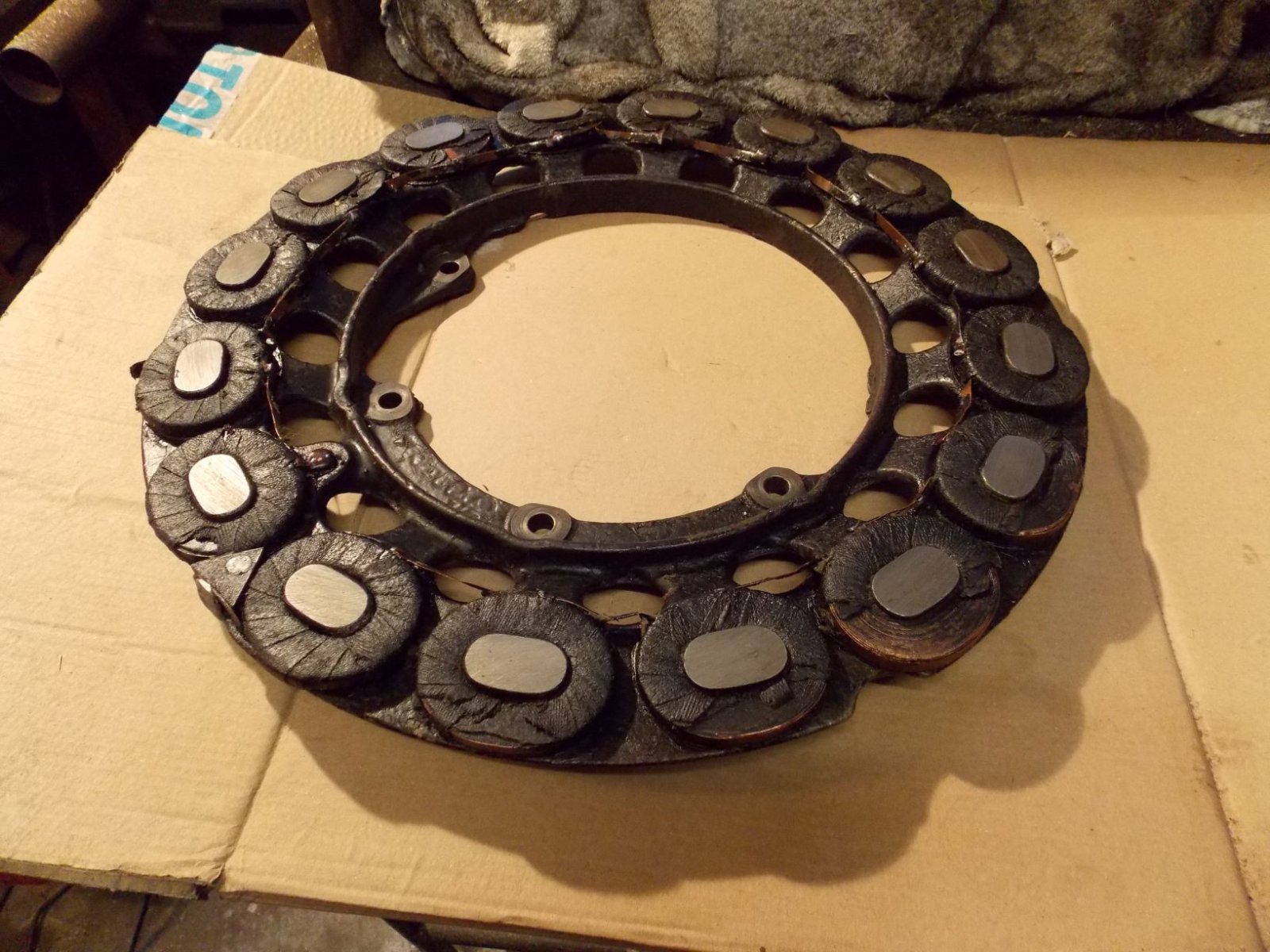

What are folks using to coat magneto coil ring wrappings these days? Predictably, some knucklehead in the past tried to remove the starter from my friend's 1924 Coupe engine and tore through the windings' coatings in that area. Plus, the remaining coils could use some freshening up with a sealant. They appear to be an original whitish-gray color = never restored or recoated. Now's the time to do it with engine all over the garage floor.
I see some coil windings in on-line photos are coated in red and some that are yellow, some even green. Glyptal seems to be the traditional favored coating, but at $42.00 per spray can plus shipping or tax locally, that's pretty steep for one-time job. I'm not necessarily looking for a cheap way out. I just don't want to pay for a Bentley when all I need is a Rambler. Or do I need to just bite bullet and buy Glyptal? I only want to do this ONCE and do it RIGHT!
Recommendations, please? As always, thanks in advance.

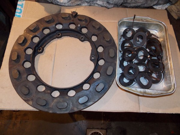

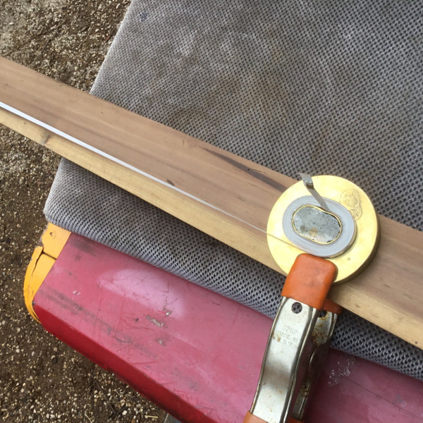

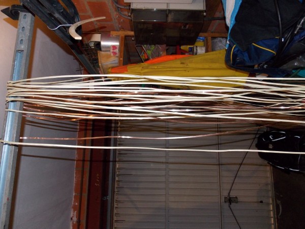

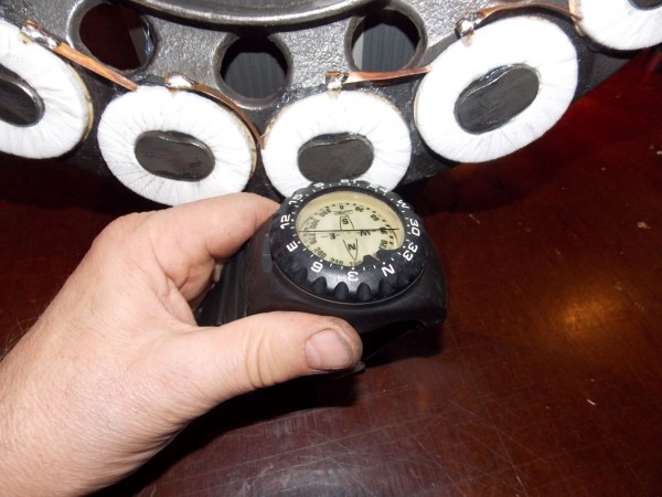

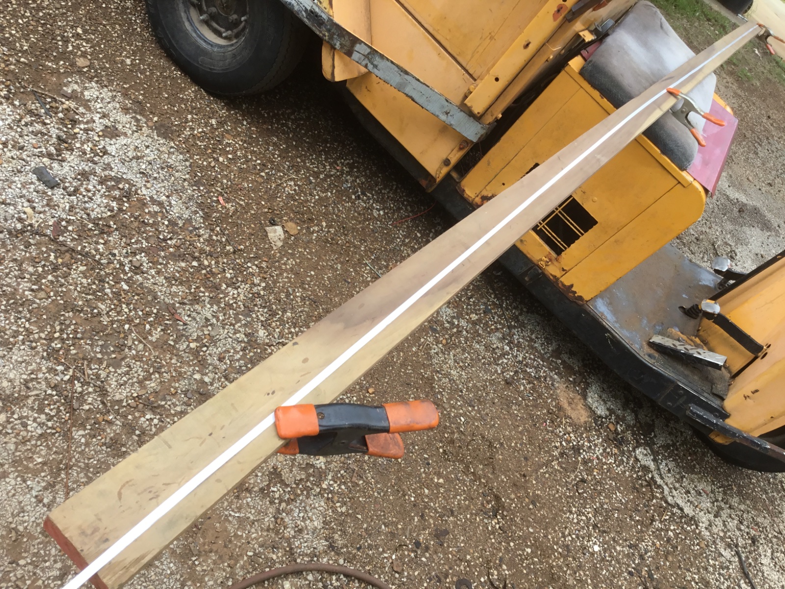

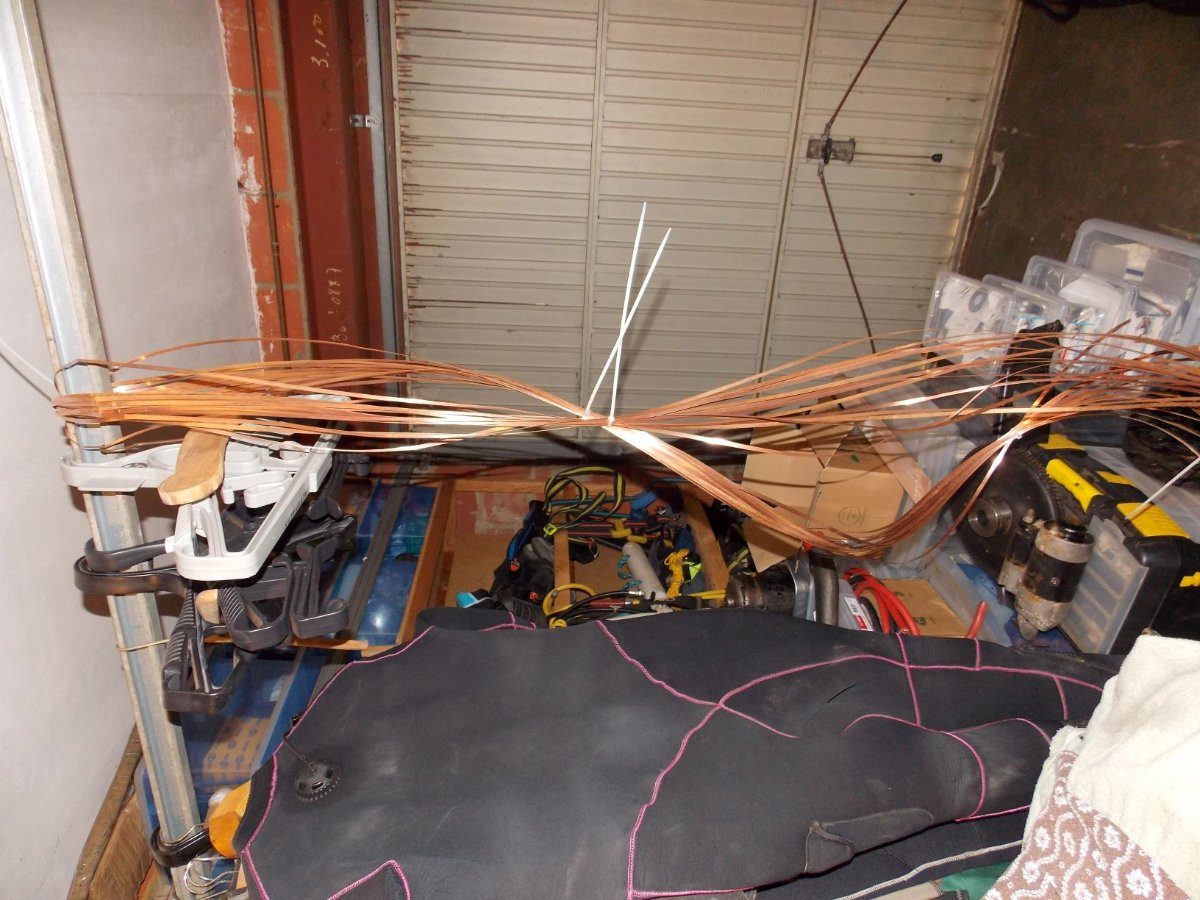

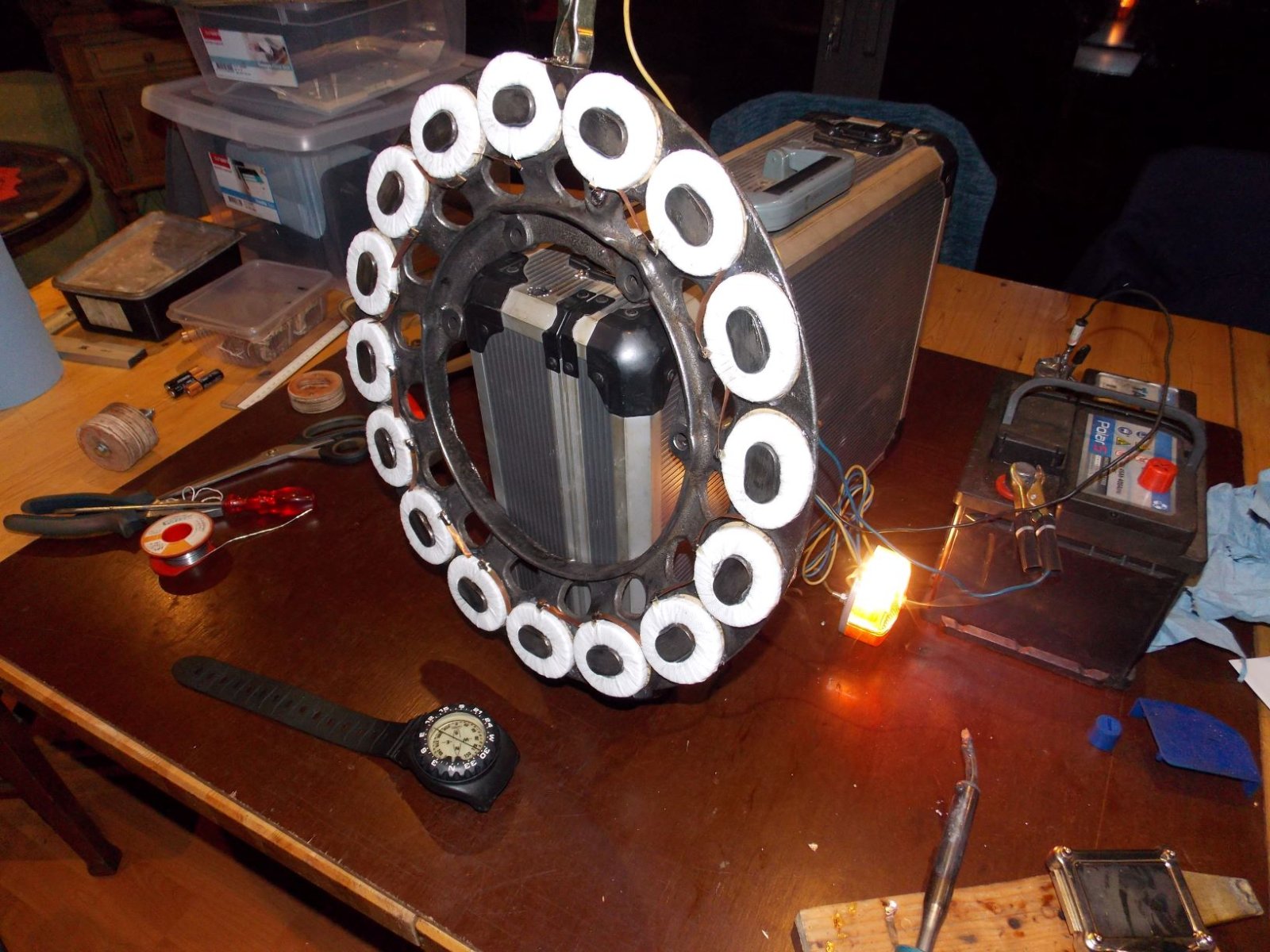

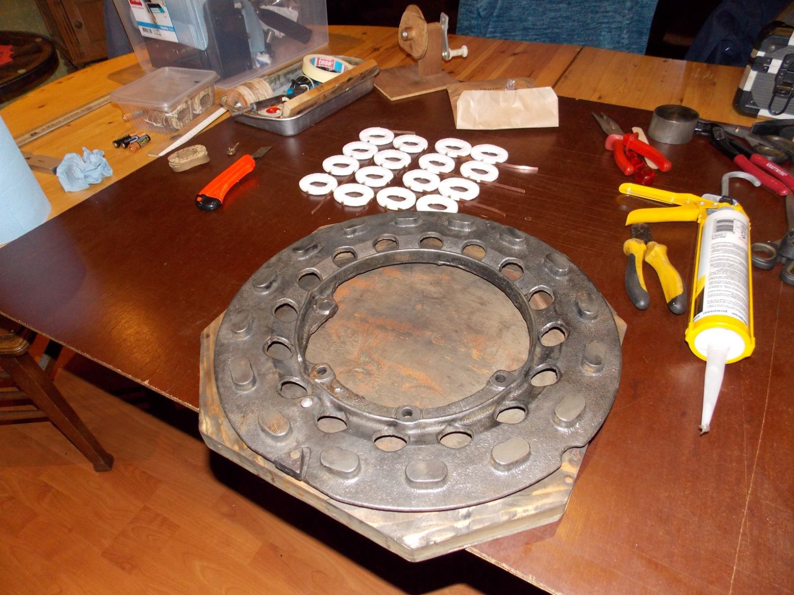

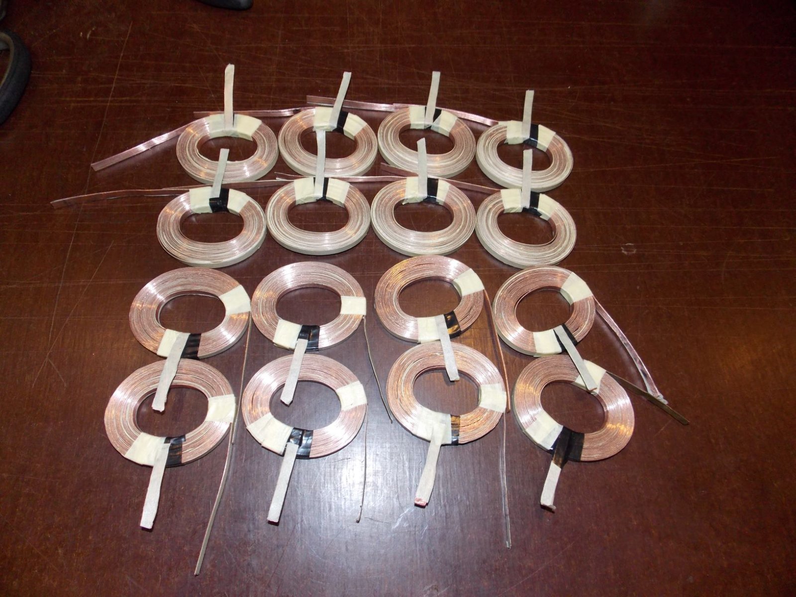

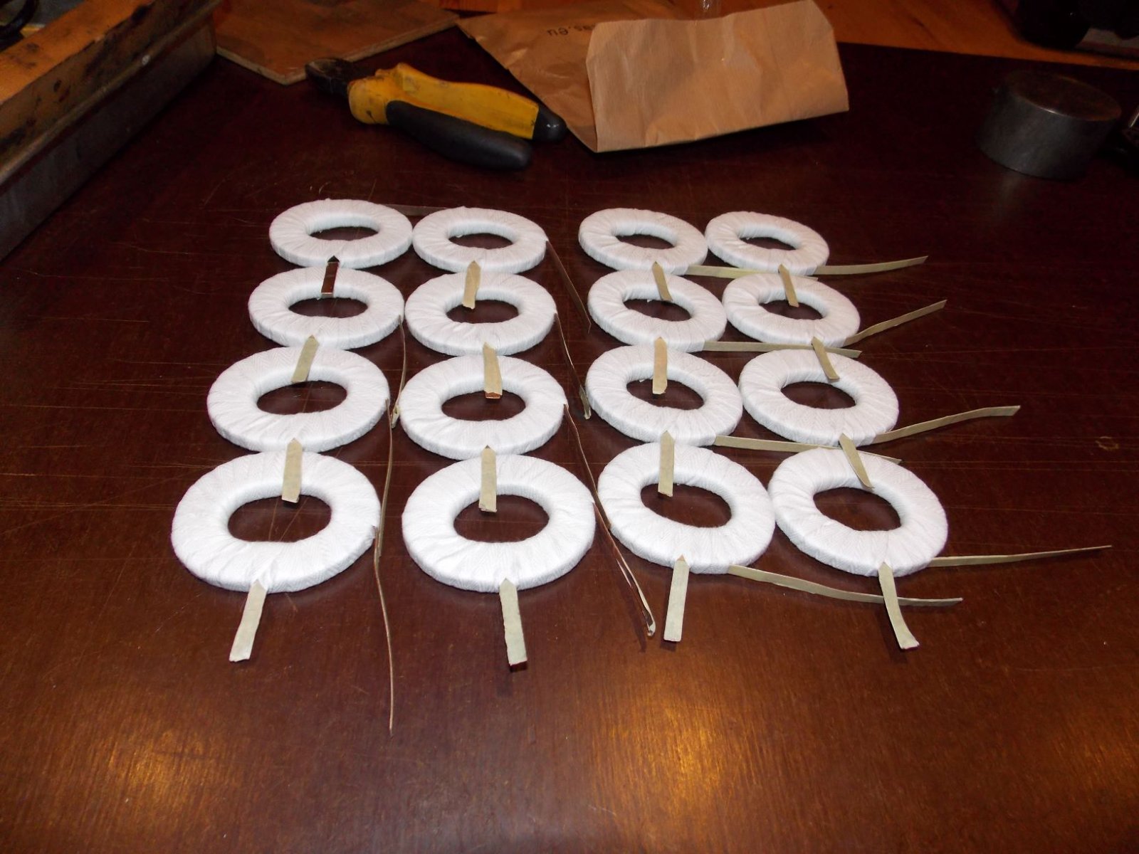

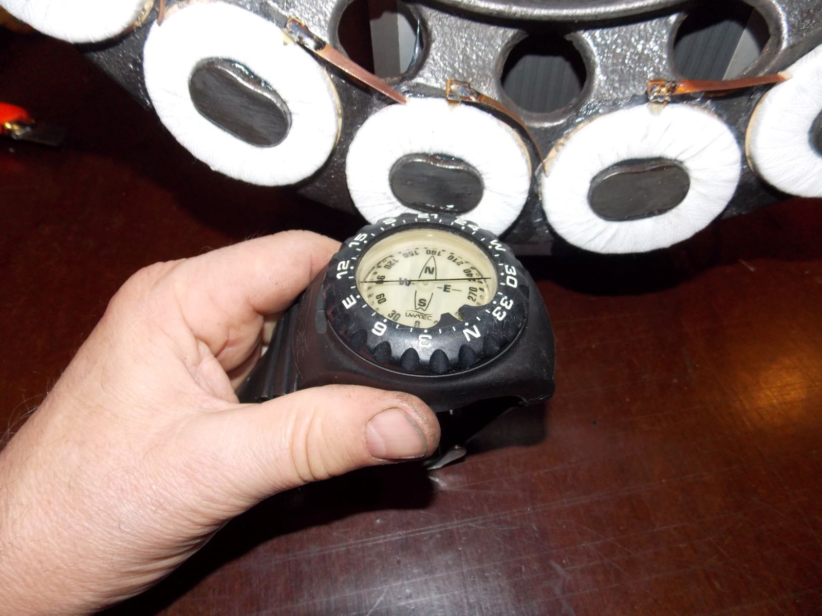

Hello Marshall,
experience learned me that trying to repair a coilring is a waste of time and money.
If yours have some insulation gone or coils that seems to be out of working you only have the chioce between replace it or rebuild it.
Replacing is easy you can find it at about every model T part shop.
Rebuilding it your self can be done. You just need to take your time for it and first read the Electric System Manual Edited by the MTFCA.
That's what I have done some 10 years ago. Since than I rebuild about 15 coilrings every year. It takes me about a weekend to clear the job.
To insulate the cleaned string I use a kind of masking tape that stand the oil.
As you take the coils apart you will find two insulation shields at each side of the coil. Under each sometimes you can find a third shield.
These shield need to be replaced. 48 are needed. Gasket paper works very well for this.
After winding the coils you need to warp it, I use 10mm (3/8") wide cotton tape, about 125cm is needed for each coil.
After assembly of the coilring I give it two coats of polyster resin, after you can paint it any colour you want.
Before all everything need to be cleaned and degreased very well.
I will try to post 12 photo's showing the way I do it. We can post only 5 photos at each post, it will take three post to post the all.
Good luck
Andre
Belgium

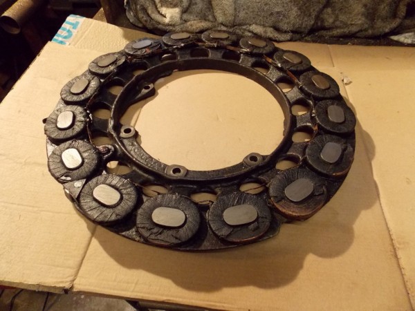

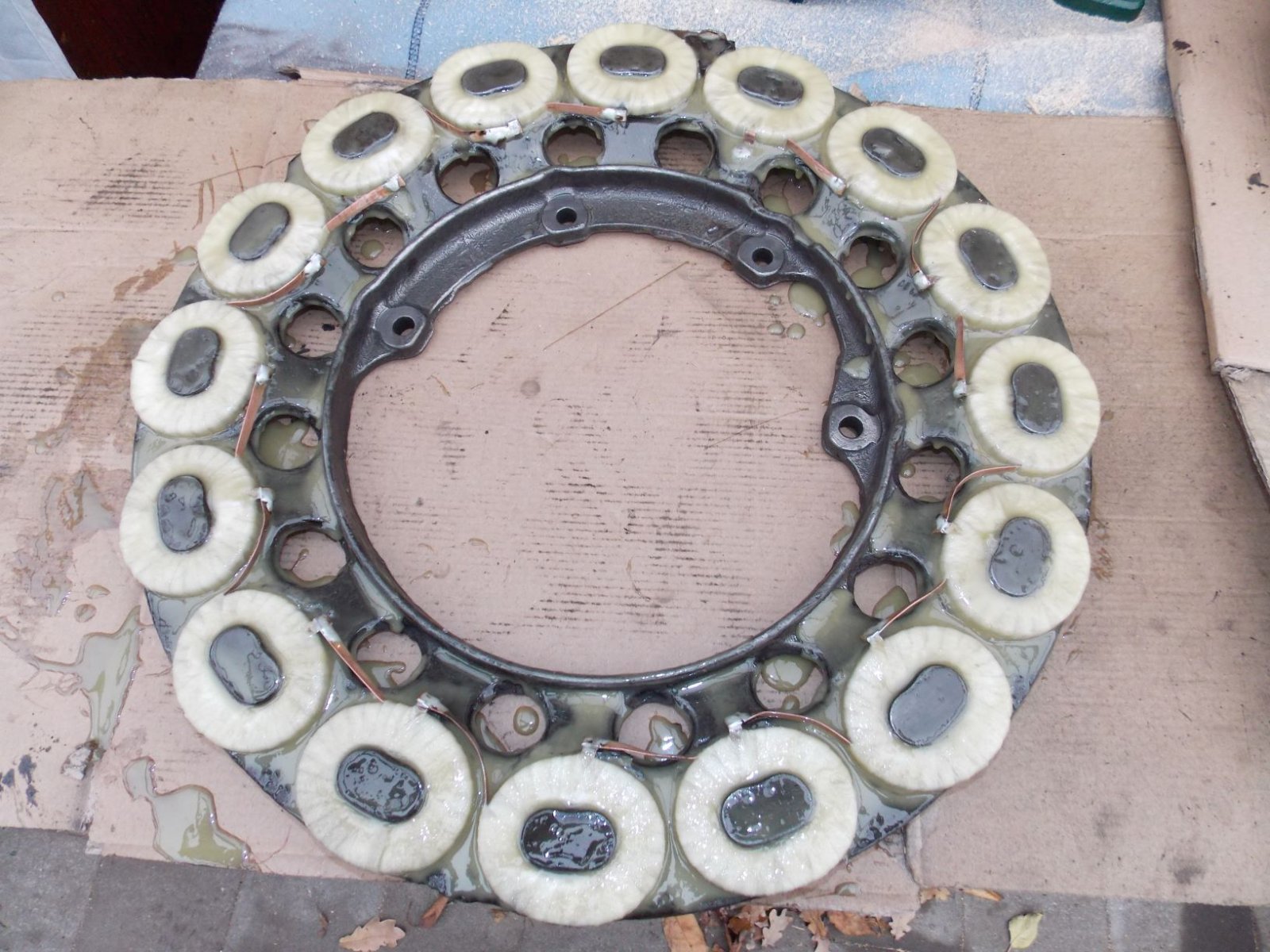

Re: Coil ring sealant
second serie photos.

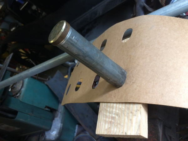

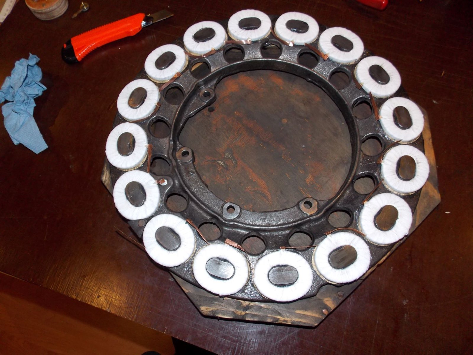

last.

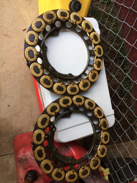

KW: McMaster Carr Part number 7574A11 Silicone Adhesive Fiberglass heat rated to 500F. 0.007" thick. This is 1/2" wide and I split to 1/4", at the time I could not find 1/4" wide. The coil ribbon is 3/16 for my ring. I used the same 1/2 " wide fiberglass tape to wrap the finished coils. 10$ per mag ring is dirt cheap, the tape retailed for $11.00 per roll of 18yards. Look at Andre's previous posts he has a lot of pics and is very meticulous, class act on his rebuild.
McM-Carr also has the fishpaper you make the washers from that go behind the coils, I used 0.020" thick. Cut the washers in a teardrop shape so you have a little 'tab' behind the coil between the solder joint and the iron core.
I glued each coil and fishpaper washer to the ring with Glyptal 1202 clear electrical varnish and after final assembly I saturated everything with clear Glyptal 1202 electrical varnish and baked at 200F for an hour in the kitchen oven. The temp and time is recommended by the manufacturer of this product.
Best, jb
