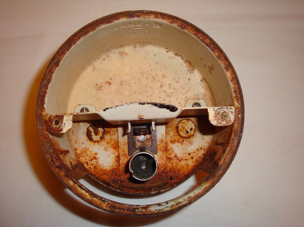

Note that the reflector was missing but the interior was painted white.
White paint can be a temporary fix until you locate a reflector, Dodge or Hupp light for parts or a complete Ford script light.

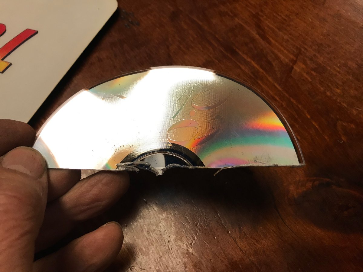

It might be possible to make a temporary one from a CD-ROM. I only spent a few minutes to see if it was possible. Cut the CD with a hot knife then laid it across a dish, use a heat gun to melt it down for a curve.
The CD had some printing on the back and that is what the reflection is showing through
