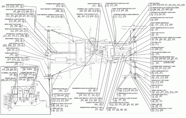

Post by Mark Gregush » Thu Apr 02, 2020 11:20 pm
How about a picture to go with that list! :D
http://www.mtfca.com/discus/messages/11 ... 1290642906

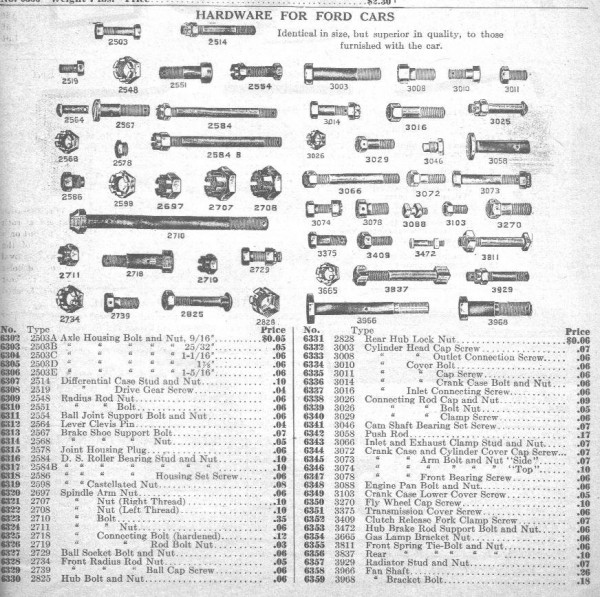

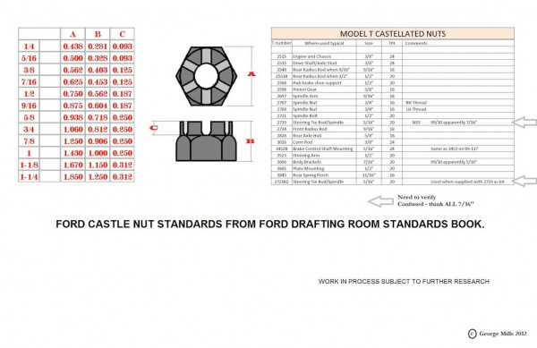

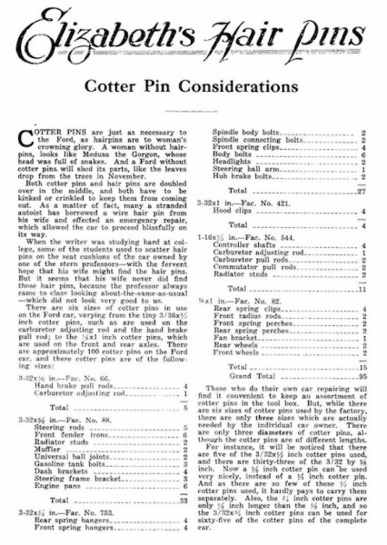

Post by TRDxB2 » Fri Apr 03, 2020 12:24 am
Here is some more info from previous MTFCA posts. If someone can convert the PDF to a spreadsheet or has the data in a spreadsheet I think I can create a cross reference: that is, given a nut or bolt size list all the places its used.

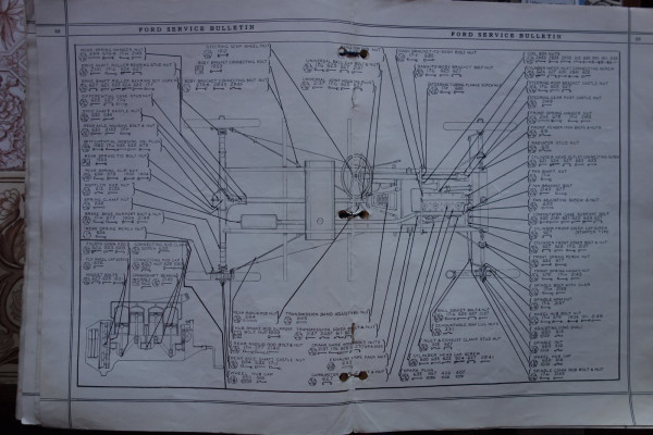

Post by Luxford » Sat Apr 04, 2020 3:20 am
The above chart is actually a Ford Canada chart from their service bulletins. Dated February 1925 Page 68 & 69
it was reprinted in a Vintage Ford magazine in the 1980's ( not sure which one) The Colorado version would have come from that chart or the Ford USA Bulletins if it was printed in their version.
Here is a photo of the original I just took from my set of Ford Canada bulletins.

Post by dmdeaton » Sat Apr 04, 2020 4:12 pm
The cotter pin pdf is hard to read. Anyone check me on this?
3/32 x 1/2
3/32 x 5/8
3/32 x 3/4
3/32 x1
1/16 x 1/2
1/8 x1
What sizes for the main and rod bolts?
thanks guys
I will put these in a spreadsheet unless it is already listed somewhere

Post by DanTreace » Sat Apr 04, 2020 6:11 pm
You have the cotter pins correct/

Post by jab35 » Sun Apr 05, 2020 12:23 am
Part number 2584B is 13/32-16, confirmed by Dan Hatch and others recently.

Post by A Whiteman » Mon Apr 06, 2020 5:48 pm
HELP
Does anyone have the Ford Canada Service Bulletin Feb 1925?
If so, can you SCAN the spanner chart (posted above) in high quality = each page in say A4 format? OR A3 format if your combo printer/scanner has a larger table.
A higher quality scan would help me a lot combining this diagram with the new draft chart I am working on. My version is too grainy when enlarged for numbers to be legible.

Post by Luxford » Thu Apr 16, 2020 12:50 am
The Canadian Spanner chart by Ford Canada was reprinted in the Vintage Ford magazine January/ february 1984 Vol 19 No 1
It is the centrefold.
