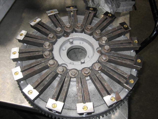

I determined that my original cast aluminum magnet spools were damaged by my last effort at leveling (that means I was over zealous with my hammer after the last engine rebuild). I am now setting up my magnets on my flywheel and am trying an alternate method.
I do not have a KW magnet setting tool. Erik kindly offered the loan of his tool. That would require about a 60 mile round trip and a second trip to return it. I am going to revert to my original method with a new twist.

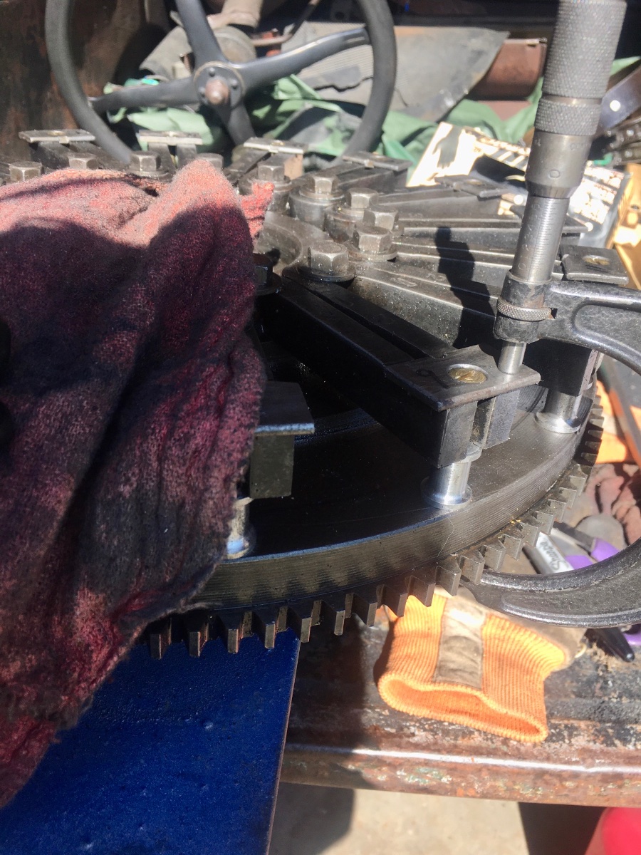

I installed all new spools and screws. Next I measure the height of the keepers and enter them on a state of the art spread sheet.
What I do after listing the magnet heights is to determine the limits of variance in height I find acceptable. Having polled a few knowledgeable T mechanics I chose 0.010”. That translates to +/-.005”.
So after checking the spread sheet I identified the target height at .005” below the tallest magnet. The first step is to add shims to all magnets which fall more than .010” less than the highest one.
I obtained some fine imported Bavarian shim stock measuring .004”-.005”. Using a notebook hole punch and a larger gasket punch shims were produced.
I had planned on sanding down some of the higher magnet’s spools but that might leave the ends out of parallel. It soon became apparent that the required precision could be obtained with one to two shims.
The result was arrived at by repeating this process adding and removing shims and re-measuring about three times before planned accuracy was obtained.
The next step will be to verify the job by putting the flywheel back onto the crankshaft and turning it to measure each magnet against the same field coil pad using brass feeler gauges.
This method is easy and non-invasive, no magnets or spools were harmed in the performance of this task!

Do you have a spare starter ring gear?
I found that if you lay this on top of the magnet plates you can check that the ring gear is parallel to the flywheel face with a vernier depth gauge and you can identify the high and low spots very easily.

It is now about 2 weeks past when I started this magnet job. I have discovered that my method of setting the magnets works but that the limits I chose to stick to based on suggestions caused great grief to me. A really good mechanic suggested that .010" on the magnets is about the limit. I translated that to +/- .005", that is what I used measuring off the back of the flywheel. Next setting the magneto in one crankshaft position allowed that error to be duplicated, spin the crankshaft and you double the error (now .020"). I installed the engine and without the fourth main in that was bad enough to get a magnet plate ticking against the field coil casting when hand cranked.
Next I pulled it all down and re-visited the magnet heights. I chose to do this by identifying the highest magnets with feelers between magnet and field coil. I removed shims if the magnet had them and if less than a shim was needed (beer can aluminum is .004"-.005" ... no I didn't consume the beverage) I had dressed the spool on a bastard file until I got to the target spool size.
The next thing I did was to reset the magneto to the more level magnets. I used the method mentioned in the current Vintage Ford. This works really well. You remove magneto shims and mount the mag with the bolts loose... at least .050" loose. Then you bolt the flywheel on (I have marked my crankshaft flange and flywheel so I always mate the the same holes). By pushing the magneto ring up against the magnets you can use a feeler gauge to measure the gap at each of the four mounting points. To be clear you are measuring the space between the mounting surface on the block and the back side of the magneto ring. You decide on the gap you want to end up with and subtract that from your measurement to get the shim size needed there. This sounds hard but it is way easier and more accurate than the trial and error (lots of error!) method I used before.
Another thing I discovered is that common mag gap setting I have gotten from mechanics and from reading the literature available is .025" so you won't end up crashing magnets against magneto. This allows for flexing of the crankshaft (yikes!!!) due to gravity fourth main tolerance, and any off center of driven plate shaft when running in horizontal position. All this comes down to trying to get the truest running flywheel for the strongest mag, not hitting and not flexing the crankshaft. I discovered that Ford specified the necessary gap in the shop manual as 1/32". That is .03125" which is .00625 more than what is now recommended! So not only have I been compounding my errors I was choosing to set the magnets closer than Ford recommended.
So now after assembling and disassembling, installing and pulling the engine several times I have arrived at an acceptable result. I hope to be driving it this evening.
The whole procedure was needed as last time (6 months ago) I got to a .001" magnet setting goal by whacking magnets and ruing the spools. Now by carefully setting up the magnets with a micrometer, shims and filing spools, the job can be done fairly easily.
My take away is use the KW magnet setting tool). If you don't have the tool then you can set the magnets by micrometer but you must hold to a maximum tolerance of +/-.0025" on magnet heights. Remember you have error on magnet height which doubles whilst setting the mag which will have some error when mag is shimmed to the block. If you feel +/- .010" is close enough for magnet to mag gap tolerance (on a .03125" gap) you are not going to get there by allowing +-.010" on the magnets. That would use up all of your wiggle room on your first step.
I am preparing to do the engine on my 1912 Omnibus. I will shoot for +/-.0005" on it's magnets. My method can get you there without too much effort once the procedure is learned.
