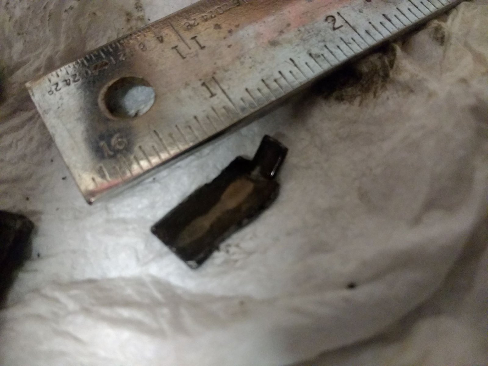

New to the forum but have been reading it since acquiring a 26 runabout last summer (2019). First thing I did when I got it home was drain the oil. A brass screw head came out with the oil. Not knowing anything yet, I assumed it was just a piece left over from previous repairs. Went about getting it up and running and drove it around a bit. One day had it idling in the shop and I heard a couple clunking sounds coming from the engine/transmission area. Immediately shut it down and started researching the forum. Have not ran it since. So I am thinking that the screw head is from a magnet retainer after doing a bunch of reading here. I had tested the magneto before the clunking episode and it is not working. So I guess my question for the board is; what is my best plan of action? I am not concerned about being able to use the mag. I am fine running on batt for what I plan to do. I know I have to pull at least the hogshead, but could I remove all the magnets at that point?

Thanks. I guess my question is; assuming a keeper plate and maybe a magnet has fallen off, can I make this thing safe to drive on batt by removing the loose parts? Do I need to remove the rest of the plates and magnets for balance issues? Can I do all of that with just hogshead removed?

Thanks Jim for your thoughtful response. No intention of running it as is, I've read enough posts to know better. I'm learning as I go. I have the manual and have no problem pulling the power plant. Just wanted to see what my options were.

I have the motor out and the trans off. 3 magnet keeper plates came off and were being thrown about. Not seeing any damage other than to the plates themselves. So, I plan to get a new coil ring. What is the best plan of action for the magnets? I don't see any cracks on initial inspection. They have very little magnetism at the moment. I found a mystery item stuck to one of the magnets. Can anyone identify it? See picture.

If you are wondering what that last piece is, it is the same thing as was found here: viewtopic.php?f=2&t=12078&p=90974&hilit=blue#p90974
You have plenty of trouble on your hands, and will probably be replacing the magneto coil ring (cheap right now) and doing a flywheel teardown and rebuild as well as replacing 1 or more parts inside your brake drum.
