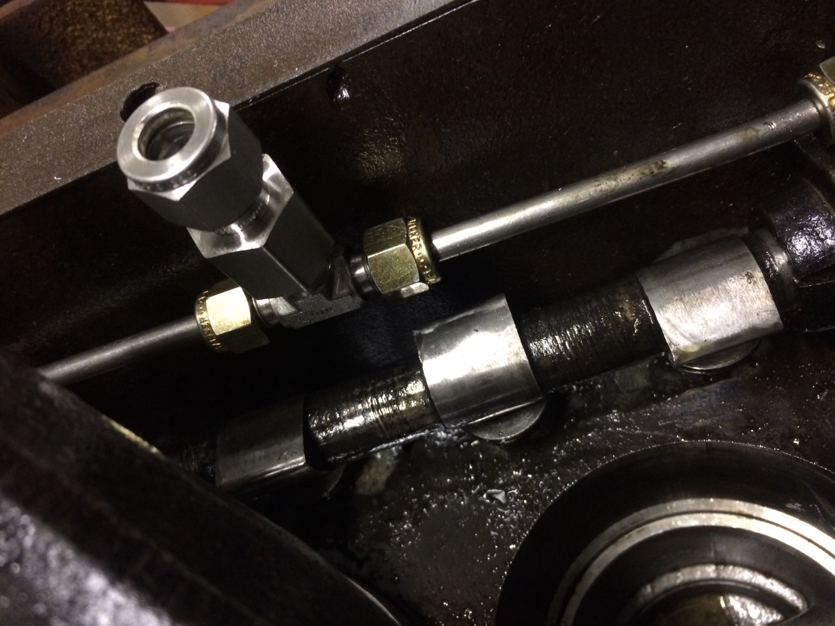

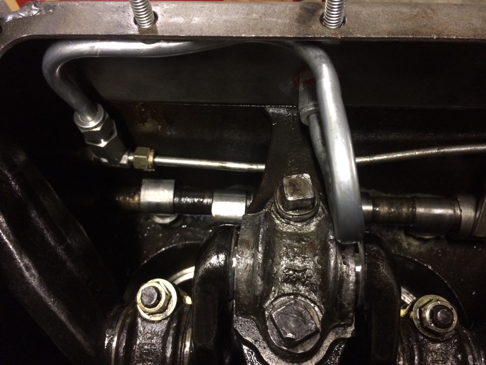

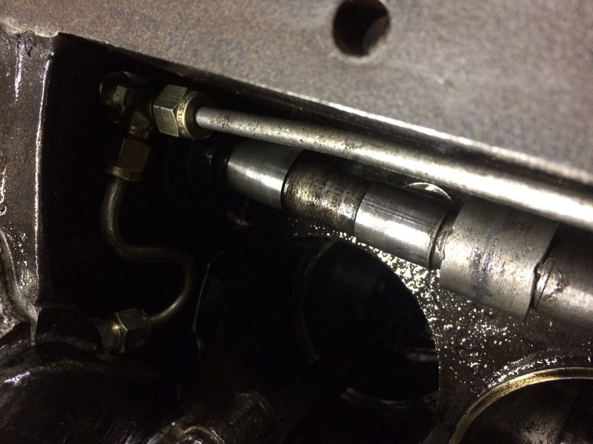

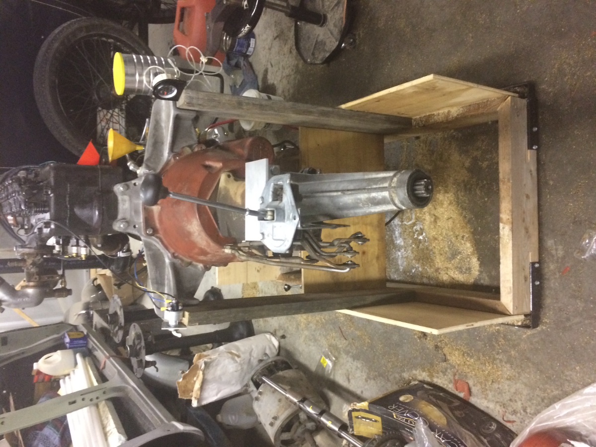

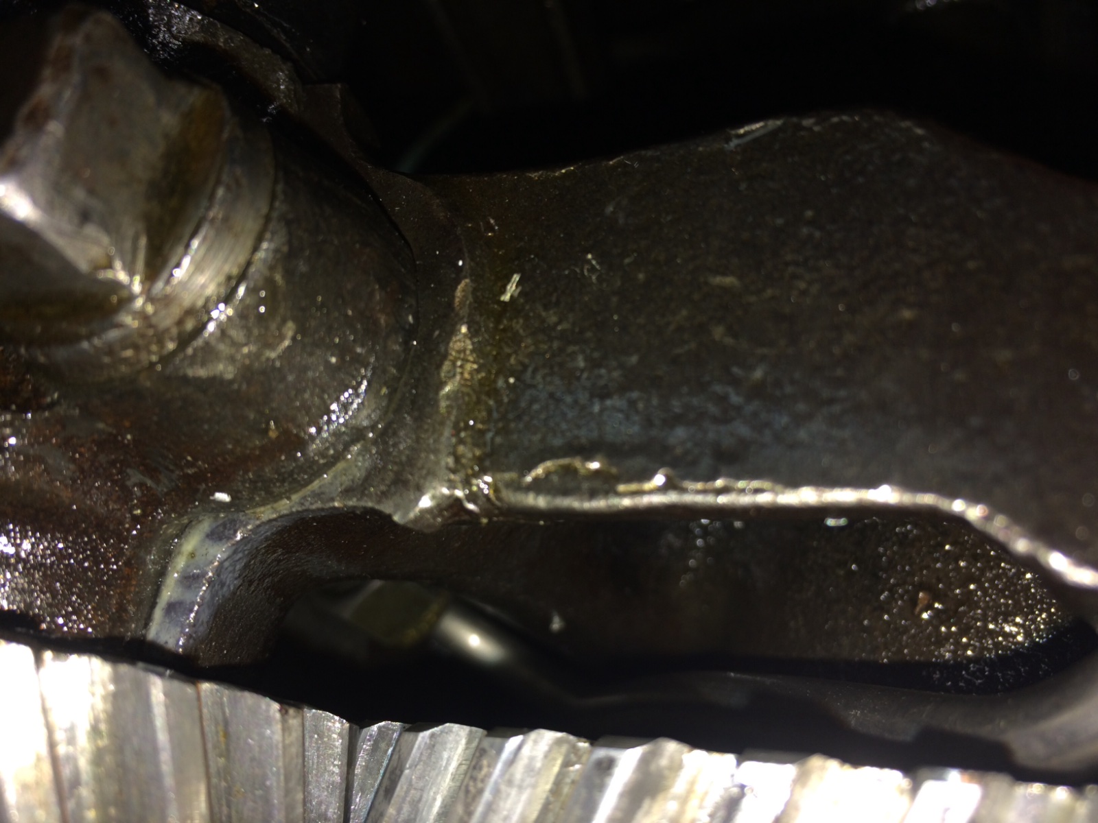

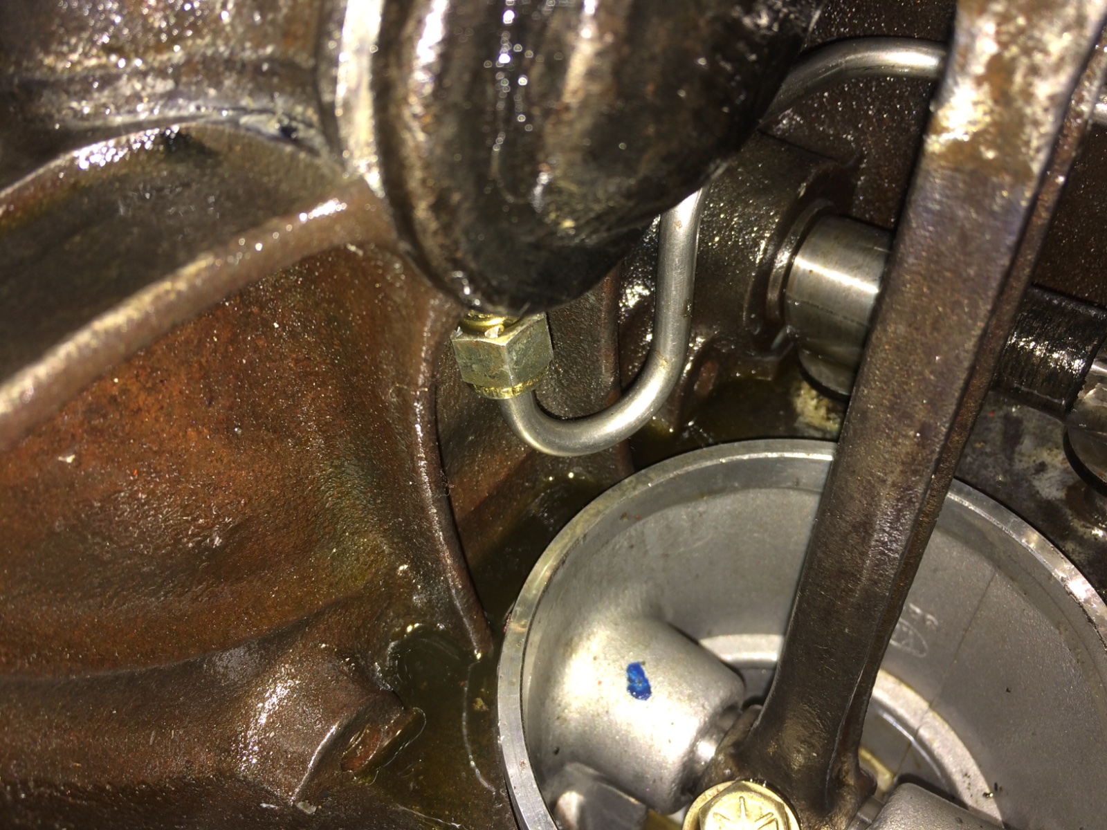

Post by Les Schubert » Sun Apr 05, 2020 2:35 pm
Connecting to outside
Front  main bearing (not really easy to see
Rear  main bearing
Rear main bearing
Line connection
Line connection
Centre main bearing
Centre main bearing

Those are the good fittings!!
SurfCityGene
Posts: 681
First Name: Gene
Last Name: Carrothers
Re: My approach to pressure oil lines
Post by SurfCityGene » Sun Apr 05, 2020 3:48 pm
Those are the BEST Fittings and a Nice job forming the lines!!
1912 Torpedo Roadster
Posts: 6712
Post by Scott_Conger » Sun Apr 05, 2020 4:11 pm
Yes, they are the best fittings. Now, how many have seen the proprietary wrench(s) and gap gauge available for them and when should it be used and when should it NOT be used? Just a little trivia from someone who spent much of their career using them...
Les
nice work and no small task working with tha SS tubing...

What kind of fittings are they?
Les Schubert
Posts: 1364
First Name: Les
Last Name: Schubert
Location: Calgary
Post by Les Schubert » Sun Apr 05, 2020 4:33 pm
Swagelok. Not cheap but ultimately easy to use. Actually the tubing is just galvanized steel. The fittings are SS. Fortunately available off the shelf locally. Over the years we used a LOT of them at the shop I had.

Les.
I don't like being picky but I hate seeing things that can give a heap of grief down the track, your rods are around the wrong way and no oil holes in the pistons for the wrist pins. :(
Les Schubert
Posts: 1364
First Name: Les
Last Name: Schubert
Location: Calgary
Post by Les Schubert » Sun Apr 05, 2020 6:38 pm

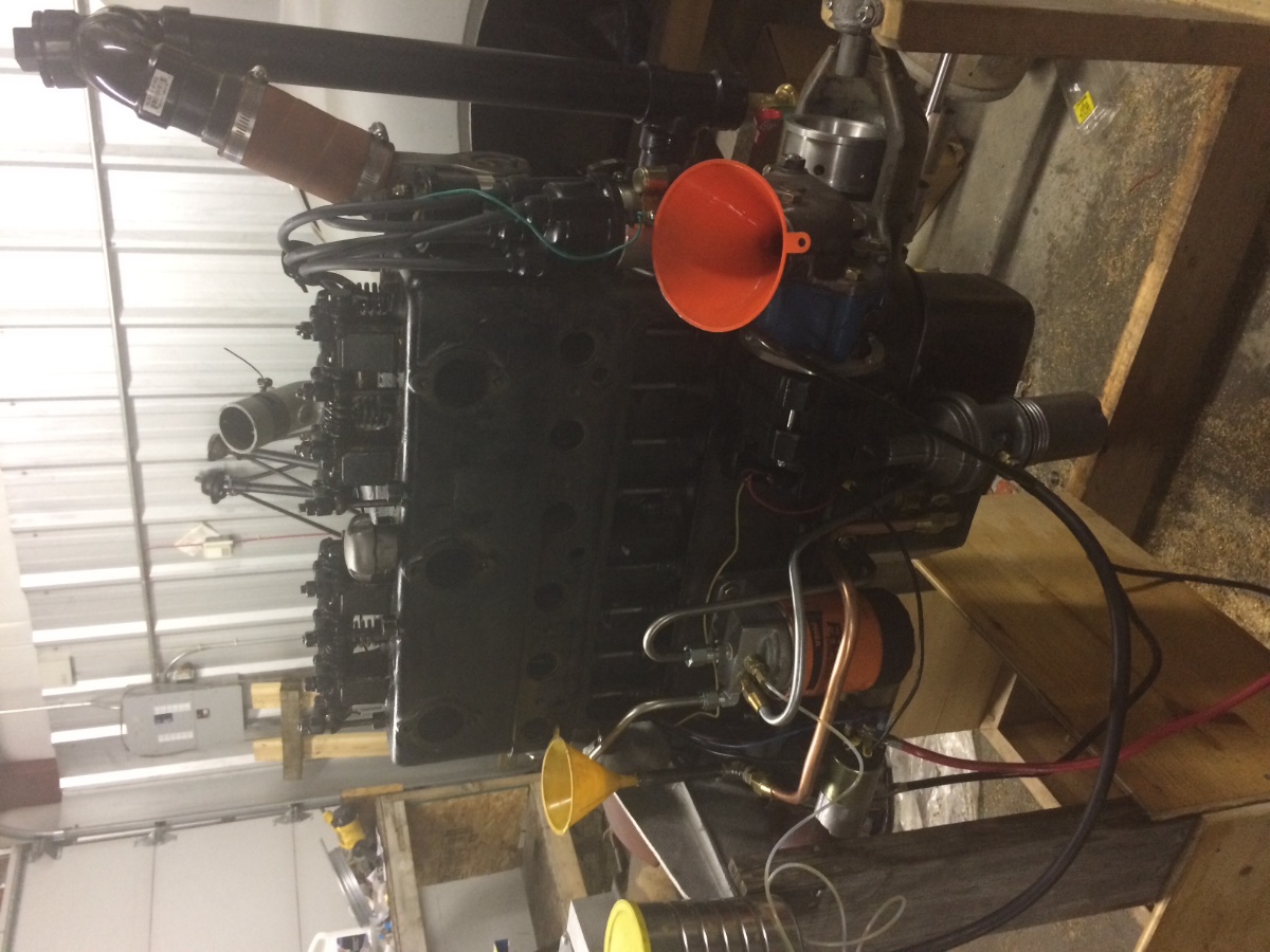

Just about ready to light it up!!

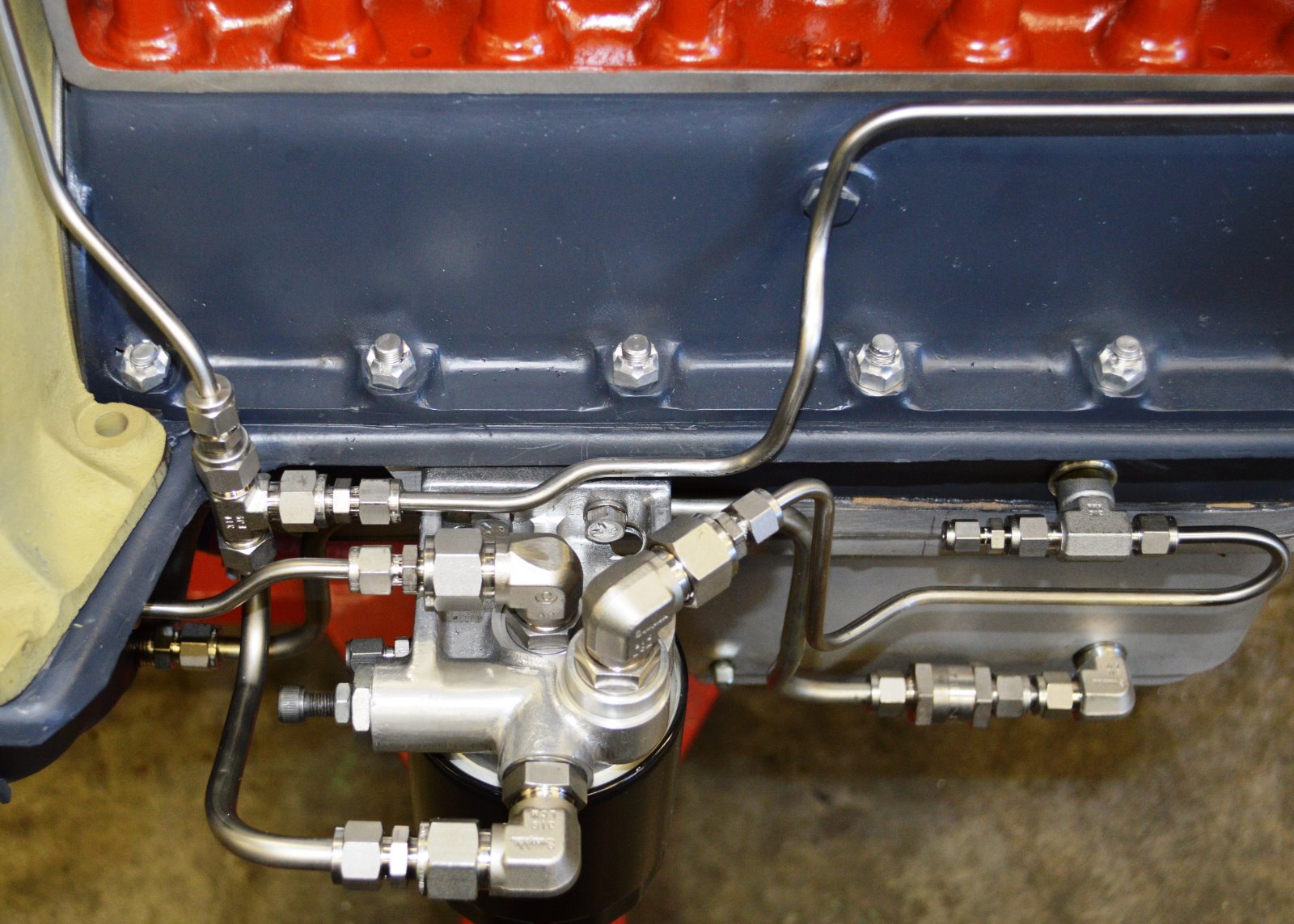

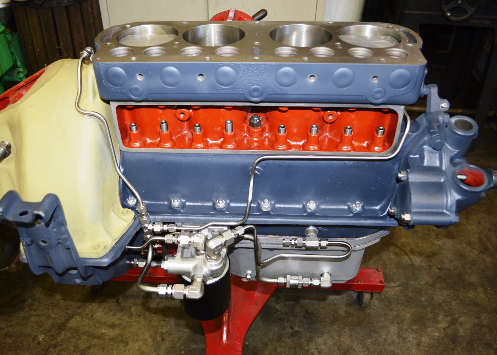

A different outside view. Did this one a few years ago. All stainless- the Swageloc guy loved me!

Wow Les, indeed he did!
That's a lot of pricey bling on display. The engine's not so bad, either!

DAN how do the swagelok compare to the a n. Fittings
Dan McEachern
Posts: 1476
First Name: DAN
Last Name: MCEACHERN
Location: ALAMEDA,CA,USA
Post by Dan McEachern » Wed Apr 08, 2020 2:24 am
AN fittings use a 37 degree flare as the sealing surface and were developed during WW2 as an Army-Navy (AN) spec for aircraft use. Swagelok tube fittings use a 2 piece ferrule similar to a commercial compression fitting but are manufactured to a much higher quality level, and are generally available in Stainless, brass and steel. They are used a lot in the chemical process industry and anywhere high reliability is needed.
