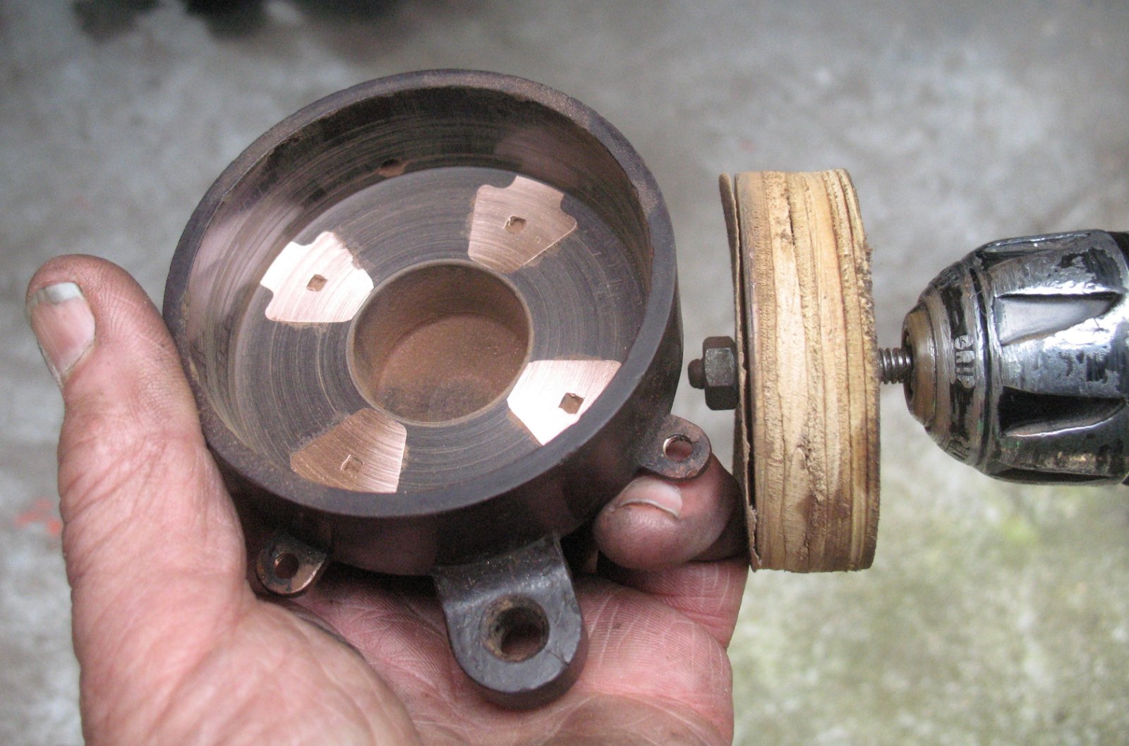

I run New Day and my method is so simple I'm almost embarrassed to post it.
Cut a circle out of 3/4 plywood that will just fit in the timer.
Drill a hole as close to center and as straight as you can.
Insert a 1/4 inch carriage bolt and smack it with a hammer to counter sink it.
Cover the face with self sticking sandpaper, 150- 180 -220.
Put a nut on the back side and tighten it up.
Chuck it up in your cordless drill and clean up the inside of that New Day.
Nice thing doing it this way is that you don't even have to take it off the car. Just pop it off, clean it up, put it back on.
I've been doing this for 50 years or more. Works for me.
I'm sure there are far more sophisticated ways but like I said, this works for me.

Post by Steve Jelf » Tue Apr 07, 2020 10:52 pm
Here is Stan's method. I think I may have learned it from him.

Keep an eye on how deep you go, the contact is only as thick as the tab where the wire is attached.

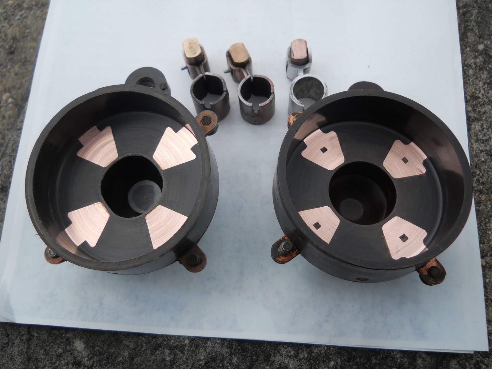

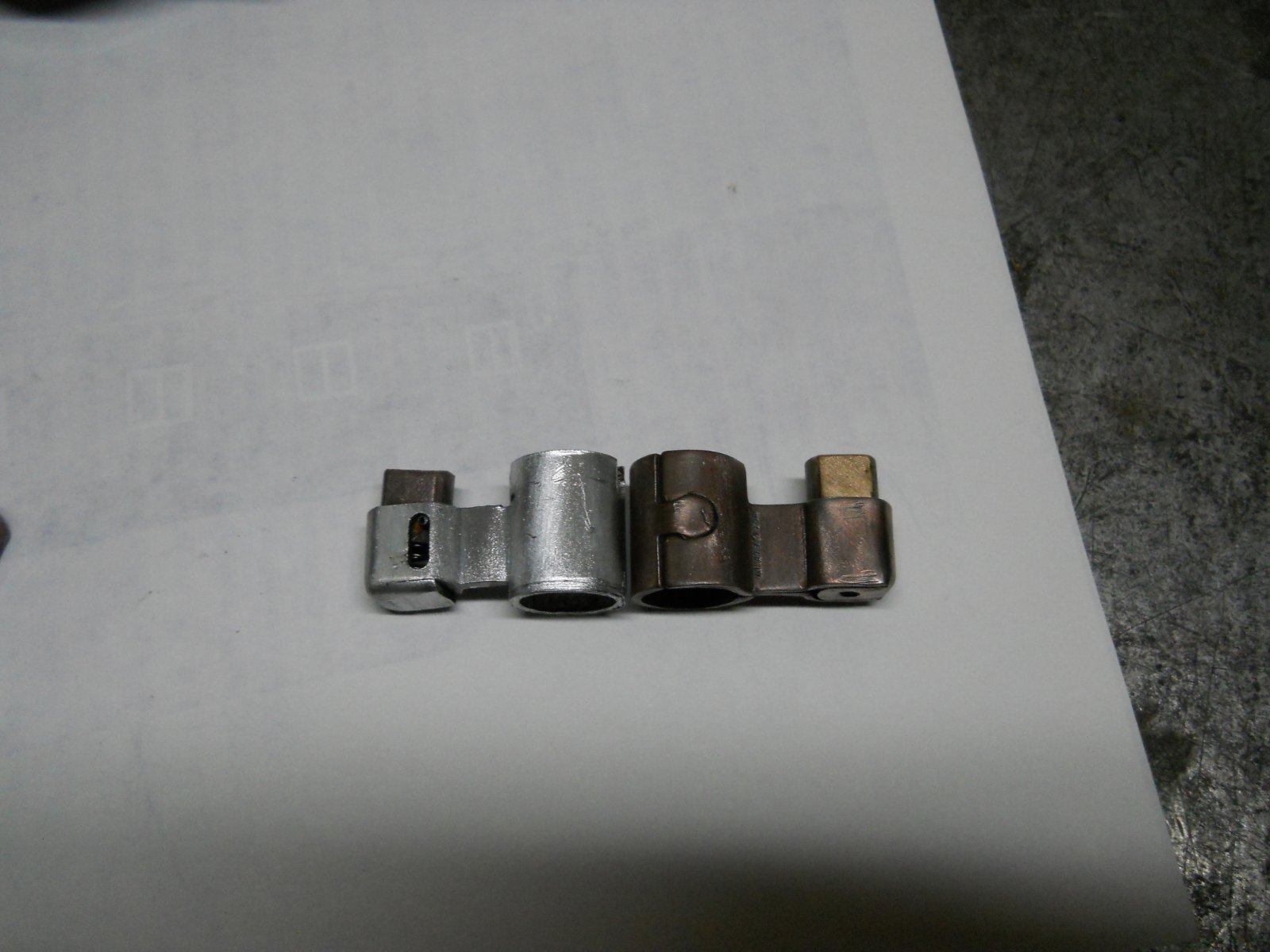

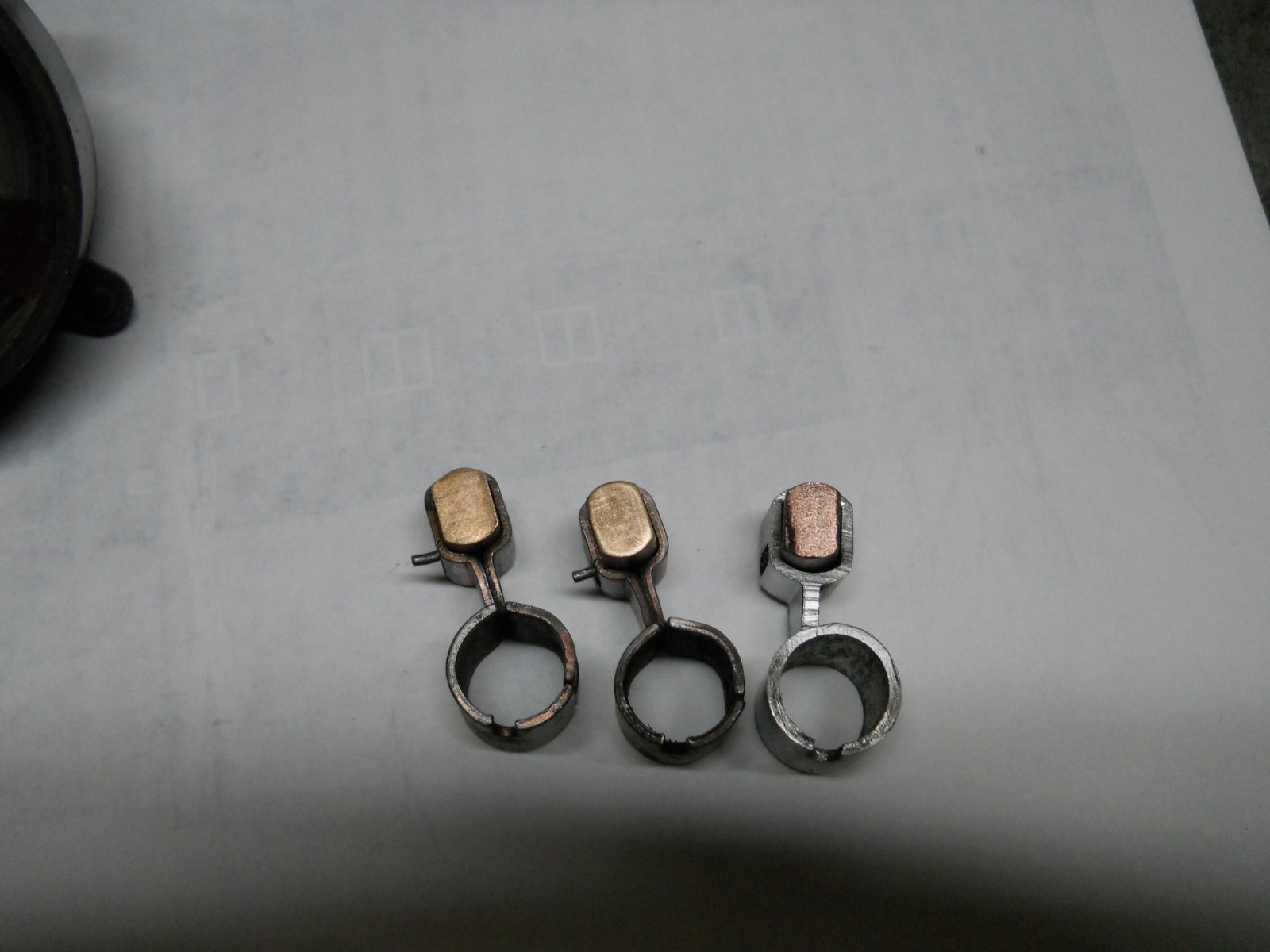

Ok, I made the tool (use a drill press to make mandrel hole) I did the deed and discovered something hope someone has an answer...one of the timers has pat. pending other has an S which to use? next two of the brushes are same one appears to be aluminum and is a bit taller you can see where is was grinding on my brass plate also looks to have a funny angle for brush...which to use? thanks randy

The silver colored one with the funny angle is junk. The brush caught on a step in the timer cap and got bent. You could just straighten it, but the brush itself is worn too far anyway, evidenced by the funky angle worn into it. Once that's trued up it'll be too short. Plus, at was a cheaply made repro to begin with.

Before you install the brush, file a slight chamfer on the leading edge. It will help a lot with wear.

The timer on the right looks like an original New Day. I assume the left one is the notorious S timer, which is one of the repops Stan is warning against. You appear to have a good timer and don't need a new one, but the one currently being made by Tom Carnegie has received very good reviews.

the one on left has the S on it....

One thing to be really careful about is to insure the spring on your brush is good. It should push the brush all the way out of the holder, indicated by the pin being at the top of the slot. If it isn't, even a new brush will make intermittent contact and the car will run poorly.
The one on the right is the good one. The one on the left needs a new spring.
