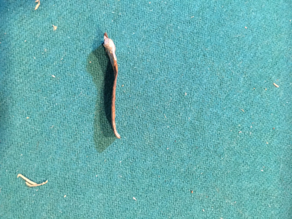

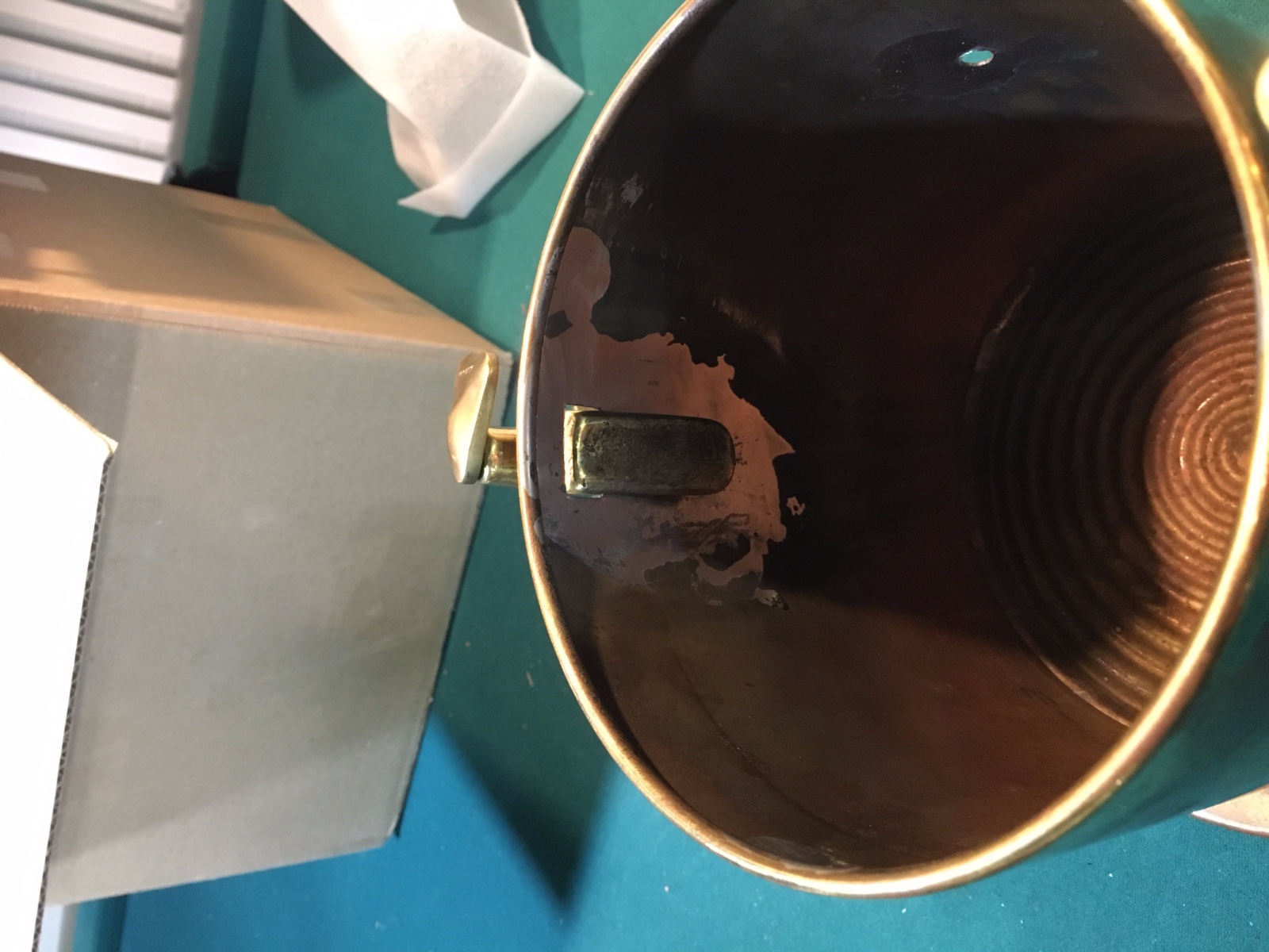

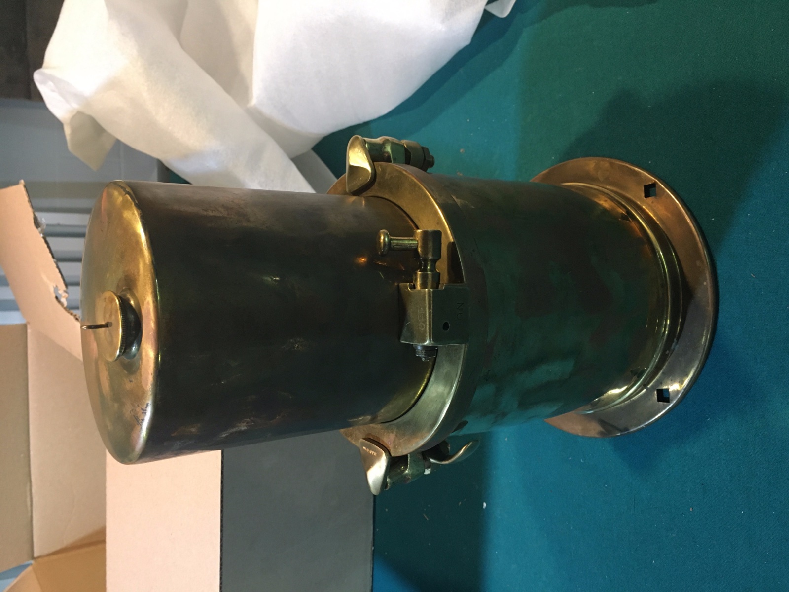

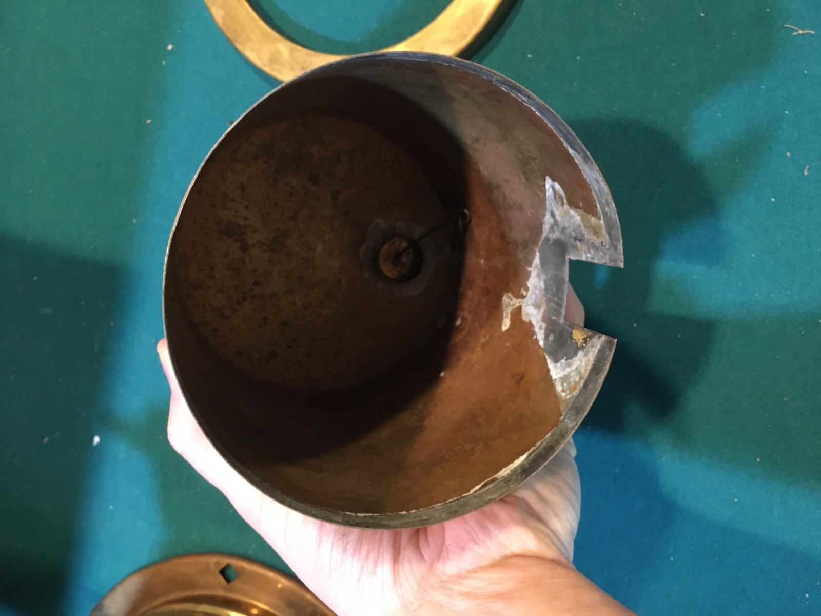

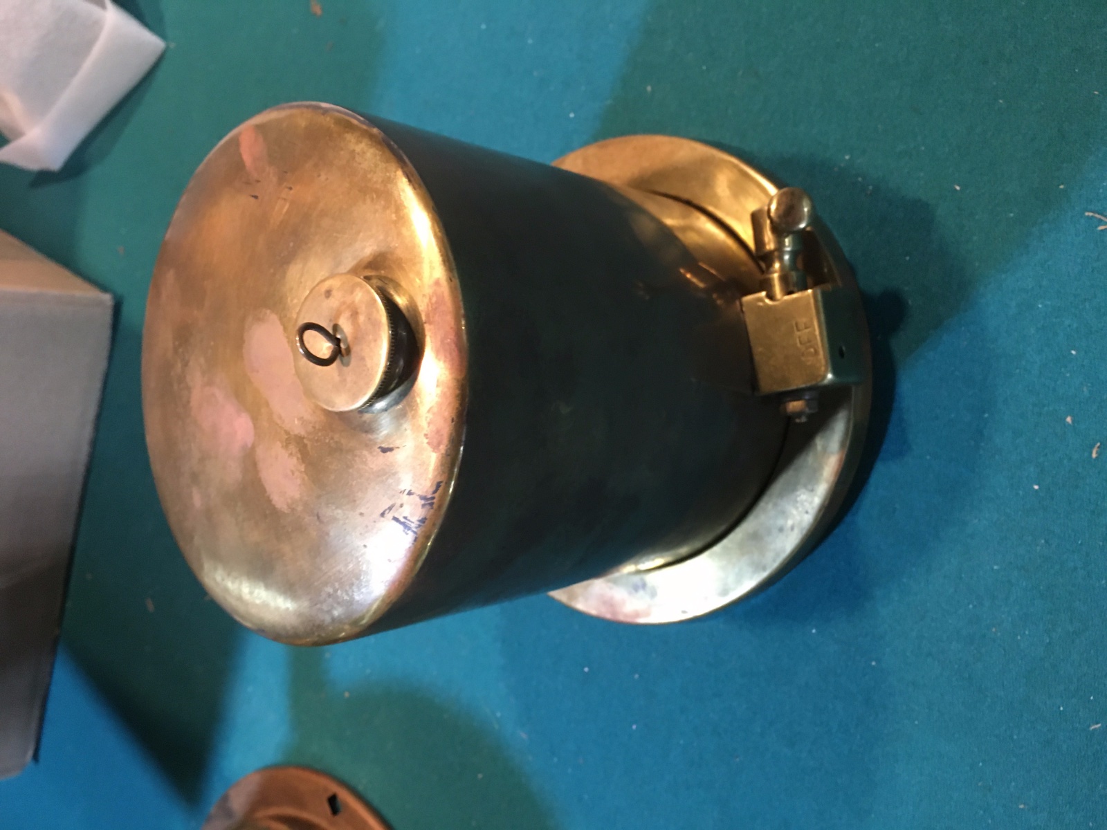

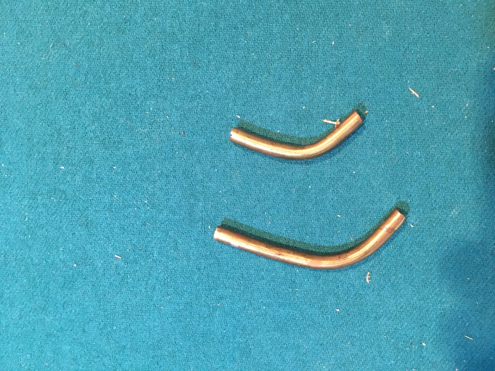

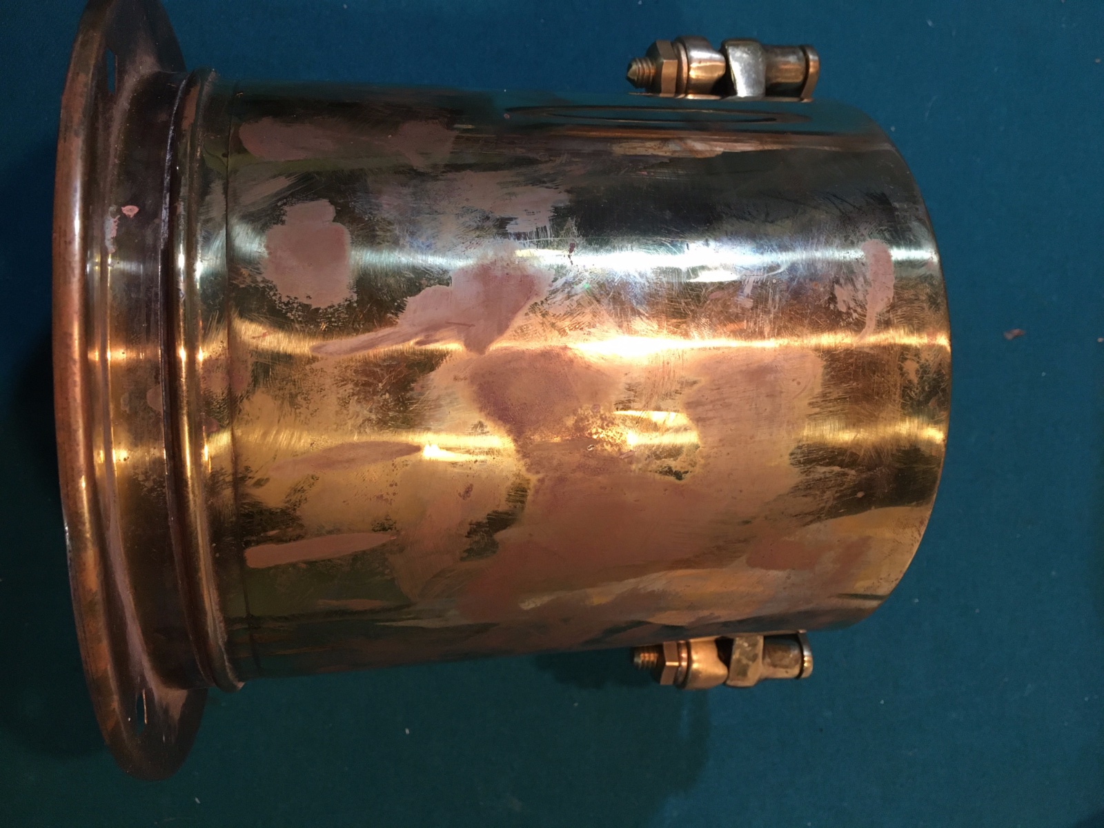

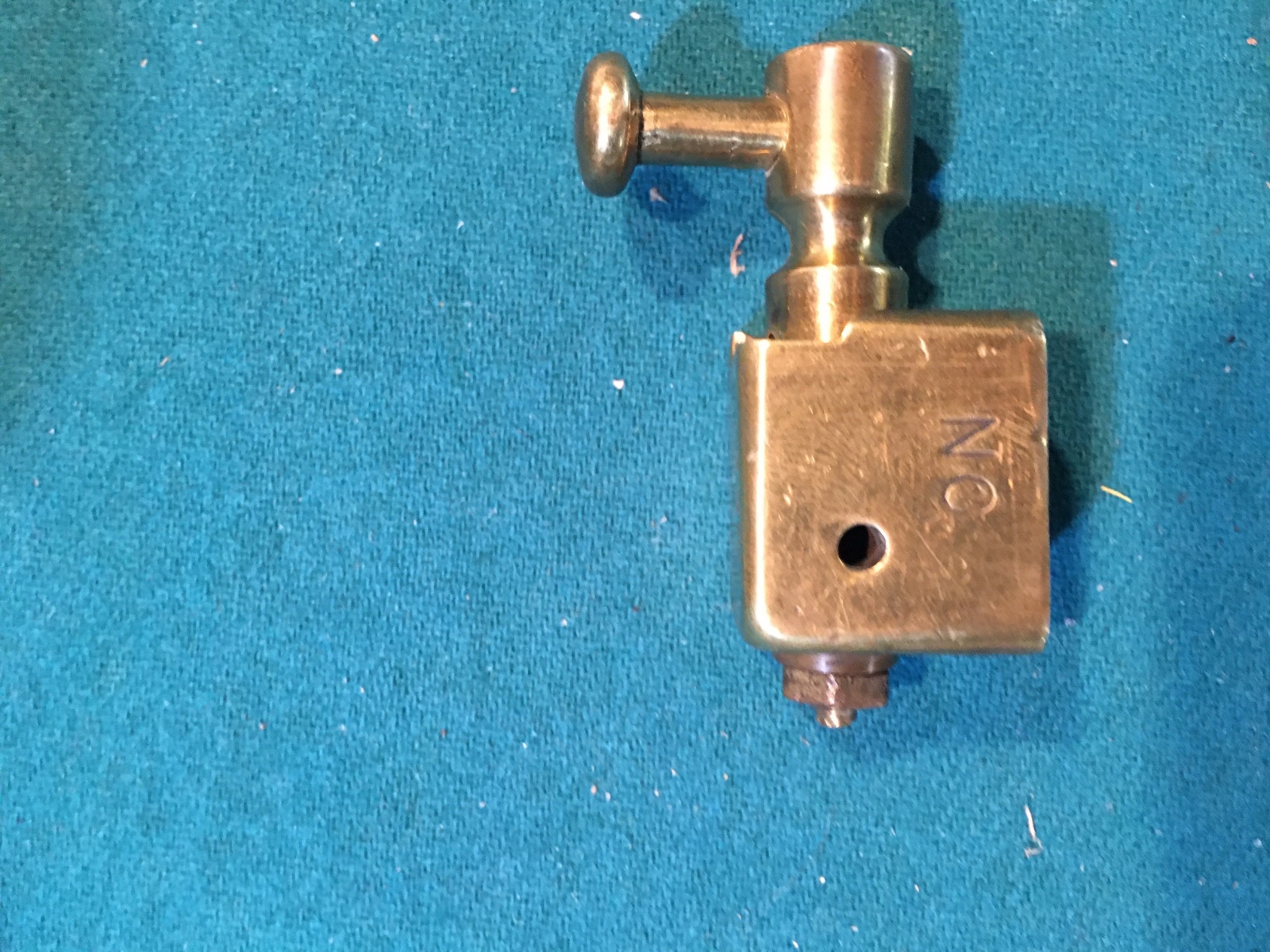

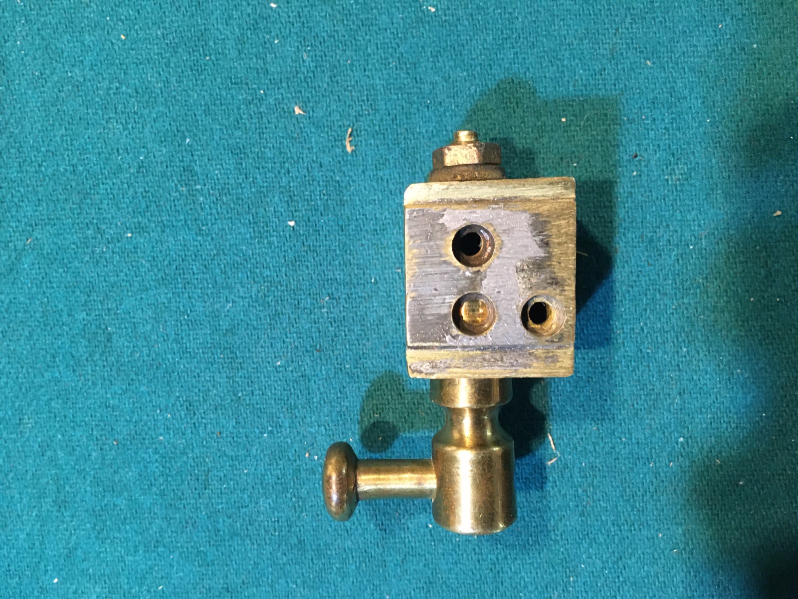

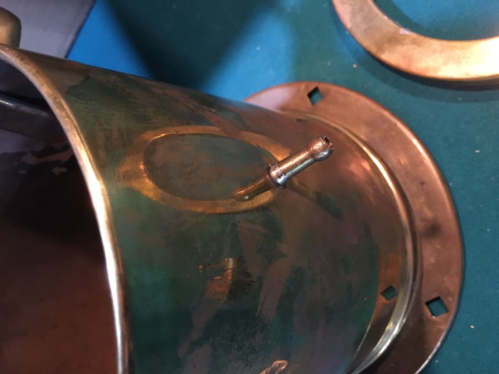

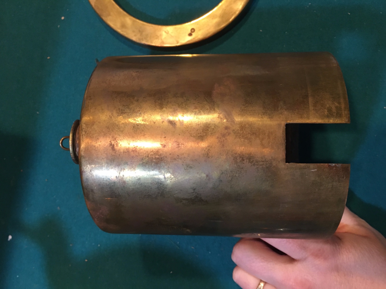

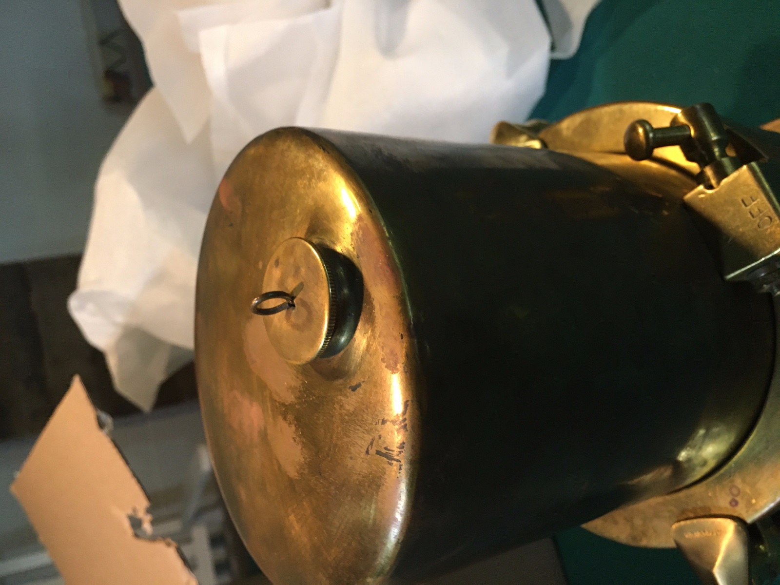

I just acquired this brass Carbide Generator. It looks as though someone took it all apart to do a restoration on it. All the brass is straight. I've never seen one of these apart before. It is missing the basket for the carbide, and I think some sort of rubber gasket to seal the top and the bottom of the tank? also some sort of other tank that goes inside the top water tank? So a few questions as to how these things are assembled:

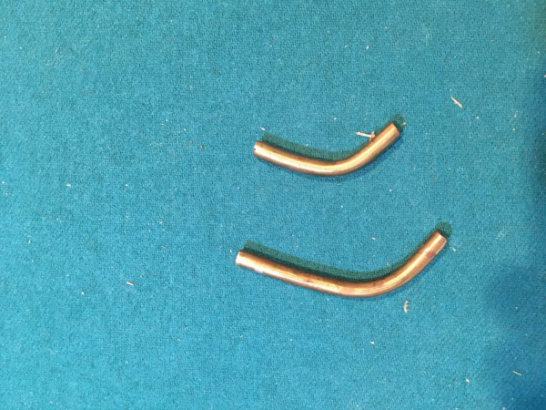

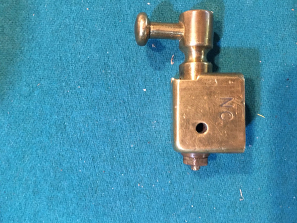

There are two pieces of piping a short and a long which holes do they mount to and come out of on the switch and the bottom plate?

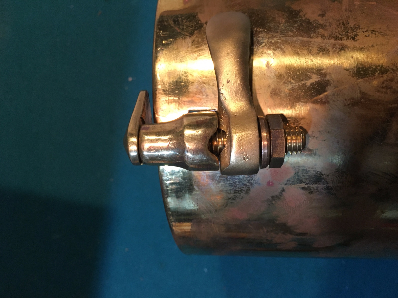

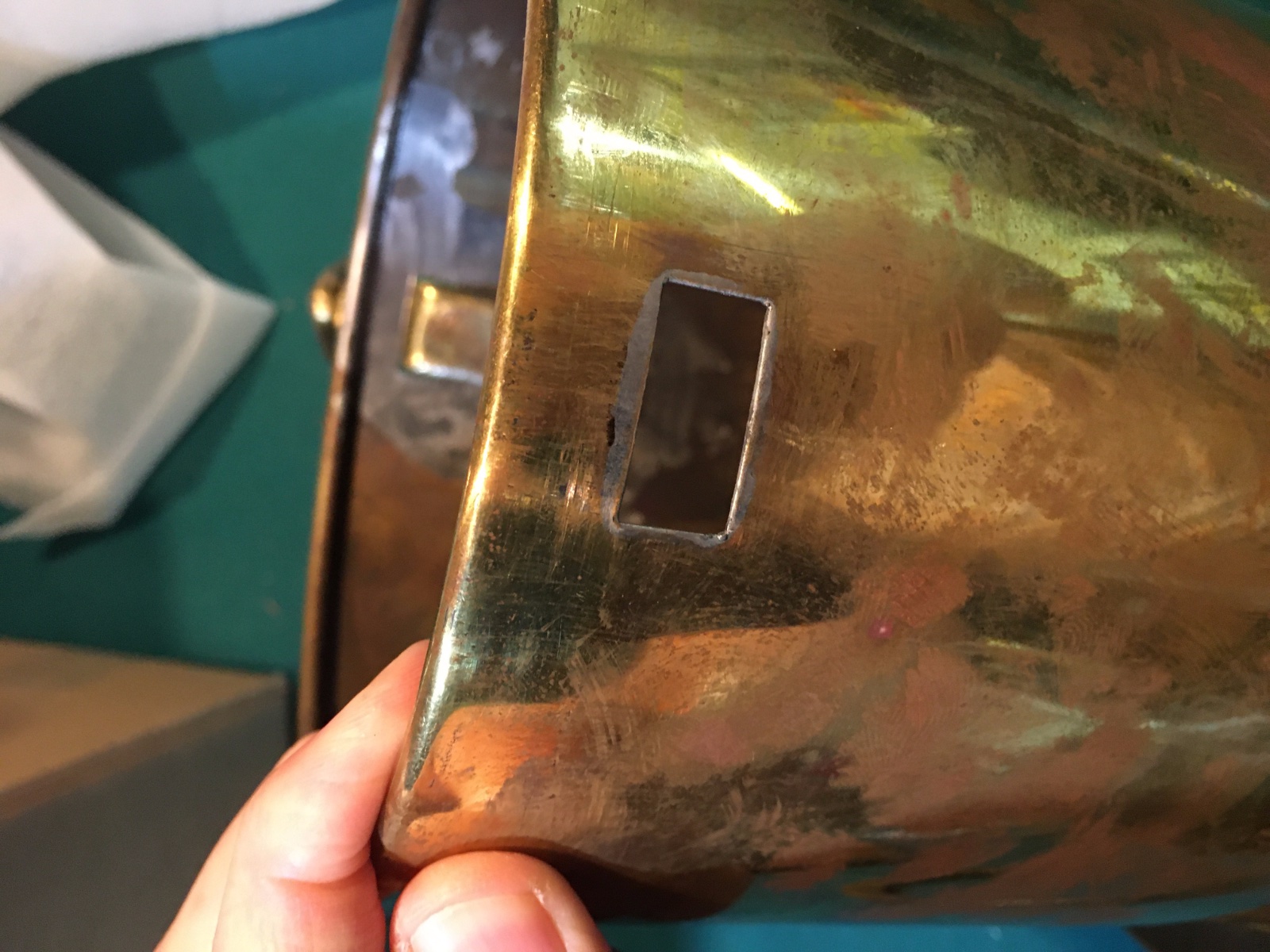

The levers on the sides that hold the top and the bottom tank together, how are they fastened to the inside of the tank?

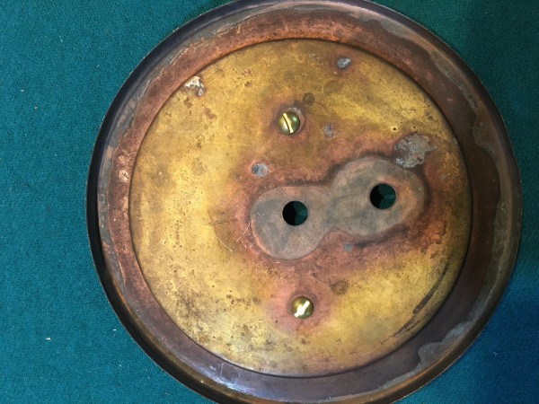

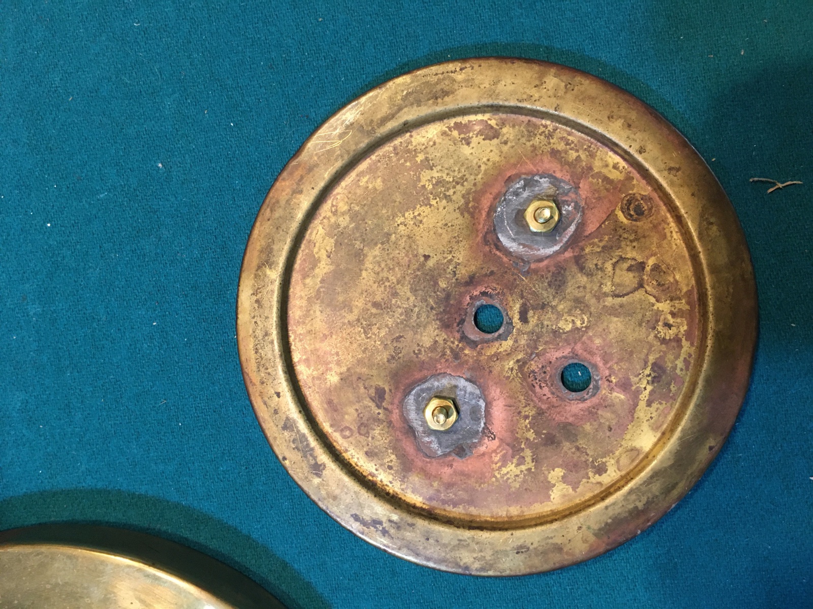

There is a bottom plate with two screws and nuts attached that I presume goes to the top of the water tank, is there another piece that attaches to this bottom plate?

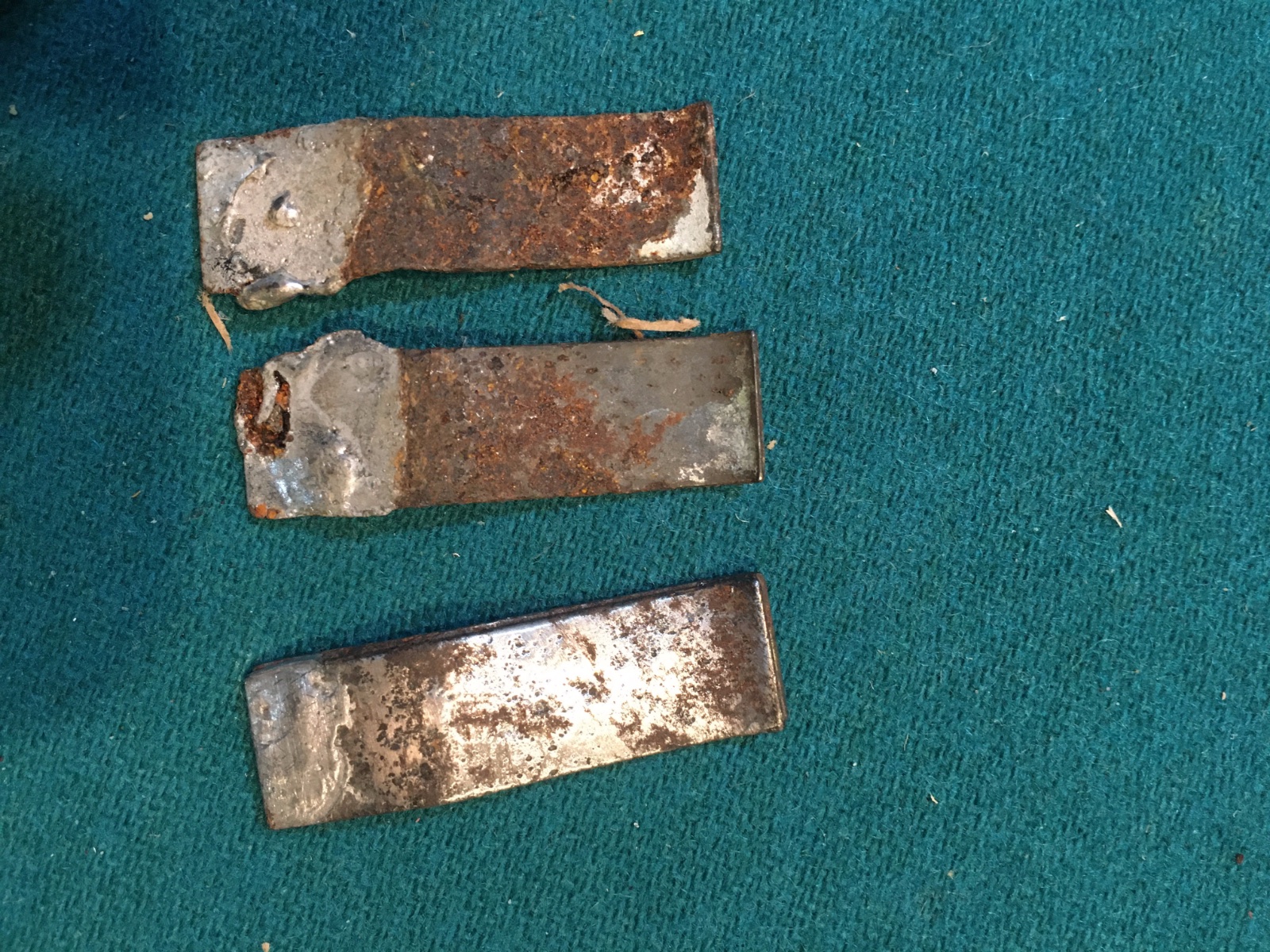

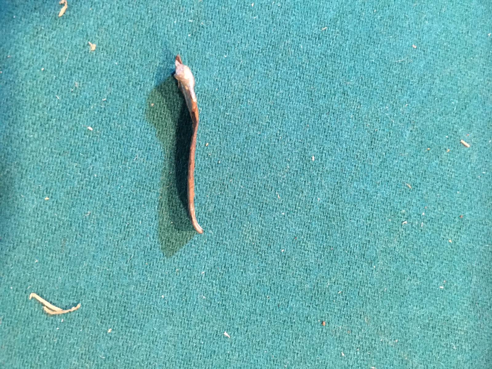

It came with three pieces of metal that has a slight curve in them. I have no idea what these are for.
From the looks of this tank it appears to be an early E and J but not sure.
Perhaps someone on this forum has taken apart one of these before. Really it just needs to be assembled. The brass is in really great condition just needs a polishing.
Thanks guys for your help!
Mike

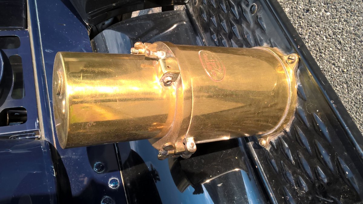

Mike, Looks like you have a Corcoran Generator. It is identical to a Jno Brown except for the base and Jno Brown tag. I have a completely restored Jno Brown that I could send pictures to you for reference. If you call me I can give you some advise on modifications, missing parts, incorrect parts and restoration tips for a correct Jno Brown 1911-12 generator. 586-243-7202 AL

My understanding is that brass era Brown and Corcoran generators are nothing alike in their general appearance other than being dimensionally the same. I recognize what Mike posted as a brass era Corcoran -- round base and cam clamps. Jno. Brown had a cast base with three feet and wingnuts for clamps (among other small differences). When Brown went to black-and-brass, the style looked more like a brass era Corcoran and it wouldn't surprise me if not all manufacturers made their own generators, but sourced them elsewhere and had them made under their name. Even amongst all the different designs they will share several similar features like the concentric rings stamped into the bottom plate and the valves appear very similar. The shared manufacturing is just a theory on my part.

I did figure out what those three pieces of steel are with a slight bend. The attach on the inside of the bottom tank under a lip. I’m not sure what function they serve though. Perhaps to keep the basket from jumping around? I saw this picture that helped me figure it out. Perhaps someone else can chime in?

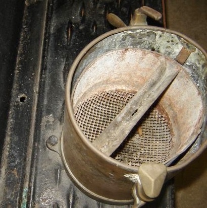

Know little of generators, but can share this photo found on past forum post. Appears to show the metal strips to hold the basket up.

Ok I’ve been looking over pictures and have been able to put most of the parts together. Can anyone verify if there is a gasket between the top tank and bottom?

Yes.... .06" flat rubber or thicker (old inner tube or rubber roofing) or composite sheet (standard gasket stock).
