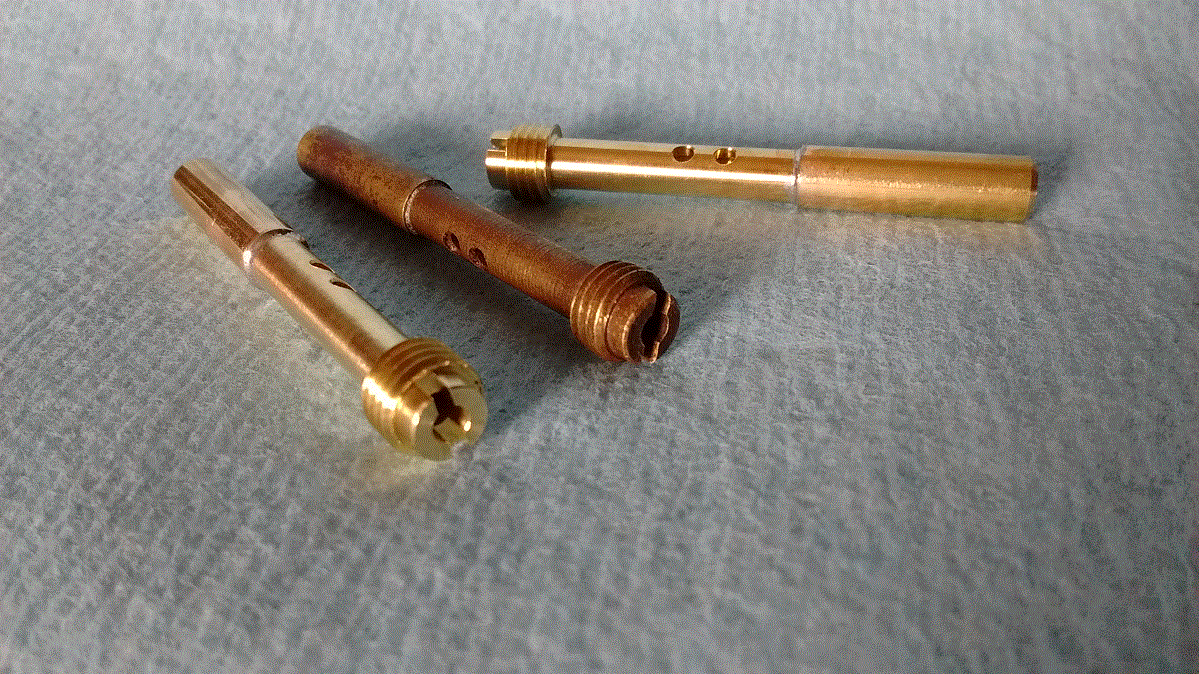

Who knows why I do this stuff? For me, it's interesting mechanical archeology and the sheer satisfaction of replicating interesting or complicated or miniature things.
More parts falling off my lathe today - one original and two clones:

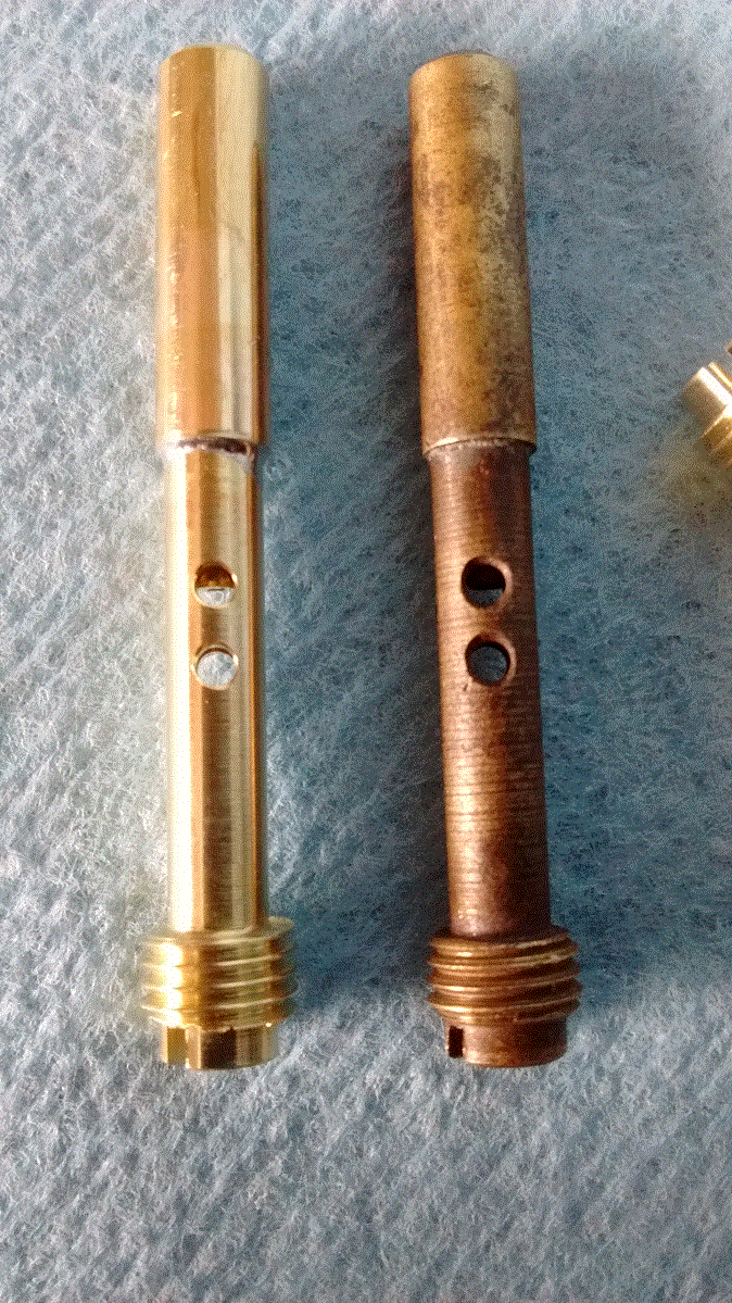

Gene, simply making some was challenge enough and I am in no position to improve something that folks a lot smarter than me designed.
I puzzled over it for quite a while before I realized the original was a soldered assembly and then the whole thing came together in my mind. I think if I'd been less fortunate during disassembly and the original had simply broken, I'd have figured out the secret much faster.

Probably a fun project but I can't imagine there is much market for them.
People who can't get them out usually twist them off trying or strip the slot in the top; I think some people who "rebuild" OFs don't even know there is an idle jet in there.
Some screw right out, some take a hot wrench and a specific vocabulary.
Anyway, that is the early design made up from three pieces, the later design is all one piece.
The early design tends to break at the solder joint, the later design tends to strip out the slot if it is stuck in a hundred years of old gas and varnish.
The RF is way worse. The brass idle jet and the aluminum body tend to weld together and the only answer is usually to drill it out, make a new idle jet and hope it works.
