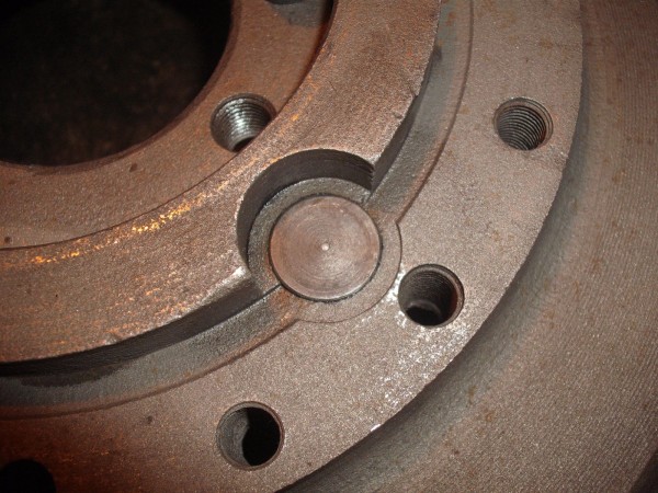

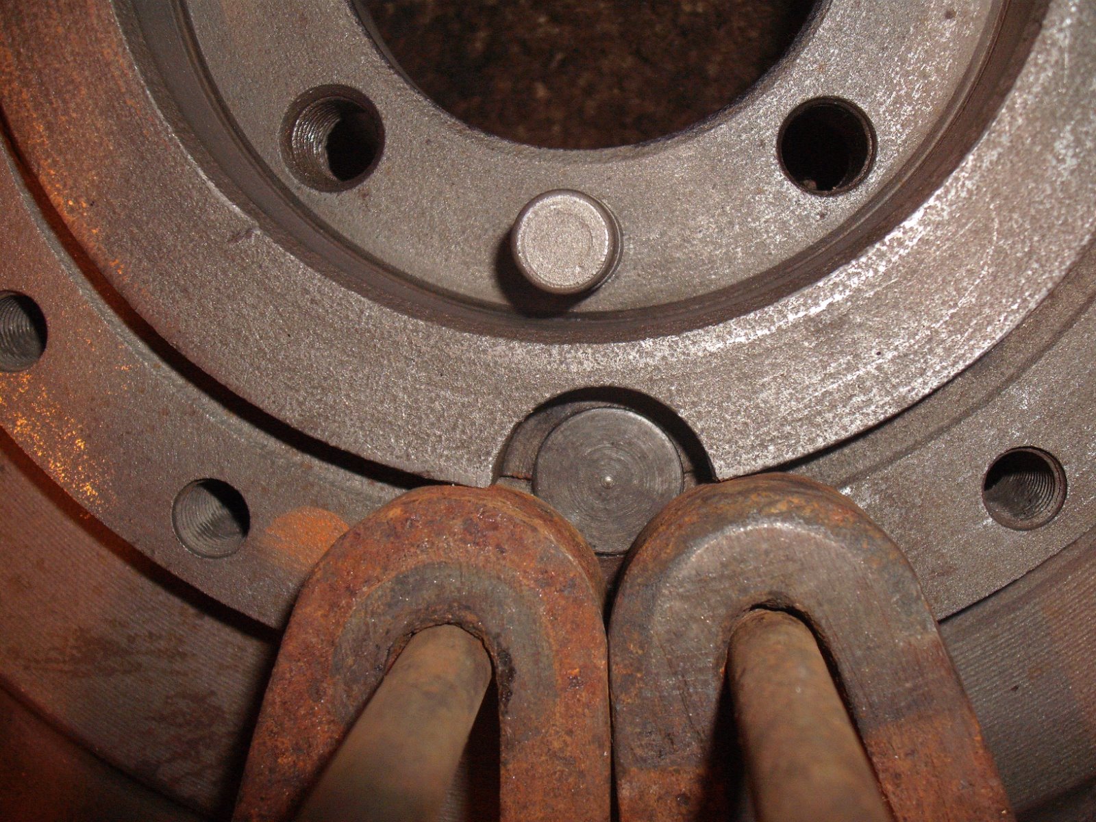

I am building the speedster engine. I think I just dodged a bullet today ... Today I was riveting the ring gear bolts in place that hold the ring gear and the 16 spools that Im using for oil slingers. While riveting the bolts one of the triple gear pins fell out. I thought they were in good shape. No wear at all and no signs of looseness. So today I ordered the new triple gear pins, and hope the old ones were not already oversize. If they are then Ill find a good flywheel. Does anyone know the size of a stock triple gear pin where it fits the flywheel. ?? I know they are tapered, so it may be a trick to measure them ...
All this got me thinking. (dangerous). What if I had missed it and the pin backed out while running. It would have been a total loss. So is there any way the speedster guys running no magnets handle this problem. Or does everyone just "trust" the press fit. Im thinking of using a washer and bolt at each pin. A thick washer made like a fender washer will cover the end of the pin and keep it from backing all the way out. It does not have to hold anything, just stop it from backing out in case a pin worked loose. . I can use three washers, three bolts, held in place with "LockTite" and then safety wire the three bolt heads together. I will pay attention to the weight of the parts to keep everything in balance.
One of my pictures shows how Ford used the magnets to act as a safety. I have seen way too many loose triple gear pins to feel comfortable with no safety of some sort. This is my first engine with no magnets. So any help, ideas, information about how others may have addressed this problem ...

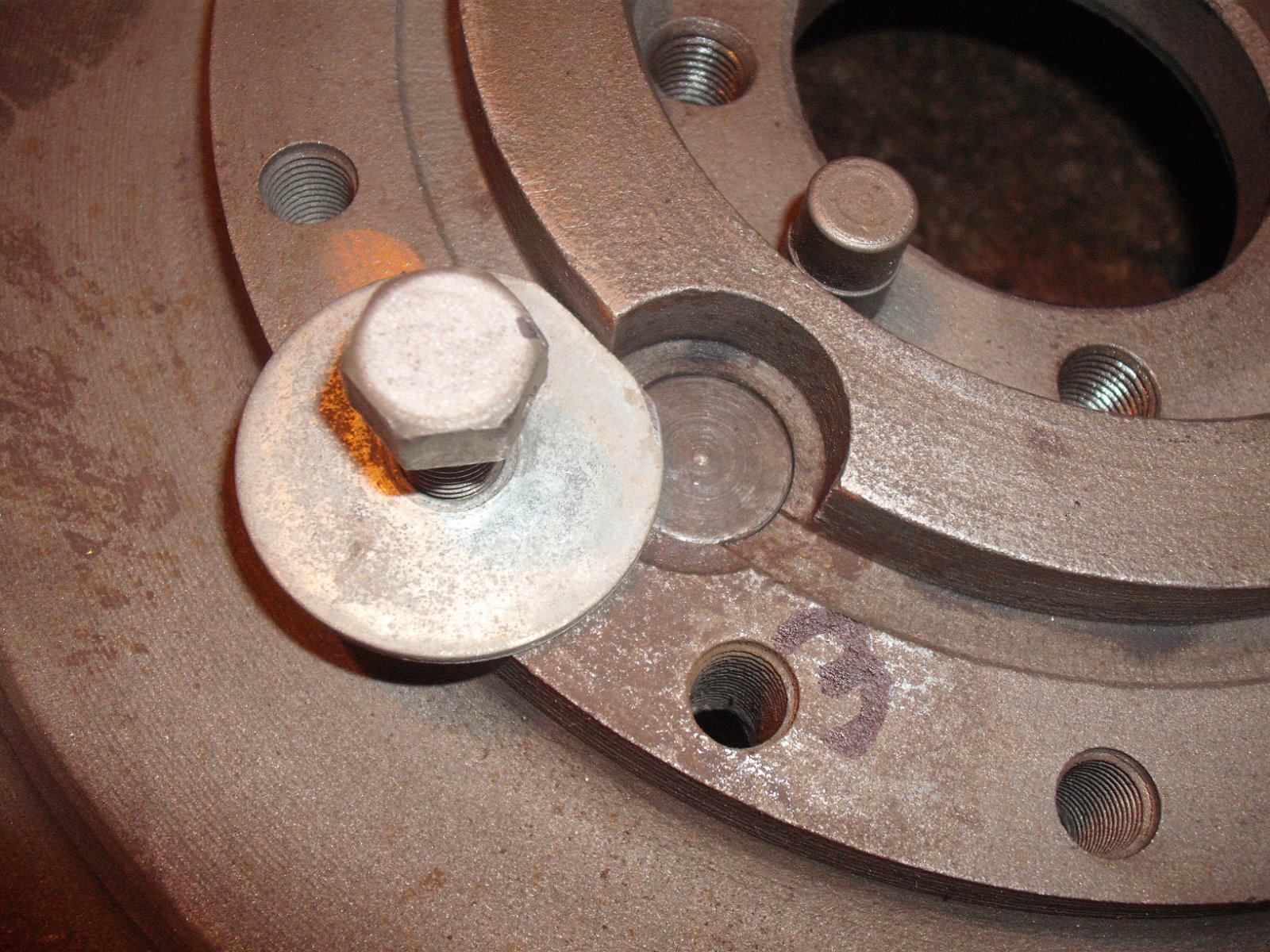

Capturing the pins with a large washer & bolt is one procedure - another which I use & prefer I and I believe to be the best is a collar available (is/was?) from Dan McEachern - no way anything is "coming from together" with one of his gizmos !

If you have taken out the magnets, do you need a bolted washer or custom collar behind the triple gear pins, even though they are pressed in? Or is this just a precautionary measure to keep them from backing out, and not mandatory? P.S. How come I have a bad gut feeling?
Mindless Automaton
- Posts: 125
- Joined: Mon Jan 07, 2019 1:47 am
- First Name: Kep
- Last Name: Kerensky
- * REQUIRED* Type and Year of Model Ts owned: 23 truck, 26 bug
- Location: Northland
- Board Member Since: 2011
Re: triple gear pins, flywheel with no magnets, questions ..
Not mandatory.Autie wrote: ↑Thu Feb 07, 2019 12:44 amIf you have taken out the magnets, do you need a bolted washer or custom collar behind the triple gear pins, even though they are pressed in? Or is this just a precautionary measure to keep them from backing out, and not mandatory? P.S. How come I have a bad gut feeling?
But a collar ring would be nice.
Washers, less elegant and less balanced.

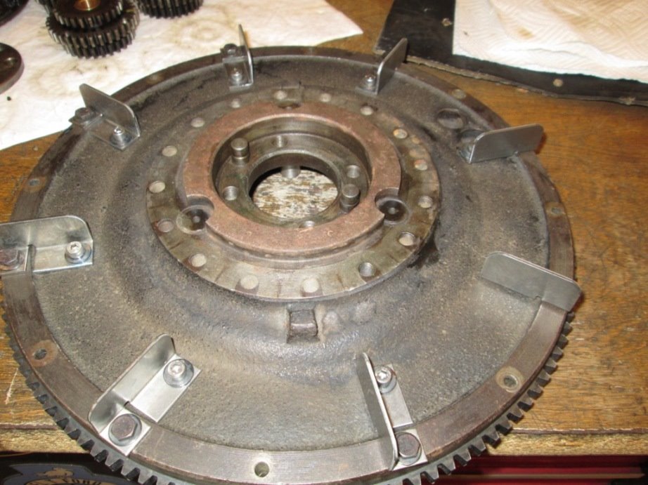

This is a charming thought, having been driving around with no magnets since early 2010.
From everyone I talked to about installing oil paddles, and the instructions that came with them, no mention was made about the triple gear pins backing out. Too late now, I'm not removing the engine to deal with the possibility. But, if something does happen, I'll finally get to clean the congealed oil off the clutch discs.

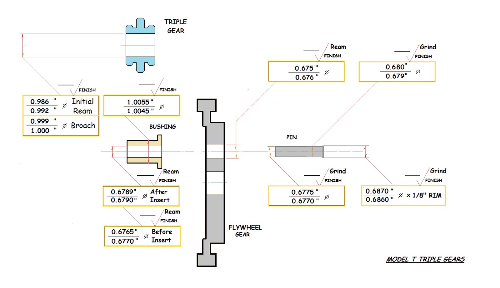

Back to your original question.
Here are the original factory dimensions and tolerances for the triple gear system parts as a reference.
Three points to consider before trying to interpret this drawing...
1- I don't think that the two pin suppliers today make pins to the original drawing specifications.
2- I have fully convinced myself that as surprising as it may seem, Ford DID hold transmission parts to the 4th decimal place on repeatability in manufacture and only used some 2/3 of that 4th digit range.
3- You'll notice a 'bullet rim' on the tail of a pin. This was apparently to seat lock the pin in the wheel. If someone tried to push a pin out into the gear side, it would have been tough, but if they just got a bigger press and got it out you can bet the fly-wheel hole got bigger in the process.

Thanks for the specification drawing, The Ford service manual says that the pins need to be .003 larger where they fit into the flywheel. That is to make up for the holes being enlarged by driving out the old pins.
Thanks for all the input
I have seen quiet a few "loose pins" thru the years of tearing down engines. So I know it is a somewhat common occurrence. I have ordered Dan's pin retaining ring. It should solve any problems with the pins backing out. Ill try to remember to post photos when I get the ring installed.

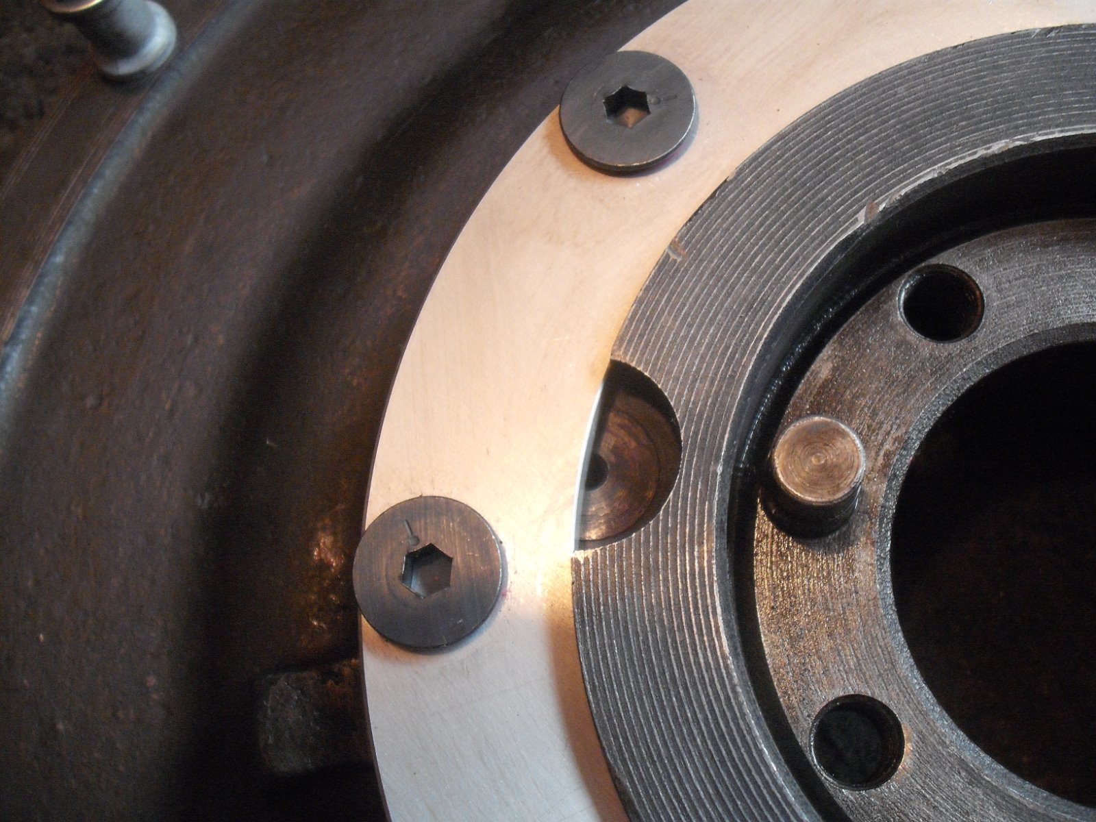

Somewhere I have a photo of the collar installed on my engine - here's what Dan's oil slingers look like installed - I'm still looking !

Autie. The problem I see with installing the bolts/washers in the car is "balance". If I had used bolts I was going to weigh the parts and use thicker/thinner washers to achieve balance. Then do a final balance procedure of the flywheel assembly. The balance problem comes from the bolt hole, vs. triple gear pin spacing. There are 16 bolt holes. Then there are 3 pins. It is possible to get the three washers to cover part of the three pins, but not possible to get the three bolt/washer assemblies to have an equal spacing. Since my engine is still apart, I could balance the flywheel assembly as a unit.
It may be possible to use Dans retaining ring, by cutting it in half to install it. But I have not seen his product yet. I would suggest to contact Dan and see what he thinks. The price of his ring is not that much, for "peace of mind". But Im unsure if it is useable on a complete engine ...

OK, heres the deal. I finally got to my T today to install the retainer plate made by Dan McEachern (which by the way is top notch, well engineered/manufactured part). Being that my engine and transmission was just rebuilt/installed prior to reading this post and it hasn't the magnets installed due to me running a distributor set up, and nothing backing the triple gear pins, I was concerned of the possibility of one of the pins backing out. Being that Dans retainer ring is suppose to be installed BEFORE the tranny is bolted to the crank because it is just that, a complete round ring (like a donut), I was wondering if I cut it into 4 exact measured/weighed pieces and went through the oil pan inspection cover, if there would be enough room to install them. A kinda tight fit but yes, it is doable. Easy peasy? Not so fast. I forgot the oil slingers I had installed on the flywheel which bolts up to the flywheel in 4 of the holes which the retaining ring would go into also. Still no problem. The problem comes in is where the oil slingers bolt onto the outer edge of the flywheel, I had to remove the starter to gain access to those (8) bolts in total. Tomorrow (?), I am going to mill the ends of the oil slingers where it bolts up to the flywheel to compensate for the height of the retainer ring and get it back together.

Autie, Sounds like you are making progress. If you cut the retainer ring in four pieces and label them as to where they originally were when solid and then install them in that order on the flywheel , I do not think weighing them will be needed. As an added protection I also used locktite on the screws Dan supplies. His ring is really a nice piece.
Here is the only pic I seem to have taken while I was installing his ring on my engine. I would highly recommend using his product when building a engine with no magnets. Thanks Dan for such a nice product.
Sorry for any worries or extra work my problem/question may have caused. But in 30 plus years of rebuilding engines, this was a "new" problem that never even occurred to me.... The old dog learning new tricks saying, really applies to me on this problem ....
