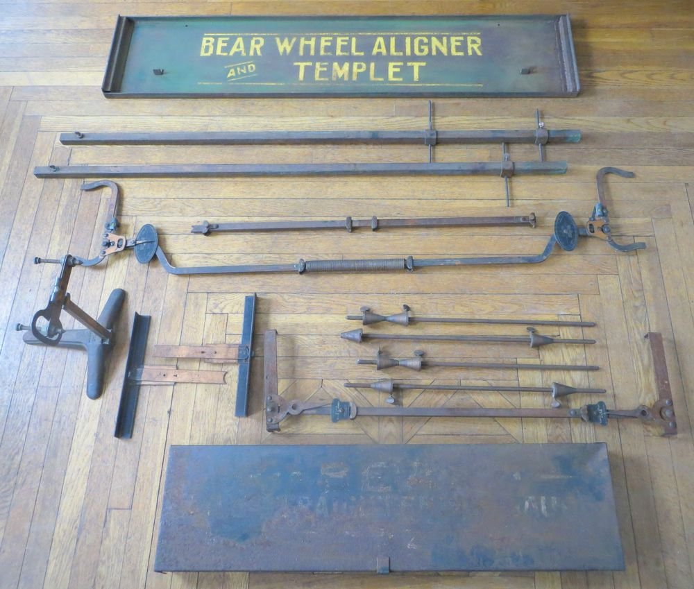

Could someone with a Bear or similar alignment tool please describe how to use it, specifically, how does the alignment tool stay on the wheels for measuring. Looking at pictures I cannot see how it can be done by one person without falling off the wheels. Some look like they have ends that might wrap around the wheel fellow, and others look like they have points to touch the wheel fellow. Does the spring in the center of the connecting rod work in tension or compression? I am thinking about making something like it with plywood ends and a metal connecting rod, but don't quite understand how it interfaces with the wheels.

They have two springs. One for the right, and another for the left. Haven't had a problem with one falling off.

Here is some information from a previous discussion and picture of a complete set

I have the Bear manual. Which number fixture do you have? Number 10, 15, 40, etc? The entire manual is a lot to scan but I can scan the specific pages you need.

[image][/image]See attached
