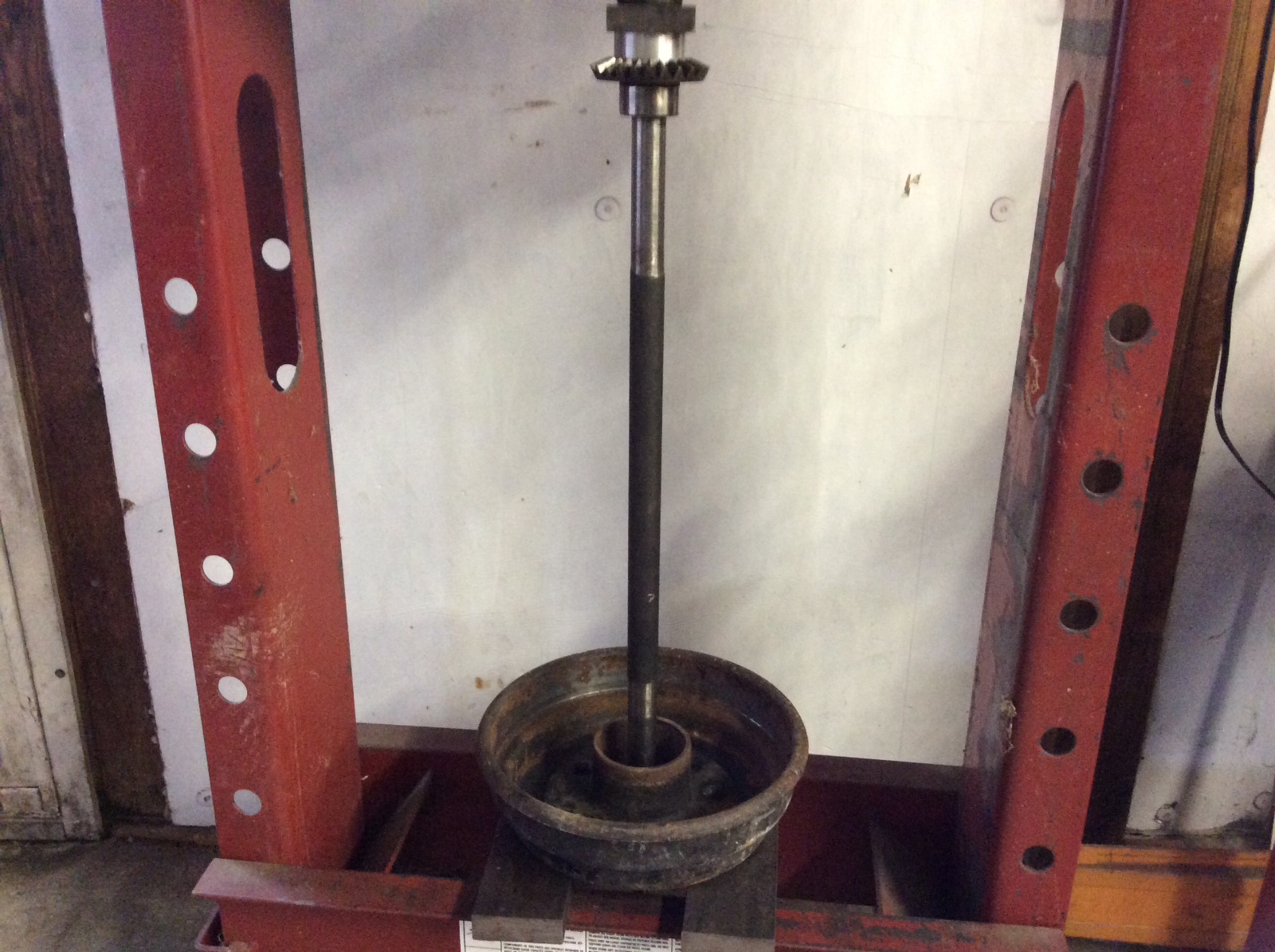

I used a 20 ton press. I polished 1 axle .0005” to 1.6250 . One gear was a tight fit and one was very tight due to different gear tolerance. I used a model A hub with an axle shim to hold the tapered end. I froze the axle and heated the gear.

One thing I did to prevent bending new axles was to reinforce them with angle iron before pressing the gears on. I cut 1x1 x 1/8" angles to about 22". I wrapped the axles with tape to protect surfaces and then clamped two pieces of angles onto axles with a few hose clamps. Doing this increased the critical buckling force from about 28,000 pounds to 54,000 pounds. The press I used was 20 tons, which could have buckled an axle without reinforcement.

i am going to use a piece of square tubing over the axle 3/16 to 1/4 inch wall i will also put bolts in along the length to tighten up the axle and use a hub with a shim in it and will be able to cage the whole assembly for pressing on the new gear and incorporate many of the suggestions folks here have given me.
