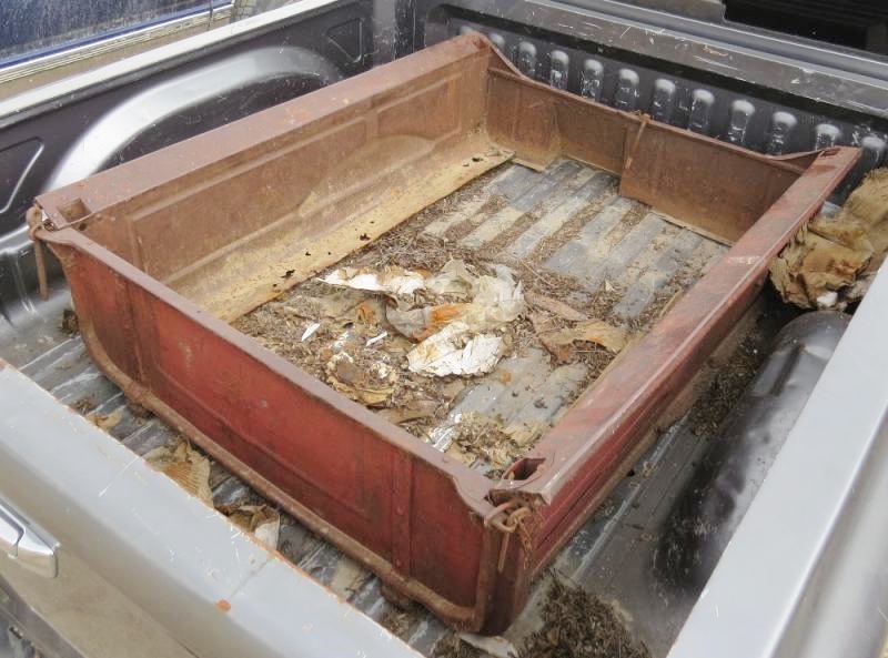

I am trying to convert my roadster to a pickup. I found a trailer someone created from an old Model T pickup bed. I bought 2 parts from Lang's they call "pickup bed steel strips cross channels" So far I have not seen a pickup that has these cross channels. They are drilled and appear that the steel bed strip bolts go thru them. What I'm trying to find out is how many holes from the tail gate back do they go, and also does the open side of the cross channel face the back or the front of the car.

The bed has a wood board floor, your bed in the photo seems complete other than missing the wood floor boards which are held with metal bed strips, and the sides of the outer boards bolt to the curved inner bed metal, and to the rear support and to the front panel of the bed.
Bed complete with all metal, but missing the wood floor boards.

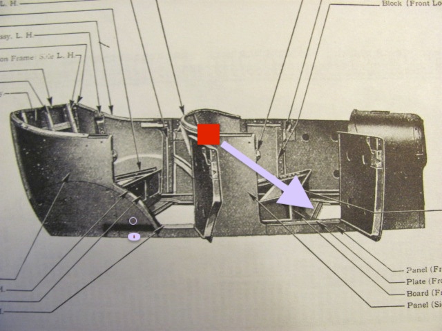

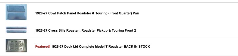

Howells makes the Model T metal, the pieces for the pickup. On the Howell site parts are listed for the cross sills for the subframe of the runabout and touring, they each use two of these. You can see them in the factory illustration , they lock the side members of the subframe, and have holes for the frame mounting bolts.
Lang's
Howell's

I think you may be right. The cross channels fit on the bed and I can see how they would help support the wood from the bottom. I then checked if they would fit between the frame and they do not. Perhaps they are for a 1925 bed as I do have a friend with a 1925 bed that has them.
