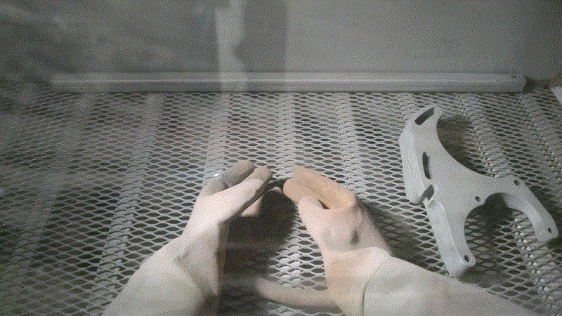

It is very frustrating sand blasting in a booth that is very foggy, even with two lights in the upper rear corner. Today an idea came to me to blast with one hand and hold a flashlight on the metal with the other hand. And what a great difference that made.
I still have to look through the beveled edge to see, but at least I can see when using a flashlight!

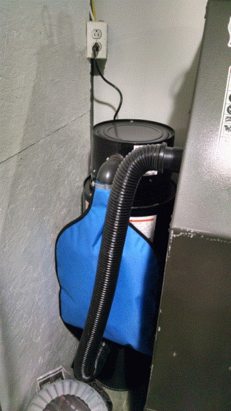

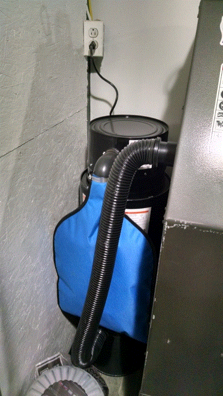

After Robert posted this yesterday, I got to thinking that the last couple times I used my Blast Cabinet, it was a little hard to see so today I changed the lens on the view window.....What a difference!
Here is also a picture of the vacuum system on the side of the Skat Blast 960 from TP Tools in Canfield, Ohio. If anybody is thinking about buying one, I can highly recommend this brand.

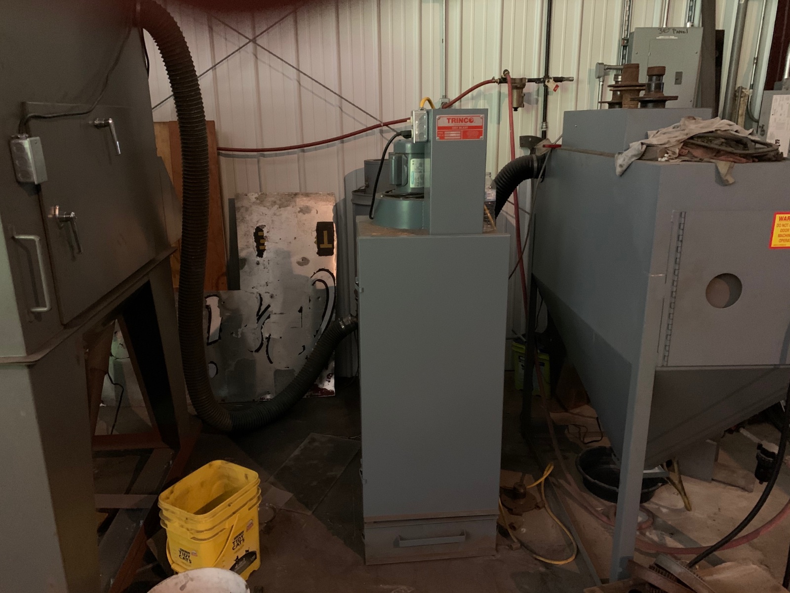

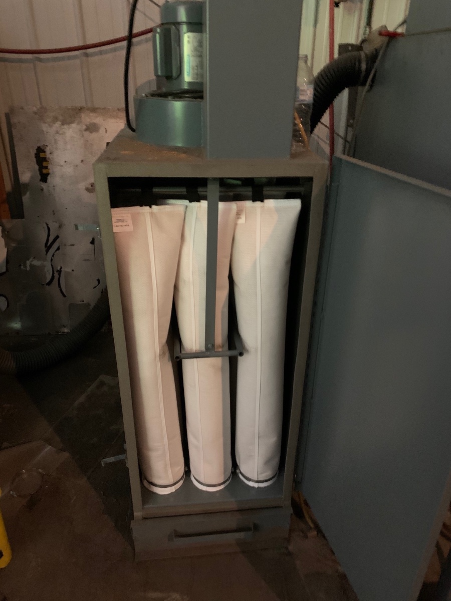

Since I was using my blast cabinets today, I took a couple pictures of my dust collector. Dan

Awesome Dan!
Do you get much sand in the bottom drawer? just wondering because I have never had to empty my collector bag. I thought I would get more in there.

Lots of dust, very little grit. I do not use sand , very bad for your health. Very dangerous to use sand. Dan
