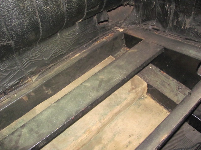

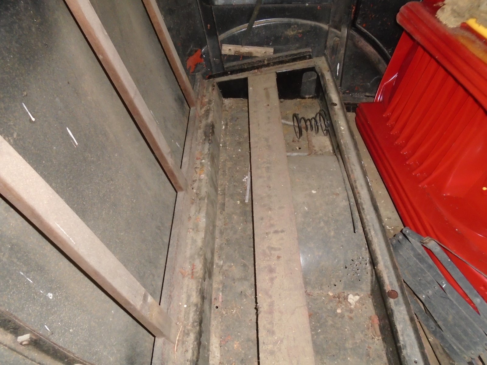

My 26 touring has three boards 3/4" material one narrow and two wider, the car was never finished but it runs I have owned it for 56 years. I have done about 60% restoration, I replaced all the wood that was originally in the car and the boards were under the rear seat. I cut the new wood the same as the originals. I can see that there would be more support with the boards. I can't see that there would be any difference in storage space, the boards would only raise the seat higher.

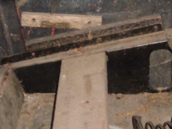

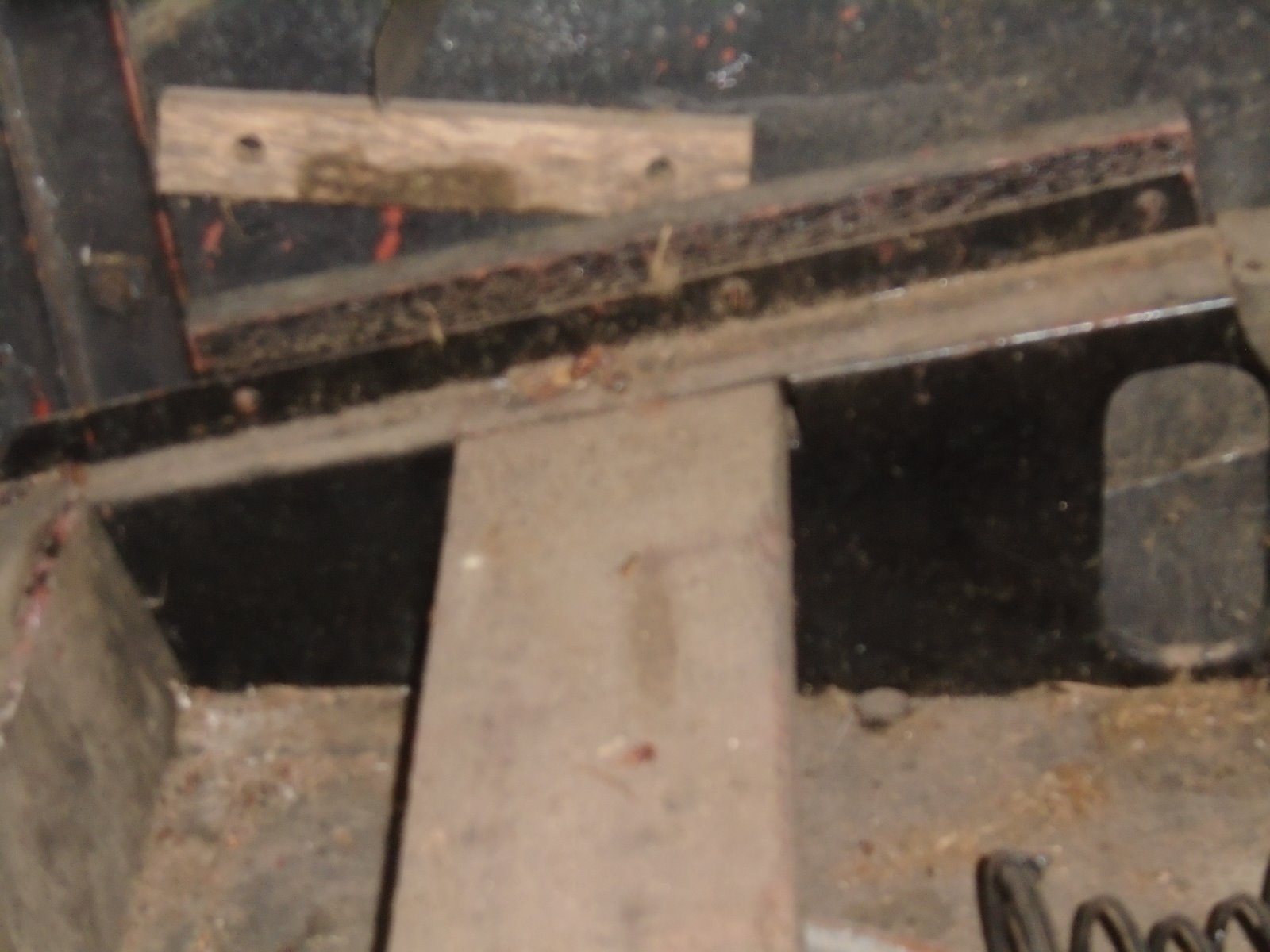

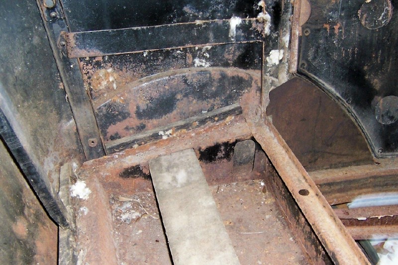

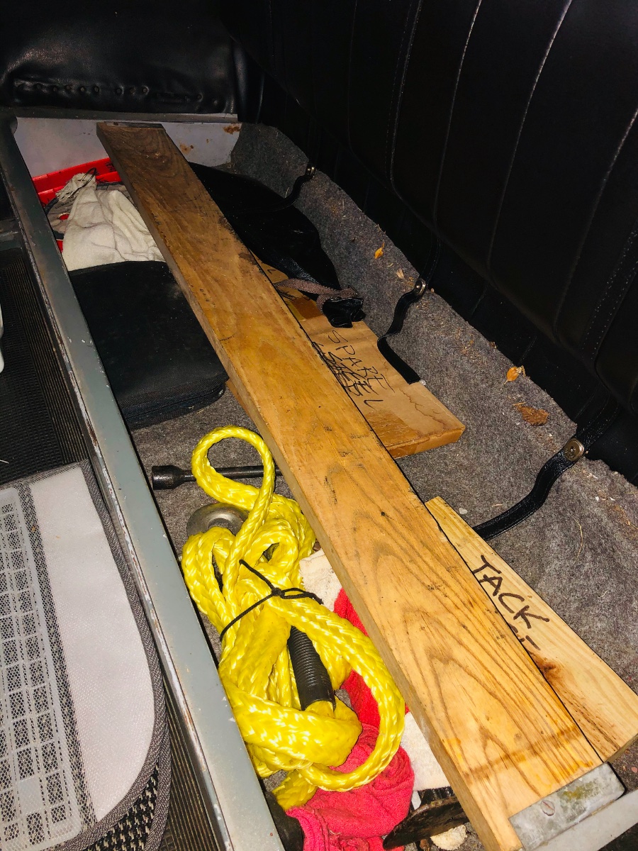

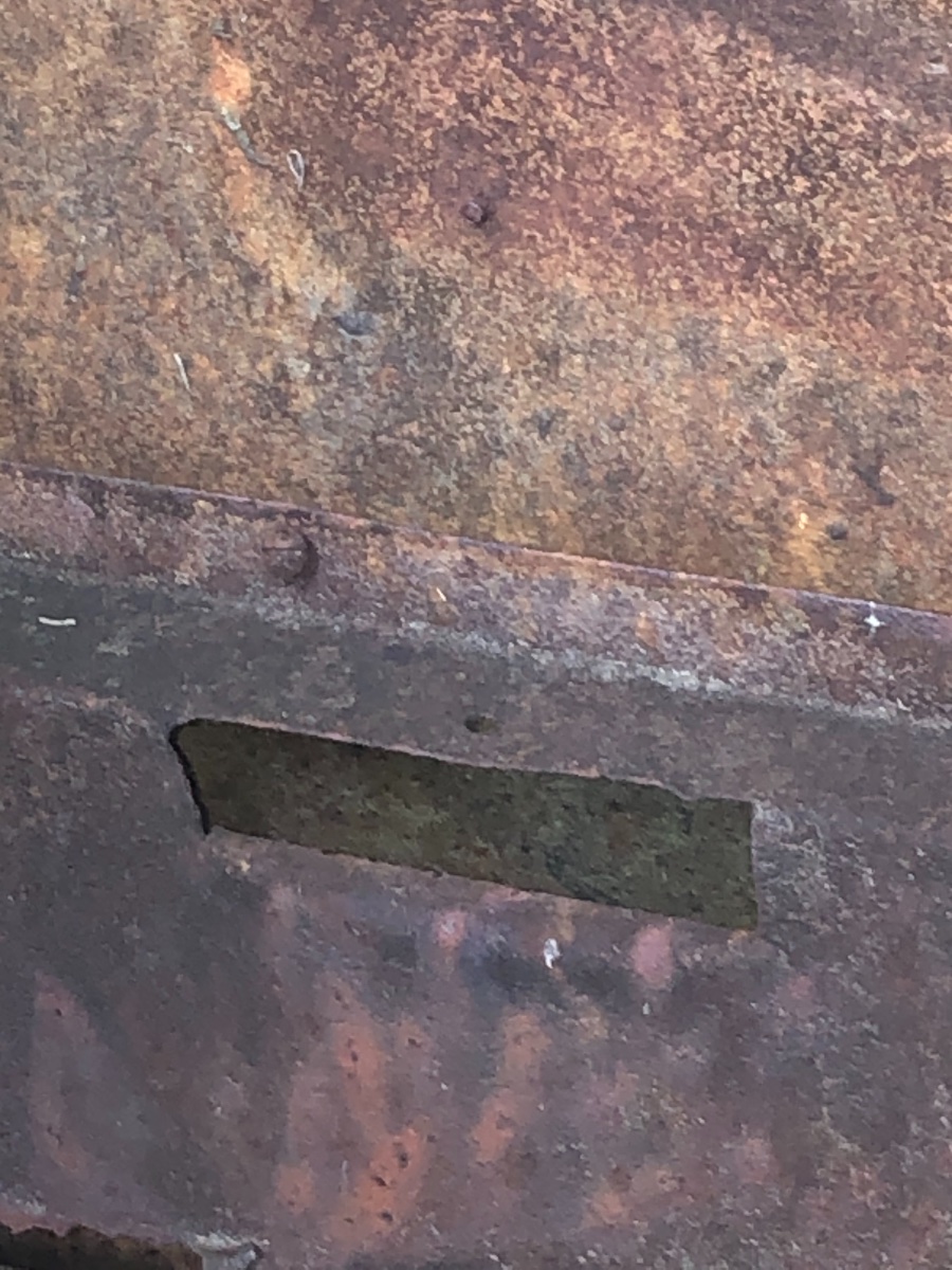

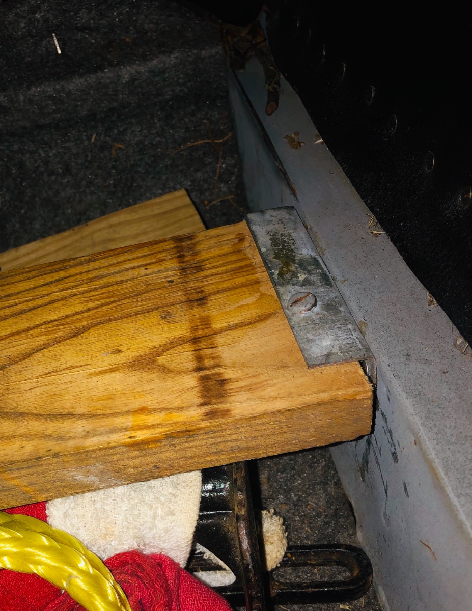

Here is the '25 touring rear seat support board:
Original '25 , Board rides flat, horizontal surface. Side seat riser panel has slot for board, and a wood screw from the top secures it. (cardboard lining is original for keeping side curtains nice or keep tool roll rattles away.)
1927 touring:
Original '27, the seat riser panel has slot to fit the board, and note the hole, single hole for a screw to fasten the board to the riser.
1927 touring, with replacement Howells seat riser panel, no slot, so you make some way to fasten the horizontal board
1927 touring:

My 1925 touring body rear seat area currently looks like Dan's pictures, a single 3/4 inch thick board that fits into slots in the sides of the seat pan and is held with a single slotted wood screw on each side. The board is placed so that it will provide support for the seat bottom springs. It is shown in the Fordwood picture for '23-'25 touring car wood.
http://fordwood.com/images/tour23new.jpg
My interest in this thread centered around whether there was a more substantial cover under the springs, one that covered the whole seat pan opening. For the '23-'25 cars, apparently not, the single 3/4 inch thick board is it.

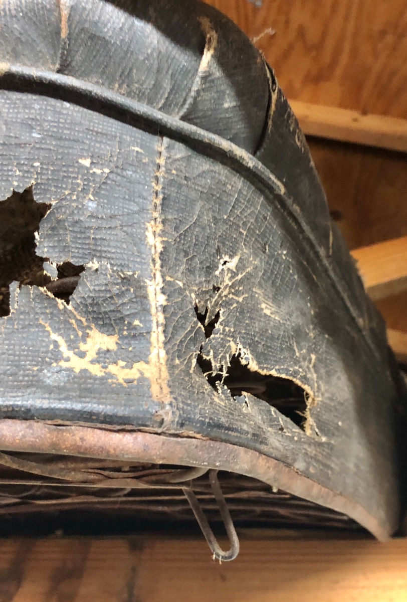

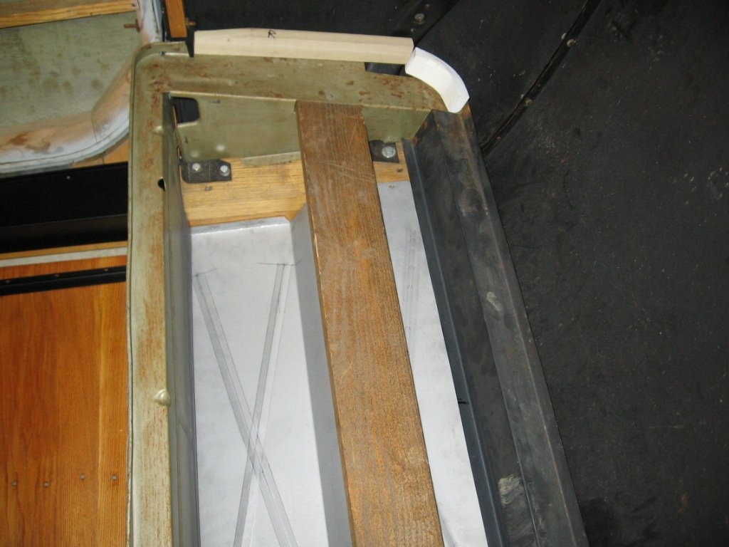

I think you have your answer but here is what my 26 looks like. In my earlier post I mentioned two additional boards but I had fabricated a temporary seat for a wedding. I don't know what the large hole is for in the seat frame?
- Posts: 4084
Re: Board under Rear Seat.
David
Believe those pair of holes on the front edge of the seat rest frame are retention holes.
The open cars, at least from '23 have those pair of holes in the front and rear seat risers, the original seat springs have two prongs that wedge into those large holes, keeps the seat in place.
Reproduction seat spring bases for these later T's don't have that feature, so you have to rely on butts to hold them down
, or remove those seat spring cushions when open trailering to keep from loosing them
Note the spring steel prong on underside front edge of original seat cushion.
Those 2 holes on front riser of a '23 touring.
