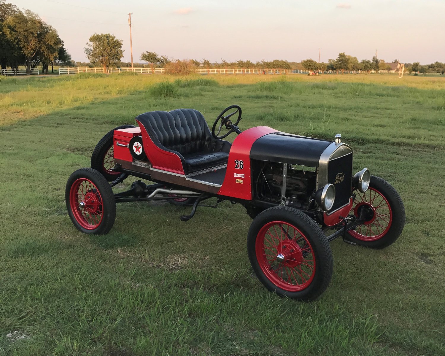

A coincedence you mention the Z head. I have a '27 Speedster (has a Ford script head - someone must have changed it before I got the car) and have actually been thinking about installing one, but have all but talked myself out of it since I'm not sure how robust the bottom end is and sure don't want to hazzard breaking a crank.

I have no idea about the true condition of my engine since I traded another Model T for it a couple of years ago. When first got the car, I noticed a very slight little knock - in my estimation not enough to be concerned about, so I removed all the shims from the rod caps and installed dippers while I was there for insurance. It sounds better, but not completely gone. It starts and runs very well and provides free starts regularly. Since it's a speedster, it's very light (no body, fenders, splash aprons, or running boards) and I've clocked 50 mph without the benefit of any auxilliary gearing. Taking all that into account, would you still recommend installing a Z head? Besides increased speed and more power for climbing hills, are there any other benefits of running one?
