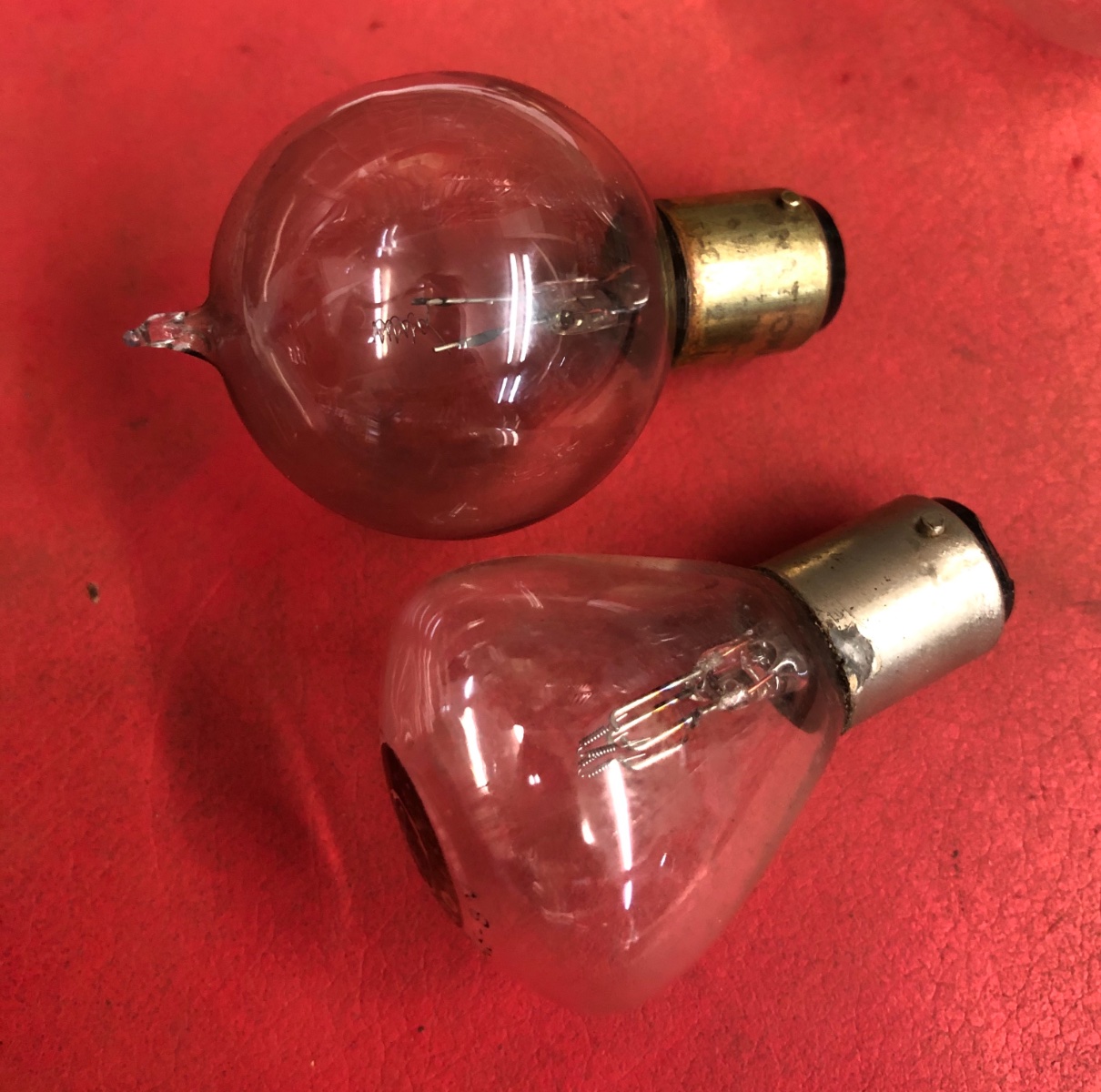

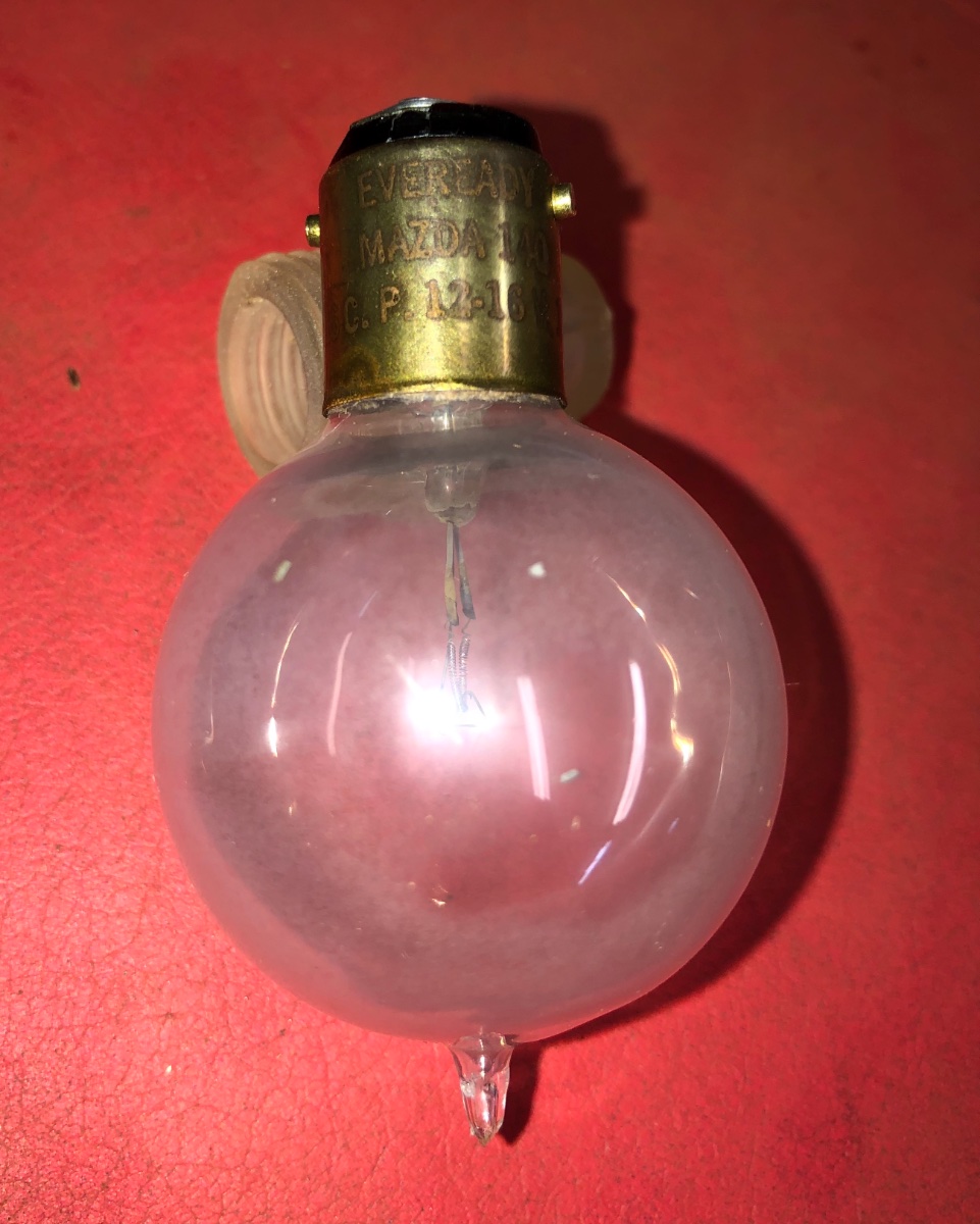

And here's one of those original Mazda 2 contact terminal magneto bulbs. These are single CP, this one 16 c.p. , 12-16v.
And comparison with typical electric 2 contact terminal bulb, these are usually dual filament, so CP on the lower one is 21c.p and 2c.p.
The electric DC bulbs are normally sporting a solder point at the top of the brass base, indicating the base is the ground.
As John posted, most of the magneto bulbs got too much AC from the magneto, and look browned out and blown, just like the one in top of photo

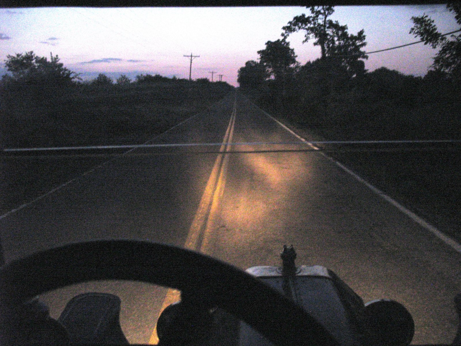

If you intend to drive at night with magneto bulbs you ought to limit your travel to the length of your driveway!
I agree with John on that, with an exception. If you're in a city or town where there are street lights to help out, it's OK. But I have also driven by mag lights on an unfamiliar country road. Once. I will not do that again. It's just too scary and dangerous. I almost wrecked. For the lights to get bright enough to be of any use, you have to be going fast enough to outrun them.
I have found that the 6-8 v bulbs last better than I expected, perhaps because I don't do much night driving. But I do carry at least half a dozen spares, just in case.
I wouldn't have done this without a bit of early morning daylight.
- Posts: 5545
Re: 1915 single contact headlights
Re brightness of mag lights; That fits what I have read. When they came to a corner they would shift into low and rev the engine up so they could see, of course not too high so as not to burn the bulbs out.
