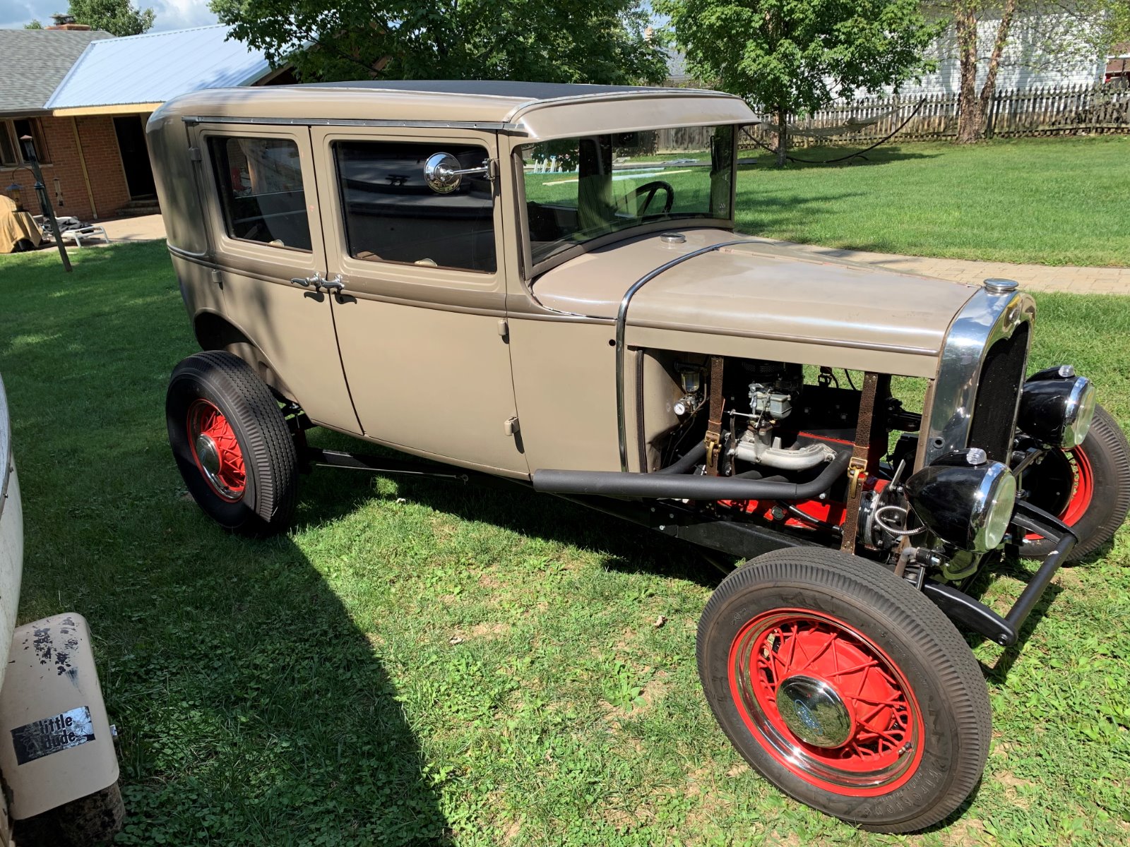

so here is my driveshaft style header on my fordor. There was a fellow making these on the HAMB forum, but he quit the header business. I am building the race style body speedster using Dave Currier's body. I haven't decided which way to go with the exhaust yet. Good timing for this thread.

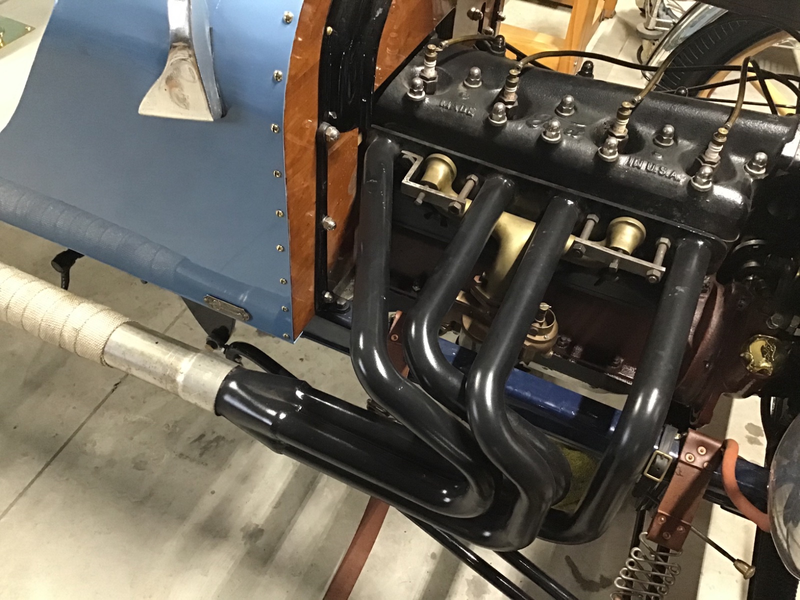

Ideas from one I build for Dave Carnahan's Speedster!
Hope this Helps Danny!
Hank
Hank

I like that Hank
If u wanted to tuck it under the hood Looks like a tight fit

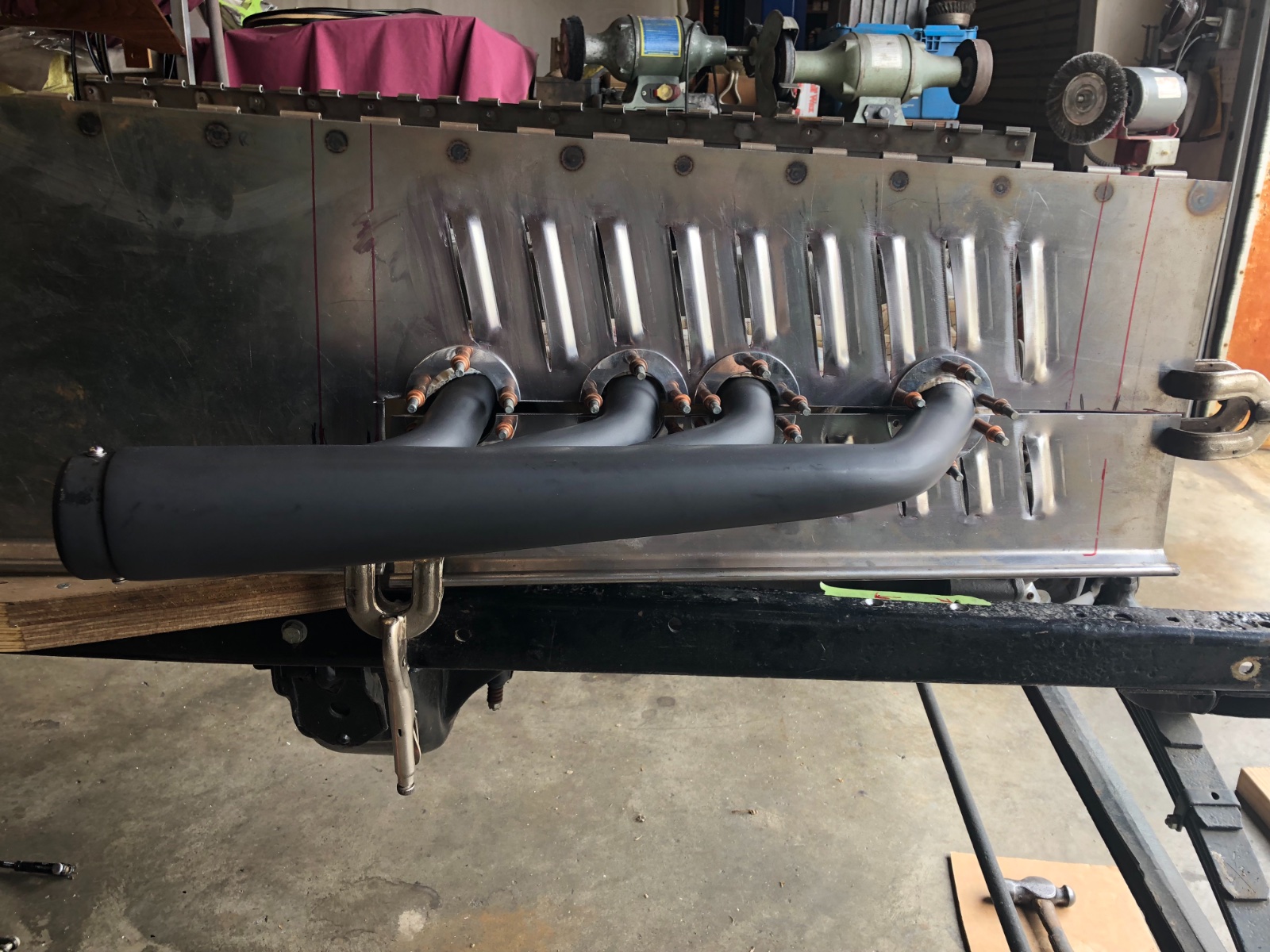

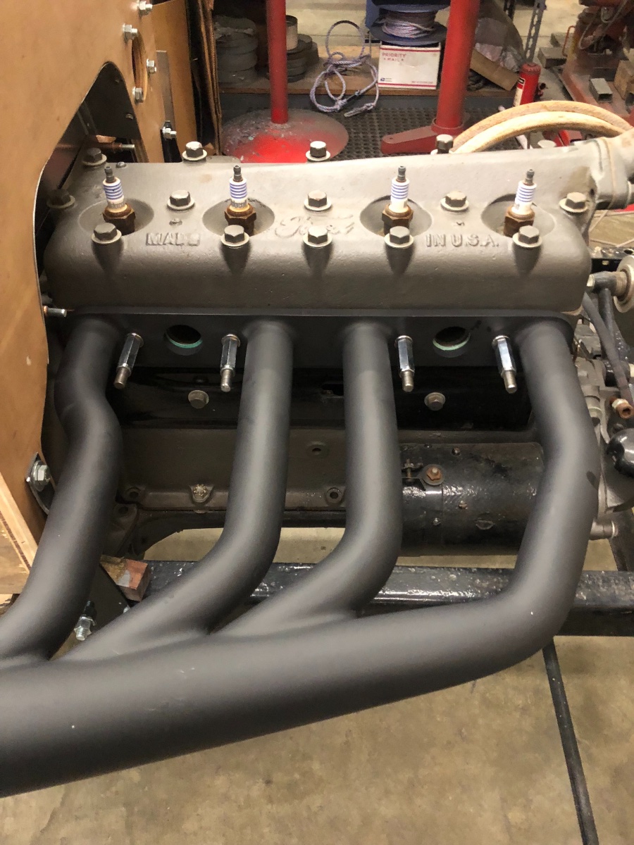

Here is my home made 32inch equal length.

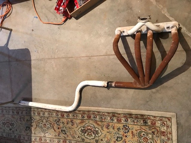

From the WTB post
Kim, I have a header that came off a Model T speedster project that I sold.
Kim, found how to post photos. See attached header.
Hope you are another party can use it.
George Unprr@cox.net

Peter, I love the look of your header. I was wanting to run mine under the body in a somewhat original path. Your header would also work for me as it could run under the passenger side splash apron. I have functioning doors on my roadsters tub that I am using as part of my "speedster" project.
