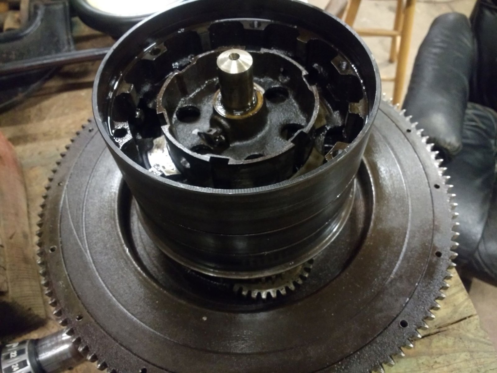

After finding a piece of lug shoe stuck to my magnets, I broke down the transmission to get a look. Sure enough, 1 shoe gone and all but 1 damaged in some fashion. I noticed while spinning the hubs to get a look at the gears, with the assembly sitting in the position shown in the pic, the reverse drum would brush the gears creating a soft scraping sound. So I grabbed the whole drum assembly and gave it a wiggle and it has some slop. If I deflect it in one direction, the gear set below also deflects out of its plane. I can do this around the drums to each gear set. Is it normal to have this type of "slop" in this orientation and at this level of disassembly? Or do I need to keep going?

It appears the transmission / flywheel is not bolted to a crankshaft. If so, there is nothing holding the trans main shaft in alignment and positioned properly with the flywheel, so yes it normal.

Richard- bolting on the driven plate will do nothing to stop the man shaft flange from flopping around in the flywheel.

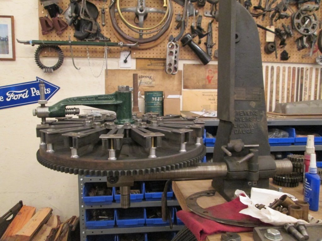

I had a flywheel mandrel machined for doing transmission assembly & setting the magnets.
