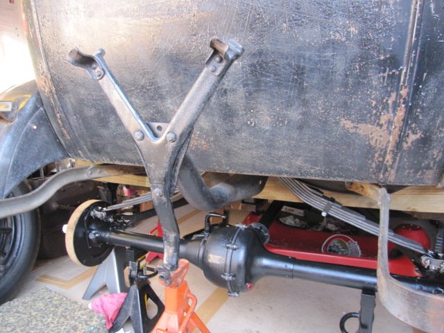

On my 27 fordor the spare tire carrier wheel mounting plate is bent in slightly at the bottom I am thinking it should be flat.

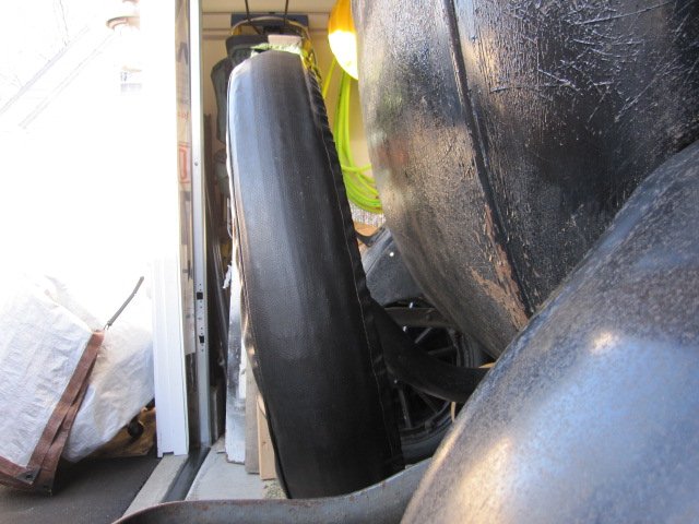

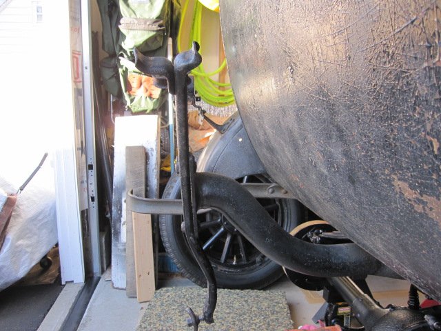

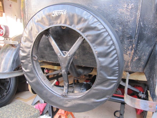

Steven here are some pictures of my 26 fordor rear carrier with and with out the spare, hope it helps. If you need any more pictures I can post them for you.
