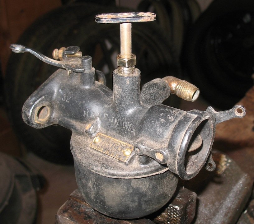

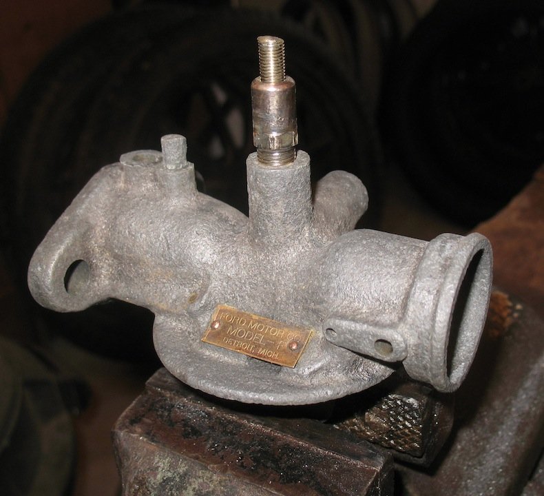

Re: Ford NH vs Holley NH Differences
OK How about the Ford F carburetor?
That's the name used on Ford's version of the NH.
Other than the tag, the only difference I noticed is 32 and MADE IN USA on the Holley version.

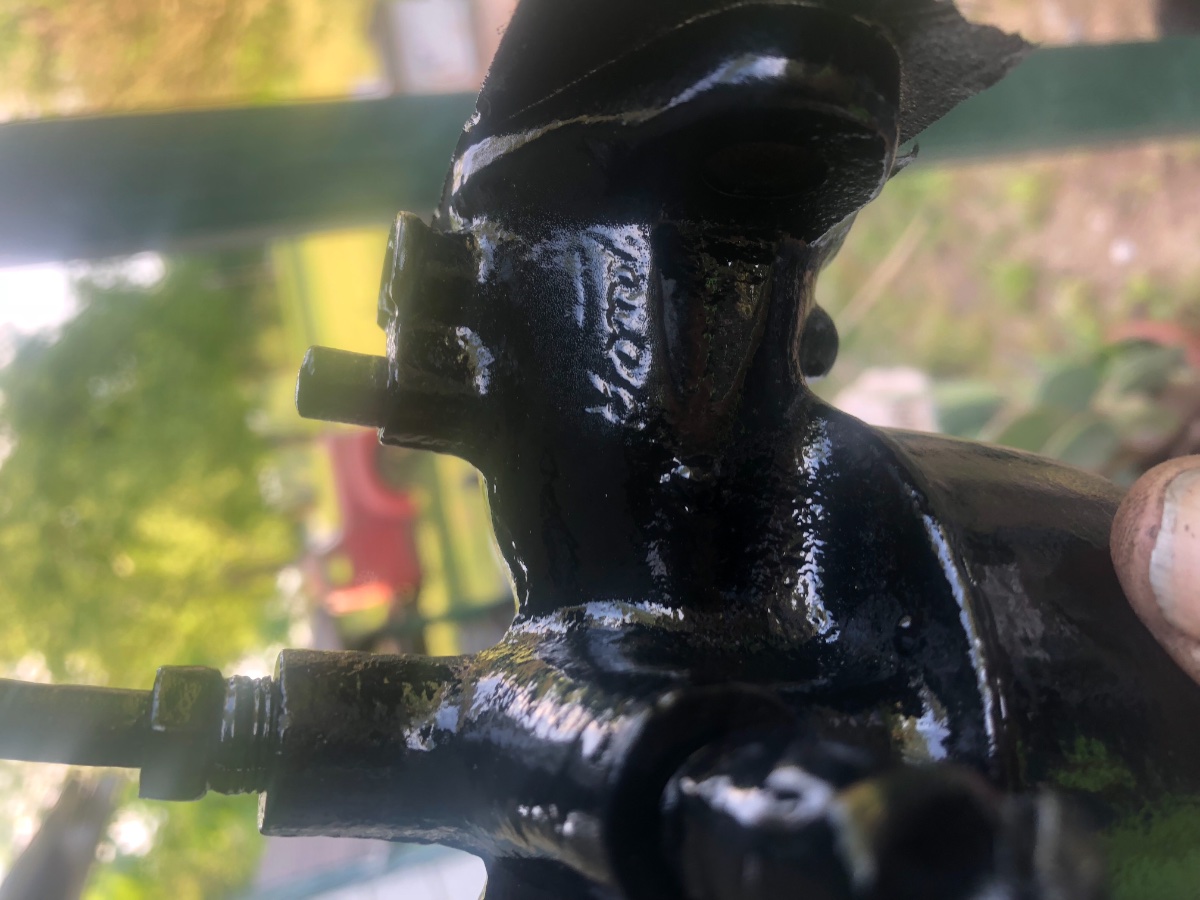

I was working on this one today. It has the screw in vent like the early straight through NH’s and no data plate. It has Ford cast into the body, but is a swayback with the offset drain and long throttle and choke arms. Maybe it’s a transitional model.

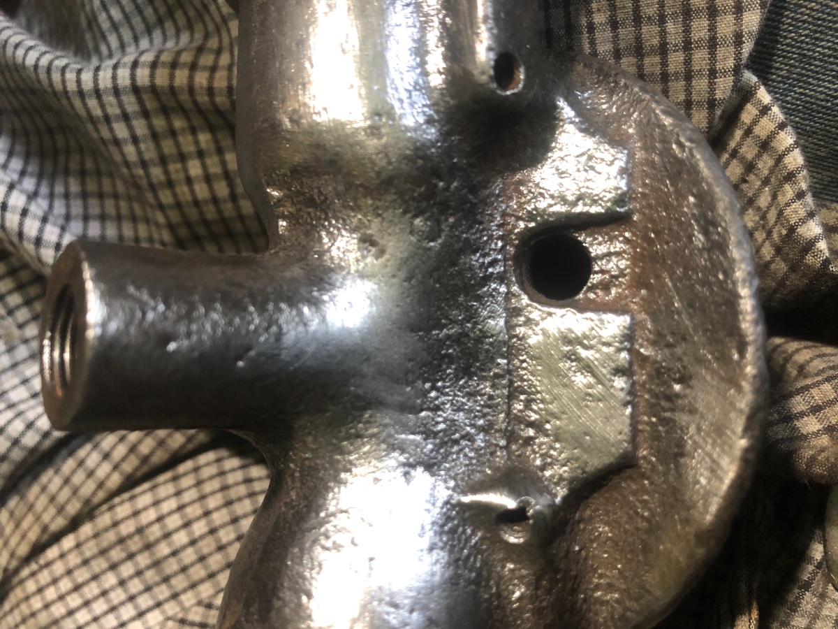

Re; "By the way, the early version of the Ford NH has a screw plug on the side the later version does not." Just reassembled one of those. It has Ford cast into it with no name plate.
