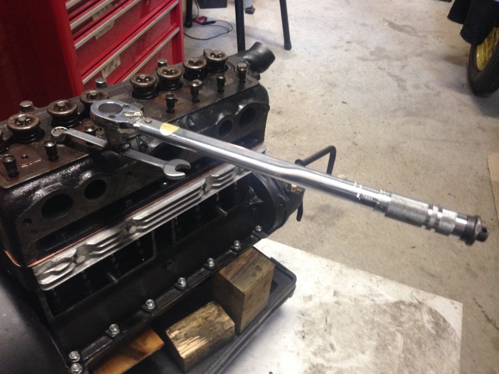

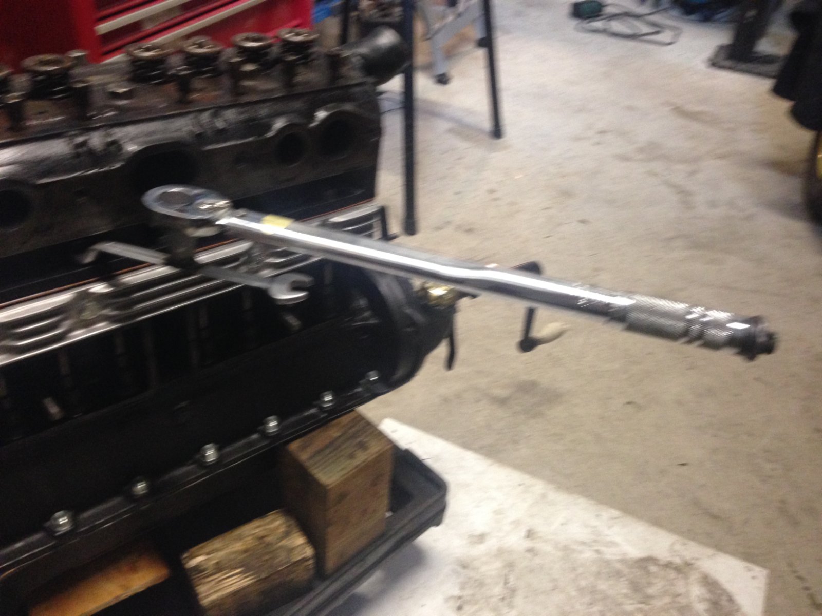

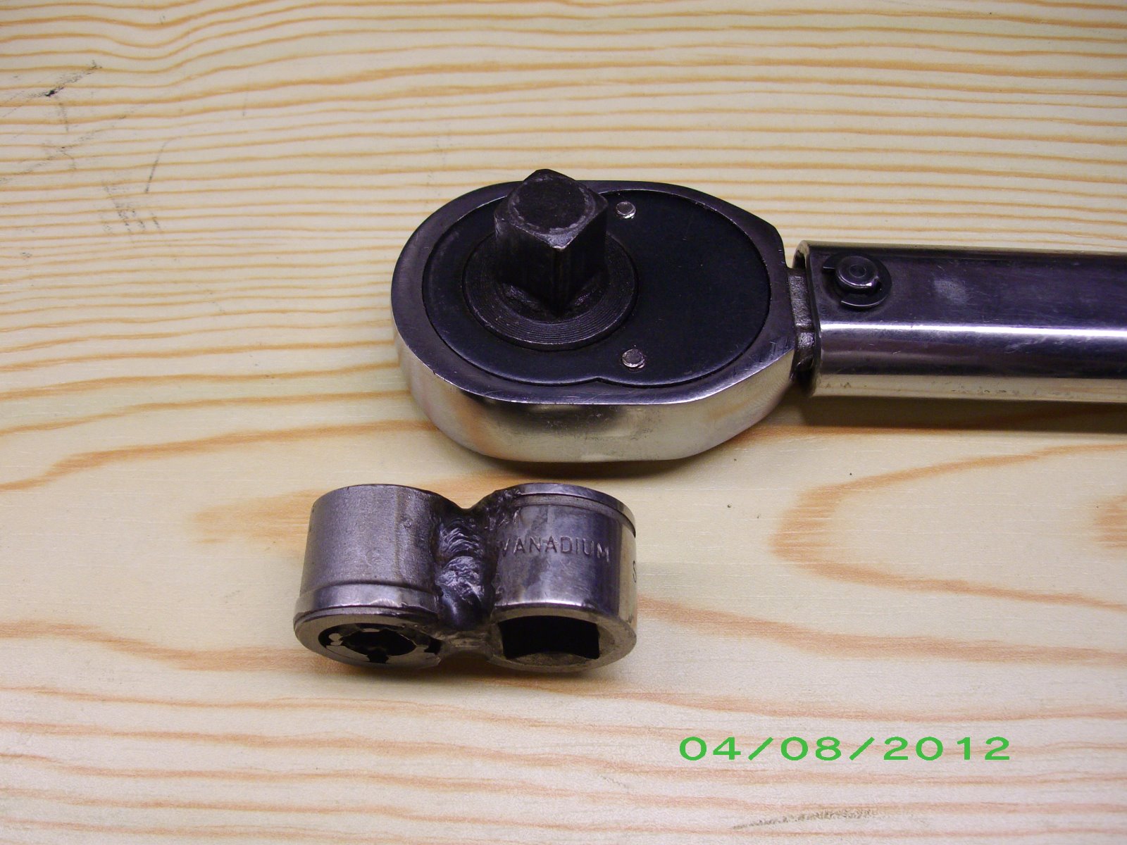

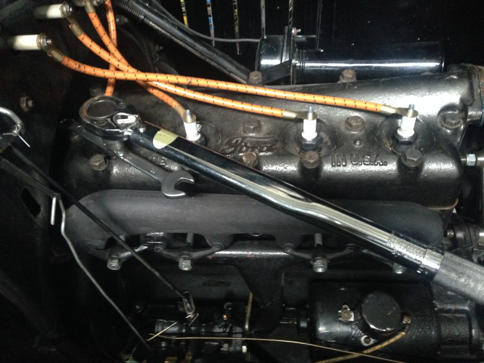

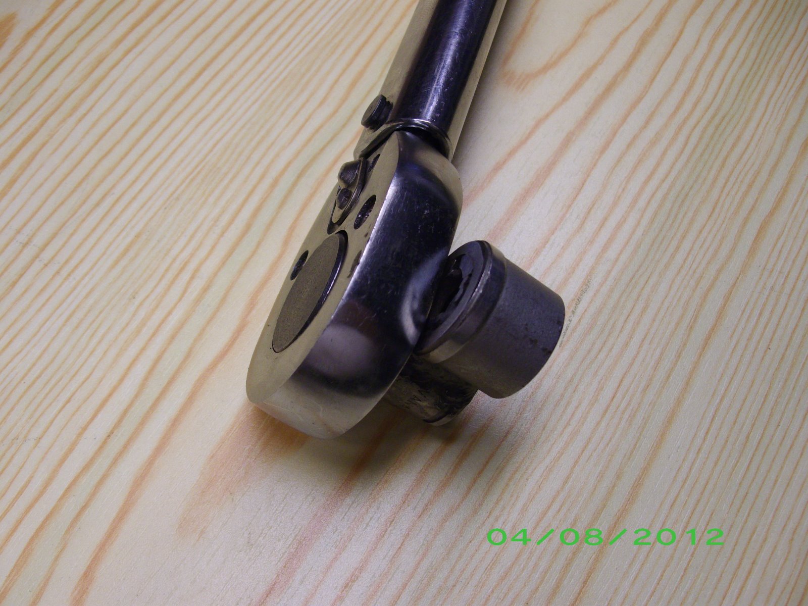

When the engine is installed or in other situations, it is a problem to use the torque wrench for example with cylinder head bolts. Here's a little tip:

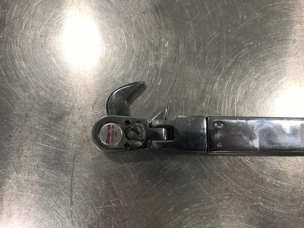

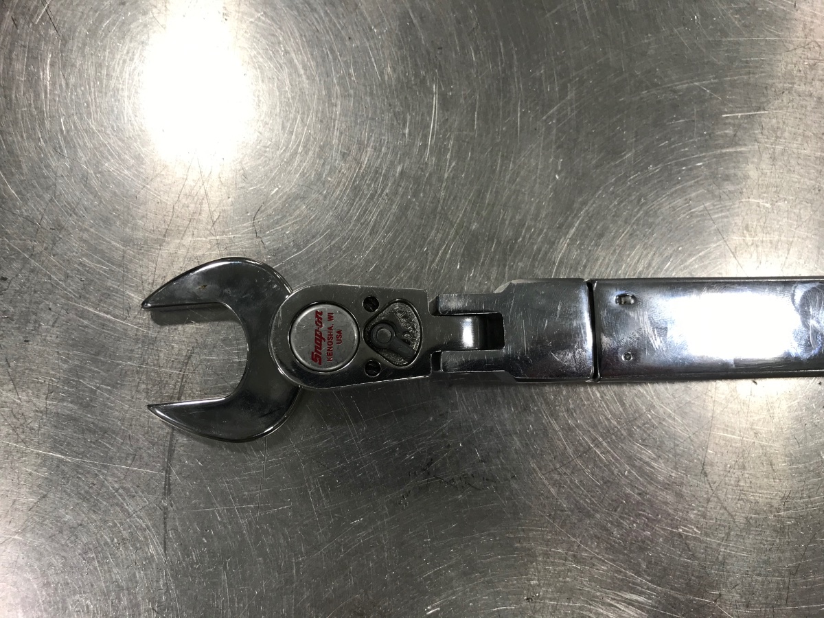

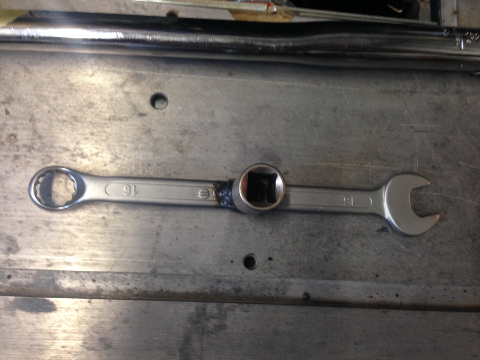

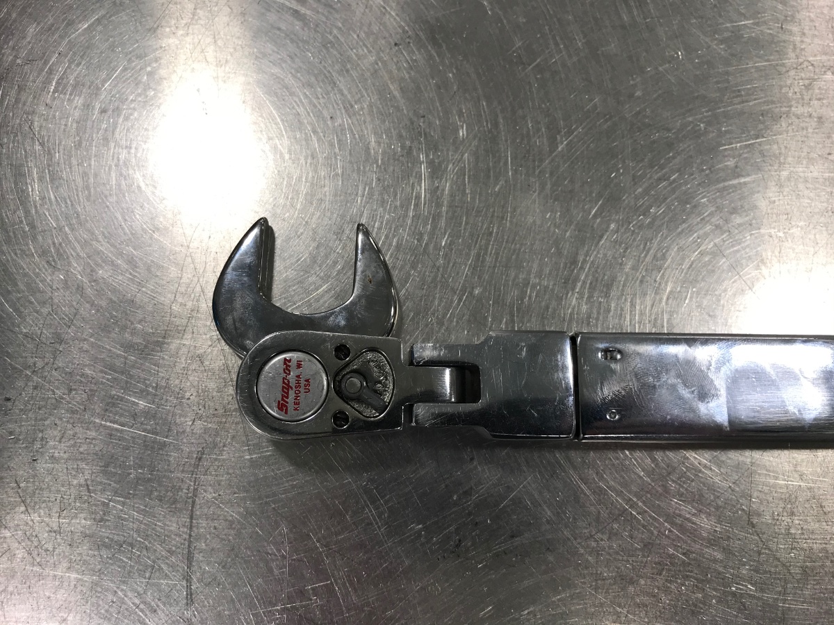

1. Tighten an easily accessible screw with the desired torque.
2. Use the torque wrench to readjust a ring / open-end wrench with welded-on pick-up on this screw (step by step, starting with a setting that is certainly smaller). Usually it is a few degrees less.
3. Now tighten the screws at the problem point with the same angle.
See the following photos:

Anton suggests' backing off the setting' to correct for the added length. I'd say this is fine for this application, and you note Anton is keeping the 'extension' in line with the torque wrench handle, doing so simplifies the correction calculation.
With the 'extension' in line with the handle as shown, correct the torque wrench setting by the ratio of original handle length to the extended handle length, original plus length of extension, measured center of bolt to pivot point in wrench handle. If the extension adds 10% length to the handle, back off the setting 10% and proceed. It ain't rocket science and it is a model T, drive careful everyone, jb

When using a crow’ foot or other adapters with a torque wrench, if you turn it 90 degrees from the handle of the wrench like this you don’t need to do any calculations.
If it is in this direction in relation to the handle, you need to calculate a lower torque setting since the adapter is adding more leverage.
If it is in this direction in relation to the handle, you need to calculate a higher torque setting since this direction is decreasing your leverage.
