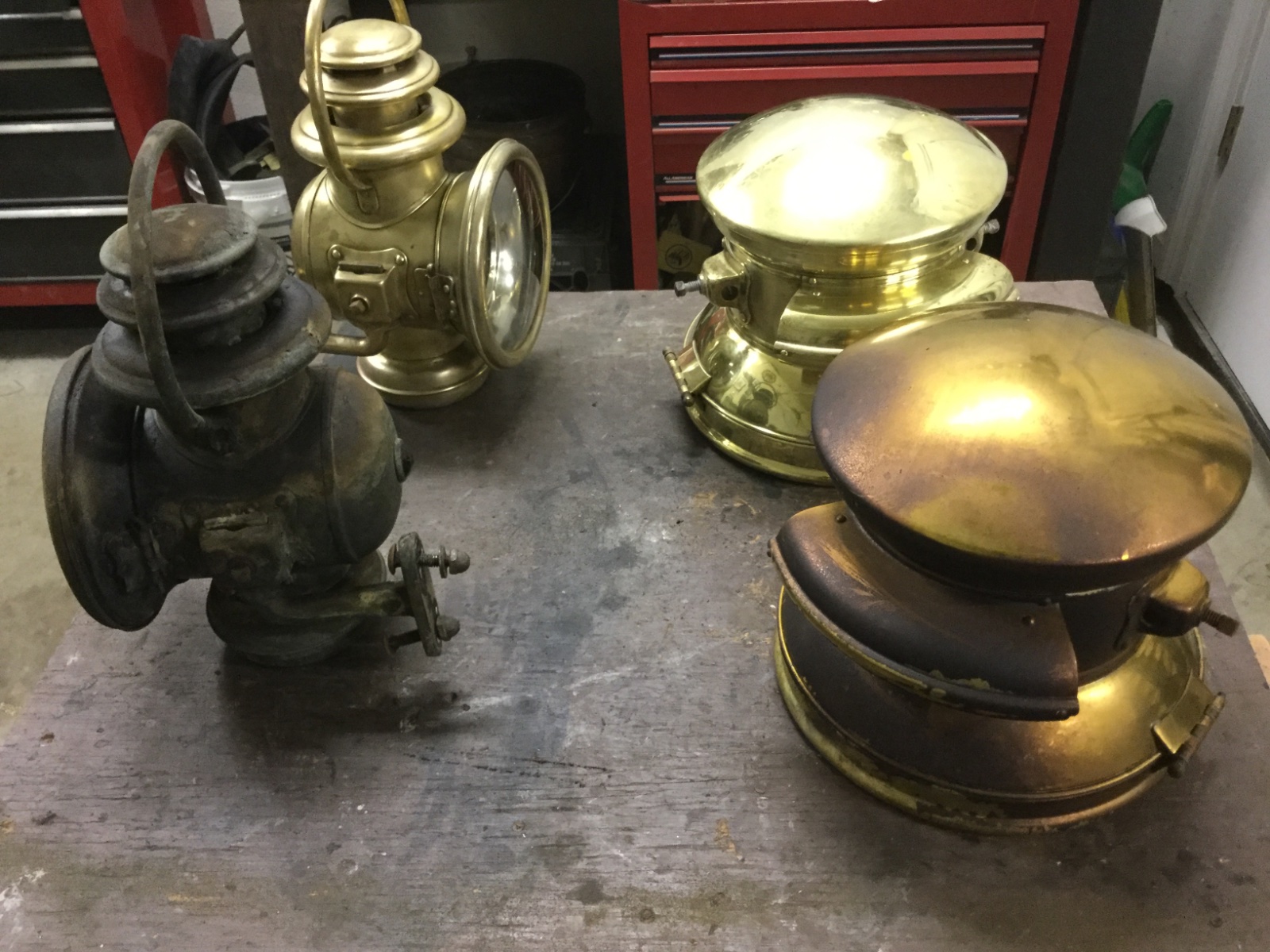

I soaked these in hot water over a period of several days. Then used a piece of wood and a finger nail to peal off lacquer coating.
It took awhile but the results was worth the effort.
