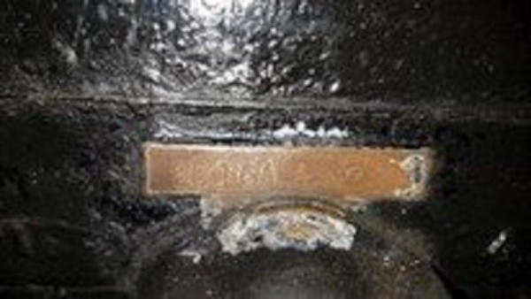

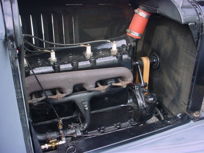

Hi Folks,
This is my first forum post. My name is Brian and I just imported a beautiful 1913 model T into the UK.
The number on the engine plate is 261644 which fits in with the age for May 1913, but unfortunately when I tried to register the car in the UK, our highways department called DVLA, sent out an inspector to see if the car was real. Therein starts the problem. The engine plate is stamped 261644 but about I/2 an inch to the right there is a no 9 stamped. The stamp is slightly out of line with the main stamp but the inspector insisted it is part of the number and recorded it as 2616449. The California Title document only has the first 261644 so now the DVLA will not make a UK title unless I can prove the car is 1913 and explain the extra number.
Can anyone help?
Cheers....Brian
Can anyone help?
Cheers....Brian

Brian, welcome to the affliction, and to the forum ! I have a 1913 runabout, would love to see some photos of your new "import".
Perhaps a photo of the engine number and the offending "9" could help forum members offer some explanations, but would the rigid inspector you encountered accept opinions from across the pond ? Is there any chance of appealing this fellow's rather unreasonable insistence ? Would the inspector bow to "expert" assessments that the car is indeed a 1913 model ? Documentation that the engine serial number (without the 9) is indeed May, 1913, is easy enough to come by, one would think the California title document would suffice. Dontcha just love bureaucrats ??

I gather that "engine plate" means the flat area machined on the side of the engine above the water inlet. That's where the engine serial number is located after the very early cars.
There are glaring differences between a car made in May of 1913 and one made in April of 1918, which would be the date indicated by the extra digit. Your inspector is probably unschooled on century-old cars, and will need to be shown that this car is really a 1913 and can't possibly be a 1918. Bruce McCalley's Model T Encyclopedia details the changing features by year and includes pictures. I would start with the serial number section and show that the six digit number indicates May 2, 1913, and that adding the extra digit would make it April 4, 1918. Then show the pictures and descriptions of the same features for the two different cars. You shouldn't have to go far beyond the radiator.

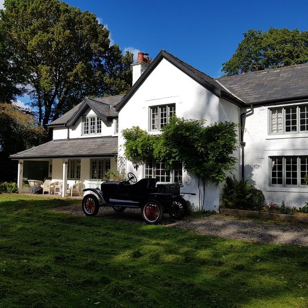

my house is a bit older 1632

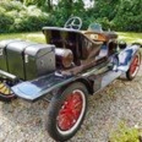

Hmm. Appears to be a "bitsa" T, mostly '20s from the look of the sheet metal. Now it becomes problematic whether the later radiator and sheet metal have been hung on an earlier chassis. I can't see the motor number well enough to comment. Thanks for the photos. Looks like it will be a fun car !

That doesn't appear to be a factory stamping, at least from the low resolution picture you sent. I can see part of the casting date at the right side of the picture, a 4, meaning April.

It's impossible to read the number or discern much of anything from the miniature images, but I suspect this car may be a parts salad. If you post some full sized pictures maybe we can tell you about it.

Sorry to say, there is not much 1913 there. Like others, I cannot see enough detail in the low resolution image of the serial number. However, I do know the series of changes in the shape of the serial number embossment to know the block is not any earlier than 1917. More likely, even much later. Does the front of the motor, on the other side, have mountings for a generator? Those mounting flat areas and bolt holes were added in 1919, whereas all the earlier blocks had a cast-en-block cover around the side and back of the timing gear. Again, photos of the other side would help there.
What I can see in the serial number photo suggests that the serial number on the block may well be one stamped on after the block left the factory. The block was probably a replacement for a damaged block many years ago. Does it have a single long cover over the sides of the valves? Or two short covers?
More and higher resolution pictures of the engine and car can help us to identify what you have.

Looks like it has a black radiator which would be 1918 up.

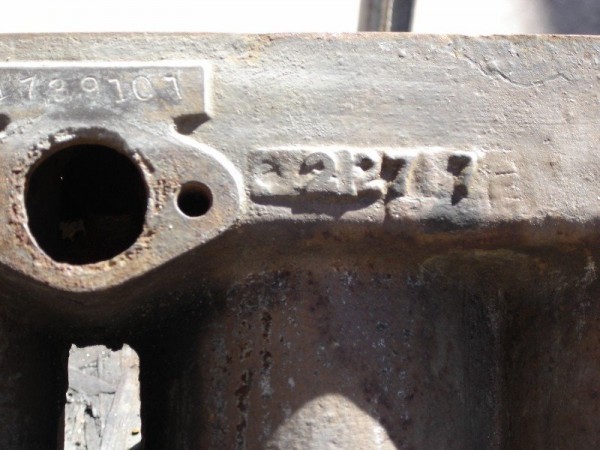

Brian
Nice T! Like the speedster look. As Wayne noted the serial # boss on the block grew in size over the years, an early block would have a much smaller length boss, below is a 1914 serial number on a 1914 genuine block.
And a later block compared to your photo, enlarged slightly.

My wife has followed my T model affliction from before we were married in 1969. When I showed her the photo of the car in front of the house, her comment was, "That's no more 1913 than I am!"
The inclusion of the 9 at the end of the engine number would be consistent with the April 1918 date given by Steve, The black radiator and hood, the front fenders and the engine no. with the 9 included all indicate this. It would be interesting to know when/how the California title was generated, to throw some light on the history of the car. The date on the title is a misrepresentation of the facts, either through ignorance or deliberate action. In this case, the British bureaucrat appears to have got it right, and the Californian counterpart had it way wrong.
Either way Brian, it looks to be a nice car and you should have a lot of fun with it. I just hope you didn't pay a premium price expecting a brass radiator veteran.

Here is my enlargement using Microsoft Paint.
Really like this one, racy looking

1913 did not have a boss that long for the engine number, therefore your engine is not a 1913. As mentioned above, what is the casting date, or has it been removed?

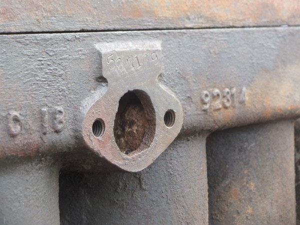

This is what your engine should look like
- Posts: 7279
Re: Model T 1913 Help with engine number
John, if you are thinking Brian has an 18 model as suggested, then your picture is about right, although the NH carb is out of place. If you are suggesting a 1913 should look like your photo, then there is way more out of place. Can you fill us in? Anyone new to T's will be confused.

I hope you weren't taken advantage of when you bought that car. There is nothing 1913 on it or anything else. I hope you enjoy it though.

Lacking any good pictures of the car we don't know in detail what's on it and in it, but the little photos posted so far suggest a parts salad mostly from the late teens and twenties. I hope I'm wrong.

Allan you are right, this photo of the right hand side of an early engine would be very similar to what he should have with that serial number. It is what I could find that had two valve covers and no generator mount. Yes carb, manifold radiator etc is wrong. It sure sounds like it is NOT a 13. Thanks.
