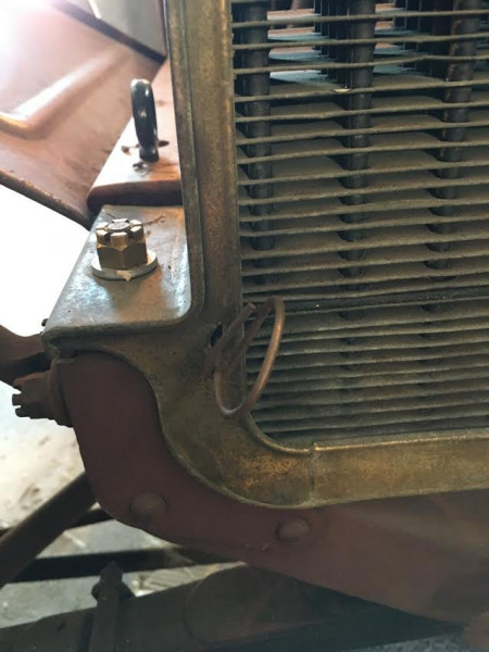

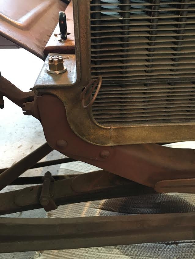

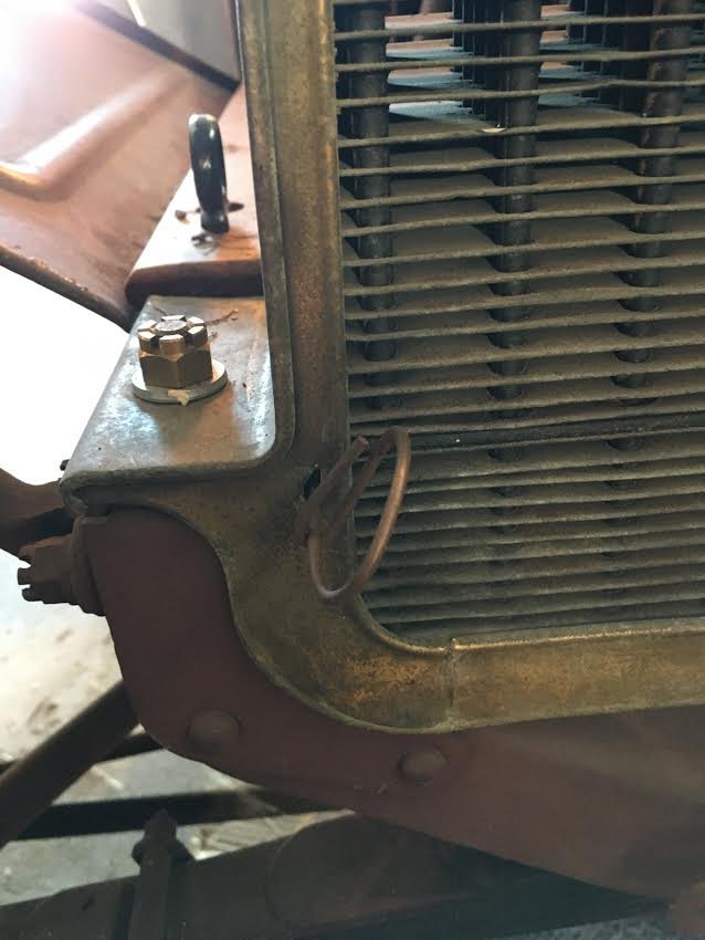

If you get a chance, take a photo of where the priming wire comes out. I posted this question a few days ago. I think Ford may have relocated the hole in 1915 slightly.

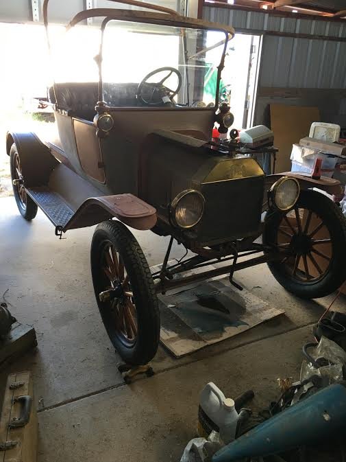

Hi Larry
Here are a couple of pictures.
I am not sure that it is a 15 radiator.
When I bought the car there was a discussion here and I not sure what the conclusion was.
