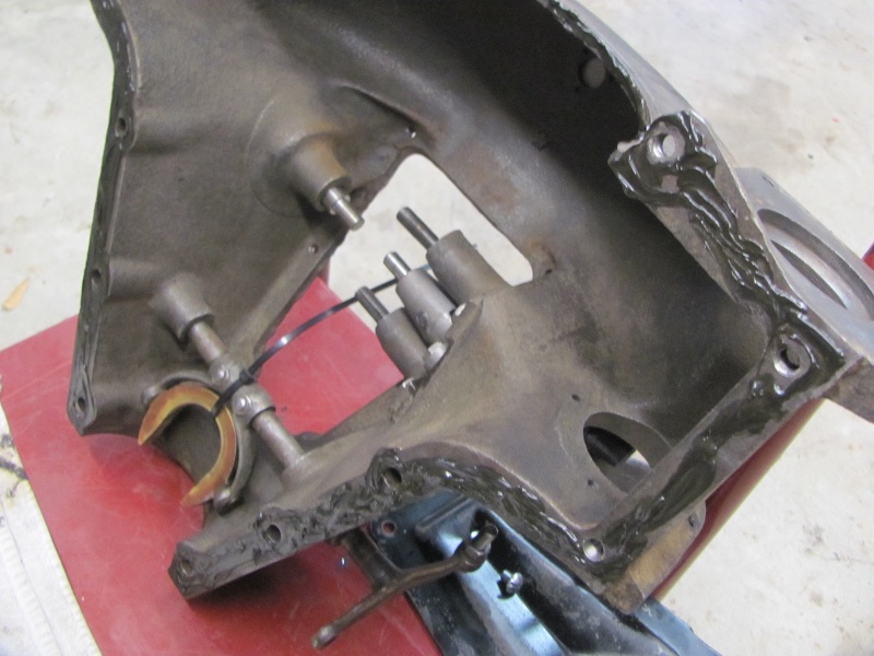

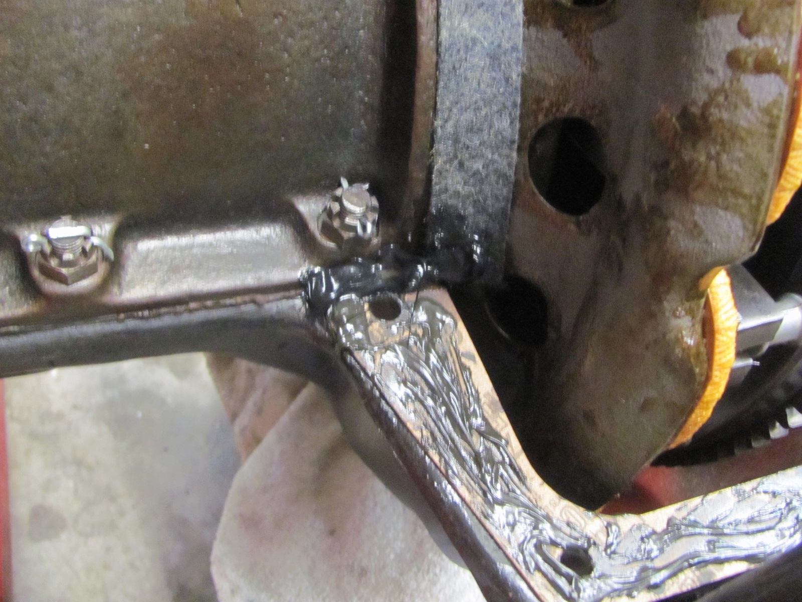

Same here, have used varnish soaked felt over the hogshead block curvature for decades. You won't want to place Model T felts anywhere on the T without grease or sealant packed into the felt fibers, a dry felt isn't desired. It can't compress and do the job of a felt seal.
Here is hogshead prepped for placement, the soaked and partial dry felt is lying over the block curvature, placed there earlier.
Note the Pematex 2 on metal surfaces, and a bead of it over the hogshead curve.
Now the gaskets are trimmed at the corner junction to fit flush, take care there.
Then the crankcase is fitted with gasket, with Permatex on the metal, so the gasket is sealed to it. And the pre-soaked felt lying in wait. The only place I use RTV is in the corner, that modern stuff replaces the "candlestick wax" piece of Ford instruction. That corner is the place where a leak can happen, the intersection of 3 metal surfaces.
As for removal later, there isn't a reason to not coat both mating metal parts with Permatex. That way the gasket is covered both sides, for resistance to leaks. Have removed many times this same way, with varnish soaked felt and Permatex on all surfaces. A quick lift with a tool and the hogshead separates fine.
