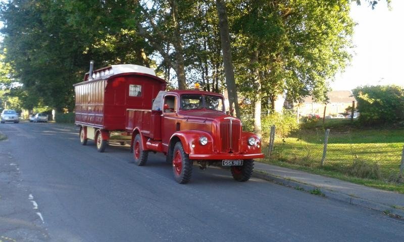

I have just received my paint from Craftmaster in the uk. They list Ford Model T black and the later colours. This is coach paint and can be applied by brush or spray. I have used it in the past. Please see the Morris Commercial and showman's wagon which were brush painted 10 years ago and still look good.
