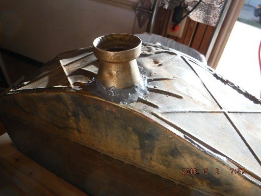

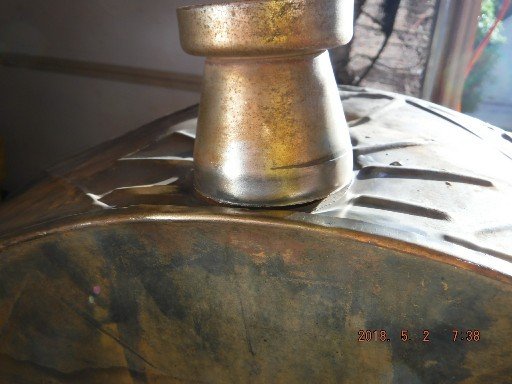

I have a steel radiator that had similar problem. The neck on my 24 separated on one side of my radiator. It's a well used radiator so as an experiment I used JB weld to re attach it. I cleaned the area with a rotary wire brush, some fine sand paper, and acetone. I also pre heated the metal a bit with a heat gun and used the heat gun to smooth the JB weld. It moves like peanut butter when warm. So far this has lasted with no problems. Probably would work with a brass radiator but not a show piece. I painted the radiator black after patching this and numerous other leaks.

JB weld does really work in most cases. Will work fine for a radiator repair. Make sure you clean the area well and let it set up a couple of days. It will be fine.
