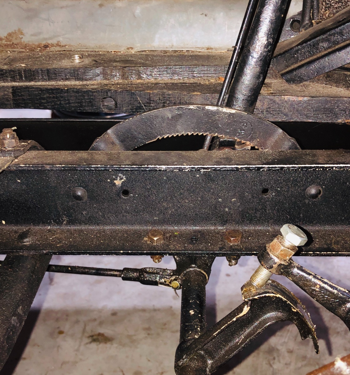

- Posts: 3904
Re: differences in 25 and earlier frames from a 26
1925 frames were used for one year only. They have the same brake quadrant as the 1926-7. Early 25 frames still had the four holes, but the inner two were not used.

- Posts: 4042
Looking over the frame on the 1925 Coupe, and sure enough, the frame has the 4 rivet holes for the quadrant, but only two are used with the later quadrant. Appears good teeth, but will see later, after removing the clutch/brake lever, as the pawl must be shot, the lever won't hold in position.

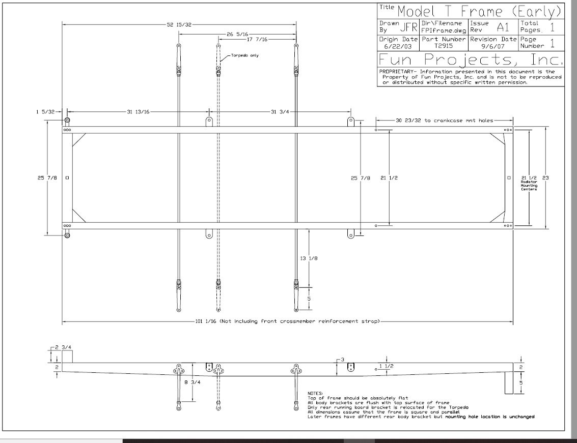

- Posts: 6541
self explanatory. Taken from a MTFCA discussion
- Screen shot 2019-06-30 at 8.17.41 PM.jpg (57.55 KiB) Viewed 6225 times
- Screen shot 2019-06-30 at 8.18.23 PM.jpg (40.94 KiB) Viewed 6225 times
- Posts: 6541
Dimensions
