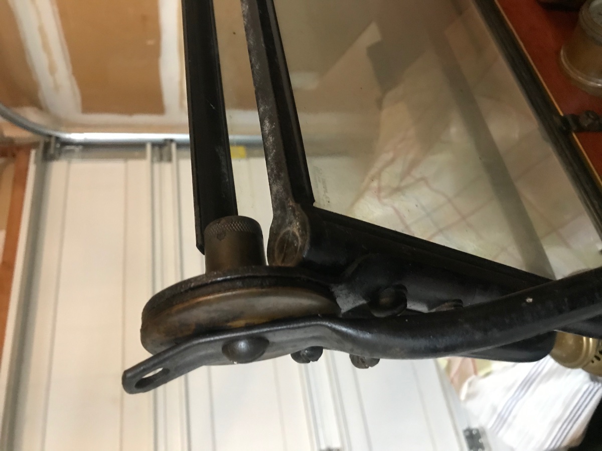

What I’ve learned trying to get the upper windshield frame to raise on my 1913 Ford Touring.
1) I am not too bright
2) I am not that smart
3) I don’t have any idea what I’m doing
I have repeatedly soaked the hinges with creeping oil.
I tried to turn the slotted bolts on the outside of the hinges on both sides of the car with no luck.
I tried to see if the brass cylinder on the interior side of each hinge would spin off but they seem to just turn with no result.
I don’t see any explanation in the shop manual or other pieces of original literature I have.
I will feel even worse if I am the first person in the history of the MTFCA to have this problem and not be able to figure it out.

I see "knurling" on the outer brass cylinder - did you attempt (with assistance) to hold the knurled part while turning the large slotted screw ?

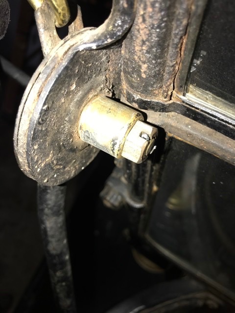

I just reread your post.
The brass cylinder will just pull off. It is just a cover. Inside you will find a nut and spring. You can loosen the nut to take pressure off the spring.
Here is a picture of mine with the cover off.

I was trying to spin that cover off.
Duh!
Thanks Ed!

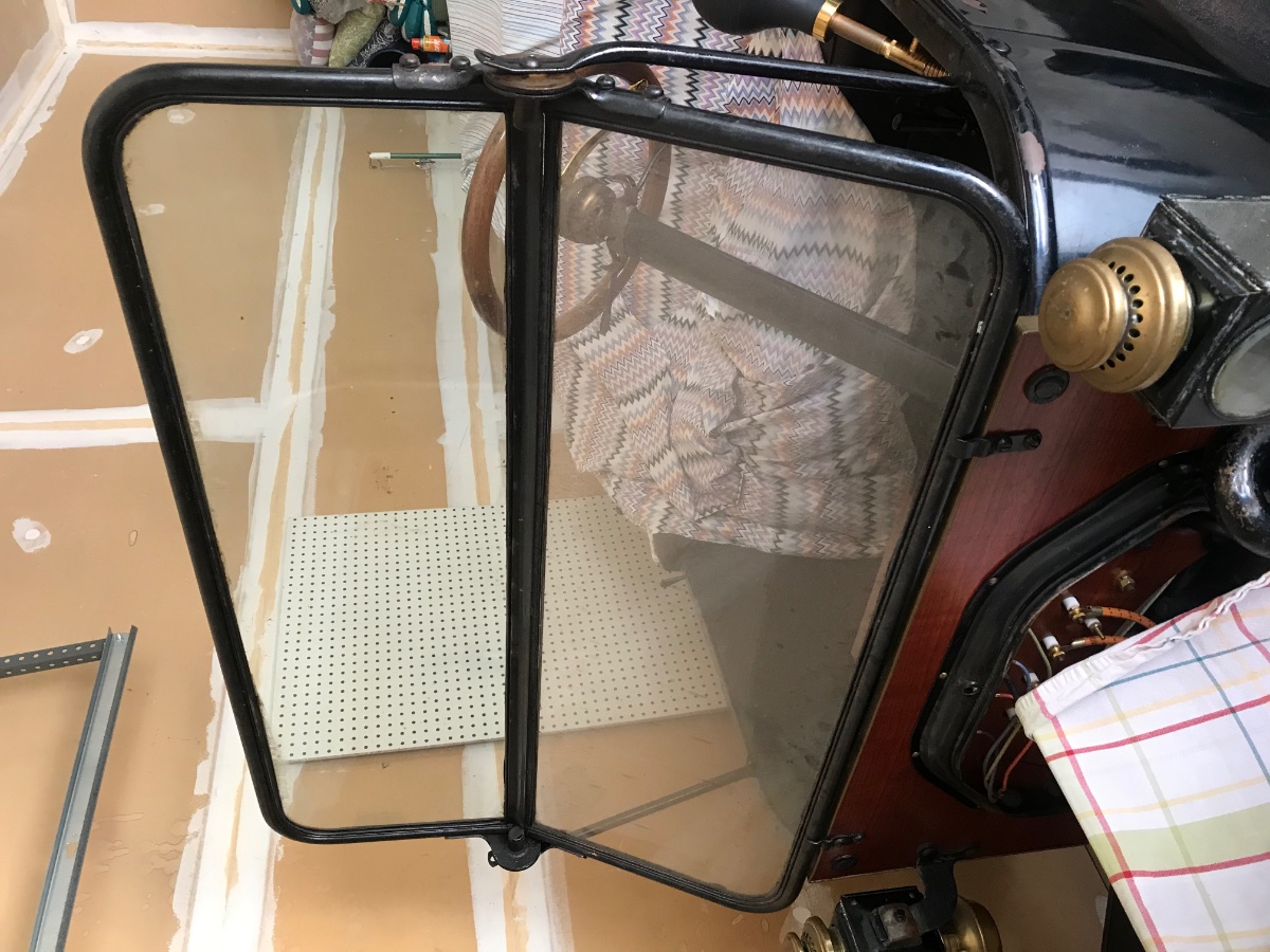

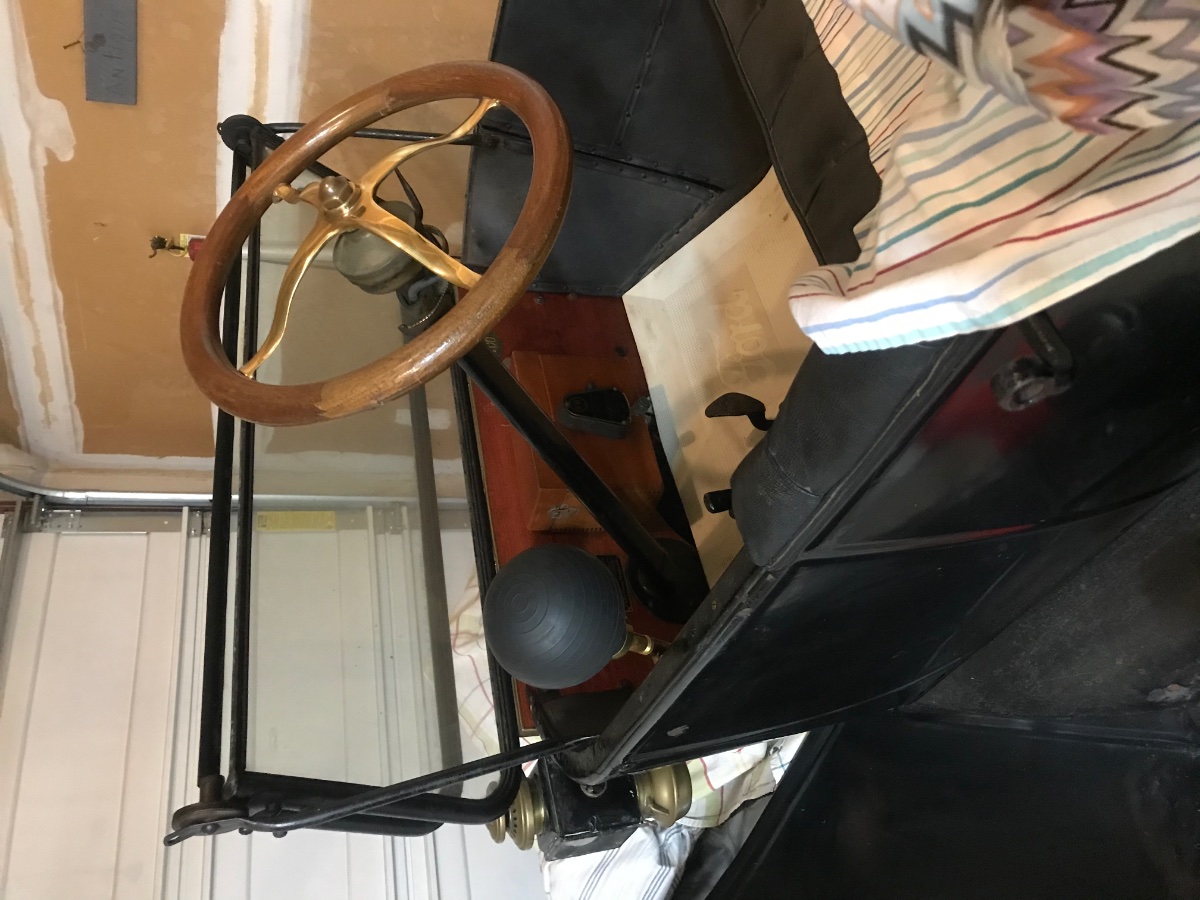

She has risen!
Alleluia, Alleluia
Thank you to everyone who helped with great suggestions.
Gene
Alleluia, Alleluia
Gene
Gene Emering
Newton, New Jersey
Newton, New Jersey
- Posts: 4624
Re: Windshield Woes Continue
Good deal! Looks like things did move after all. Did you have to loosen anything or just give it a little more ‘umphh’ to get it to move. Whatever you did it worked!
John,
Ed Fuller's post (above) enlightened me as to why the brass covers on the interior side of the hinge would not screw or turn off.
Answer - They're covers that just pull off revealing a nut that can be loosened.
A couple turns of the nut with a 19/32 wrench and we're now in business!
Thanks again MTFCA and everyone who posted.
