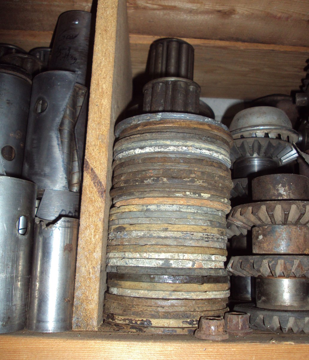

As I am sometimes a fly in the ointment and don't what anyone to have a catastrophic accident and I will encourage you to attend to this soon. However I will show you a stack of babbitt washers that survived thousands of miles without disintegration. That differential could go many more miles if there is not excessive end play in the axles or if the lubricating oil shows no sign of babbitt in it. How and where you drive the car could influence how urgent the rebuild is.
