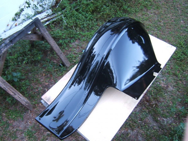

A decent paint job is 99% preparation (paint removal, rust removal, dent removal, bodywork, sanding, cleaning, priming, etc.) and 1% actual painting. With so much work involved, one should want to avoid using the cheapest alternative so that the necessity for having to do all that work again is kept to a minimum. The best rattle can paint I have found for painting small parts (and large parts as shown below), is Gloss Black Rustoleum appliance epoxy. It is sold at Home Depot. It goes on beautifully and if applied properly, will need no followup work, but if followup work (wet sanding and compounding) is necessary to remove runs, dust, or other imperfections and bring it to a mirror finish it will dress out just as nicely as the professional paint gun applied paint and, if after several years, it starts to oxidize, it only takes a few minutes of rubbing with Meguire's rubbing compound to bring it back to a mirror shine. The four attached photos are of a front fender I painted with a rattle can of Rustoleum Appliance Epoxy. The photos were taken a few minutes after I painted it and it did not need any followup work. Needless to say, I was very pleased with the results and use nothing else. Jim Patrick
