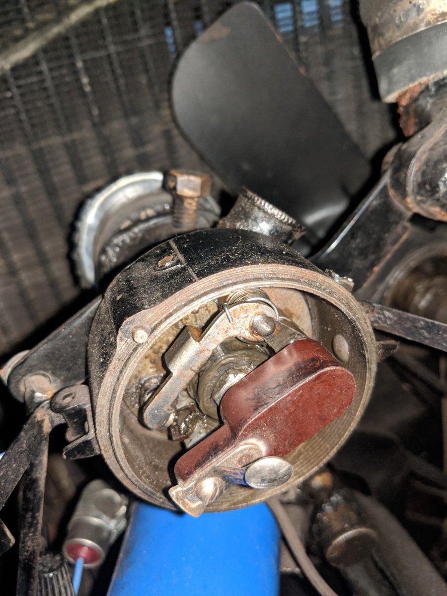

My engine (26) seemed like it was running a little rough and I thought there might be a miss, so I pulled a spark plug (Motorcraft F11) and it was just a mess (excessive carbon, but dry) so I decided to just throw on new set of plugs and wires.

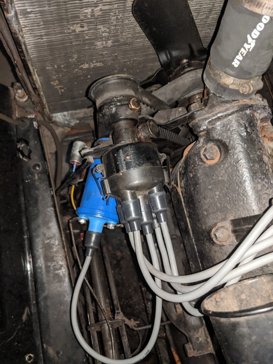

At some point in the past a previous owner installed a belt driven distributor that has no apparent identifying markings on the outside. Because I'm doing new plugs and wires I figured a new cap and rotor would probably be a good idea.

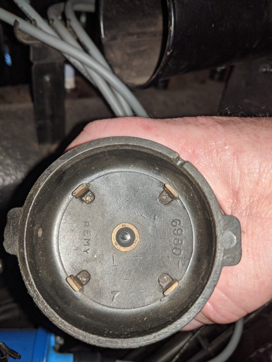

So I removed the cap to try and figure out what the heck it is. Inside the cap is inscribed "Remy 6980."
After about two hours of Google searching I learned that this distributor comes out of a 1918-1927 CHEVROLET!!
And add injury to insult, a new one will cost me $90!! Not the distributor, the cap! And the rotor? $55 :x

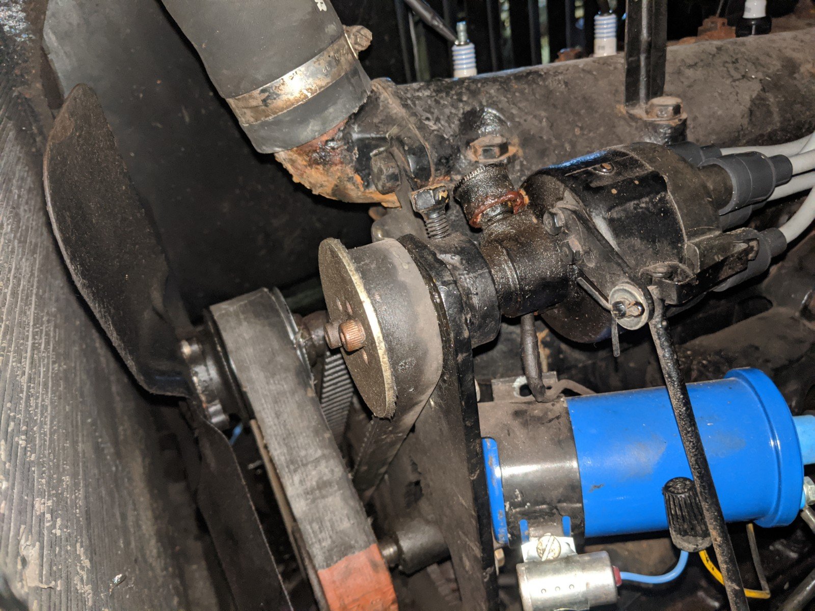

My personal opinion? (Sorry about any offense?) I have seen several such belt driven distributor setups over the years, and I do not like them. Whether they use a vintage distributor (not common), or a modern four cylinder distributor (most of them?) The drive system is not very authentic or era proper in any sense of antique automobiles. To be fully informative, there were a few chain driven distributors setups back in the day, some used something akin to bicycle chain. Although this is sort off like those, it isn't really the same thing. And the mounting is usually a bit hokey on these types.
I will not say that one should not use the modern distributors made for model Ts. The truth is, back in the day, there were dozens of different ones made, they all looked somewhat different, and the new ones look sort of like the originals in a general way. While I personally prefer the model T timer and coils, or on some cars era correct original magnetos or distributors, I have run a couple model Ts with modern distributors myself. I am certainly not going to chastise anyone else for doing so.
I would recommend trying to sell this thing to someone with a '20s Chevrolet that needs it. Whether you want to put it back to the timer and coils or the new distributor made for a model T? That is your call. And either way, it will look better than this silly thing does.

Wouldn't the belt drive be a bit problematic? I would think that it could cause timing problems because of slippage of the belt? Just curious, I've never seen one of those before. Dave

David S, They use a modern timing belt with teeth on it. Something that did not exist much over fifty years ago, let alone when the model T was even just a used car.
As I said, I have seen a few of these. Between the hokey mounting, modern belts and pulleys, they just look bad. I think one of the decent new distributors for a model T is a much better option. Personally, I think for most model Ts, getting back to a timer and coils is an even better solution. But sometimes, for a variety of reasons, that isn't always so simple. So if a T owner decides to run the modern distributor? I say fine.

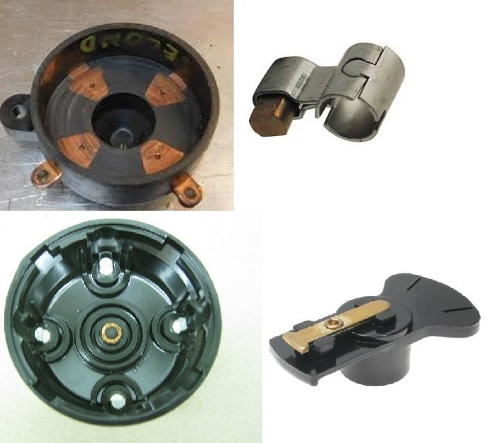

Yes sticker shock! Could be why people don't drive other brands of cars as much as we do our Fords. The cap, points and rotor would be around $60 plus shipping from The Filling Station if it were the 1927/28 distributor.
From what I can see in the photos, the cap, rotor and wires look to be in good shape and should give lots of years of service.
I had to do some searching for a distributor body to replace the one on a 25 Chevrolet that I was working on. Some of the bodies that Chevrolet used were cast white metal, this one looks to be cast iron which is what I looked for and found. The pot metal one on the car was coming apart, being held together with epoxy. The replacement I found was around $60 with shipping Resale value depending on what modifications have been done to the shaft and distributor body. If I was going to sell it, I would try selling everything; belt brackets links pulley distributor wires etc as a package first.
If I were going to replace the wires, I would get the spark plug wire from one of the car suppliers like Snyder's, Lang's or Chaffin's and make my own set.
