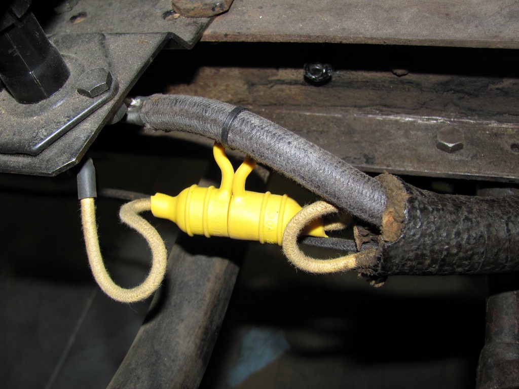

The reproduction small ammeters are about all you can do. Rebuilding your original isn't possible. But you can use the original rim to replace the chrome rim on the repo to make it cosmetically nice.

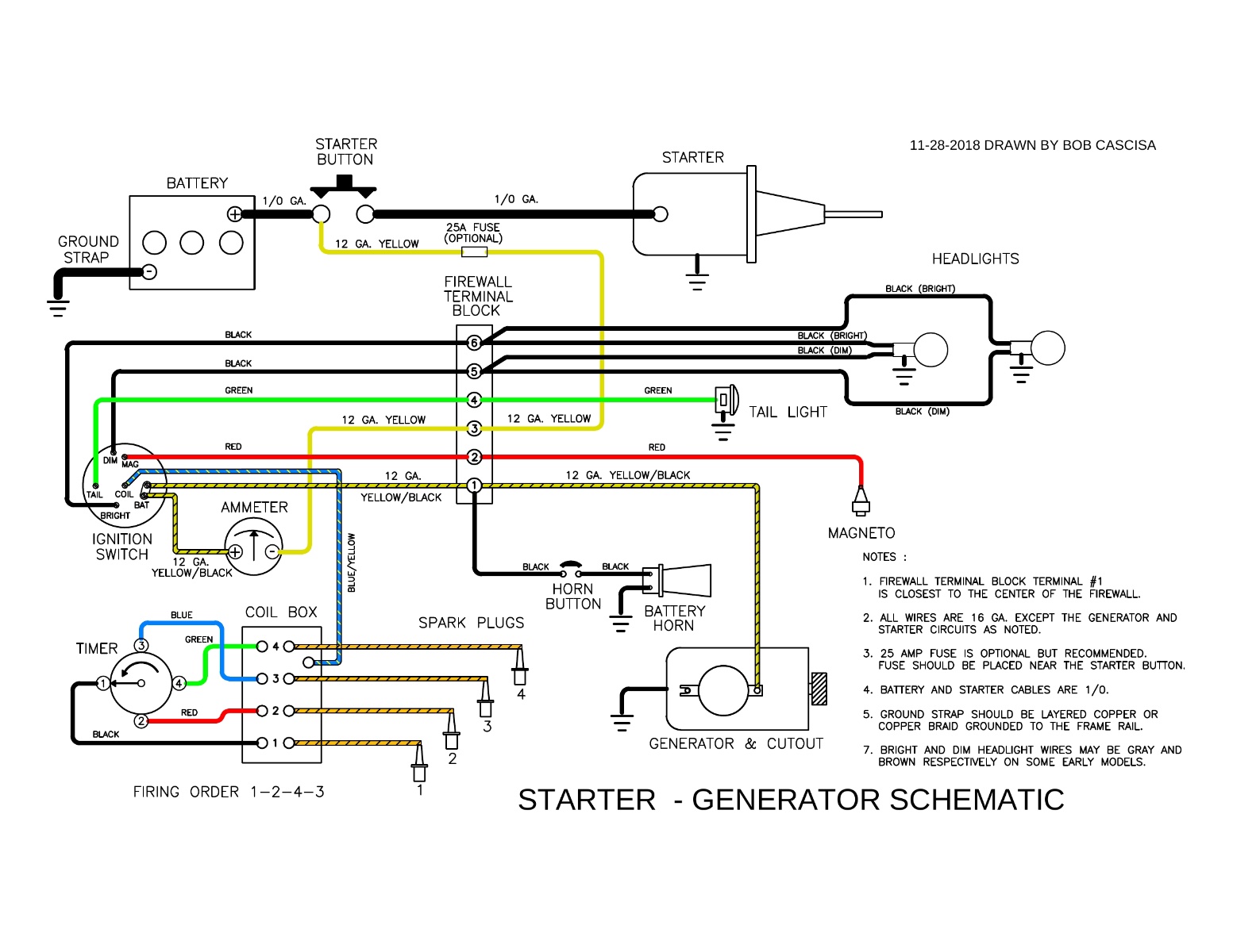

Best to really check your wiring, and the terminals at the rear of the switch, as Ford recommended. Be sure none contact each other. Then be sure to use min. of 12ga. wire jumper for the switch to ammeter (some vendor replacement have been wrong size wire), that little jumper carries a big load.
Finally, add a fuse close to the battery on that major yellow electric supply wire at the foot switch, to prevent such a loss or fire. The fuse will blow if any place in the wiring or elec. components has a short to ground.
New repo ammeter w/o Ford script on lower left, with original bezel to disguise.

Thanks Dan. I wired in the fuse today. I put it up closer to the fuse block to keep it out of the elements but I like your fuse holder in the pics. May have to look for one of them. It appears that the generator survived the ordeal as I get 7 volts at the battery when running at a semi-fast idle. I believe the cutout works as well but have to test further.
- Posts: 4084
Re: Fried Ammeter
The location of the fuse is good, easy access. The one by the footswitch is made by Fun Projects (Birdhaven), think the housing is a marine type single in line glass fuse waterproof container. Just keep in mind if something won't let you start the car to check that fuse!

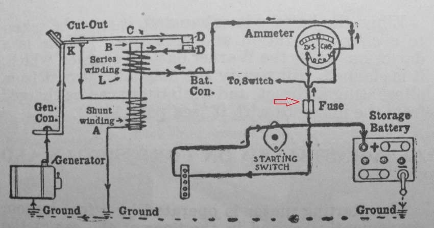

The early 1919 starter Fords with the F. A. (Fred Ames) system had a fuse in line to the ammeter, that seems good, but for some reason, Ford deleted the fuse when making its own starter and generators. Likely at dumb idea, but I guess keeping the low cost Ford simple for owners. If that glass fuse broke or something, the owner wouldn't know it was the fuse and would complain to the dealer or maybe even cuss Henry for putting something there that made the Ford not start!

The only problem with the fuse plan is that if your engine is running on Magneto and the fuse blows for some other reason, the engine will continue to run and the generator will consume all the current generated and burn itself out.
