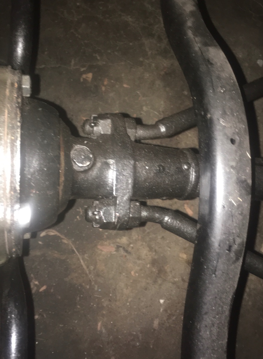

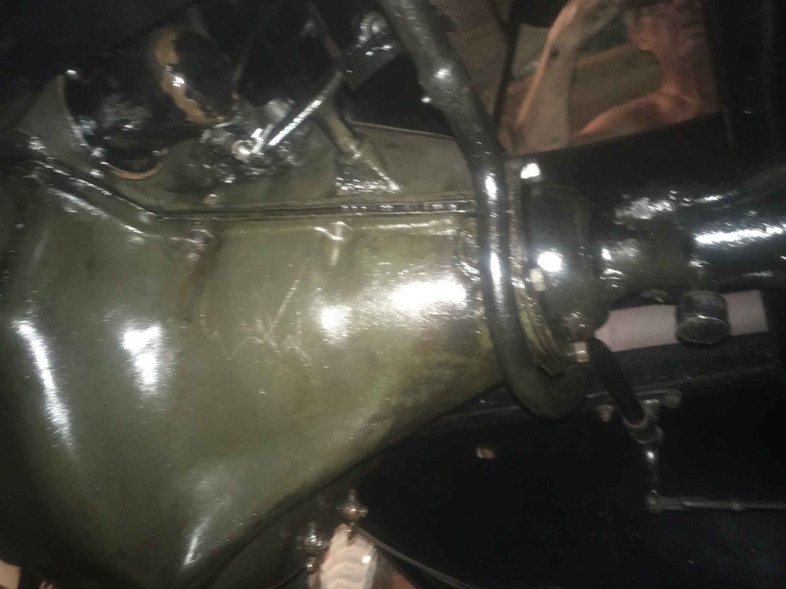

So I’m going to look for the leak in a few minutes. I’ll run the engine and see where it’s coming from.
Someone pointed out my driveshaft was flipped and I was missing my u-joint grease cup. I took some pictures of the u-joint and I’ll post them here to see what you guys think about it. Maybe I just remove a bolt and replace it with the proper grease cup?

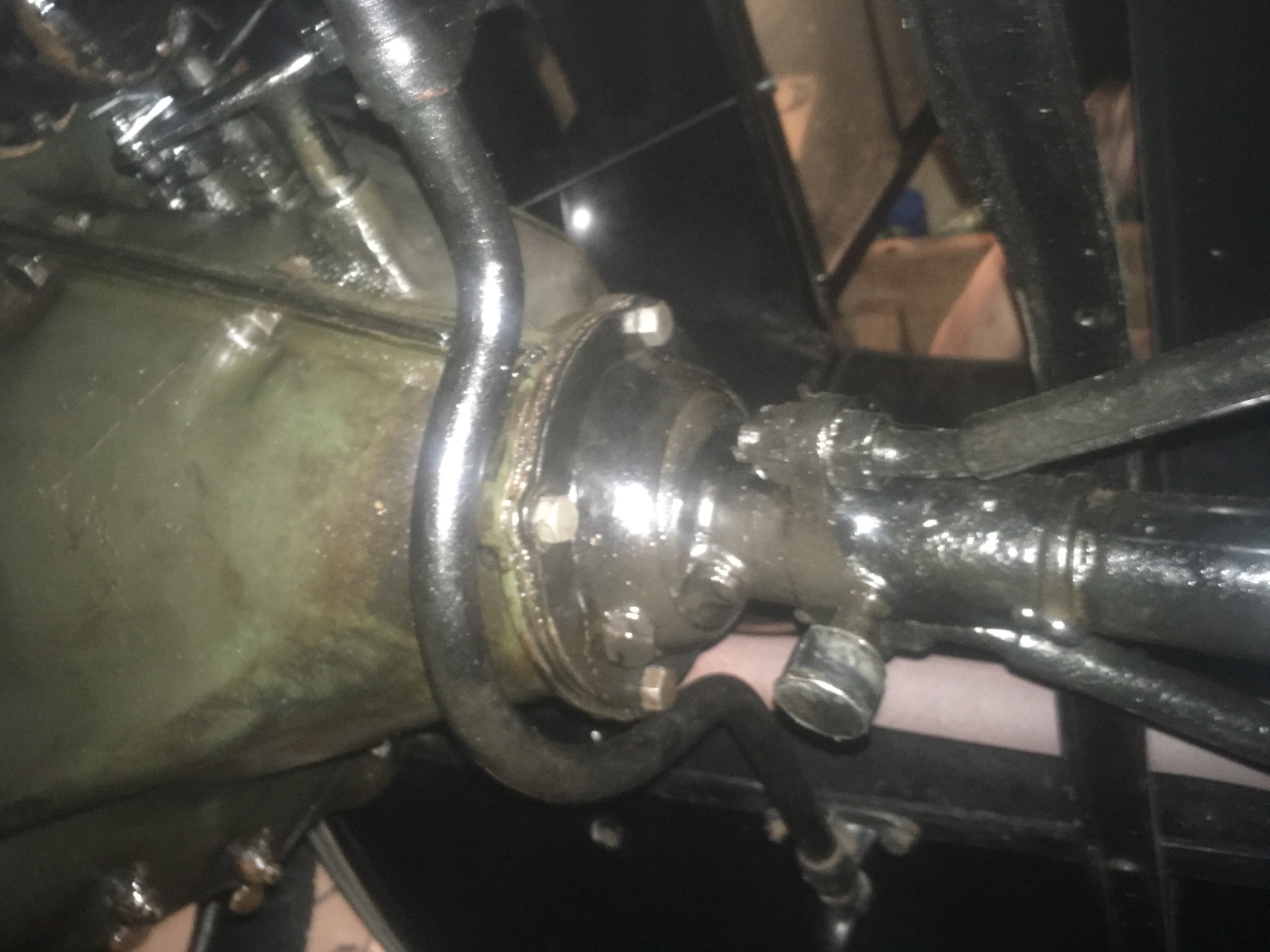

There was oil pouring out of the car. I found the leak, a screw fell out of the Bendix gear housing (I think that’s what it’s called?). I tightened all screws and it doesn’t leak oil anymore.
Anyways, I’m guessing I should order a U-joint grease cup and install that. I’m just not sure where to put it, looks like a bolt is where it’s supposed to be. 🤔

Could be talking about the corners of the transmission cover where it meets the engine block. The corners are notorious for leaking in that area after a few years. A good dab of sealant in those corners usually cures it.

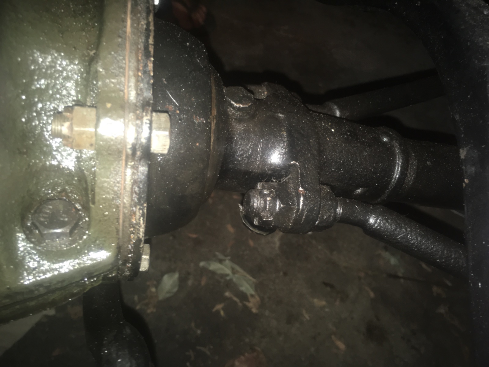

Looks like there’s just a bolt where my U-joint grease cup is supposed to be...why would the previous owner do that? Oh well, I ordered a grease cup for it. Hope it threads in and the threads aren’t stripped from the bolt.

I was the one who mentioned your driveshaft was flipped. The angle might result in a clearance issue on the driveshaft coupler that prevents a big grease cup from being installed. You can't just flip the coupler 180° because it has to align with a hole in the ball around the universal. Until you get it flipped back, you do need to find a way to fill the ball with grease, even if it means removing the bolt temporarily and squirting grease in the hole. You might be able to thread a zerk into the hole if the cup won't clear. Good luck!

So those darned screws loosened themselves from the bendix gear cover (?). Found them on the street and replaced them. Had to give her a few cranks and she fired right up. Who needs a starter motor?

Brendan, those screws have an odd thread. If you lose another one, don't just try to screw in another screw that is "close". They are available, but not from the big box stores, only from the T parts vendors. Be sure to use lock washers on them so you don't have the same problem down the road. Dave

Dave is correct - often the only recourse is to buy fasteners from a vendor. If you plan to stick with bolts securing the wishbone ball to the pan you might want to drill the heads (if there is enough meat) and safety wire. Alternatively, Aircraft AN bolts are fine thread and may be ordered plain, drilled shank or drilled head. https://www.aircraftspruce.com/catalog/ ... key=114583
When you grease the universal thru the bolt in the drive shaft coupler you want to pack it in there....ideally until you see some grease squeezing out around the edge. A few squirts won't do it. Not the smartest design but that's what we have to work with.

When you tighten, be VERY sure not to put too much force on the last bolt on the block or the bolt on the crankcase nearest the front of the hogs head! It is very easy to crack the cast iron parts at those locations. In fact I would say if the bolt is snug just do as was posted above and clean out that "crack" good with lacquer thinner and then smear on some black RTV in that area trying to force some into the crack. That will usually seal most leaks in that area.

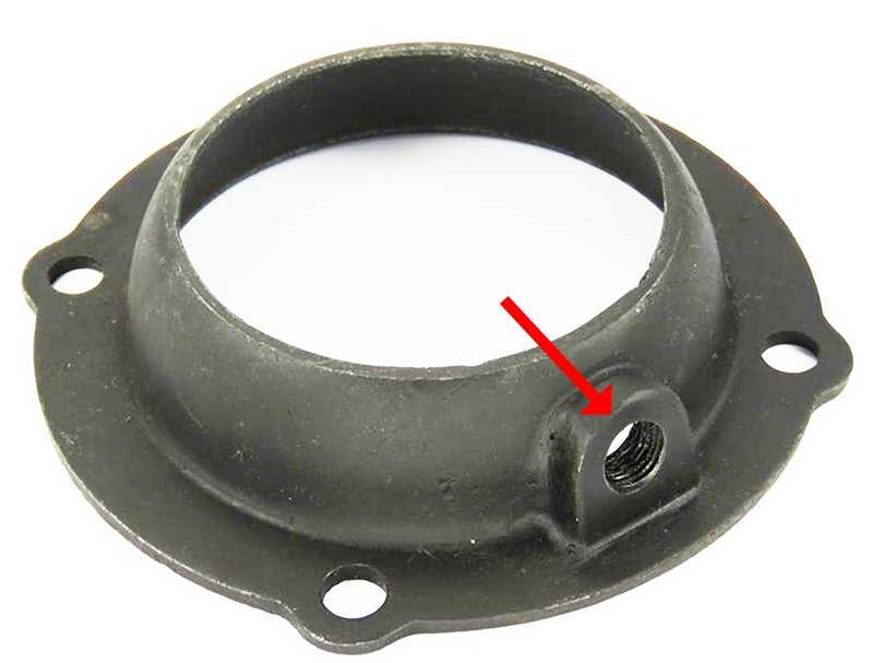

Re: Just Got My First T, Need Some Advice
Post by Norman Kling » Mon Jul 27, 2020 11:06 am
The grease cup should be at the top of the u joint! Someone has turned the cover upside down to make the grease cup more accessable, but if it interferes with the brake shaft, it is in the wrong place. Usually a person with a good wrist can reach the cup from underneath, but it is very easy to reach if you take out the floorboards.
