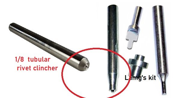

Ignition switches can be repaired (I have done several) and some parts are available. Repro ones are expensive...
You said that going over a bump knocks it off might be an issue with the fiber backing plate or the ends of the contact rings being worn. This is a picture of good contacts both on the rotating rings and the backing plate. Notice the roundness of the contacts, how do yours look after cleaning?
The ignition switch is actually two switches in one - the key turns the inner ring to select the voltage source. The handle is used to operate the lights by rotating the outer ring
T suppliers sell backing plates and switches and rivets for the style that needs them remove in order to replace the tumbler. That's the type you have. They do not sell the rotating rings. Sometimes the fiber backing plate warps and a light sanding solves some problems. Bending the metal contacts, is not advised as they can break, and doesn't help if the corresponding brass socket on the backing plate is blocked. In other words the contact needs to nestle into the brass pocket. Those tracking lines caused by rotating the switch are normal.

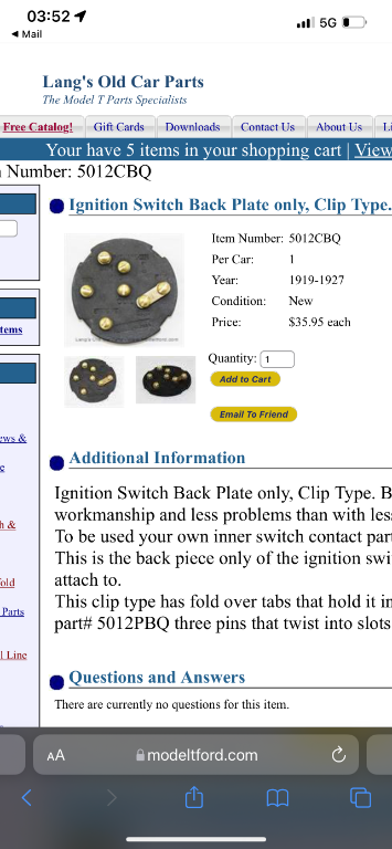

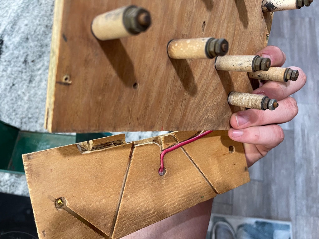

Thanks for all this info, extremely helpful. My backing plate looks like a biscuit on the side, looks like it’s starting to separate maybe from moisture? Very flaky, and I had to be careful with it. It does seem the plate is “swollen” and the contacts aren’t level with the exterior of the plate. I’ll pull it off and do some more cleaning and light sanding perhaps I can repair. The contacts on the ring if I remember looked more “cone” shaped than round, and a little distorted. I’ll take a look and see if I can find a replacement backing plate. I haven’t driven the car yet or got it to move but by bump I mean any movement to the switch and the key moved left or right a hair…the most minute change it loses contact.
I need to pull the panel and switch apart anyway again cause if I am gonna keep this switch I need to repaint. The previous owner painted the entire thing GOLD and it looks terrible. I’d like to get it back gloss black but that’s just the housing though. Lol
Edit: Went and found the plate, I didn’t know they sold just this piece. I think this will do it and fix my switch and ignition woes:

Before you reassemble the switch turn the tabs red (not hot enough to melt) and let them cool so they won't break off when you bend them down.

Its not unusual for backing plate to look water damaged (edges separated a bit). Its a real problem with the pin style and not so with the clip type that you have. The important part is that the contact surface b relatively flat and nothing in the tracks made by the rotating contacts block rotation. Sometimes when you turn the key to an ON position you feel a stop but its not really in position and just a bit more effort gets it there (too much and you'll break the pot metal tumbler, when that happens the wafers fall out and as does the key)
So be creative and paint it with the cup in place - just tape the inside bottom) There is no electrical contact inside the cup, just that the rings need to rotate on the bottom of it. All electrical contact is between the conatct rings and backing plate, anything else is a short.
Do not take the switch apart to paint it unless you have to. It can become a can of worms immediately. The type switch you have (my favorite) has a flange on top on the handle that is fits between the face plate and cup. To take the the handle off...
The large rotating ring comes off easily, then smaller ring needs to be pried upward off the back of the tumbler. Then then the rivets need to be drilled out and that's where you can ruin the switch plate when they start to spin enlarging the rivet hole. Laying the faceplate down the handle should be able to be removed BUT before you move it the key needs to be in the tumblers in order to hold the wafers (pins) in place so they don't fall through (not to hard to get them back in the proper order - only 4). So now you paint it and then try to put the stainless steel rivets back in - with the appropriate rivet clincher (not the one sold by supplies is the wrong size). Hopefully you don't mess up the paint job as you try to peen the rivets (remember the tumbler and handle are in place when you try to do this).

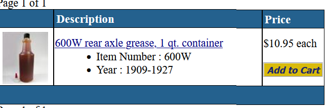

Minor point but Lang's ad calls 600W grease not oil. The "W" does not mean winter for a grease as in oil but a reference to its weight as grease is usually discussed. Yes, grease is oil with additives to make it thicker and sticky. Problem with vintage documentation is that we sometimes interpret it in Today's jargon. I even found a reference where oil in the early 1900's suffixed with a "W" meant whale oil. :?
One needs to consider the additives in Today's greases, oils, and any fluid when using them in a Model T. Will they have an effect on brass, copper, bronze, babbit, felt etc - all the materials that linger in your engine and differential. If the rear axle was rebuilt it is likely to have brass thrust washers (does the oil/grease contain active sulfur -bad). I'd stick with a formula designed for an application. If you don't have any buy two, on for the first fresh filling and the other to keep it at the proper level

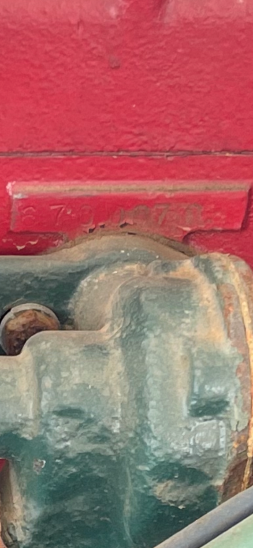

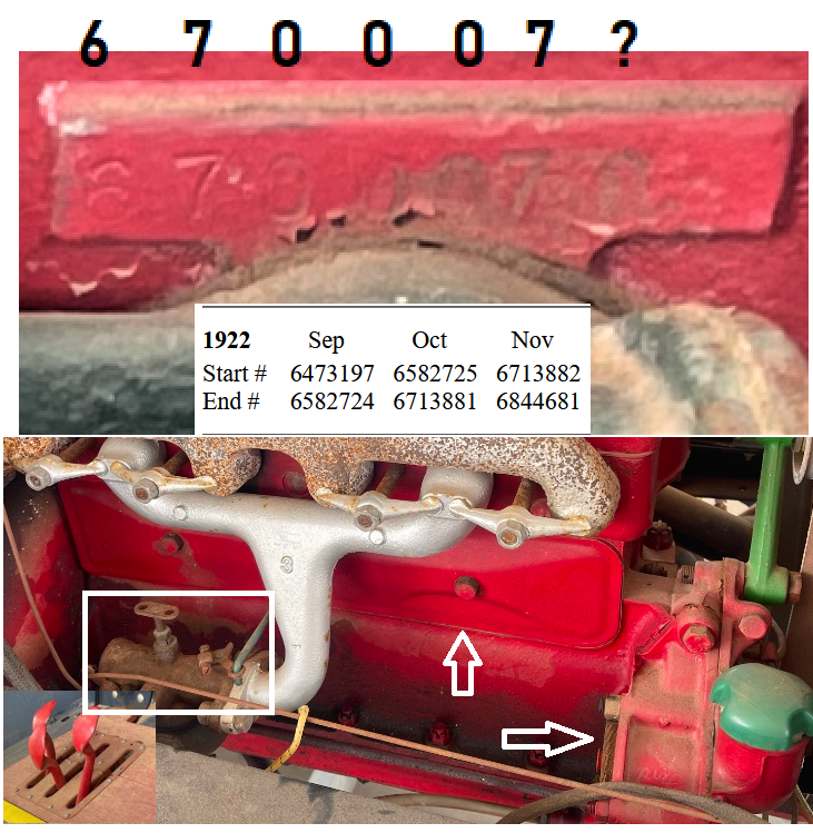

Can anyone read this engine number? I tried looking it up but I don’t think I’m reading it right. In person it’s even harder to read so I took this pic but still can’t make it out. May try to use some chalk or something tomorrow I’m just curious. Looks like 6700070 or 67000770…but that doesn’t make sense to me if it has another 7 in there. If the first number is right that’s a 1922 motor on a 1925 frame/body? Unless it was in the rogue highland transition?

Looks like 6700070 - best to just rub some lacquer thinner over the numbers should remove the paint. It is not unusual for engines to have been replaced back hen or even now.

If Frank's reading of the serial number is correct, the engine was assembled on Saturday, October 28, 1922 (almost four months into the 1923 model year).

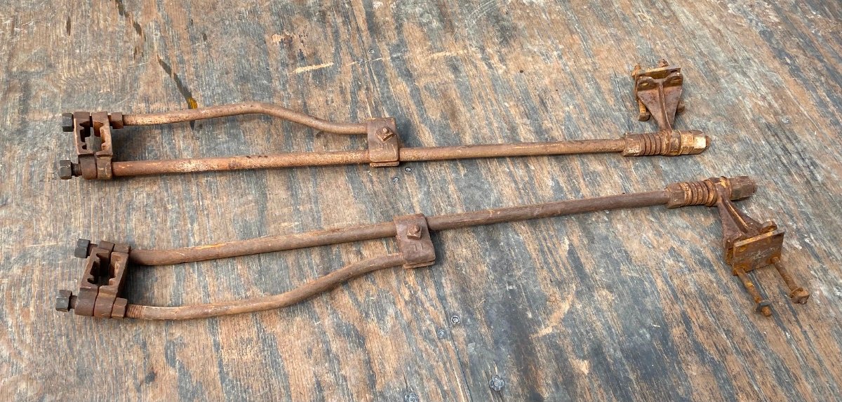

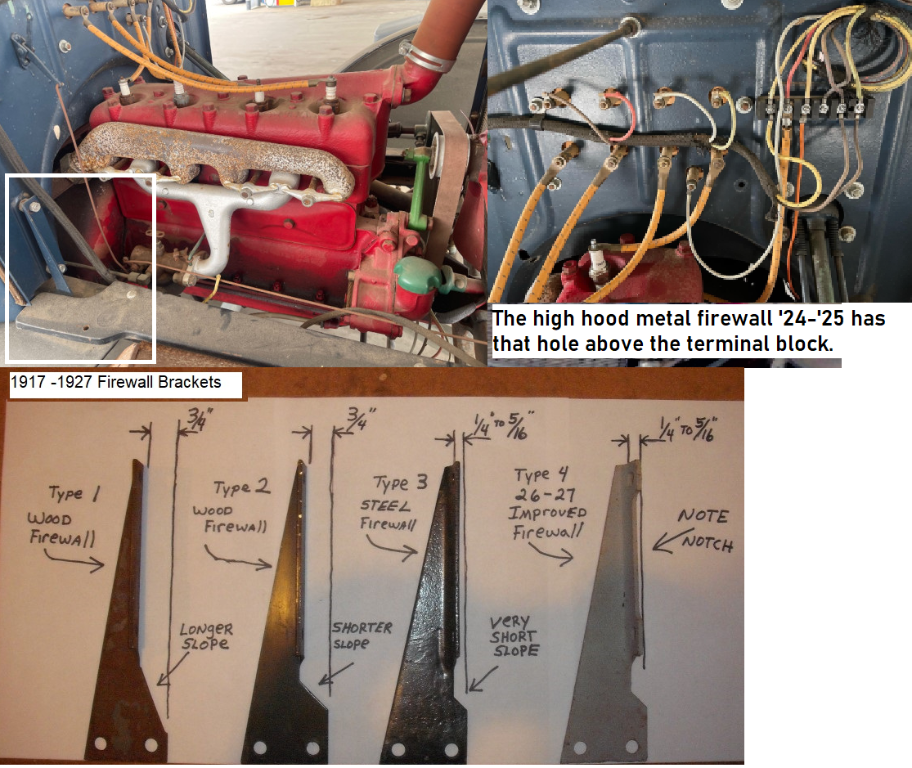

While I was looking at the engine number I noticed that the firewall brackets may be incorrect. Thee shouldn't be a spacer between the bracket and firewall. Likely they are for a wood firewall. The firewall also appears to be a 24'-25' high firewall. So you need to measure the radiator shell to see if it matches. Low vs High requires a different hood. The discussion is long but I don't know if that was covered. Also start to a diary & document what you have and a ledger of your expenses (save receipts). Tax laws are changing and when a Model T is sold the Government will be looking for their "fair share" a tax on a Capitol Gain (sold price - investment cost).

I’ll go take a measurement on the radiator and see if I can find a frame number. Boy don’t get me started on taxes, it’s getting ridiculous. Old cars have been prolly paid for multiple times just with their taxes. You get taxed on what you wake, taxed on what you buy, taxed if you give someone money, hell you get taxed and leave money when you die! I’ll never understand why you gotta pay taxes on a private sale between two individuals where the taxes were already paid when purchased new or from dealer. Man when will enough be enough huh? Lol next thing you know they’ll be sending collectors to your house again to see what you got they can tax. Makes me wish it was still easy to get paid cash and not use a bank cause they gonna start watching your accounts as well!
Forgot to mention I do have a hood and it fits, however there is something funky going on with radiator shell I’ll post pics. I ordered with other parts the actual mounting bolt/spring set to do it correctly.

Your flaky biscuit switch plate can be strengthened by using superglue between layers, then clamping it flat. Mine works well now.

Wow I didn’t think of that! I ordered another back from Lang’s. I’ll save it though

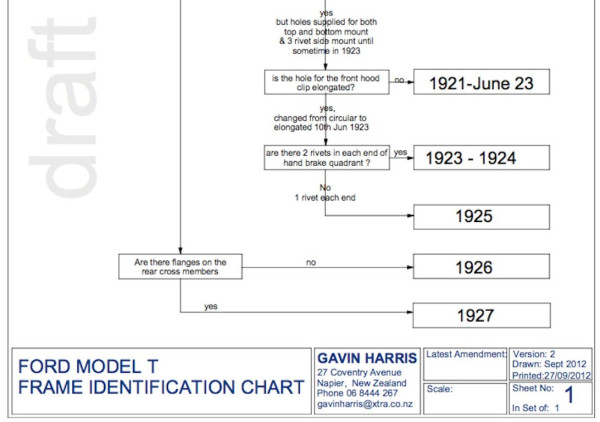

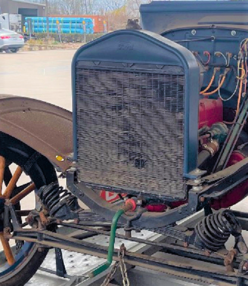

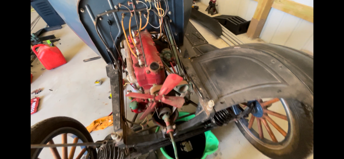

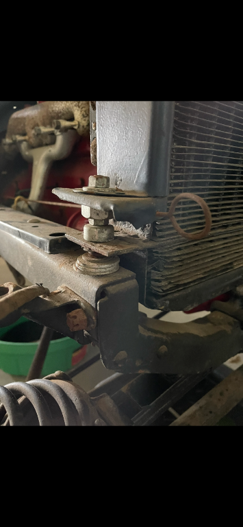

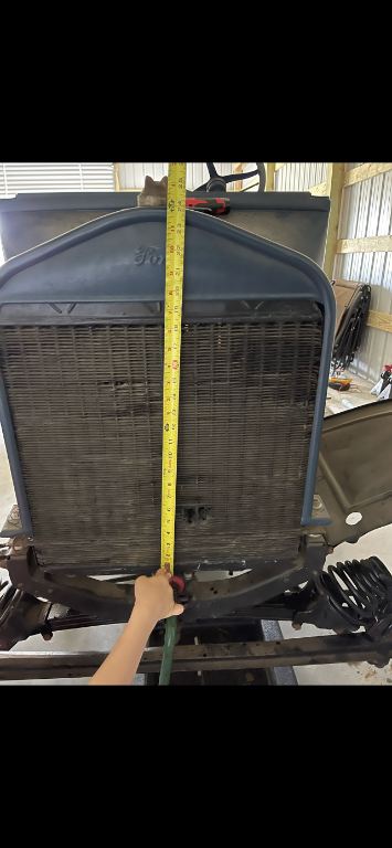

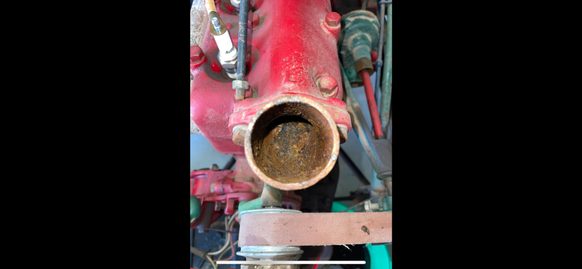

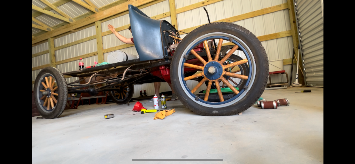

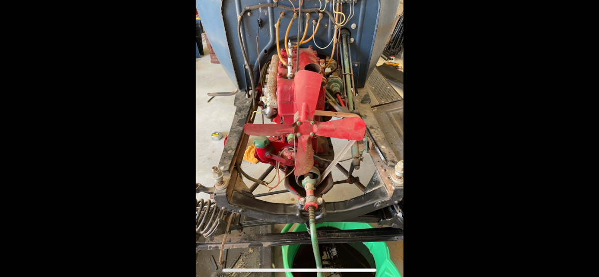

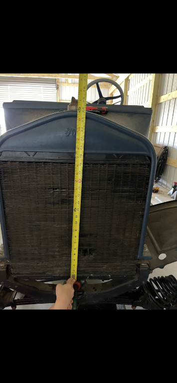

Here’s some pics. I couldn’t find a frame number. I looked on the top rail on both sides by where emergency brake connections are. I got distracted and moved on lol

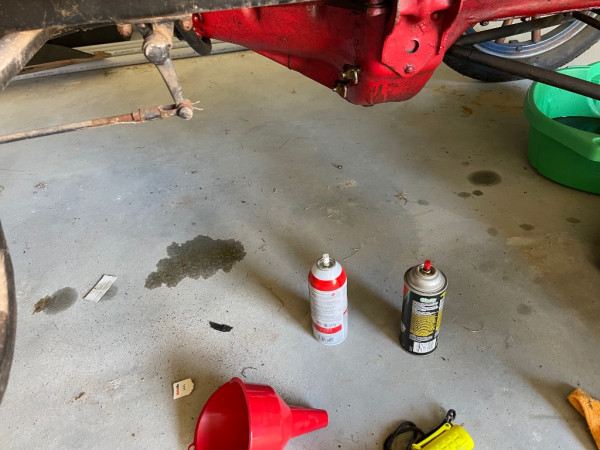

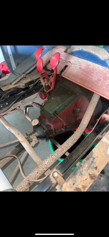

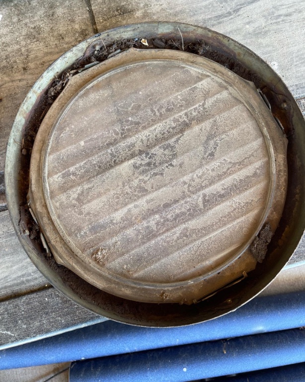

Every pic I post I gotta do a screenshot of because it won’t upload…says size but I can upload a screenshot that’s larger MB lol. Anyways, the previous owner was apparently a fan of Christmas 😂
Grease cup on trans is stuck, gonna use some Kroil and let it set and see if I can get it off. Radiator mount is about $20 in washers lol I ordered the correct mounts yesterday. Included measurement of radiator from bottom of it to the top of shell. I believe the element size was 17” tall from bottom to top of cooling area.

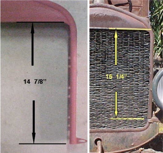

Looks like some one used a low radiator & raised the shell so a high hood/cowl would fit.
Posts: 7410
Re: New Member and Owner..Some Questions!
Post by Steve Jelf » Mon Mar 14, 2022 1:41 pm
Yes, a low radiator's cooling area is about 17" high. If you want your radiator to fit the shell and hood, it would be a high radiator (1924-1927), about an inch taller. On the other hand, the low radiator should work, even if it looks silly. :D

WELL DAMN lol. What a smorgasbord of parts! Looks like I’ll be looking for another radiator I guess lol boy this is getting expensive! Im glad I didn’t get this ones leak fixed yet! Plus with the fins missing in the center where it looks like a spear went through it would’ve been extra im sure. :cry: so I guess I got a shirt shell as well lol

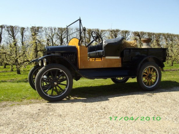

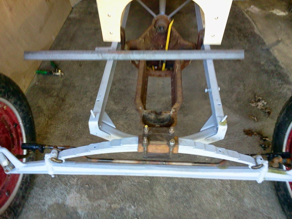

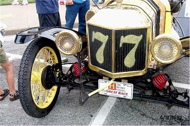

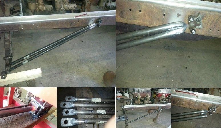

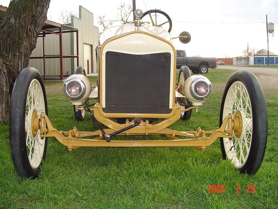

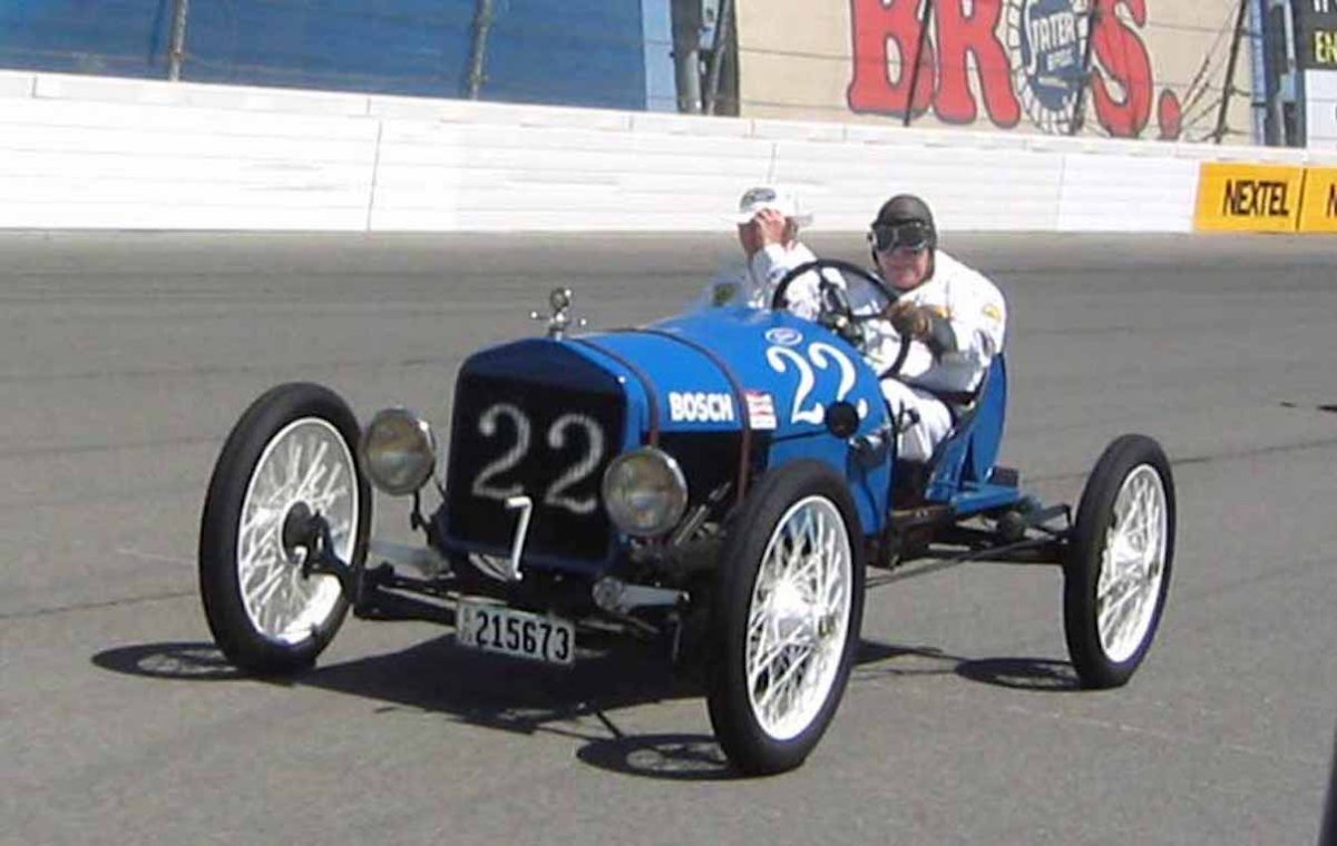

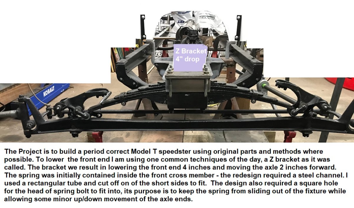

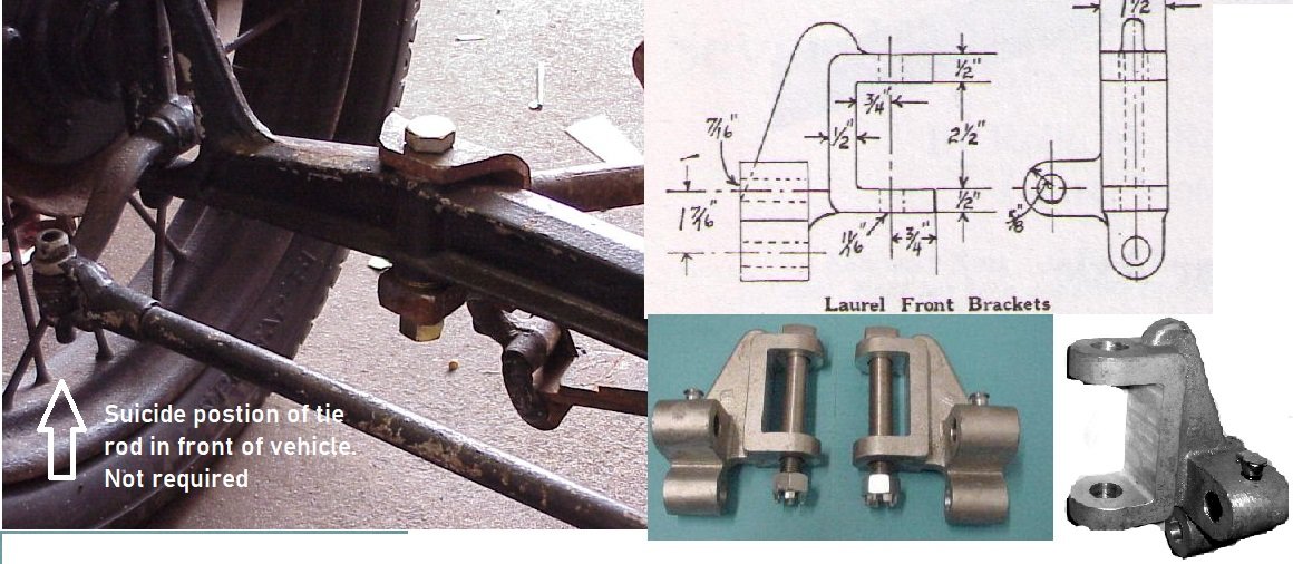

If your thinking of doing a speedster, keep the firewall, shell and radiator. You can mount the radiator and shell properly and make a make a hood or have it made (less sides). It would give a nice rake to the body lines. Least cost too. Not sure what you have in mine but you can sell the cowl portion with or without the dash. The issue with pictures is no surprise. Camera photo's need to be adjusted via an app

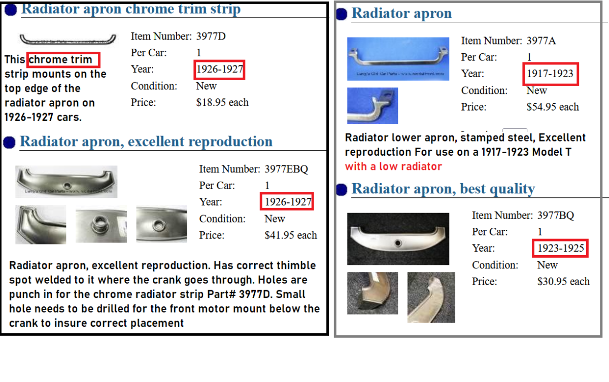

I noticed I don’t have the lower part of the radiator shell, should I get one? Or would it not look right?

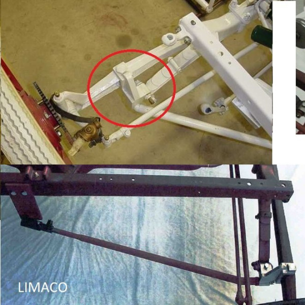

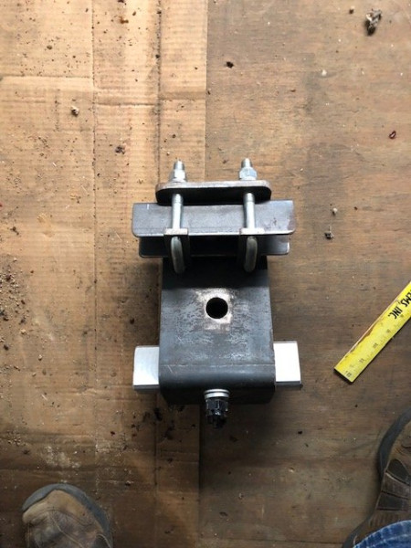

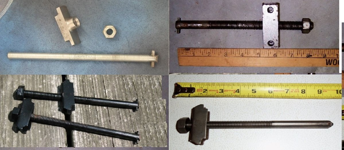

You don't need an answer to that question (spend $$) until you have the mechanical parts up to snuff and have decided upon what it is you want your T to look like (speedster, pickup etc). In fact the parts may get in the way later and get unused. But the question does bring up the subject of "how to order parts efficiently". Shipping costs can eat you alive so you need to plan what to buy and when. A bundle of parts that fit into a 10"x5"x2" might cost $10 to ship - if you were to add a 24" long part weight 12oz the cost would jump dramatically if shipped together. However if you ordered long parts together later you'd be saving on shipping costs. Shipping costs are based on density (volume & weight). Simple example: 2.5lbs in a 10"x5"x2" box might cost $10. Shipping 2.5lbs of ping pong balls would require a 1 cubic foot a box (The Internet i s great. 432 balls) cost $14. So plan on everything you know you need now to get it running right & safe. Clean & paint rusty parts, another subject for discussion (not always a final paint job).
Keep everything, don't sell anything, until your finished with the build.
For the time being I would lower the radiator shell and use the proper parts so it looks right. The parts for the shell aren't needed and as you can see which combination would you buy. The front engine mount that the crank is in is the correct style for your years.

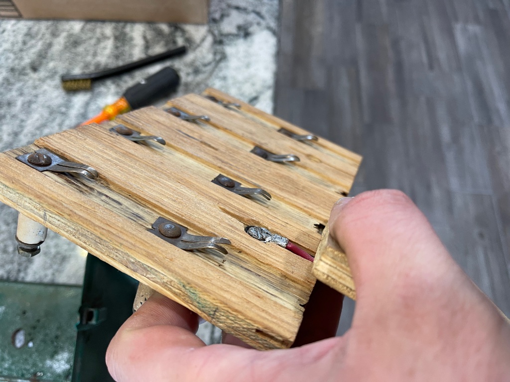

While I await part arrivals, tomorrow I’m going to continue to clean things up…LOTS of texas red dust everywhere but underneath is nice shiny black in the frame etc. I’m gonna pull radiator off and bring to another local shop I found to get leak repaired and see if they can also repair fins and clean. I’ll take the opportunity to see how the block looks and if I can flush it out as well. Give me something to do tomorrow I love tinkering with it. Just something about it is just fun, more so than other cars I’ve owned; maybe it’s the fact I’m making it “mine”. Also it’s been so great just being able to talk to other owners that enjoy Ts!

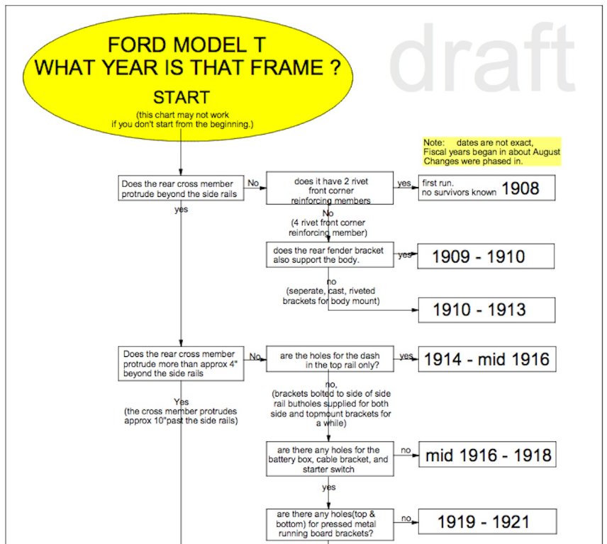

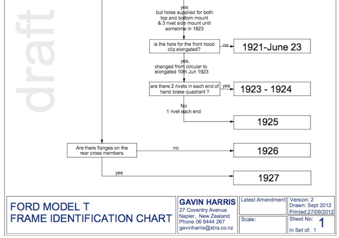

The only number you will find is the serial number on the engine. It was nowhere else on the car until December 1925, when they started stamping it on both engine and frame. That's your VIN. With a parts salad like this, I would call the year whatever the frame is. Your firewall is 24-25, so maybe the frame is too. If it is, the handbrake quadrant will tell you which.

Use your engine number and engine build date as your car (you can then show the engine reference chart) and don't offer any explanation of part variations or use t he above flow chart (that's for personal use & judging). Likely they are just concerned that it is an antique or a Hot Rod (Bucket T) trying to get cheap plates. Model T identification was/is by engine number and year for Title and registrations only, it is not intended to prove the year it was built since engines could be and often were replaced.

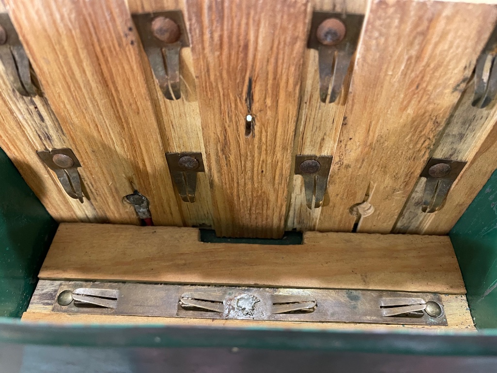

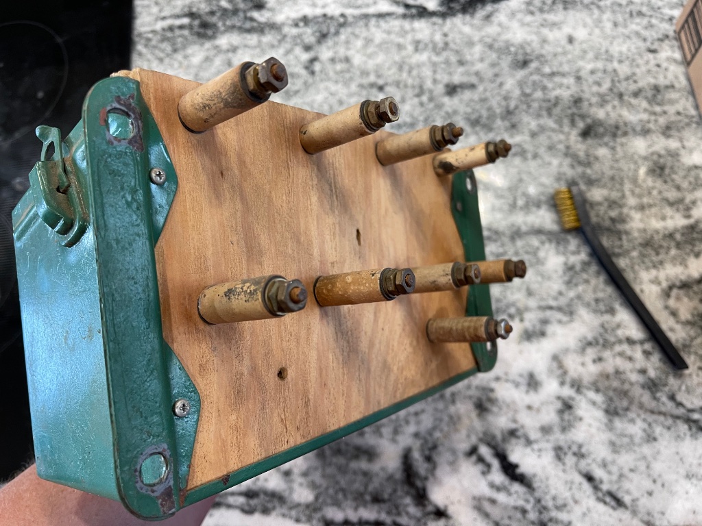

So y’all will be proud! I’m off today and got some time to play with it. Verified all 4 coils are good, they all buzz loudly and bright spark when placed in the 1st two coil box spots, second half of the coil box is dead it seems. Removed coil box, think I see problem. Isn’t there supposed to be a second wire on the right? Can’t tell if this is a DIY make up or a kit he had purchased at some point, but it looks rough. I’m gonna take it apart and clean everything well, some of the contacts are bent oddly. I need to find a coil box lid if ima continue this route as humidity is terrible here. Also removed radiator, the motor side doesn’t look all that bad really. The radiator feels like it’s got 20lb of sludge in the bottom of it 😂, I rodded out the petcock and it drained nicely just had to keep at it. Gonna take it to shop today see if it can be repaired; the fins in the middle look like someone threw a spear through it lol.

More:

Well scratch that I see what that wire is for. Ima clean everything up see what happens
Posts: 6575
Post by TRDxB2 » Tue Mar 15, 2022 12:59 pm

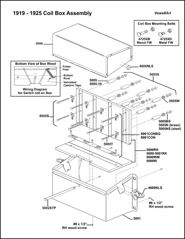

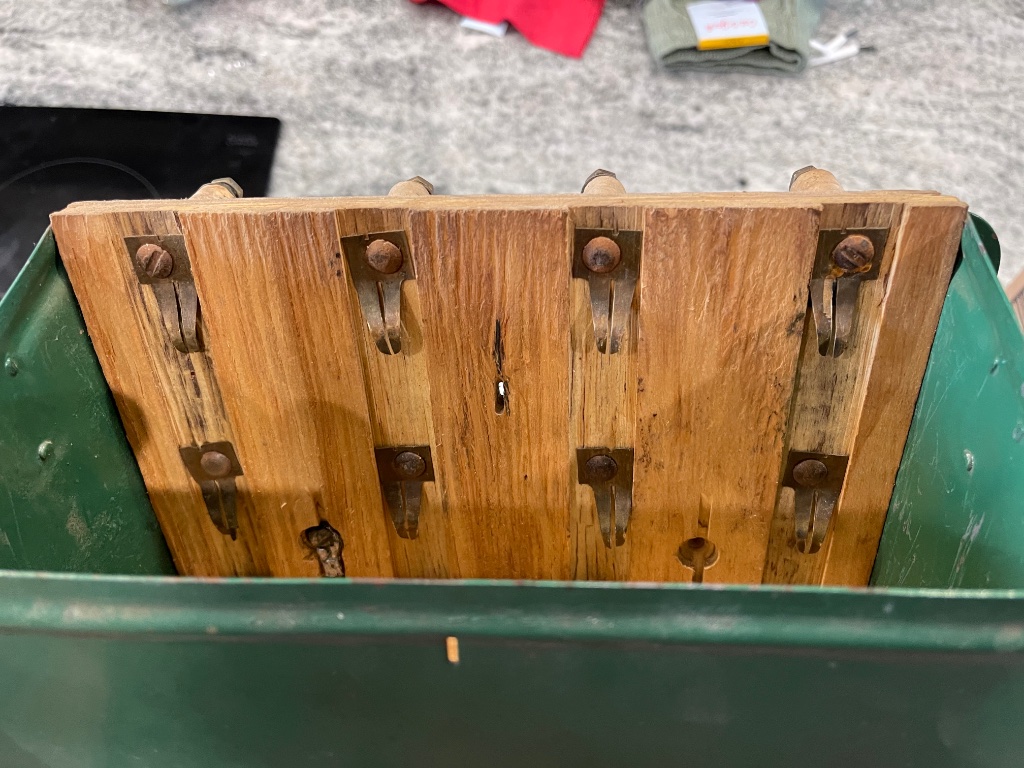

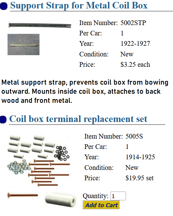

Your coil box wood is just a repro. To refurbish it take the contacts off carefully, they are shaped like a carriage bolt with the square in the contact.
I don't understand why you say one side is dead, unless the coils where not making contact. That may be a result of not having the support strap
The last issue of repro lids that has spot welded construction did not fit well. Original lids are hard to come by. Wht you need is a way to keep the coils from bouncing up and losing contact y=until you find one
This link will get you to many exploded diagrams of various parts https://mtfca.com/phpBB3/app.php/gallery/album/5
The ceramic insulators have paper insulators on both ends (clean them but they will look discolored). DON'T replace the contacts just clean them, they are special metal and repros are not the same. Don't bend them either (they are lefts and rights as you can see in the pictures. Once you have dismantled the board, give it a light sanding and you need to seal it with a penetrating sealer (I use MinWax Wood Hardener - really soaks into the wood like a sponge). Other may suggest the repro plastic board but its a cost decision. The rust is just in the head and water inlets and outlets. Don't remove the head unless you are intending to use a non-copper gasket (copper ones have been unavailable for almost a year)

Post by Guardian1fox2 » Tue Mar 15, 2022 1:26 pm
Well I took video but can’t share it but I GOT IT RUNNING!!!!!
Man I’m so excited, I did it with everything that was there originally the previous owner had!!
I had radiator off so I only let it run for like 20-30 secs. Had some water vapor coming out of the outlet for radiator when I shut it off. Once I got the coil box back on, and checked all 4 coils buzzing I got giddy. I checked gas tank, looked clean…I was too impatient to clean thoroughly lol
Added just a bit of gas, when I did BOY it started pouring out of the bottom of carb and out front of carb. I guess the previous owner before he passed emptied all gas and drained carb. I turned petcock and it stopped. Sprayed it good with carb cleaner, just out of previous experiences I turned carb too adjustment all the way in and backed off 1 1/2 turn. Sprayed a little starting fluid, and it POPPED OFF!
Then it was pouring out front of carb, so I sprayed more, and turned adjustment screw in and back out 1 1/2 turn a couple times, it stopped.
Got to front and moved timing down just a bit, and turned up throttle a little…IT STARTED RIGHT UP!!!!
I let it run for just a little bit adjusted timing and brought throttle down, it just sat and idled no problem. I turned it off since I didn’t have radiator on it…didn’t wanna chance anything with water pump or overheating. Bringing radiator now to shop I can’t wait to let it run for a bit and clean it out! In the pic it’s a screenshot from video of me going YAY! but you can’t see me 😂

In a box of parts I was looking through, I found another blue mountable rim. What would I need to mount it as a spare once I get a tire and tube for it?

When and if you work on that coil box again, it looks like the top right and top left pieces were reversed. See how they are not lined up like the bottom ones. All you have to do is switch them.

Post by TRDxB2 » Tue Mar 15, 2022 11:37 pm

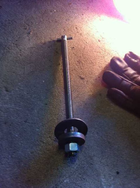

Lots of information and ideas in this recent post https://mtfca.com/phpBB3/viewtopic.php? ... er#p206651
Also you need to browse this site as it all kinds of information North West Speedster Club https://www.nwvs.org/technical-reference/
But before you get carried away you need to realize that changing one thing means you need to change something else and then buy something else and then ..... So plan carefully. Also be careful with those beehive Hassler shocks. They are under a lot of tension now. A simple DIY tool is needed to remove/replace them on the axle
http://www.mtfca.com/discus/messages/50 ... 1208891118

Thanks for the warning. I do have instructions that came with it. I’d like to take them off and clean/lubricate them well, I’ll need to to reverse eye bottom leaf anyways. Idk if I wanna get it really low, I’d like it to look period. I have 26/7 spindles but not sure what I need to do to swap them, I’ll take pics to show; they seem to be in good shape. I’d like to retain my hand crank, perhaps reverse eye front, spindles, and reversing rear will give me enough for now and a slight rake which may look good with my tall firewall and shorter radiator. 🤷‍♂️. Also got figure out light mounting without fenders. I don’t have any lights so I’ll have to find that too 😂. I do have the fender brackets though.
The running boards are in great shape along with the front driver fender and the splash panels. Also got rear fenders and passenger fender. May try to use them as trade material for the other stuff I need.

David noticed the same thing I did about your coil box contacts. They are left and right handed but yours are mixed up. Look at Martynn's drawing that Frank posted. It shows where each contact should be.
In case you have not seen it, there is an awesome gallery of exploded assembly drawings that were done by Martynn Vowell. Clink on "Gallery" next to your login name. Click "VowellArt". Then click on a heading that is of interest to you and you will find a wealth of information on how things go together. Congratulations on you first start.

Oh I see what y’all are saying now. I’ll swap them when I go to redo the coil box, with either the waterproof material or sealing the wood. Btw, should I seal the wood on the coils? They seem extremely dry imo.
Oh I did find an original coil box lid in decent shape on fleabay. Picked it up for $40. I’ll evaporust the surface rust off and paint both top and bottom black and it’ll be back in shape.

Post by Steve Jelf » Wed Mar 16, 2022 10:59 am
I’d like to retain my hand crank...
Maybe you'd like to set it up as Frank Harris did his.

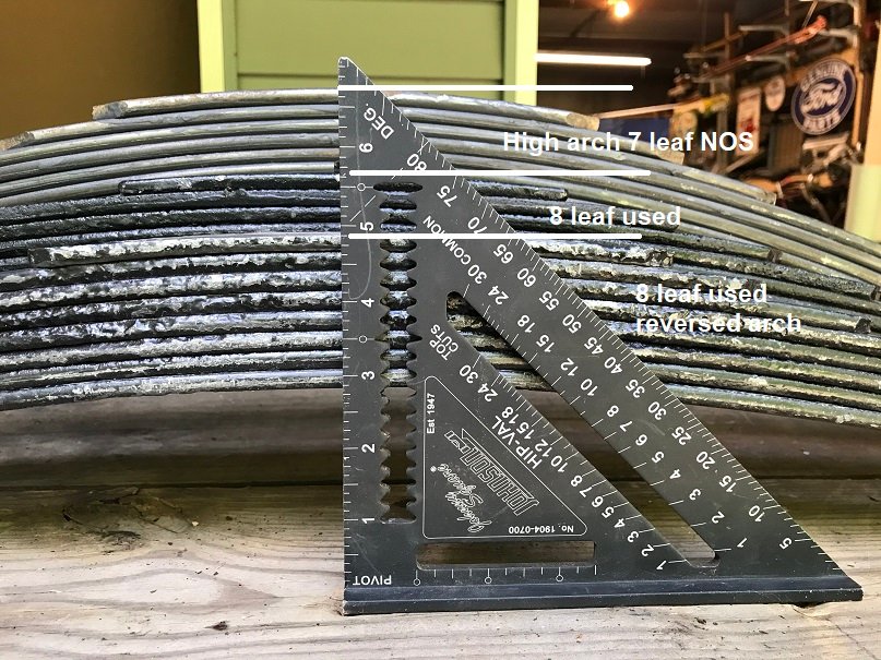

Post by TRDxB2 » Wed Mar 16, 2022 2:14 pm

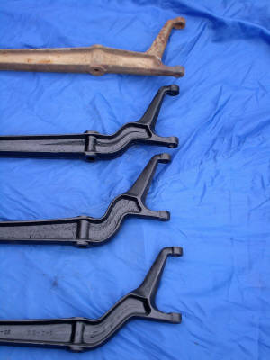

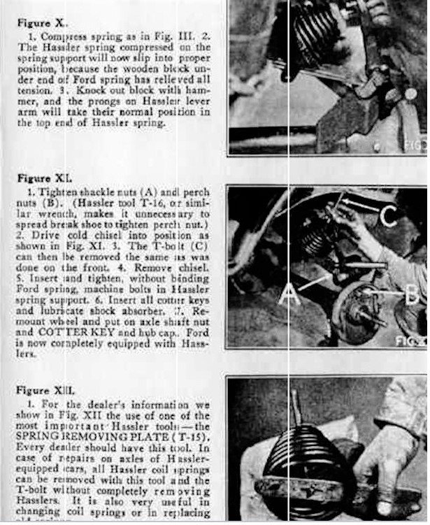

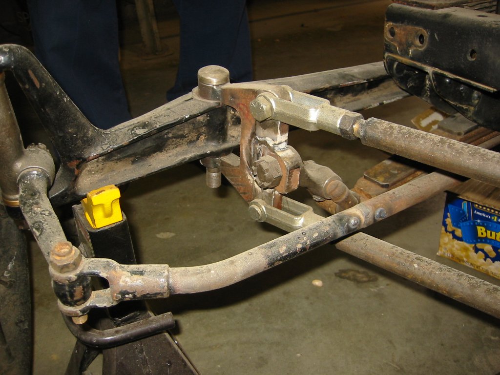

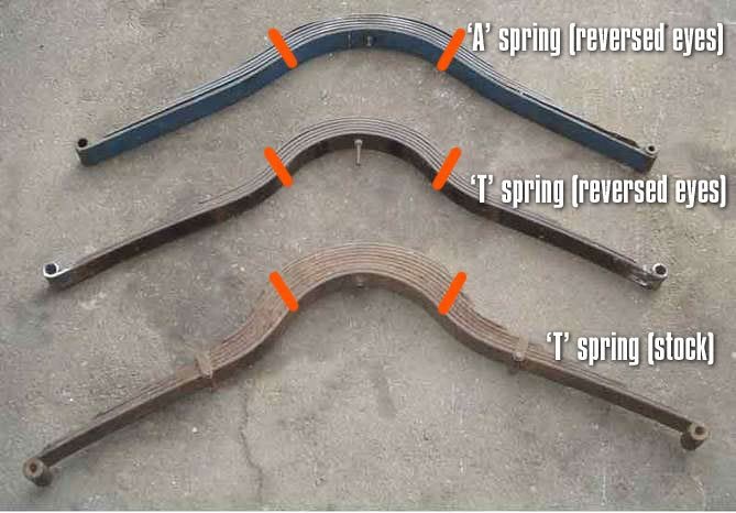

Most methods to drop the front axle do not eliminate the hand crank. These are the ones that keep the axle under or behind the front cross member.
Some simple things: Spring height is the first to look at. Not sure what you have. See attached. Reverse eye is about and inch lowering' 26'-27' spindles get about 1/2"-3/4". Removing ONE of the top leaf springs get that thickness (should have good leafs and light weight speedster): wheel diameter.
The more exotic methods re a dropped front axle, Laurel or Limco brackets
A speedster some kind of brackets, a reverse eye spring, and the top leaf removed - together amounts to a 4 1/4" drop. Brackets account for 3", reverse eye - 1", and overload leaf - 1/4". At 4 1/4" of drop the tie rod just clears the pan (by 1/8" inch) with the 1919-up T270B & T282B curved spindle arms. One can gain another 1 1/2" of room for the tie rod by putting the left spindle arm on the right and vise-versa. 26' spindles do not effect the tie rod issues they lower the axle position not the spindle arm
dropped axle.png (172.72 KiB) Viewed 12969 times

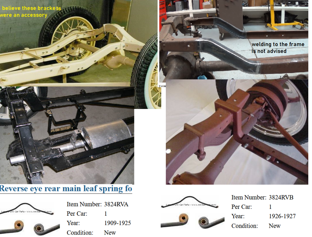

Rear drops are somewhat limited. Spring height, cross member mod, reverse eye, brackets, frame modifications

YES!!

Hmm, looks expensive lol I’ll take a pic of my springs in the front. Doesn’t seem like spindles are worth it honestly. I guess for now I’ll try to get front spring reverse eyed, and see if I can retain hasslers for the look. The rear I saw on eBay a guy sells those brackets but man cutting the frame with my inexperience makes me nervous. I could reverse eye the rear for now maybe put SLIGHT bends on the ends of it if I need to get a slight rake. Idk seems like I need to find a T person locally. Unfortunately no chapters in LA and I think the closest one is 5-6 hours away. Wish there was some simple bolt on options 😂. I did see someone sold a bracket for the radius rods where you bolt the bracket to the frame and swing out the arms and get them cut and fitted with tie rod ends…like a kit. That wouldn’t be to bad if I had to go that route cause I could bring the parts somewhere.
This MAY open a can of worms; but, what would a period drop be on a “racer” or speedster from 1923?

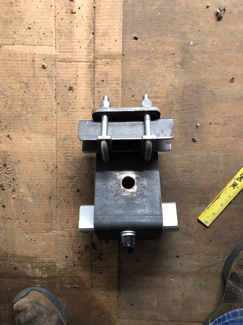

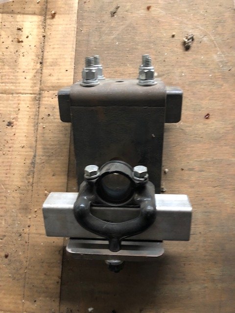

Post by TRDxB2 » Wed Mar 16, 2022 3:47 pm

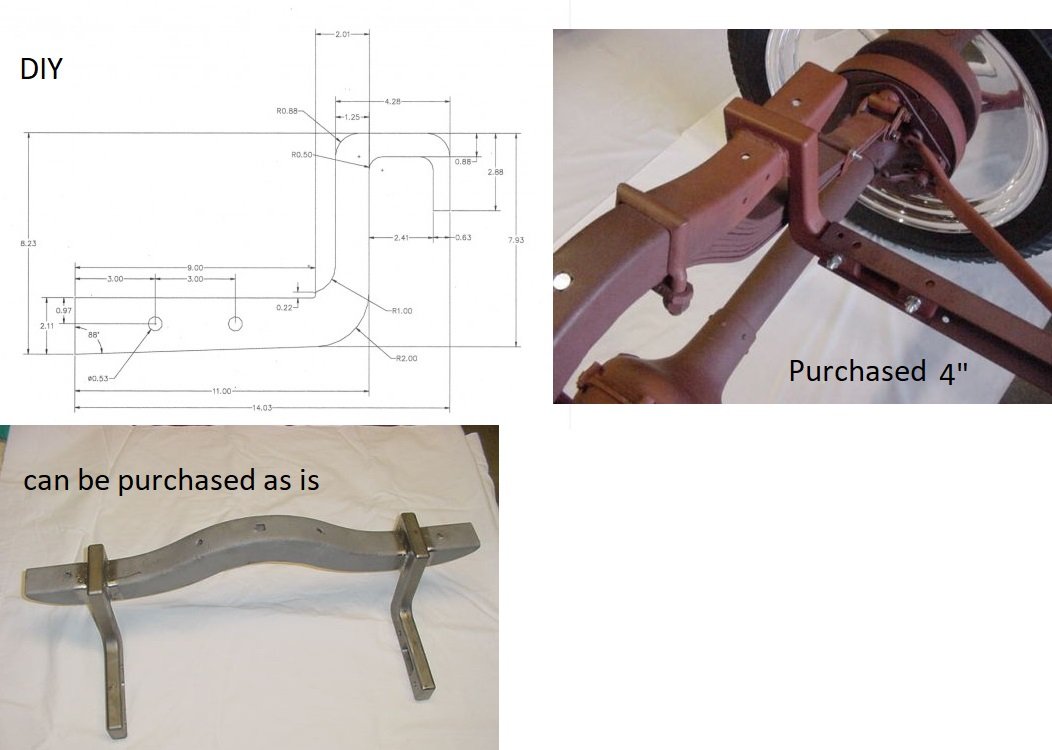

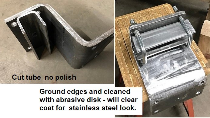

I had a Z bracket made for the front from a local Steel outfit (they reduced the fee last minute if I didn't want a receipt -$35. A Z pushes the axle forward and lowers too. Mine has no hole for crank because I'm using the new aluminum pulleys. Hank Lee has a bracket setup (not sure if he still has one for sale) Like mine it lowers 4.5" but he has a provision for a crank - need longer
Th only caution with this method, same to for he other, is to allow clearance for the tie rod hitting the bolts holding the bracket to the cross member.
Mine with Hasslers & 29" spindles but change to pancake style Hasslers
Hank's
Wow this is awesome. So I technically could just get one that’s 4” and leave everything stock, make hole for a crank? Then I could couple it with the aluminum Z brackets off eBay for rear and leave rear end stock? If you don’t mind, could I send you a PM? I’ll send you my number if you don’t mind!

Well damn, I forgot to get a pan 😂 you run it for 30 sec and it leaks! 😂😂😂

NO! As I said previously changing one thing leads to another. The Z bracket moves the front axle forward. Now the wishbone can't reach the perches. Soooo you could attempt to fabricate some lateral radius rods instead like on T Bucket Hot Rods .

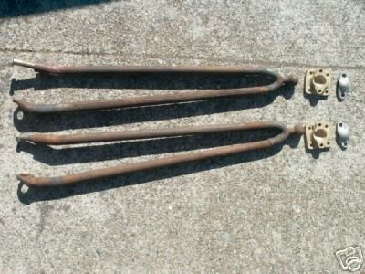

These are period radius bars -hard to find in any condition
Some DIY there are more ideas on searchinh. Also you need to realize that some drop methods will prevent the use of the Hassslers.
bone 2.jpg (36.3 KiB) Viewed 12914 times

Oh I should’ve been more clear I meant I could bassinet calmly leave axle stock. I know I’ll have to do something with the rods but didn’t realize there were other ways!

Not sure if the Beehive Hasslers will work with a reverse eye front spring. Take a look at what you have.

The Z bracket is the welded bracket I mentioned to you about. Cutting the wishbone and adding the A tie rod ends to plates bolted to the frame is the easiest. When dropping 5-6 inches IF running a crank the axle can be VERY close to the crank, close enough to make me nervous with speedbumps.

Small update, anything else I’ll just make another thread as this one is LONG and full of info!
Talked to Coil Doctor today, I’ll be sending my coils to him soon. Waiting on radiator to come back from shop; it was a basket case so they gonna see if they can get me by until I find a good one; so if anyone has a good radiator they would like to part with let me know! Prefer a high but will take whatever to get it going.
Talked to Sid with dropped axles, I’m trying to determine what would be the best and least expensive route to go to drop the front, either Z bracket or dropped axle. I can get a Z to move axle out front etc for free from a guy I know at a fab shop, it’s just I’ll have to move wishbones and make crank handle longer. Going back and forth it sounds like that route would be cheaper, however my hasslers will not work as they will hit the frame. Which after looking at them I wonder if I should use them idk if they’ve been greased in a very long time. 🤷‍♂️
Got an original coil box lid in today, and I also got another coil box off eBay that’s in incredible shape I can install a waterproof board for contacts, and also it has ability to use the coil box ignition switch if I wanna go that route for my speedster.
I’m creating a list of things and milestones I’d like to accomplish as I’m incredibly ADHD and I’ll start 5 things and not finish one lol this way I’ll feel like I’m making progress and can document it along the way. Can’t wait to get it moving. I’m so close!
I did find an interesting original race radiator on Instagram but I think ima pass as it has a LOT of soldering and don’t know if it’s even good.

Post by TRDxB2 » Mon Mar 21, 2022 5:49 pm
Not sure why you feel the Hassler's would hit the frame with a Z bracket. I did say they might not work with a reverse eye regardless of what drop method you use. The Z pushes the spring and axle forward, in front of the radiator.
This shows the position of the axle, not that is a very high Z
This is stock position of axle. It has a longer crank to clear the V'd radiator (forget the V'd radiator $$$$$$)
The drop axle keeps the wishbone and your Hasslers. I'm thinking that the only issue is in fitting your existing spindles into another axle, also perches are usually hard to remove but yours are likely going to be easy since the Hasslers were added (NOTE the Beehive Hasslers need to have had the stock perches swapped side to side such that the boss on top faces front

Lets look at it from two perspectives Cost and Effort
--Drop Axle
There is the cost + shipping of the drop axle. There is a question if your spindles will fit into a new axle or if you need that done as well. I don't see any other expense. But you could offset the spindle by selling the axle with the spindles in them (the price would depend on wear/condition of the bushings). There is effort in tearing down the old axle (removing hubs, and the Hasslers!) and the reinstalling them. Also this is a relatively safe way to go keeping the basic steering configuration etc. Adjusting the axle would follow standard methods. Oh, same crank
--Z Axle
There is the cost of the Z, crank, radius rods, brackets/parts on the frame and axle (cost + shipping), radius rod cost + shipping (shipping could cost long heavy items can be expensive). Not sure of the of your design. The current wishbone would be unused and available for sale if t he end ball is in good condition. The effort requires good engineering and planning. Since the Z pushes the axle forward that effects the tie rod and drag link end the connection to the pit arm (need to keep and eye on that). The radius rods need to be designed to allow adjustment of the axle, not only like stock but left & right. I think would take longer to accomplish than a drop axle

I went this way on my build. Provides a very clean drop

Where did you get the bolts to fit in the perch holes? Did you make them or have them made?

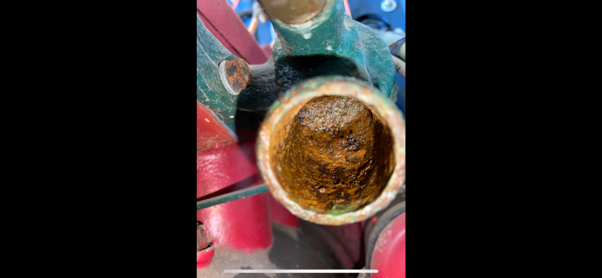

Installed radiator! Then when I started filling it with antifreeze the lower radiator pipe started looking like a sprinkler I guess cause I removed all the rust 😂. So for now, ima grab a lower hose that’ll just go straight from water pump to outlet on radiator just to get it going. Upper radiator hose was leaking bad to so I’ll grab something temporary for it as well. The petcock was leaking even tho it was closed, so I’ll put a rubber vacuum port cover thing over it until I can replace it lol. Never ends! Inching closer and closer to getting this thing moving…this week it’ll happen.

IT LIVES!!!!! I got it running today, for a long time! Even jumped on it without a seat and got around in the yard! I was so excited! I’ll upload a video I took…like a kid in a candy store lol.
Put 3 gallons in radiator; no leaks. Put a rubber cap on petcock since it leaked and it worked good. Carb petcock leaks like a sieve, and I was wondering where all the oil was coming from apparently the oil line to trans cover wasn’t connected…just sitting there lol so installed and tightened that!
When I got it back in shop I opened oil petcocks and drained the oil. No junk, came out easily and looked good. Left it open to drain out for a while and gonna refill when I get back with my son from school. Now….to start cleaning things, adjusting, oiling, greasing etc, and get it ready for the next stage.

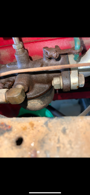

Well before I do anymore with the coils etc, since I know it runs, should I rebuild carb? Or leave alone? I do need to change the petcock which surprisingly stopped leaking which I’m sure is just the bowl empty although tank has gas in it.
Saw the petcocks for radiators and carbs in the classifieds, but nervous about trying to remove radiator one since a rubber cover works perfectly and I’m not potentially damaging radiator lol.

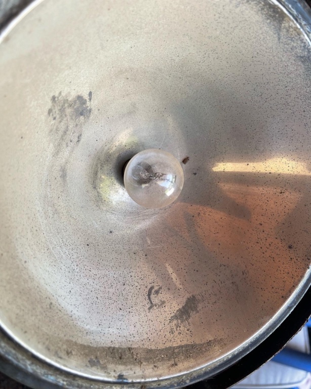

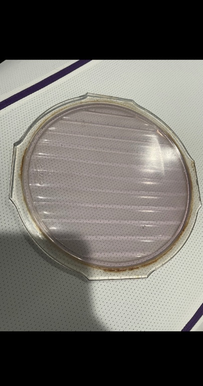

I picked up 2 T headlights off of Instagram, look to be “Barn find” originals. Rings were a little stuck so sprayed some Kroil, pushed on both sides (10 and 2) and it rotated like brand new. Turns out it was dirt and dead bugs that was stuck in there. Still got the cord bulb! 😂

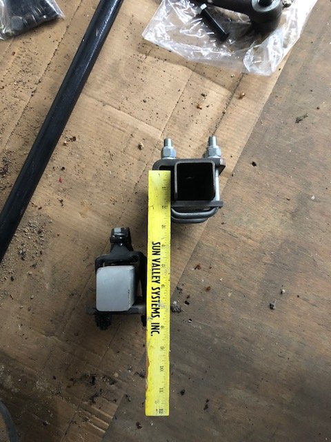

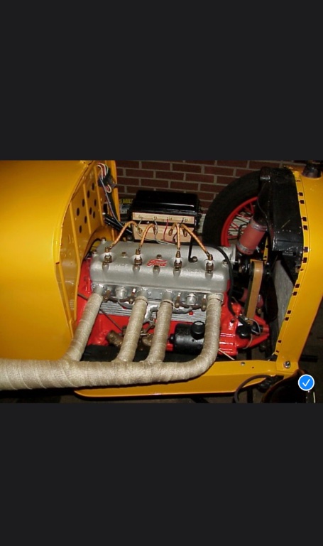

Post by Guardian1fox2 » Mon May 16, 2022 8:17 am
Got a new rebuilt carb coming, bunch of parts, just a lot of stuff I needed, new pipe, hoses etc. Finally getting to knock some stuff out. Replaced the ignition switch back plate…started it up and magneto works! Couldn’t get it to before cause the switch was so bad.
Ran it for a while other day, longest I ran it yet. I removed gas tank and started basically staging things where I’m most comfortable. Started removing the closed car cowl and almost got heat exhaustion…got nauseated, sick…so I called it quits…then I’ve been working.
Got carb off to ship off as a core, muffler was about to fall off so went ahead and removed. I want to do a lake style header and found multiple posts etc on people on here that have done them. I got the u bend pipe, and cone, but I have a question. I was searching the forum and found basically what seemed like an engineered drawing of a Model T intake/header plate dimensions…and now I can’t find it. I wanted to grab some 1/2” bar steel, and have it drilled for the intake and exhaust holes, and then have the exhaust tubing welded to it. Then for now I was going to mount my intake and carb (stock setup) using half clamp ears, similar to what I found in this pic. Does anyone have a picture and measurements of the plate?
I also saw the ModelT to A adaptor plate, and while that would be easy, I want to use my T intake and carb. I’m sure the T intake will not fit to the adaptor plate huh?
Just got a tool in to safely remove the hasslers on the front, gonna remove them and clean them up and fit the missing oil cups.

Post by Guardian1fox2 » Mon May 16, 2022 8:18 am
Forgot to add this pic.

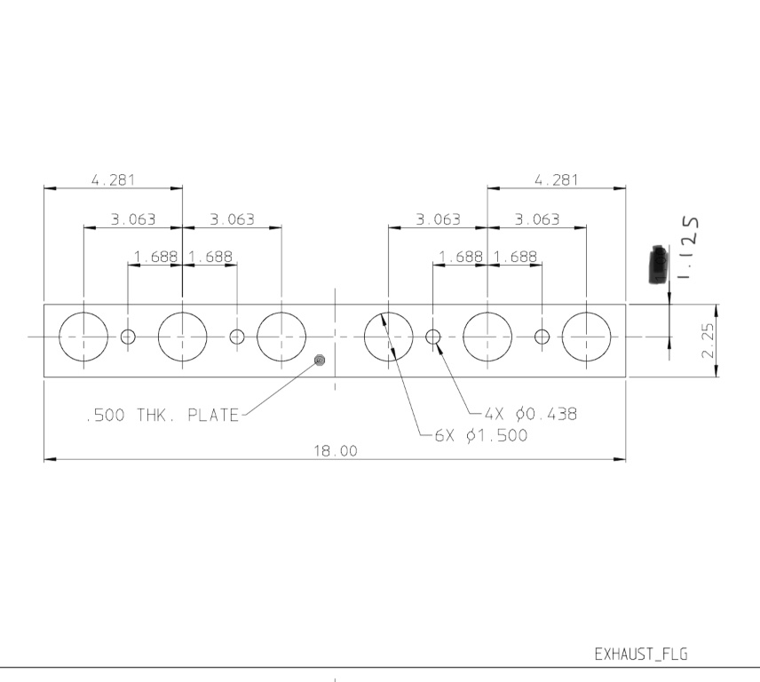

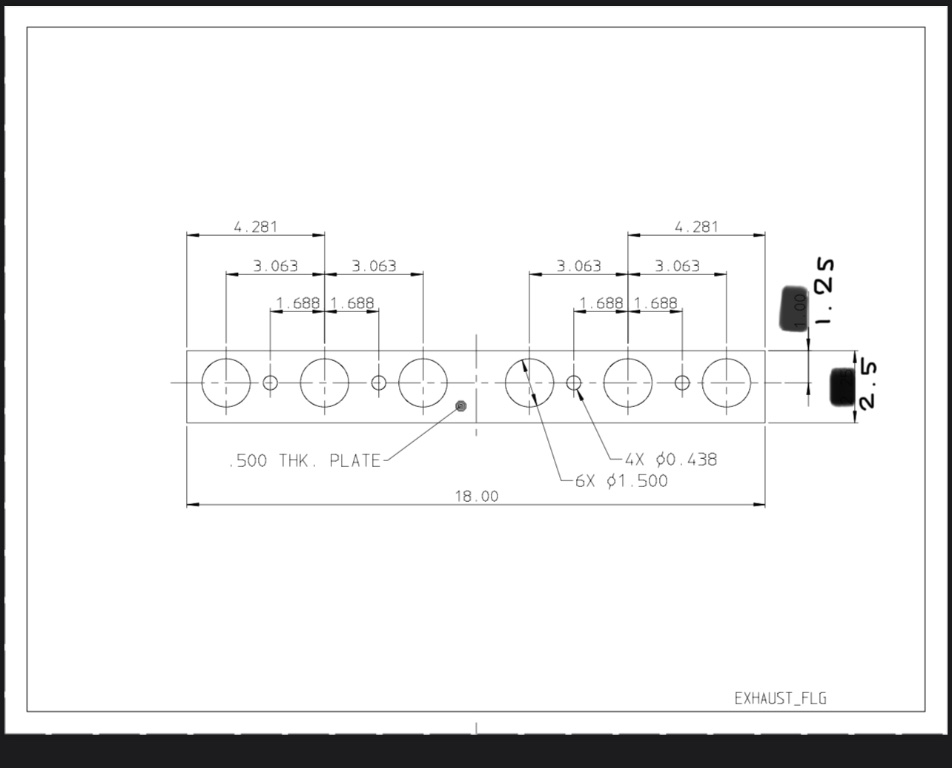

Ah found it! I believe this is the correct measurements for the model T header/intake plate. I’m gonna weld my exhaust together to this, and mount intake like pic above. Curious if I need to have some kind of indention machines into the intake ports so I can fit gasket. Not sure how others like pic above accomplished that, or if so how deep of groove to get cut into it.
I did change it to the 2.5” like the poster had suggested, here is also with center updated:

Post by Guardian1fox2 » Tue May 17, 2022 6:57 pm
Found this interesting. Removed the lenses from the 2 headlights I got from a barn find sale. After washing them they’re purple, felt it would be cool to share. Neat.
