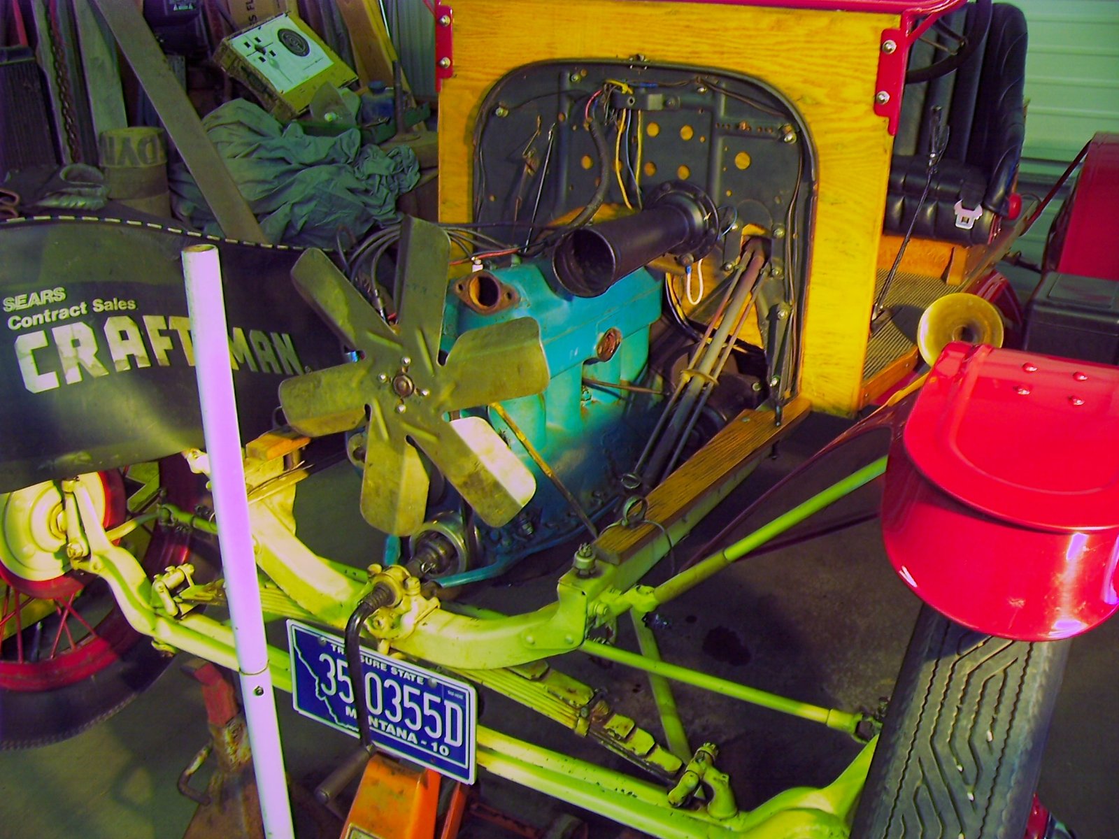

Working to find a knock in the new speedster. It has quite the fan, one piece aluminum. Also, any idea who made this distributor drive?

The new speedster has to many things to fix and adjust so I pulled the motor which will make them all much easier to fix. Going to adjust all the bearings, see what's up with the cam end play, re-line the bands and see if I have two piece valves. I'm also adding a outside oiler. Who knows what else might be hiding in there.

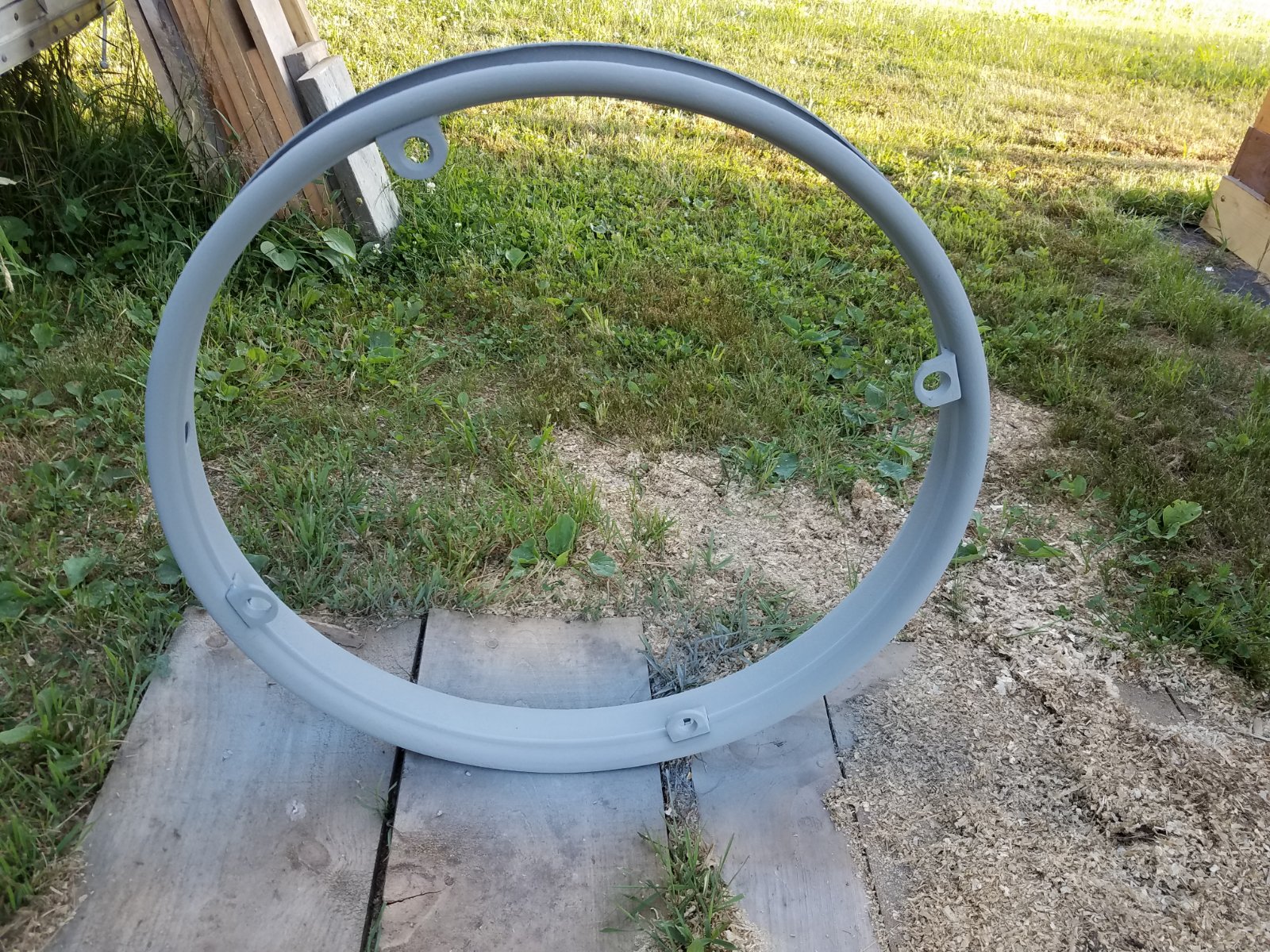

Ordered new bearings and inner seals for the front wheel I'm rebuilding. Painted the new-to-me clincher rim, and standard Ford fellow. Perhaps, now, my spokes will fit!

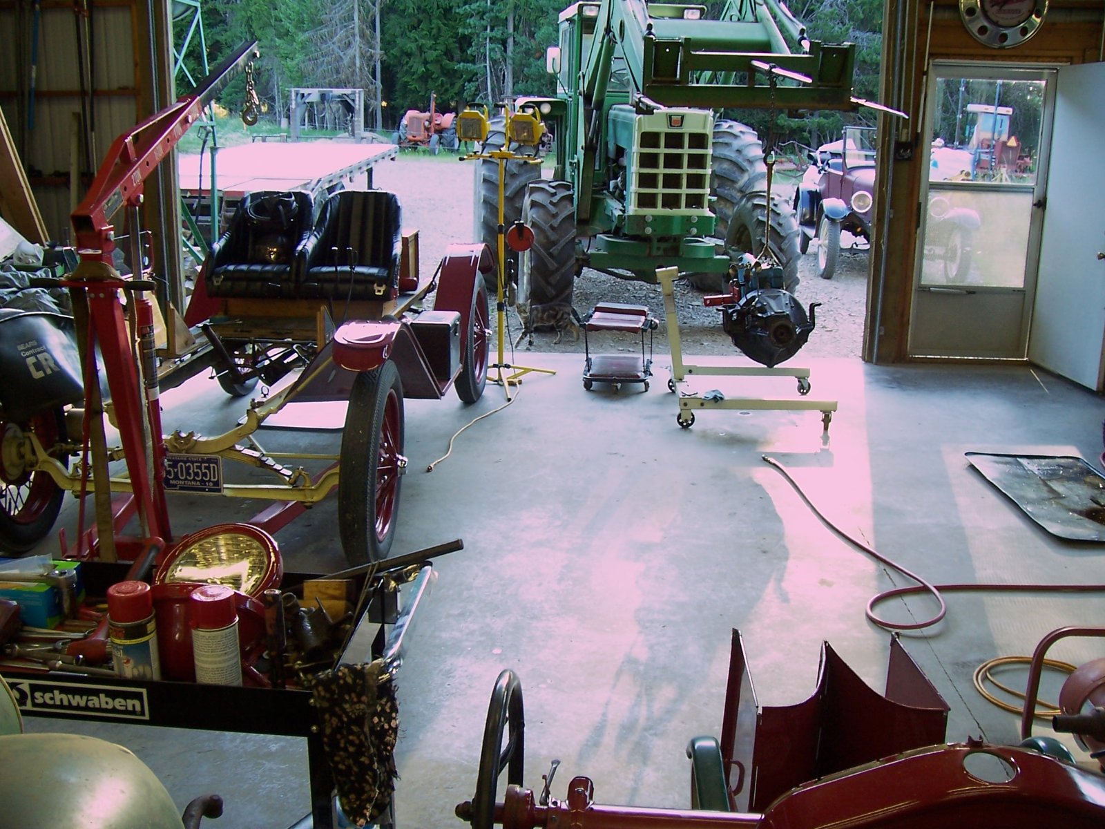

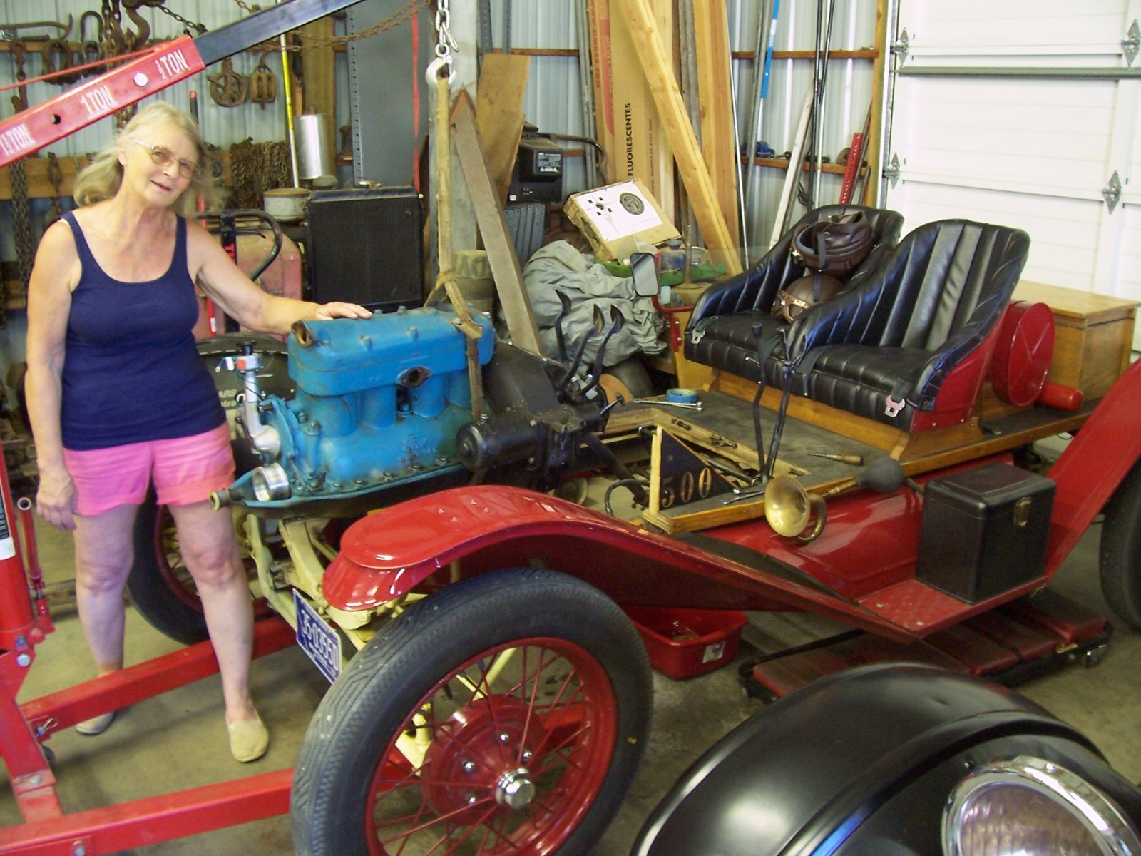

Yesterday I finished sliding the fresh engine into the runabout. Today I bolted up the ball cap, lowered the body onto the frame and installed the bolts, installed the engine mounting blocks and bolts, installed the steering column, wishbone, fan, and one valve cover. Tomorrow I'll buy gasket material and do the other valve cover, and add manifolds, carburetor, and other items. With any luck I'll greet the new month by going for a drive.

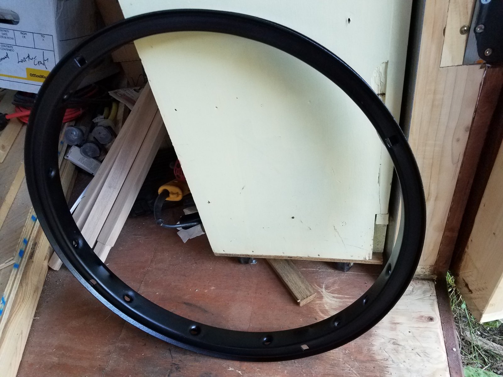

Dennis H., I don't think you are ready to assemble that wheel just yet. I may well be wrong, but from here your pictures appear to show a Kelsey felloe that uses loose lugs, and a Hayes rim, obviously with fixed lugs, kind of hard to tell from those pictures. They may go together, but they aren't made be used together. Again, I may well be wrong. Just a heads up. Dave
1925 mostly original coupe.
- Posts: 5599
Re: What have you done to your Model T in July?
Yes, Dennis - let's see the other side of the felloe - that is a Hayes rim, for sure.

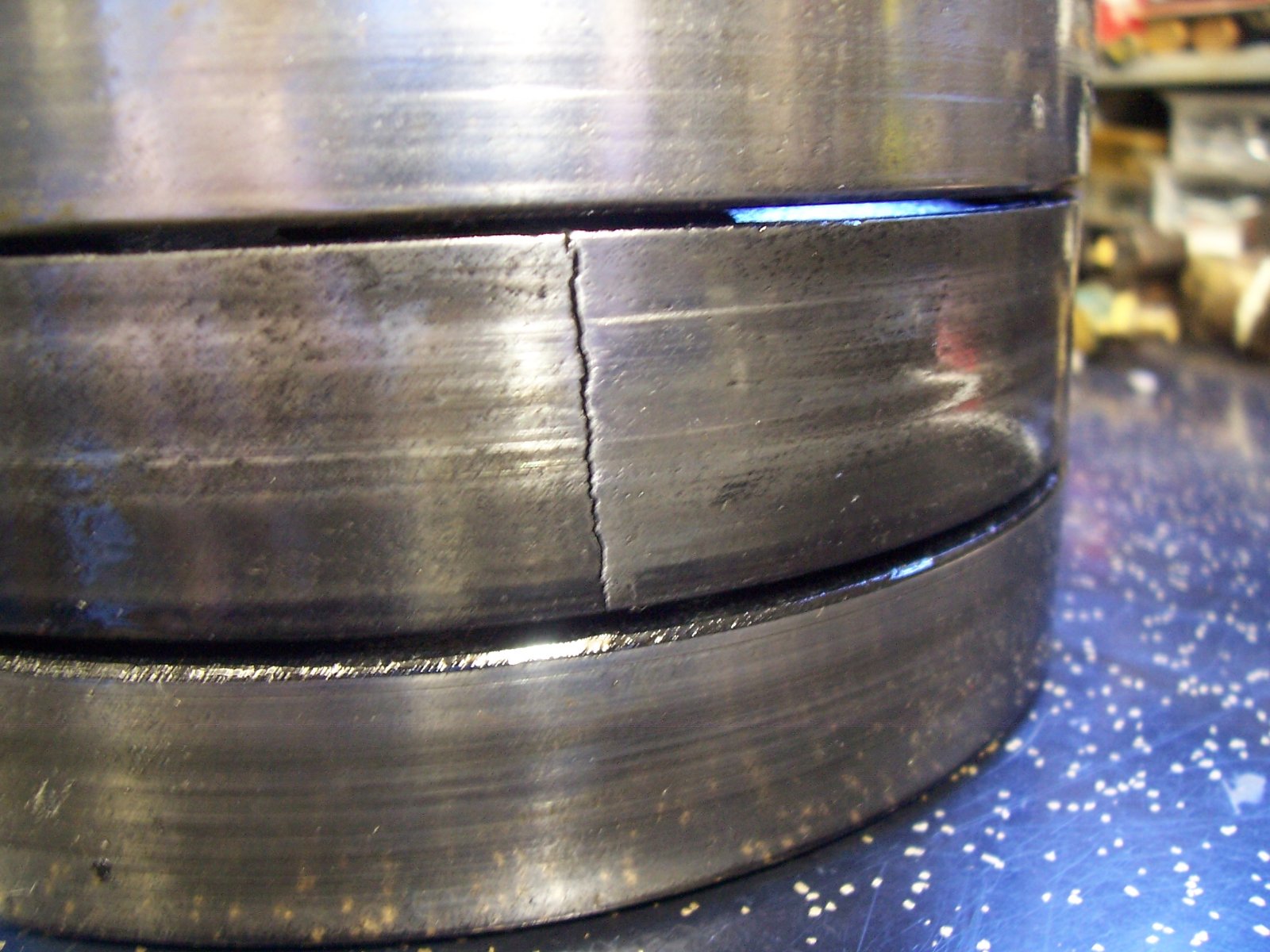

Got the motor apart today and found the clutch disc drum retaining bolt came out which allowed the clutch to move to the rear. Also found the low drum is cracked. the reverse band liner is falling apart with lint and fiber everywhere and #3&4 rods are loose. Mains this afternoon. Also has a fiber cam gear.
