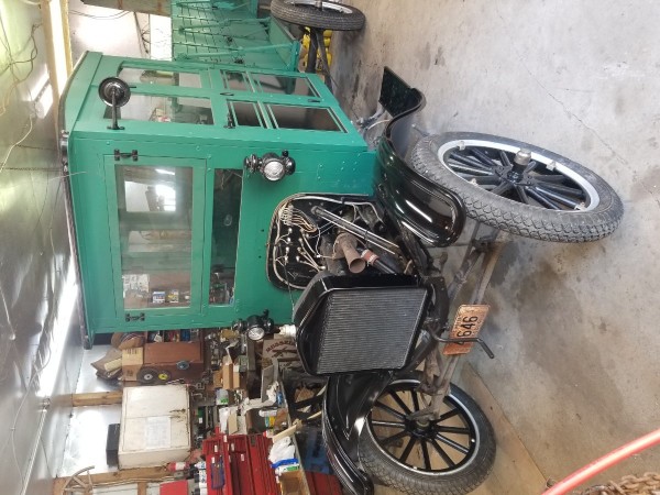

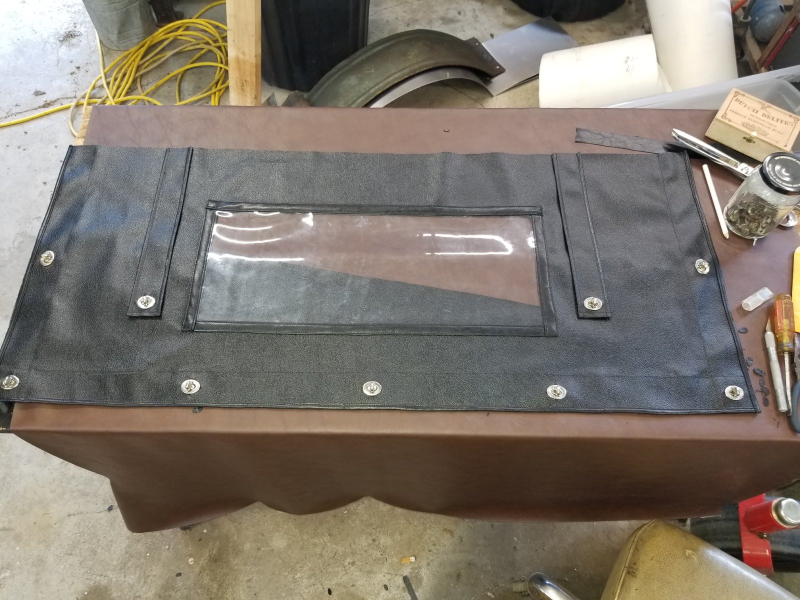

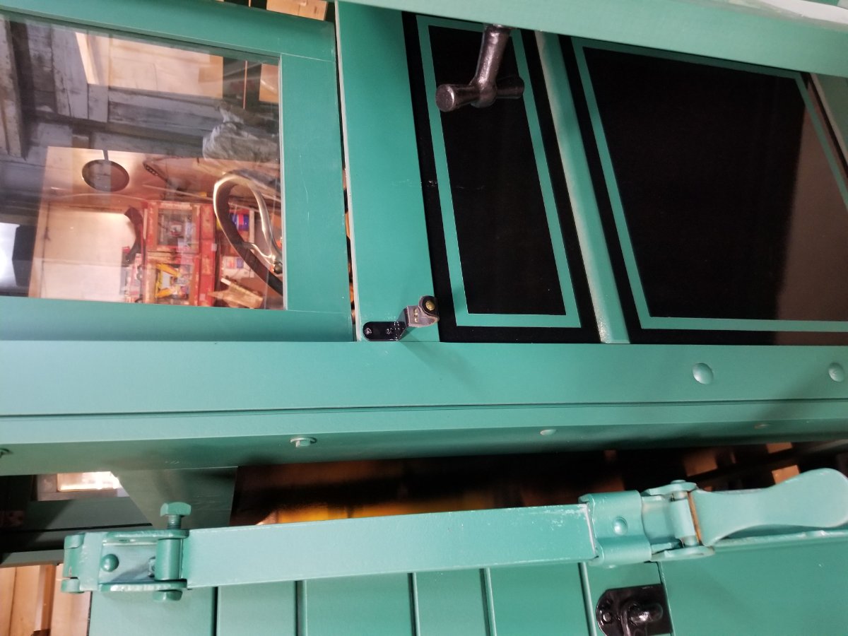

All is well with the neck surgery. I have been on light duty all week. I planned for this. I saved alot of small things that does not involve lifting. Replacing unpainted bolts and nuts with painted ones, installing needed screws, adjusting bands and painting little pieces. Today I made the door catches to hold the doors in the open position. Thanks to some drawings and measurments from Tim Morsher.
I lined the inside with black leather held in place with split rivets. The leather was soft and the split end recessed into it nicely. Dont want it metal to metal on the paint.

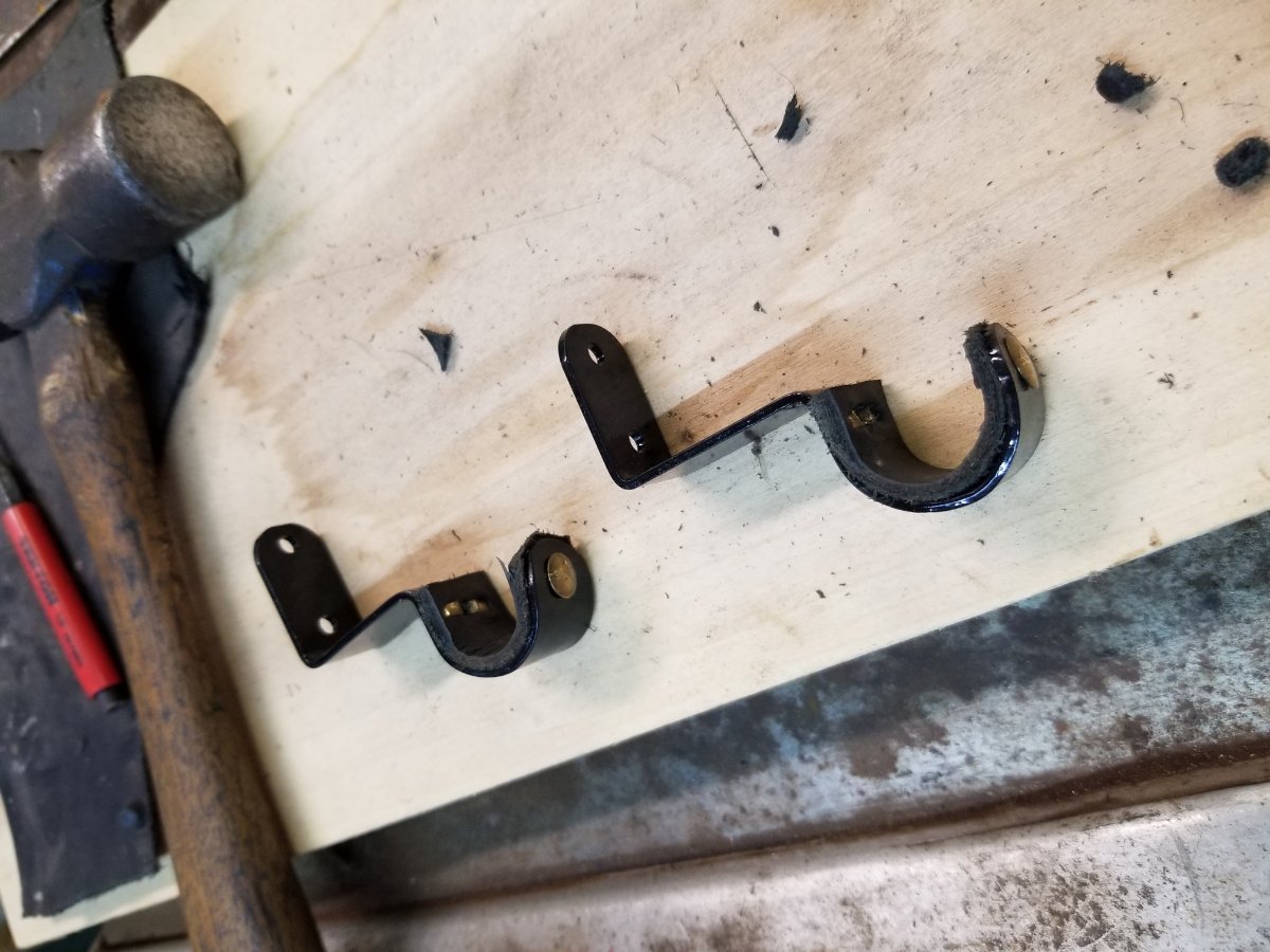

It mounts under side window on exterior of cab. The weight of inner handle holds handle in place while bouncing down the road.

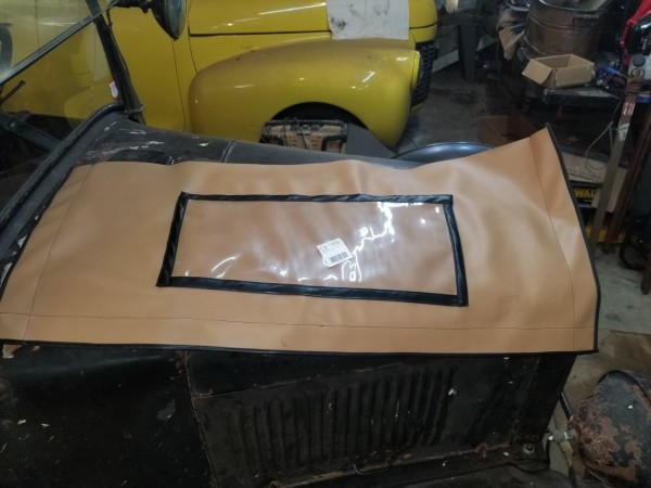

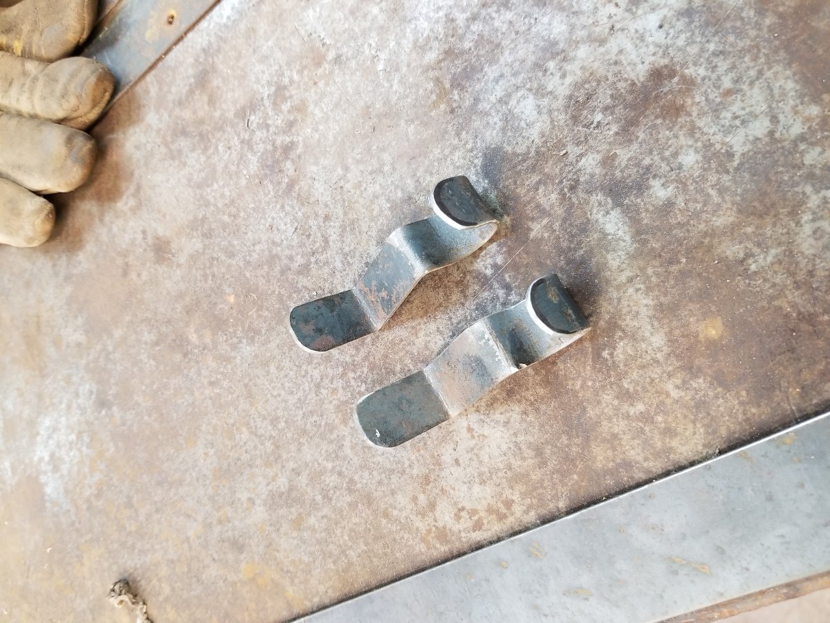

Healing up and staying busy.
Started with this
And now
The I used the flash.
I think these will be usefull on the TT.

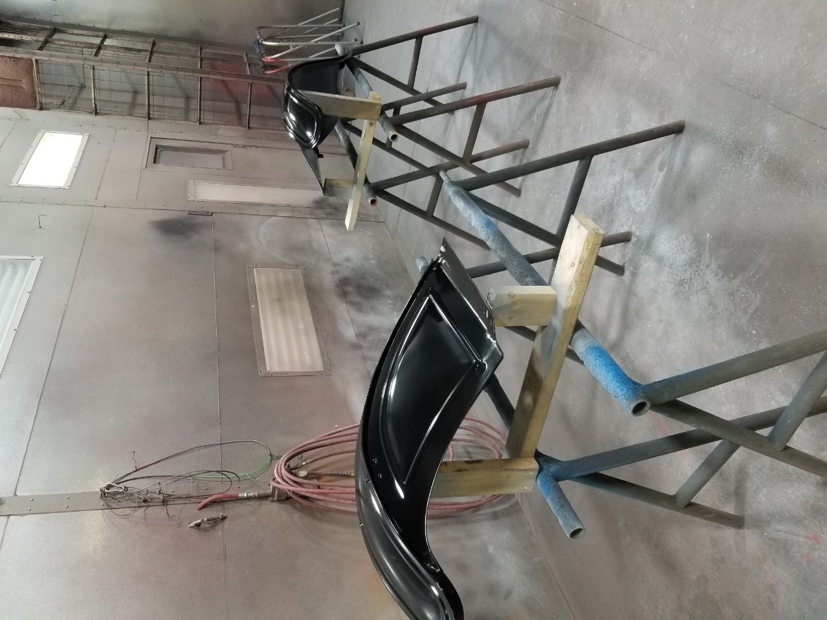

Thanks guys. Wayne I am being good. I spent today knockin tin. The one front fender looked like somebody parked their T on it. Welded cracks and brackets and have them primed. Test fitting this evening. I need to adjust one fendrr brace about 3/8 in.
No heavy lifting and no fast moves but getting there.

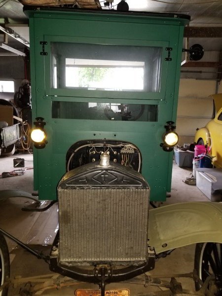

Herw are the reflectors with led in tail lights. Its daylight out and I used flash on camera.
Cowl lights with same led lights

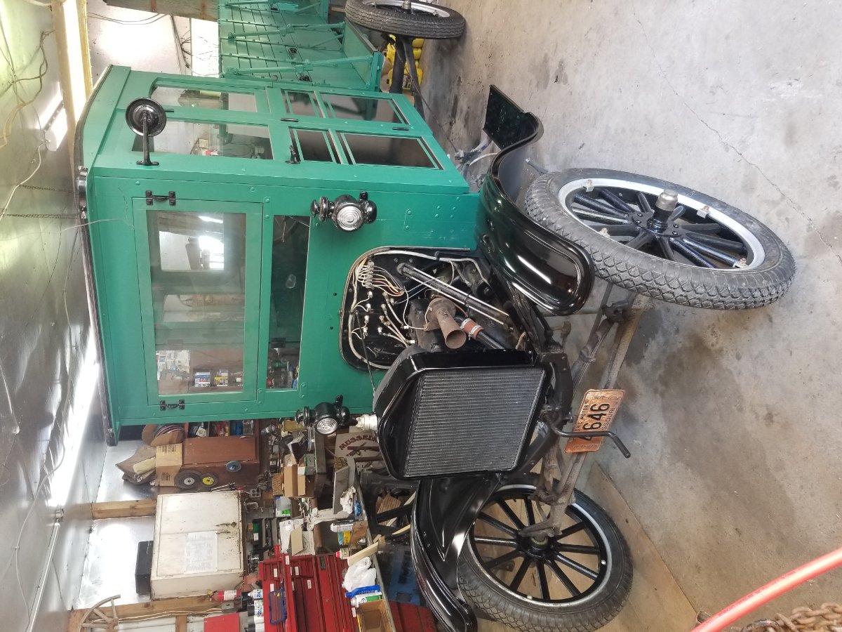

Getting close.

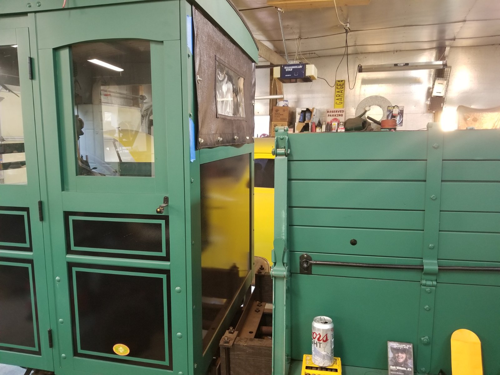

Update. Fenders and radiator shroud are on. Hope to have shelves on tonight. Still working on the hood and headlights.

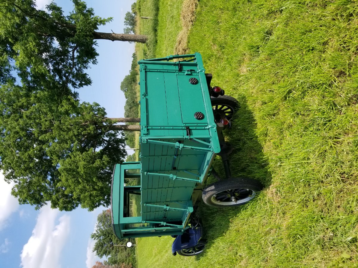

Post by Dallas Landers » Fri Jun 28, 2019 10:32 pm

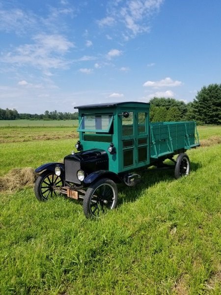

Not finished, but enough to get some seat time tonight. About dark I took it to town for fuel and road test. Snapped a couple photos I posted in another thread earlier but figured this is where they should be.
Posts: 4412
Re: 8in1 American Convertible Motor Truck Body " restoration"
Post by Wayne Sheldon » Sat Jun 29, 2019 3:20 am
Oh-h! It usually takes an incredible racing car to leave me almost speechless. A TT may do it.
Posts: 2844
First Name: Dallas
Last Name: Landers
Location: N.E. Indiana
Post by Dallas Landers » Sat Jun 29, 2019 8:15 am
Thanks Wayne, its a real treat to drive with the Chicago 3 speed. A little learning curve tho. She seems like a screamer with the high speed gears. High gear is slipping a bit after a couple trips to town so I think the cluth fingers need adjusted. Its in the shop cooling down after taking it for breakfast. The Apco explosion proof muffler has a sound all its own and when I retard the timing coming to a stop it barks a bit as the springs must be a little weak on the cutout.

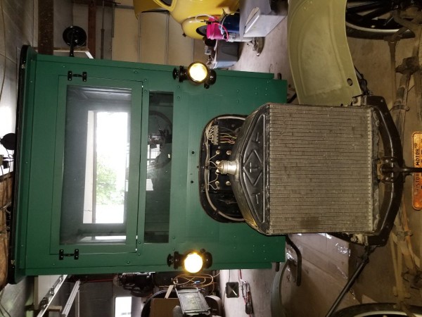

Post by perry kete » Sat Jun 29, 2019 8:25 am
Posts: 1685
Last Name: Seth
Location: Jefferson Ohio
Post by perry kete » Sat Jun 29, 2019 8:26 am
I Hope rotating helps to view the beautiful truck

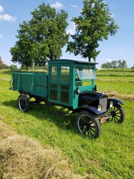

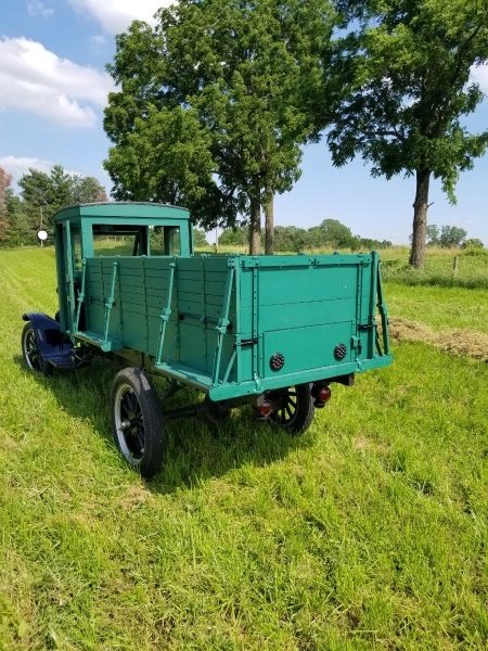

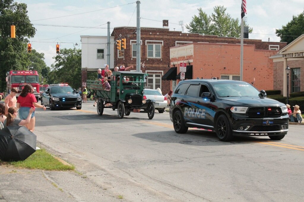

Post by Dallas Landers » Wed Jul 10, 2019 5:55 pm
I posted photos on another thread and just had these sent to me of the old girl in action. The truck is not completed but two years of sweat and head scratching was worth every minute. This is what its all about. Not that I'm a huge parade guy but seing people enjoy it and exsposing them the history of these vehicles is just fun. Candy flying from all sides helps to.
Post by Rich Eagle » Wed Jul 10, 2019 6:08 pm
It certainly has been enjoyable watching this TT go together. And now getting it out where you and others can enjoy it. Taking photos as you go is so good and nice for us to see.
Thanks for all of it.

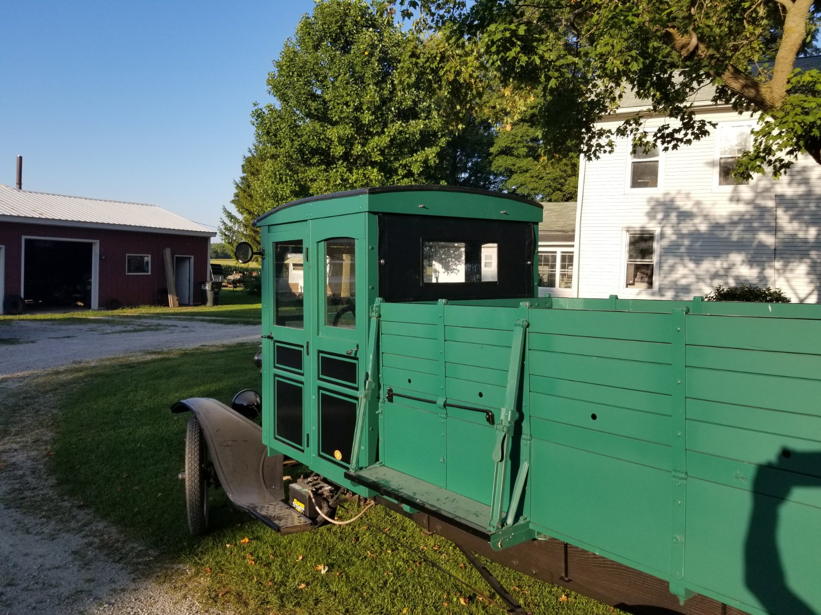

Post by Dallas Landers » Mon Aug 19, 2019 4:37 pm

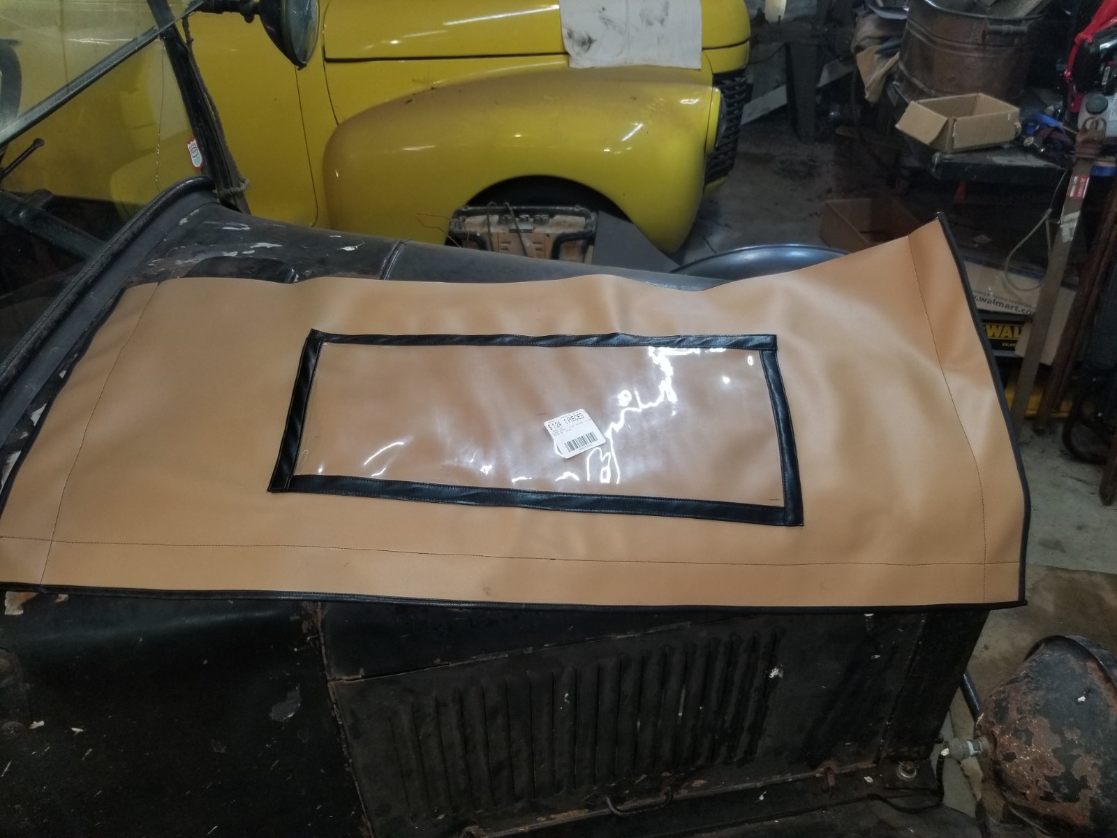

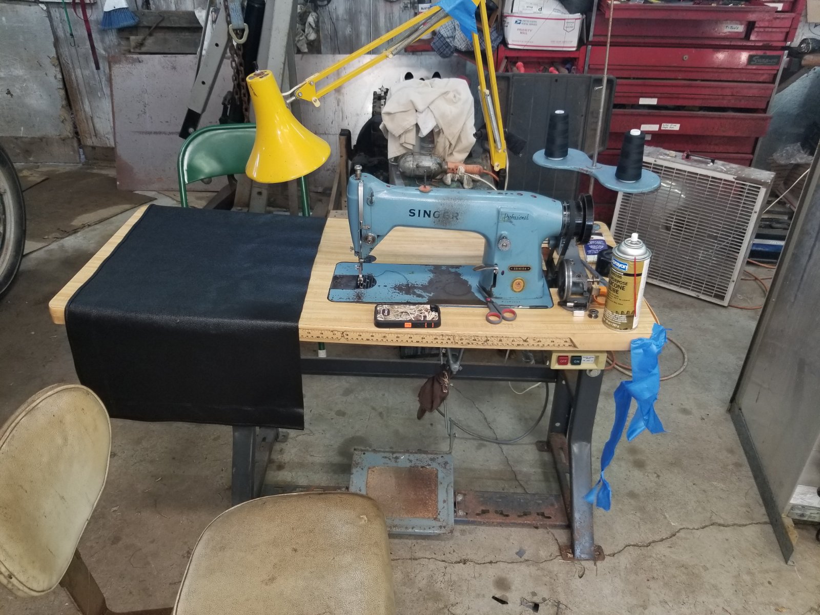

A little bit more! My folks are here from Minnasota for a few weeks. Mom brought my her industrial singer for working on these old heaps. Ive been in training on its use. We made a prototype of the rear flap for the MP cab.
After figuring and cutting and sewing on the prototype mom and Dad went to work making the rear flap.
Another piece of old equipment for the shop
Ruxstel24
Posts: 2419
Last Name: Hanlon
Location: NE Ohio
Post by Ruxstel24 » Mon Aug 19, 2019 4:42 pm
A sewing machine is a handy tool...if you know how to use one.
Not saying I do, but I can fake it pretty fair. :roll:
Posts: 2844
First Name: Dallas
Last Name: Landers
Post by Dallas Landers » Mon Aug 19, 2019 4:42 pm
Mom worked her magic
Dad helped cut and hold things in place and this is it.
Its up to me to get it installed now. The last time they were here, dad helped me hold things in place as I started making the runners for the cab mounts.

Nice work.
You've gotta love a solid old tool, like that Singer, that gets passed on to you from family.
In the near future, my dad will be giving me his Craftsman drill press and a Victor torch set. Both of them were bought by his dad right after WW2.

I will be learning how to use it. I hope I can keep the fingers clear. Mom makes it look easy. Im glad they have both had a hand in building the truck. More family memories made. Lots to do yet but at least my back will stay dry at OCF if it rains.

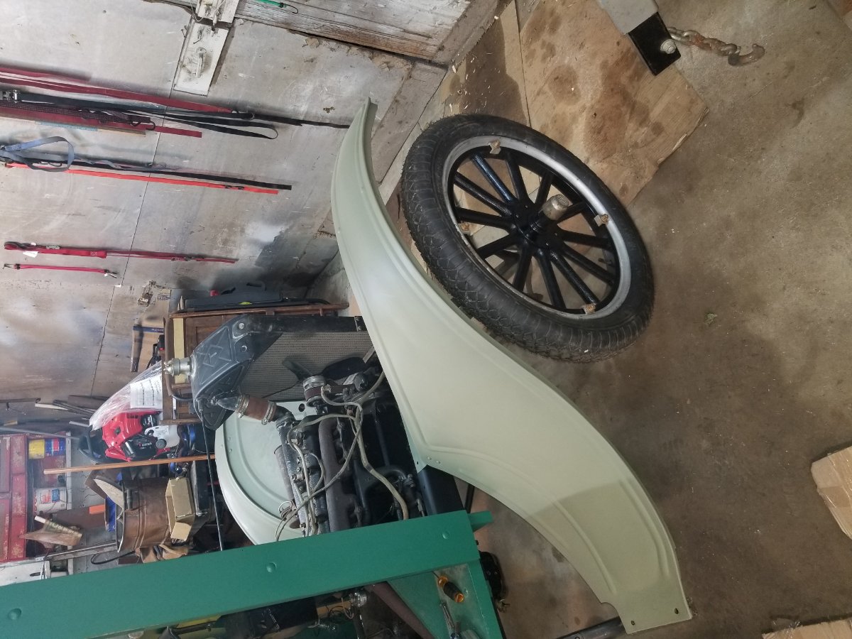

Ready
Set
Posts: 2844
First Name: Dallas
Last Name: Landers
Post by Dallas Landers » Sat Aug 24, 2019 7:50 am
Oh ya forgot this one

How are those rear fenders coming “Grasshopper”?
Hank down yonder
Posts: 2844
First Name: Dallas
Last Name: Landers
Post by Dallas Landers » Sat Aug 24, 2019 3:30 pm
Yoda, I have had my parents here for 3 weeks. Spent time with them instead of bending tin. OCF is two weeks out so it will have to go fenderless but after that it will be priority. I will finish rear flap this evening.

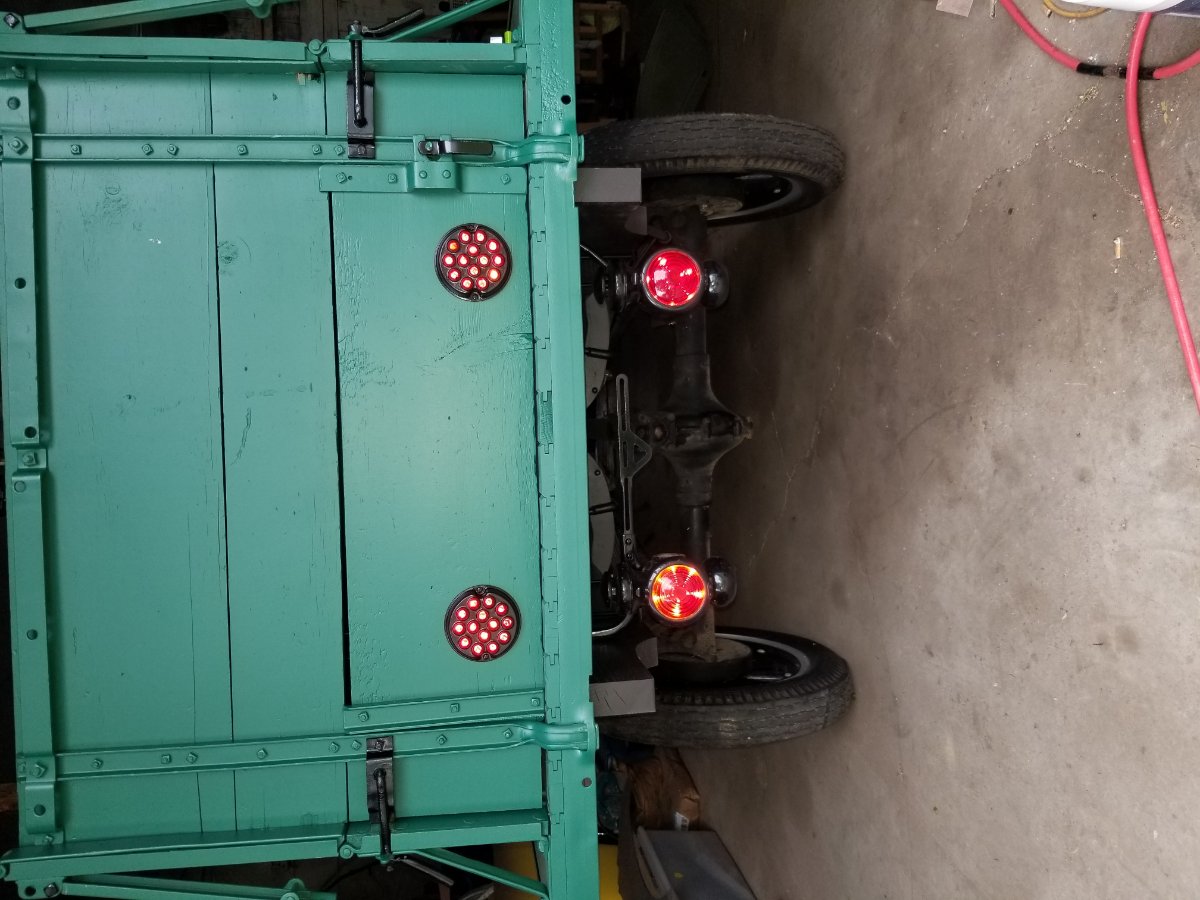

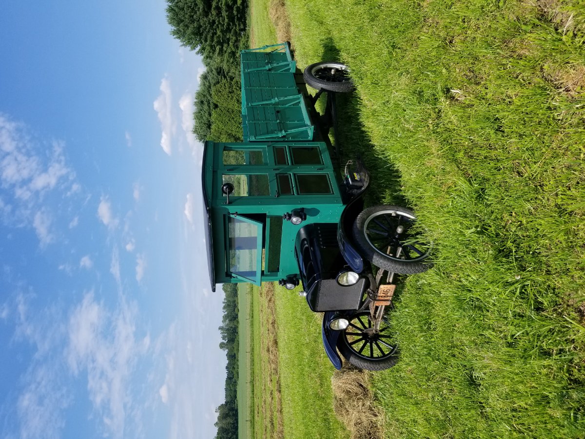

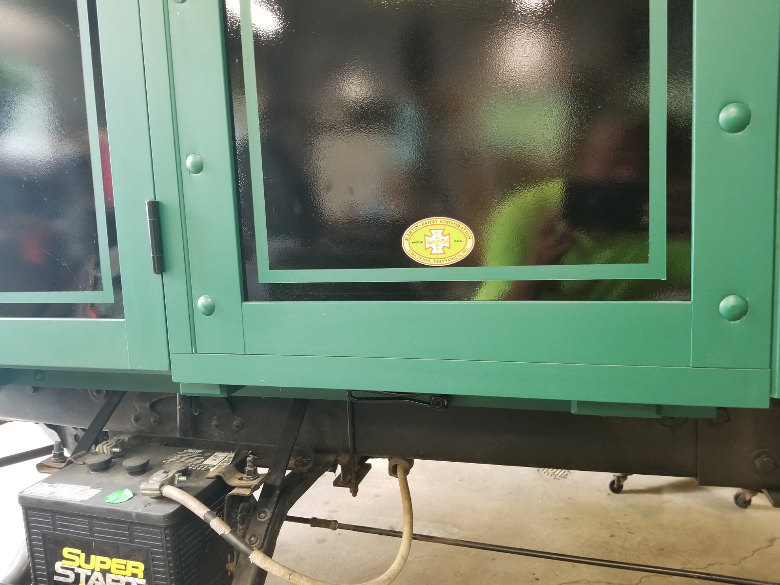

After sliding the bed back which removing 16 bolts to install the flap, its installed. After a run for breakfast in the morning it will get all the feed dust from the barn washed off. Gotta get ready for OCF!
RustyFords
Posts: 1559
First Name: Don
Last Name: Allen
Location: Houston, TX
Post by RustyFords » Sun Aug 25, 2019 8:08 am
That looks really nice.

I did notice the ICE COLD BEER on the bed! You da Man!
In all joking aside, Dallas, that has to be the coolest TT I have ever seen. You have done an EXCELLENT JOB and something to be proud of.
