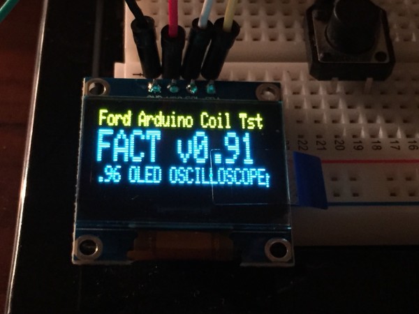

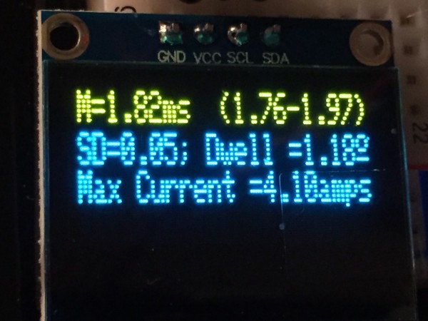

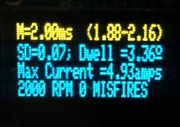

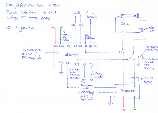

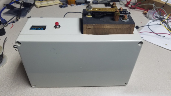

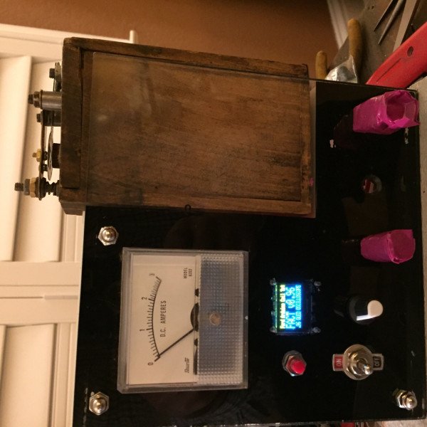

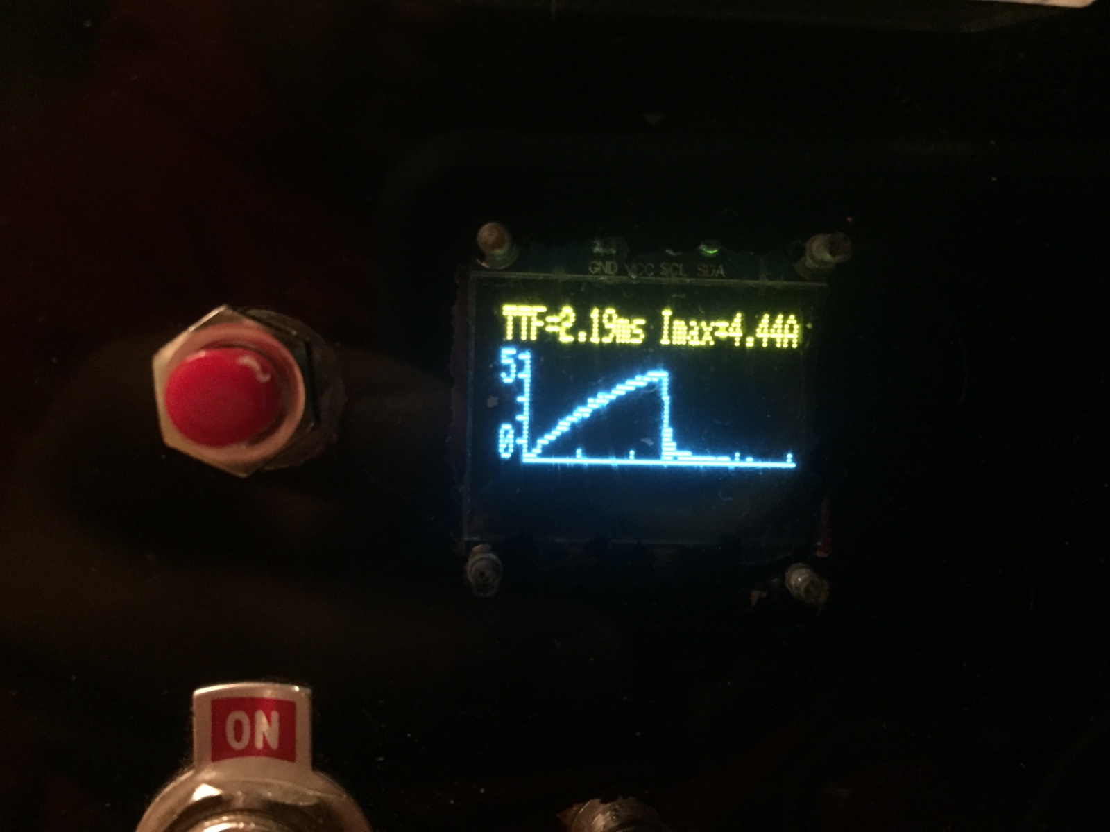

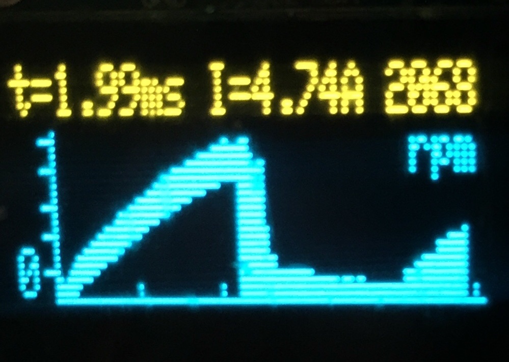

Perhaps time for brief recap on the tester.
Remember this came about because I was having trouble with my T and had thought it might be the coils. As it happened it wasn't, but by the time I determined that I'd started down the track of making a tester to check the coils out. I'd never seen a HCCT for sale here in NZ, and I didn't then know anyone with such a beast, so it was necessary for me to make something. Since I could I thought I'd make an electronic tester that might even be more accurate than the original 'old school' machine :idea:
I was further encouraged to do this because a while ago I'd been given some chassis gussets from Chris, another local T owner. This was helpful to me, and it seemed to me having a usable tester was something I could do in return should Chris' coils needed setting too. As it turned out he had a homemade HCCT but I thought it worth carrying on nevertheless. Taking it one step further it seemed it could be useful to release whatever work I did as 'open source', potentially benefiting a wider range of T owners.
The result has been gratifying, there's been quite some interest, several people have contributed to the project and we've got a more or less working tester that runs via a PC. It appears to have stimulated a fair bit of related discussion on testing methodologies too. Given the open code it allows for changing as needed so that useful data can be sent to a PC for later analysis (from which I hope some more information may fruitfully come in time).
However the tester I had in mind should be portable and able to work anywhere without connection to a PC. The original idea was a small unit that would simply, easily, and reliably test coils to see if they were 'in spec' and assist in adjusting the coils if not.

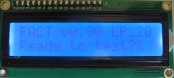

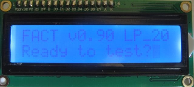

To this end I've just completed the connection of the LCD screen I had in mind at the outset, thus making the unit truly portable and able to run without connection to a PC. This doesn't finish the project because there is still quite some further beta testing and improvement/ironing out of any bugs etc to go. Additionally, having decided it would be useful, I want to add a capacitance meter, and possibly a rudimentary ohmmeter in case of any tracking between terminals across the wood (or a leaky capacitor).
However the code as it stands would make a working portable unit, so I include it here for anyone that wants to try it out. As a result of changes over the short life of the tester the original block diagram is now obsolete, so you'd need to follow the thread before connecting anything up. I won't produce a new diagram until I've settled on the other two test functions as they will require some additional wiring, but the intent is to make the basic unit even simpler to connect up than before.
Once that's done,and when the tester is more or less finished Martynn has kindly offered to draw it up so as to make it easier for anyone that wants to make one. Given this, and the attempt to 'modularise' the system I hope it should be reasonably straightforward for someone with minimal electronic experience to construct the tester, should they be interested.

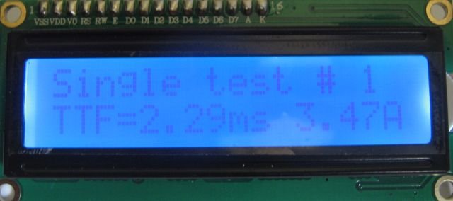

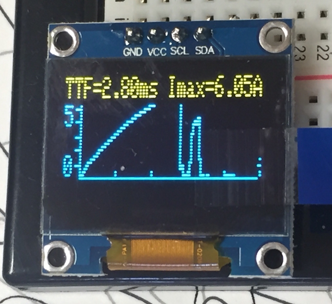

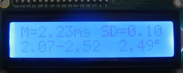

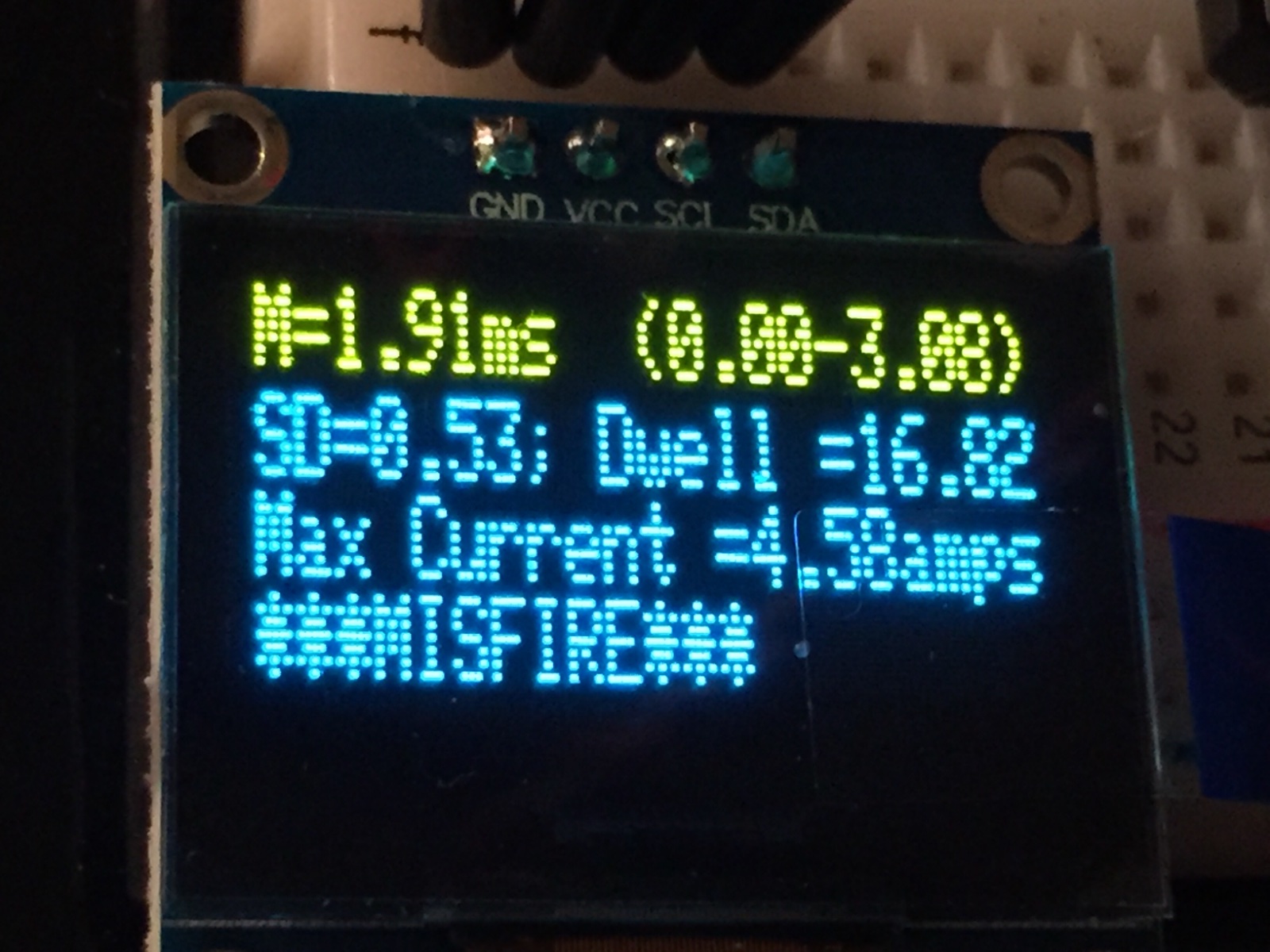

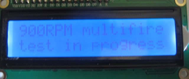

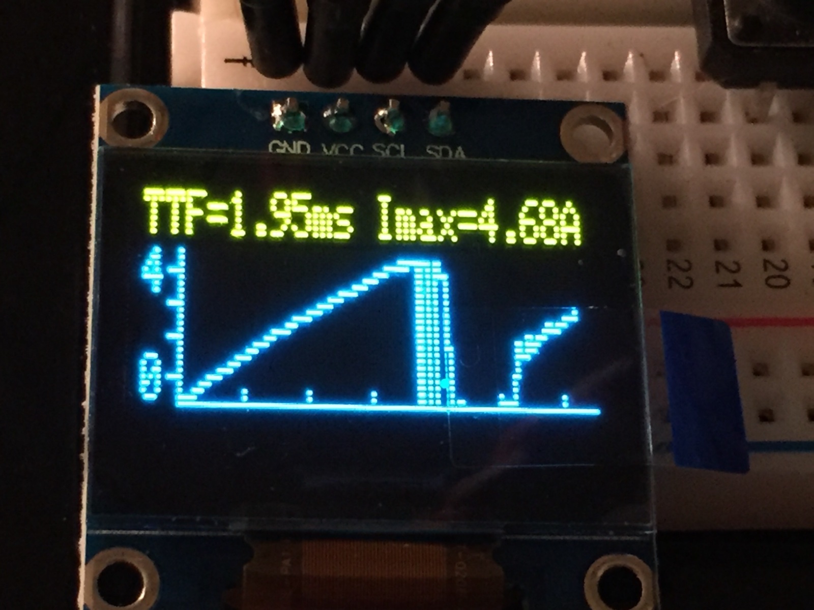

Here's what it looks like presently:

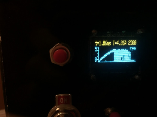

Startup display - showing software version and build number

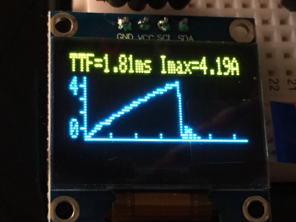

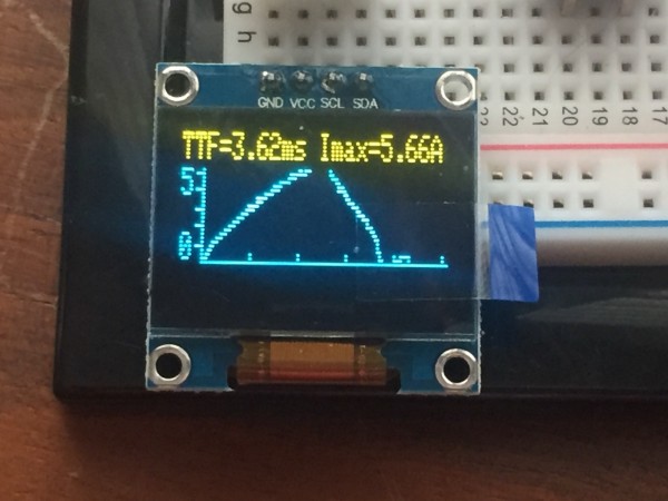

Single-shot test results showing test number, time to fire in msec, and current in amps.

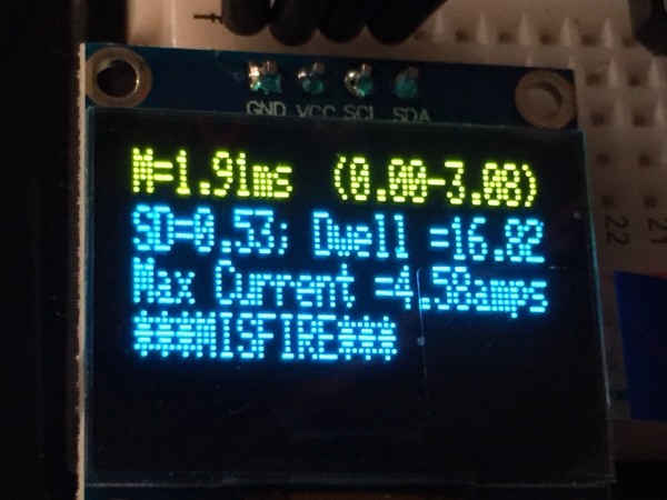

Start of multi-fire test showing RPM set
Results of multi-fire test showing mean firing time, standard deviation, min/max firing time, and degrees of rotation variabilty in firing time across the test (bear in mind this is a sick coil - JohnH's results suggest we'd expect a much smaller jitter).
Still a way to go, and as always keen to hear from anyone with suggestions/contributions and results of any tests you're doing!
Here's the code:

    lcd.clear();
    lcd.setCursor (0,0); //set cursor first col, first row
    lcd.print (F("M="));
    lcd.print (results_mean);
    lcd.print(F("ms"));
    lcd.setCursor (9,0); //set cursor 9th col, first row
    lcd.print (F("SD="));
    lcd.print (results_std_dev);
    lcd.setCursor (0,1); //set cursor first col, second row
    if (miss)
        lcd.print(F("***MISFIRE***"));
    else
        lcd.print(results_min);
        lcd.print(F("-"));
        lcd.print(results_max);
        lcd.print(F("  "));
        lcd.print ((results_max - results_min)/(float(60000 / rpm)/360));
        lcd.print ((char)223); // let's print the degree symbol!

             lcd.print(F("test in progress"));
             multi_test();

Hi Luke,

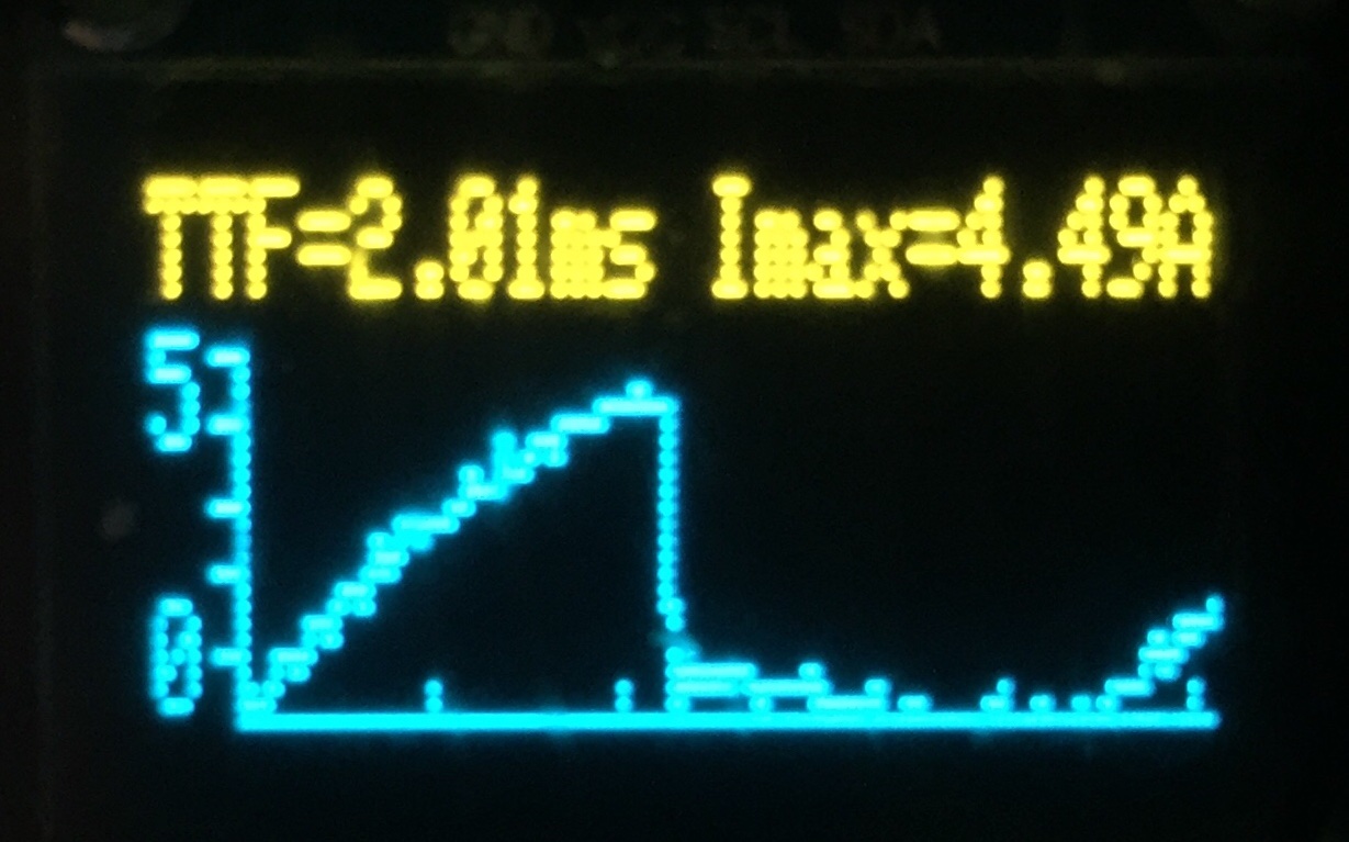

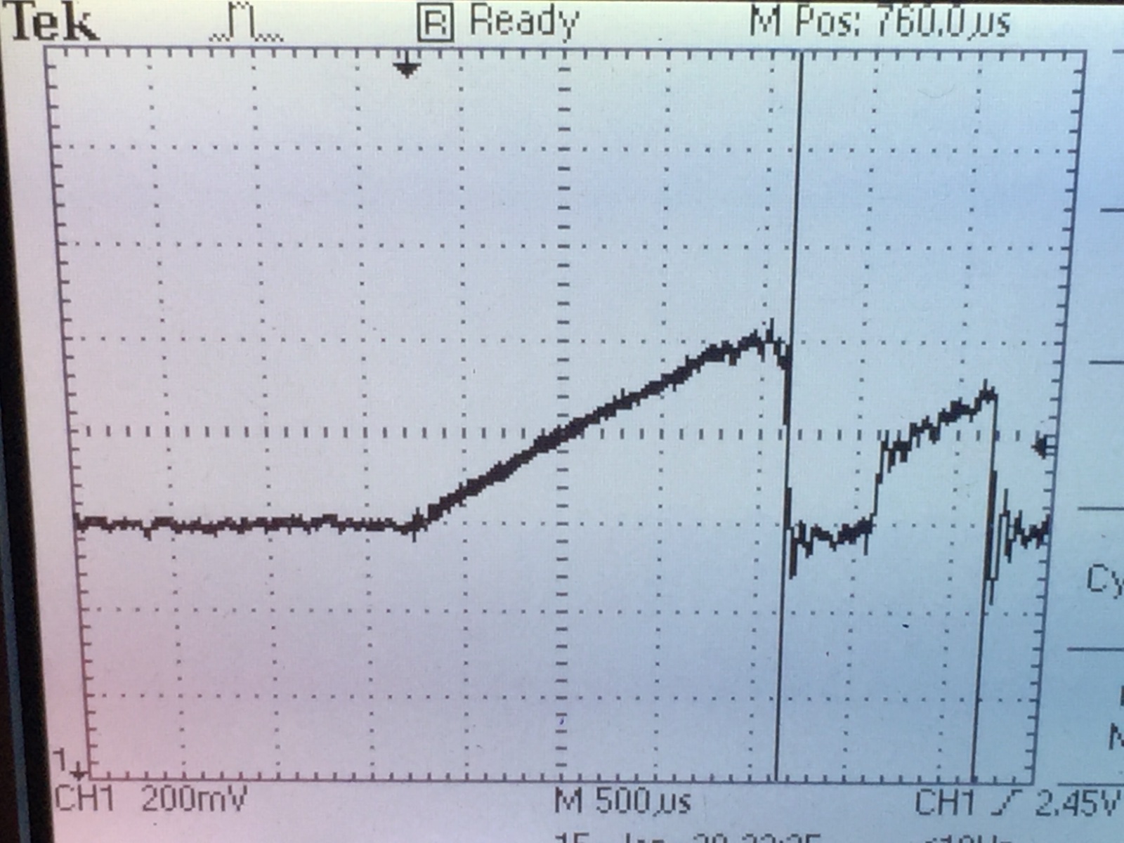

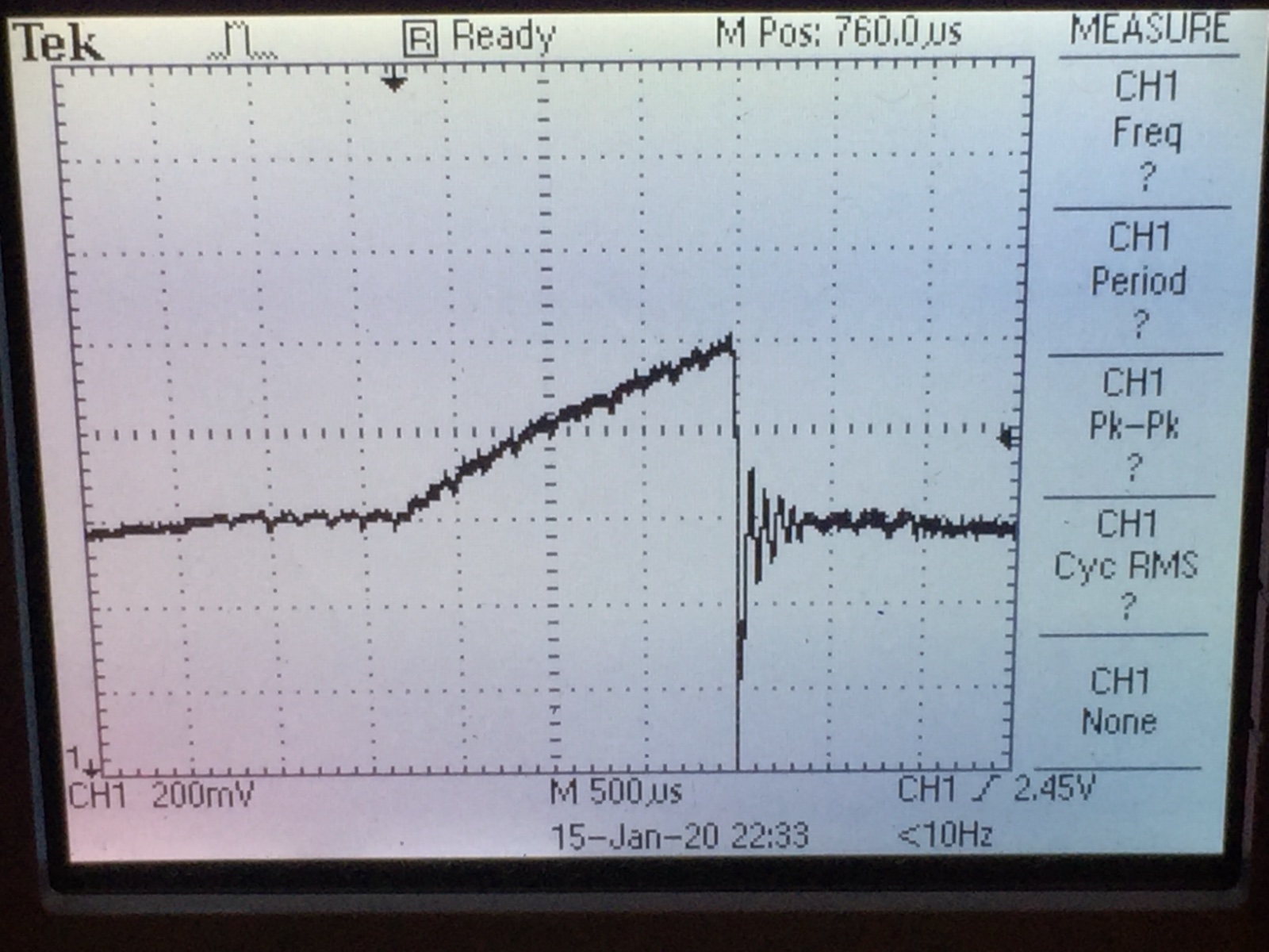

You asked... "To that end if you had a 'scope (or used the earlier code with the python plotter) and could could confirm that your 3.x msec is the main ramp and decay, or something else, I'd be keen to know?" ...Hope this helps.
VERY keen to see latest block diagram with the addition of the screen.
Matt in California
Posts: 823
Joined: Sun Jan 06, 2019 5:42 pm
First Name: Matt
Last Name: G
Location: California
Re: A new DIY electronic coil tester.
Post by Matt in California » Thu Jan 02, 2020 12:02 pm
Luke,

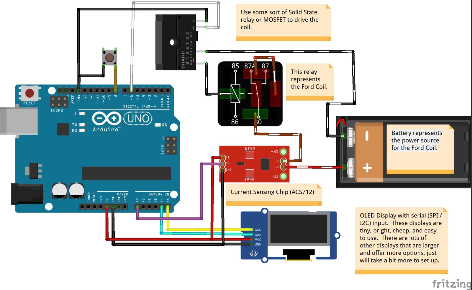

I wanted to confirm the latest Bill of Materials (BOM):
  • Price part # Description
  • $8 ATmega16U2 ARDUINO UNO R3 Development Board & USB Cable
  • $2-5 ACS712 Current Sensor Module (20A?) for Arduino
  • $3 L298N DC Stepper Motor Driver Module
  • $3-5 ??? LCD Module for Arduino
All prices are from ebay. Prices very depending on shipping location (i.e. China = waiting time).
I bring up the BOM just to confirm for myself, but also so that others can get an idea of how much the electronics cost.
Matt

John,

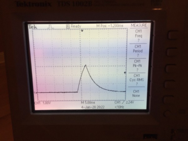

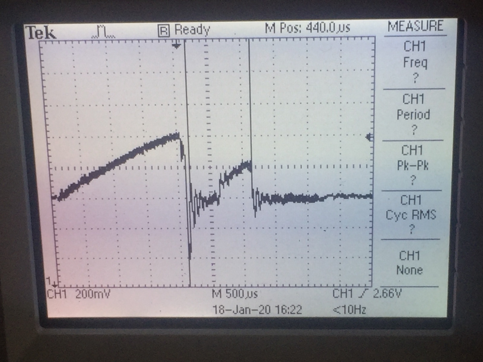

Thank you, that's very helpful - your trace seems to me the epitome of what I'd thought a good coil would look like, with the possible exception of the plateau time, and with no further spikes I expect the tester will be reporting just what the trace shows.
A couple of things arise. Having re-read JohnH's article; he has good to reason to suggest that around 2msec is a good fire-time for a coil running on 12v, and more than 3msec for one at 6V. I agree with his logic in that it's more efficient and better for the coils themselves to not be on for any longer than they need to. If you're testing yours at 12V then, particularly given the plateau 'length', it seems to me it could be brought back from a timing perspective to less than 2.4msec or less.
The other is that (also given the plateau) if you're not showing any more than 4A (which I think would be right after you adjusted the ACS712 sensitivity?) then a 5A version of the sensor would be fine. It would give a little more resolution too. Should we get an overcurrent for any reason then, given how we're using them, I believe it shouldn't destroy the device as the datasheet says the devices may be operated at higher primary current levels (prov temp is kept down).
My only hesitation on that is that we've not tested many coils (at least I assume you've not!) and although the current level is in rough agreement with what JohnH reports, and what I've found, it is quite a bit less than Mike Kossor has reported in his posts, utilising his machine. It may be that Mike is also taking the reverse current peaks into account, or there's something else we're missing so until we've tested a few more coils I guess the jury is out on that. Mike?

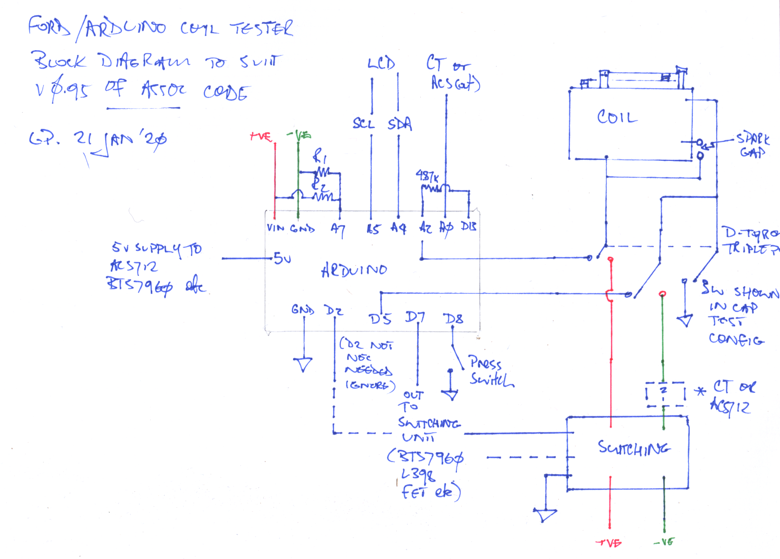

I'm happy to put up a block diagram but in order not to have to do another in quick succession I'd like to get a working cap tester first so I know what pins I'm going to use :-)
Matt,
For me things from eBay take roughly the same length of time as direct from China, and they're generally more expensive - certainly the shipping is - so my BOM would be approx ($USD):
Arduino Nano $2
ACS712 20A $1.40
L298 board $2
Pushbutton switch $1.60 (that's for 10!)
i2C 16x2 LCD $1.95
I think I'm going to order some 20x4 LCD's for something else so will try one of them in this project - it'd mean a more intelligible display, not having to truncate things the same. The cost for them is around $3.50 so even with that the cost comes in well less than the $15 I mentioned. If we add a resistor or two and another switch to include a capacitor test then maybe we're getting closer! Mind you I've assumed that one already has some wire and a box to put the completed tester in (and a 6-12V source)...

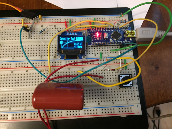

Luke,
The BOM is very impressive. If we working as it seems to be, it is well worth it. I have on order the ACS712 & L298 boards. But for now I I played more with with the MCCT and the Current Transformer. The results are looking good, but I imagine with the MOSFET switching things it will look a lot better!
LCD
As far as a display I agree a four line display is desired. I have also seen some displays with pushbuttons. That may be desired, so people don't have much soldering.
Capacitor Test
I think you could do a capacitor test buy adding a large resister in series with a output. Additionally you would want to connect a analog input between the resistor and cap. Don't forget that the points must be held open perhaps with a small piece of paper.
Matt

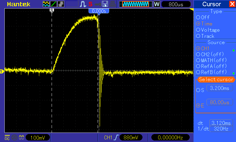

Some results from experimenting
Post by Luke » Sat Jan 04, 2020 2:04 am

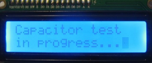

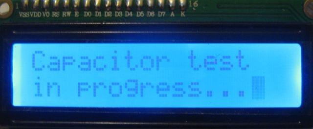

I was going to code in the capacitor tester today but got sidetracked for several reasons.
One of these was that, in wanting to make this easy for people to replicate I'm not switching the coils the way I would do it personally (using a FET), rather I'm using a module that essentially just requires one to screw in a few wires. These modules also nicely cope with back emf, so no need to have a flyback diode etc.
Unfortunately this makes it a little harder to easily switch in and out the capacitor tester. So while I was thinking about that I thought I'd see what happened when I paralleled the two H-bridge outputs of the L298 I was using. I had wondered if it was current limiting at one point (although it wasn't apparent on the 'scope), so this seemed like a way to allay that thought.
As it turned out this gave a usable boost in current handling (the 298 is a bipolar device and as an H-bridge it has a fair voltage drop) and I could get more current at a given input voltage than before. This led me on to think about another module I had here (after making a balancing scooter some years ago - a.k.a. a segway) that could be even better - a BTS7960. This is a FET switching half-bridge with low RON and easily enough capacity to handle a Model T coil.
Having connected that up I am of the view that it's a good thing; I can now show upwards of 6A at 13.5V in, mostly I suspect due to the much lower voltage drop.
However the really interesting thing was (thinking of Tom's enquiry) when I lowered the input voltage to the coils. What I noticed was that although the current went down (and thus energy out) the timing became less erratic. If I tried a coil at ~7V it may show a SD of 0.01 and a 0.31deg variation in rotational timing at 900RPM, but if I lifted the same coil to say 13.5V it could give a SD or .12 and 2.1deg variation or so (note I'm just quoting typical results, there was some variation between each test).
Although it's a small sample set I have now tested three coils and they all show the same characteristics - timing scatter reduces at the lower voltage and, to take an example of one coil, ttf increases from ~2.2ms to ~3.5ms [mean]. I expect the latter, but not the former.
My initial thoughts are that this could be due to points bounce with a more vigorous magnetic field (and therefore contact/arm movement), however this is just surmise and I would be interested in other comments/ideas?

Luke,
to be clear, are you saying that the coil takes LONGER to fire with higher applied volts?
Mike Kossor sent me this and I posted it on another thread on June 6th:
Firing Consistency Degradation.pdf
(1.58 MiB) Downloaded 471 times
As you can see Mike documents the same issue. The standard deviation is larger with faster RPM. I would guess this is due to a shorter settling time on the points/springs.

Chris,
No, the ramp time for the coils increases with reduced voltage, as I think one could expect.
I can imagine Ron's comment was due to some exasperation over a particularly recalcitrant coil? Personally I think the coil operation is reasonably logical and predictable, it's just that they're not very precise. Given they're a ~120 year old electro-mechanical oscillator design (and possibly 100 y.o. or more coils in the car!) I'm not particularly astonished by that.
For their time I think they were a very ingenious product, and that many still work well after all this time is a tribute to the designers and manufacturers, and the material used. Whether one is able to improve the system further by adjusting the coils differently today, utilising much more accurate equipment than they ever had, is a question that's been exercising my mind these past few days (as it clearly has others).
I've no conclusion to that, I have a very small sample set of coils and a limited range of data. If/when others make up a similar tester and collect some more data we might be able to reach a more informed view but for the moment I'm leaning to the thought that while a modest improvement may be possible, the inherent variability of the coils will always limit the extent of that.
However I could be proved wrong, indeed I'd be rapt (if a little surprised) were it demonstrated that coils could be exactly the same, and precise, firing time across voltage and pulse ranges, and that the coils I have been testing - or even the way I've been testing them - are simply an anomaly.
Anyway, I digress, sorry.

Thanks for passing on that detail that Mike K has produced. From my limited tests I concur with his results, however what I was discussing here was the difference in ttf variability between coils set up at 12V to when they were tested at 7V, i.e. a voltage change affects consistency in timing, not just cycle time (RPM).
I also have an idea the absolute timing may vary between coils set up the same at one voltage to when they are asked to operate at another. If this is the case it lends credence to Tom's thoughts, and it would be useful information for people such as JohnH and me who operate our vehicles solely on battery. As such it would suggest that one should set the coils at the voltage one is going to use them at (realising of course it's a moot point if you've using the magneto, in which case 12V is probably a good compromise but you'd be stuck with variability nevertheless).
Now I must reiterate I've a very small sample set and that these comments I've made are very tentative and could be proven very wrong. It would be useful to test the hypothesis when you and others have an opportunity to test some more coils at different voltages.

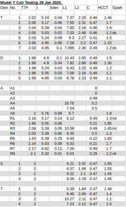

Luke
Posts: 617
Joined: Fri Dec 13, 2019 1:04 am
First Name: Luke
Last Name: P
* REQUIRED* Type and Year of Model Ts owned: 1926
Location: New Zealand
Some data from different voltage testing
Post by Luke » Sat Jan 04, 2020 5:10 pm

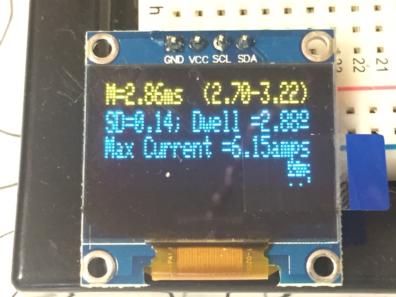

I had occasion to test four coils this morning. Given the intended mode of these, and the interest I had in operational voltage I did a quick comparison at two discrete voltage inputs.
All four coils were set to fire at Mean 3.31-3.33 msecs at 7V. One a multi-fire test of 50 cycles at an equivalent engine RPM of 900 they typically exhibited a standard deviation of .04.
At 12V the following typical results were obtained:
Coil 1 - Mean 2.22msec / SD .12
Coil 2 - Mean 2.08msec / SD.09
Coil 3 - Mean 2.10msec / SD .11
Coil 4 - Mean 2.16msec / SD .13
To clarify and expand a little - at 6V it was much more probable that each series of 50 firings on a single coil would give the same or a very close mean result (ie. it was quite consistent) whereas the same coils, and same test conditions - with the sole exception of the voltage change - were much less consistent. A coil could vary between Mean 2.11msec to 2.22msec at 12V, but only between 3.31 to 3.33msec at 6V for example.
I make no specific conclusion, one would need a lot more data, and be more rigorous in how it were collected and analysed to do that, however I think that if I were setting up coils for a car that was driven on battery vs a car typical driven on the mag I might set them differently...
Addendum:
All four coils had a similar capacitance at around 0.48uF but the inductance varied from 1.98mH to 2.7mH. Unfortunately I measured this later and can't now correlate between coil results above. However the difference in inductance between them is worth remarking on, and may lend credence to Tom's observations and attempt to match coils on characteristics other than just timing.

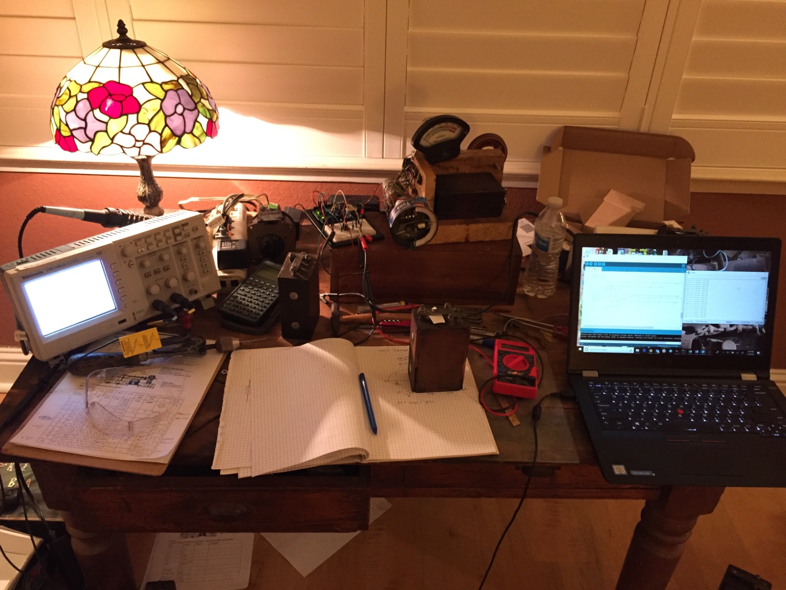

Captive Tester

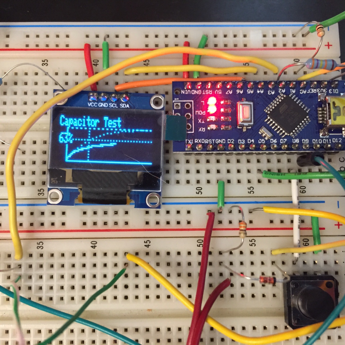

Luke, I will blame you that my living room has turned into a workshop :roll:

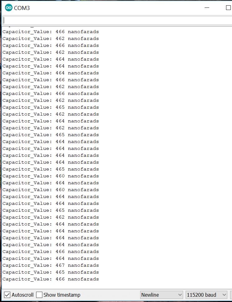

I connected a 10Kohm resistor to an output. The other side of the resistor is connected to a analog input (A1) and the coil.
I wrote the following code to test the capacitor.
Code: Select all
     if (digitalRead(Pin_11)) //10K ohm resistor is connected to output pin; other end of resistor is connected to A1 and capacitor.
        digitalWrite(Test_Cap_Pin, LOW); //set pin 2 low so that capacitor drains
        delay (1000); //wait a second
        digitalWrite(Test_Cap_Pin, HIGH);
        time_now = micros();
        //warning this is an infinite loop if A1 does not reach value could cause program to hang
        while(analogRead(A1)<642 && digitalRead(Pin_11)); //to reach 63% voltage; 5 volts = 1020; 1020 x 63% = 642
        time_constant = micros() - time_now;
        capacitor_value = time_constant/10; //C=T/R; time_contant ms / 10K ohm  = C (Nanofarads)
        Serial.print("Capacitor_Value: ");
        Serial.print(capacitor_value);
        Serial.print(" Nanofarads");
        Serial.println();
Basically it turns on the output waits until the value reaches 63% of the full value and records this time. Since it is a 10 K resistor the actual capacitor value in pico Farads is just the time divided by 10 (T = RC or C = T/R).
I got a nice RC curve on the oscilloscope (note: it turns off right at 63%).
Here are my results on a good capacitor.
Here are my test results on different coils:
Coils with New Caps:
0.462 uF
0.475 uF
0.465 uF
0.469 uF
Original Ford Coil Capacitors:
1.433 uF
1.232 uF
1.700 uF
1.244 uF

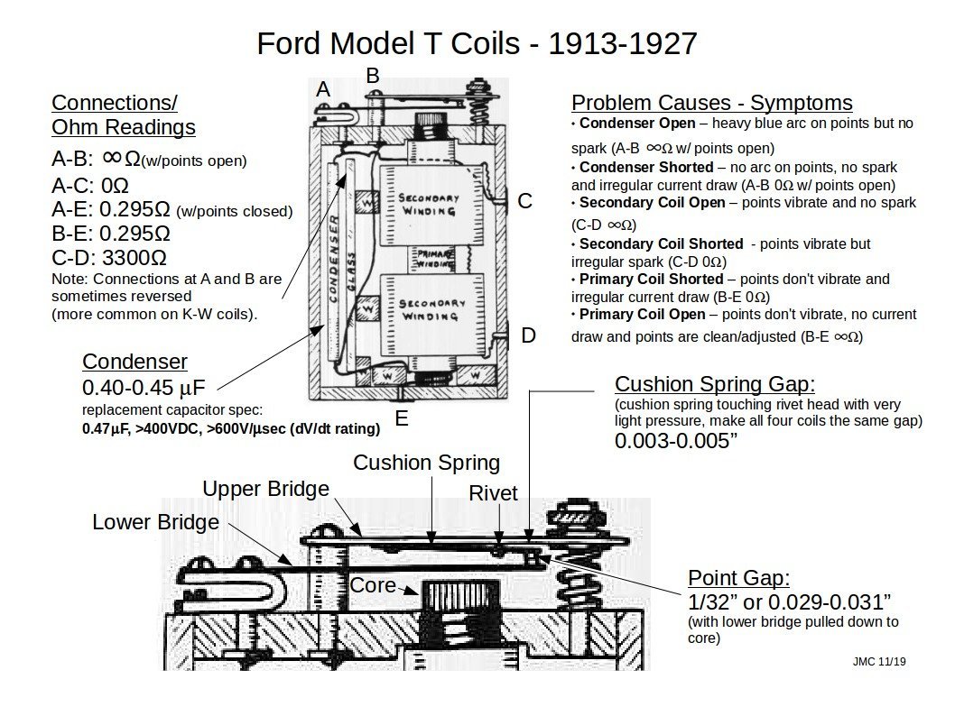

Original KW Coil Capacitors:
0.132 uF (KW? Painted over)
0.151 uF
0.144 uF
Well if nothing else, I now have a good capacitor tester. But we need to figure out what is considered an acceptable range.

Matt,
Yes, I don't know what it is about electronic projects but they're the messiest things around! I've taken aeroplanes to pieces (and put them back together!) that never seems to generate the same amount of cr*p :roll:
Good job with the code. You're now at the point where I was/am wrt to connecting it up to the cap under test. If it were just me it would be long done (and the switching device would be different) but I'm trying to maintain the simplest possible approach from a constructors perspective, hence the interlude to think about that.
A couple of things though - I think you might want to check your scale. Model T caps are circa 0.47uF as I recall, which would be 470,000pF. Also, in my view, they're not a precision item and anything from 0.42uF to 0.56uF or so should be fine. It'd be easy enough to test this empirically with a coil that doesn't have a cap installed (or a failed one) - you could connect them up externally and try the combination out to see how it went.
Apropos James' enquiry, and moving to my second point. In my cap tester I don't discharge at the 62.3% level, rather I use a higher value charge resistor and carry on the charge after the requisite TC point to see if there is any leakage. After a short (further) time the Arduino should read the full input voltage across the cap, if not there's a leak (which is easily calculated using Ohm's law).
To my mind while it's not common for caps to leak they sometimes do, but perhaps more importantly this is also a useful test to ensure there's no tracking on the coil box. I don't know if this is a 'thing' or not, but it's not hard to test so I include it.

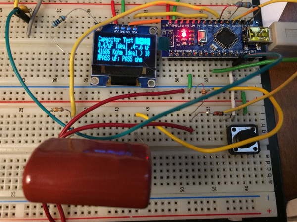

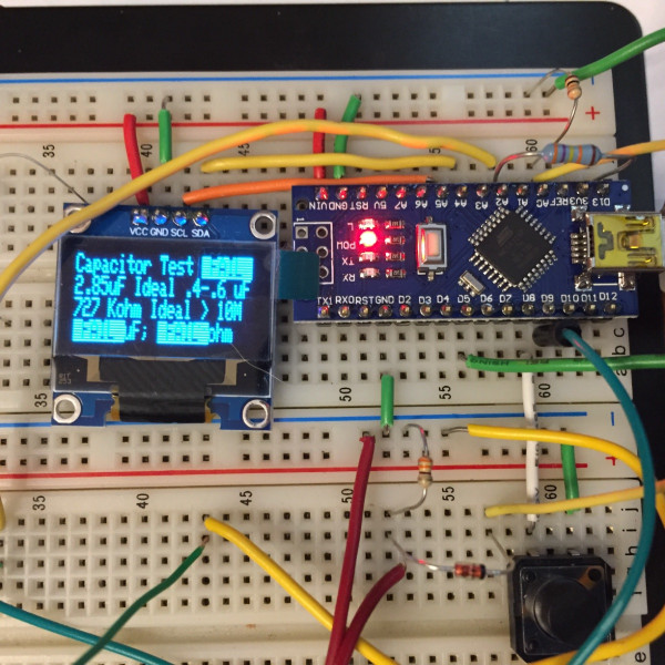

More progress

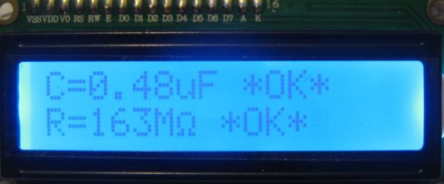

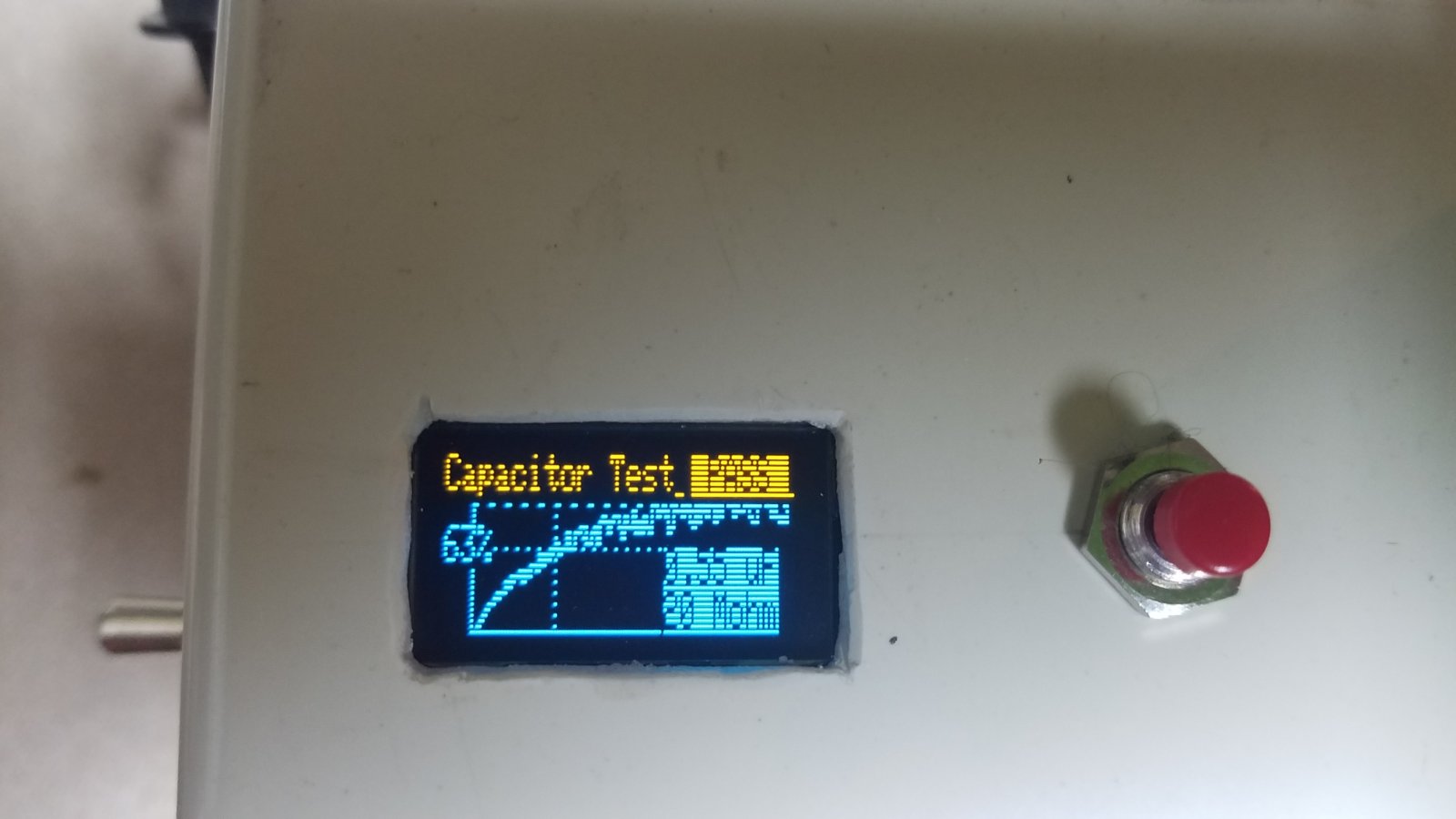

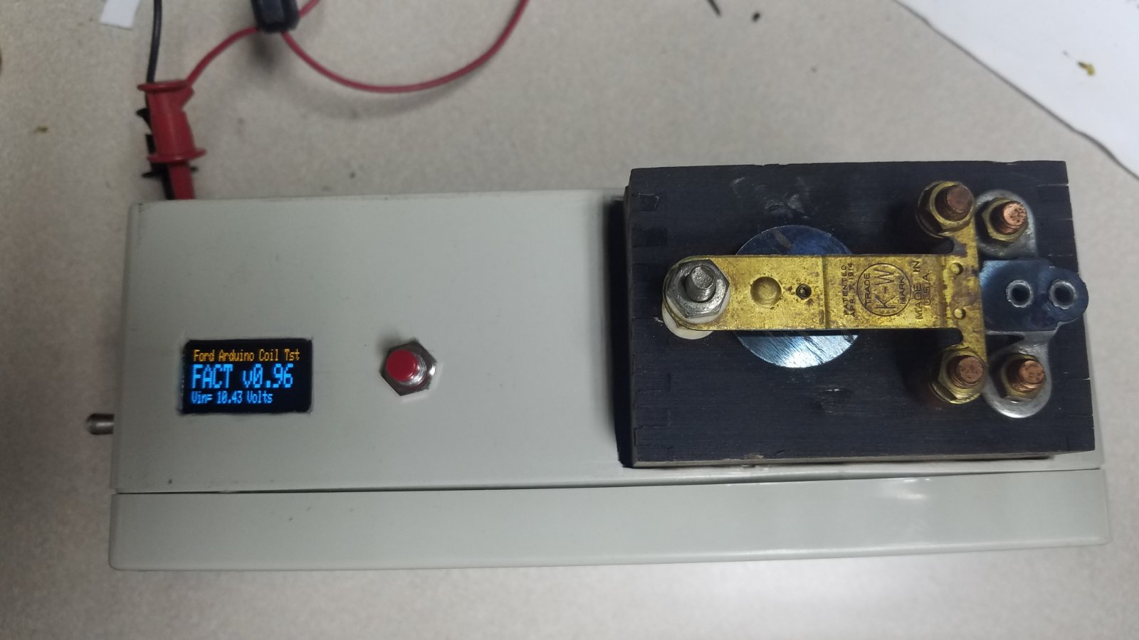

Post by Luke » Wed Jan 08, 2020 5:23 am

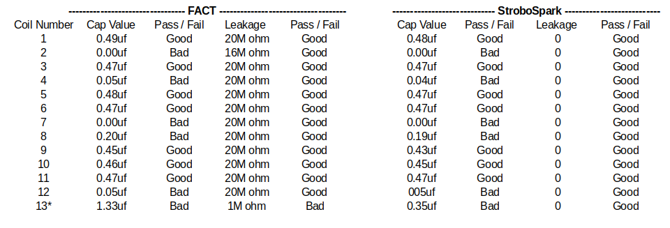

A brief report on a couple of useful things that arose today.

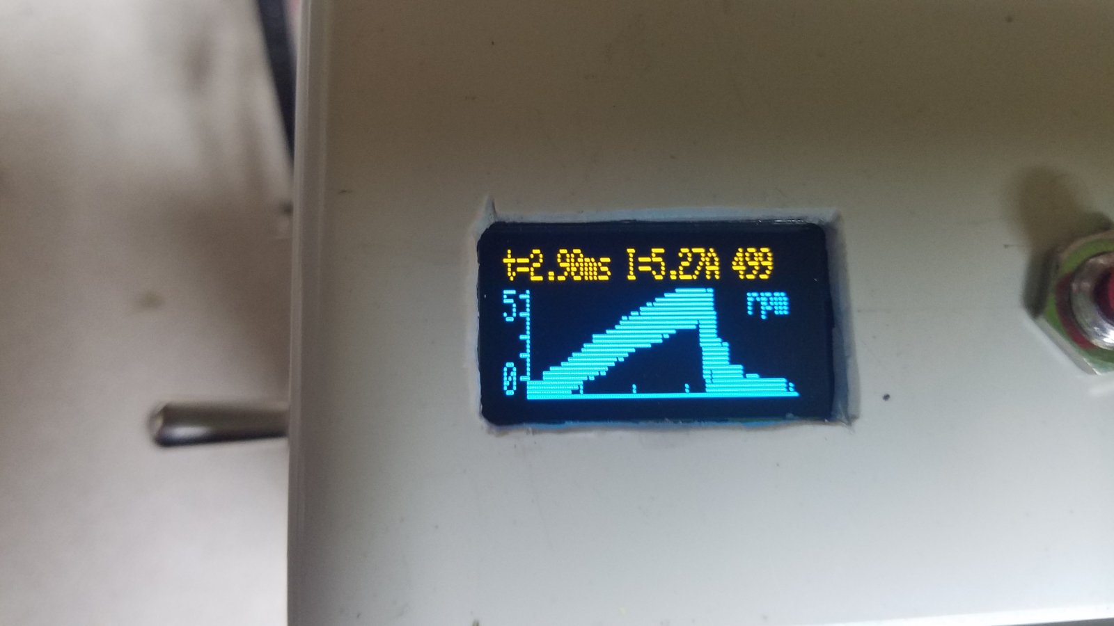

The first is that I was able to try out the tester on some other coils (thanks Chris), and we later tried some setup by the tester in a car.
Qualitatively the car went at least as well as it did with coils set on the HCCT. Coils set up on the 'FACT' tested well on the HCCT, and a faulty coil we'd earlier identified was also shown to be faulty in the HCCT.
The latter was a little different though, in the 'FACT' it showed as having reduced peak current cf the others (~5A vs ~6A), whereas in the HCCT it was quite a lot higher average current (3A-4A as I recall - the others were 1.3A-1.5A). A simple resistance test suggested this coil may have shorted turns on the secondary because it was showing 2.7k vs 3.3k for the others. I've yet to consider this further, so this is more information than conclusion.

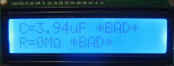

As I'd done some more on the code, and hardware wiring, we were also able to use the capacitance and leakage testing functions to ID a faulty capacitor on one of the coils (turned out to be an original capacitor), and check that the remainder were ok. This function appears to be working as expected.

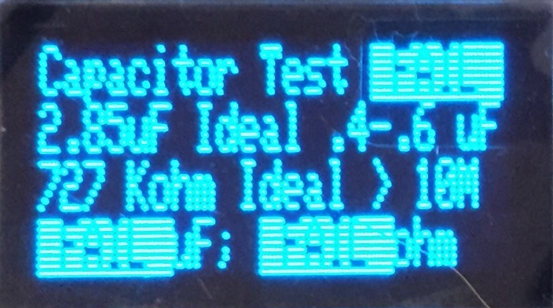

Here's some more screenshots of the new function in operation:
Tester switched to cap/leak test and button pressed
Result from a good coil
Result from a bad coil
This latter coil did show a few ohms (ie. it wasn't completely shorted out) but as I'm knocking off the decimal places and reporting only in M ohms anything less than 1M will show as 0, in any event it's clearly identified as a faulty coil (which it is).
There's a bit more to do with the code before putting it up, and some testing to be carried out from there, but I think this is getting reasonably close to being a useable tool.
Chris Barker
Posts: 343
First Name: Chris
Last Name: Barker
Location: Somerset, Eng;and
Post by Chris Barker » Wed Jan 08, 2020 11:26 am
2.7 kohms is just within the range I have measured. Probably OK.
What made you think it is 'bad' - either in the HCCT or FACT?
I would be tempted to try to 'mend' (re-set) it using either the HCCT or the FACT, then, if successful, try it in the other tool.

Luke
Posts: 617
First Name: Luke
Last Name: P
Post by Luke » Wed Jan 08, 2020 5:04 pm
Chris,
The faulty coil showed a low current draw in the 'FACT', and IIRC it had a reasonably high SD. In the HCCT it was also erratic, but it showed a particularly high averaged current.
These issues continued after several attempts at setting the coil, including a new set of points. Although not a perfect test the lower secondary resistance, coupled with the current anomalies, suggested possible shorted turn(s).
We need to consider this further, my recollection of the shorted turns tester I made nearly 40 years ago (for a TV LOPT) was that it used an AC signal to measure the inductive reactance of the coil. As the HCCT uses an AC source with a series AC current meter, I suspect it could effectively become a shorted turns tester of sorts.
What I don't know, and to which I ask in general, is whether it's common to have such a fault in the coils? Given their age, and the secondary voltage, and knowing how often LOPT's died as a result of shorted turns, it wouldn't surprise me - but there are several factors that contribute so I guess until we got a steer on that it's hard to know.
It's interesting that you've measure some coils at 2.7k, I assume they worked ok? Were you using the Strobospark with them, if so does that measure average current too?
Matt,
I'd deliberately reduced the precision on the resistance display because (1) I wanted to fit it on the screen! (2) I don't think it matters much - if it's more than say 20M why would one want to know to ten digits, and conversely if it's less than say 1M what does it matter 'cos it's clearly too low? Also it's a fairly crude test and I'm not sure it's highly accurate (but it is accurate enough for this purpose IMV). Anyway it's easy to change in the code if personal preference dictates more detail :-)
I'm sorry but I'm not sure I understand your question on the cap value?
This good coil had a replacement 0.47uF cap in it. That the tester displayed .01uF more doesn't bother me, I expect the cap will be a 20% component and in any event I don't think it's terribly important if it were a few nF either way in this location.
The bad coil was outside the tolerance I'd set, and had significant leakage anyway, so I'm ok with that too.
Incidentally the accuracy of both tests would improve if I were to more accurately determine the source voltage at the start. This appeared to float around a little so maybe some more work on that is warranted at some stage, but right now I think it does the job reasonably well?

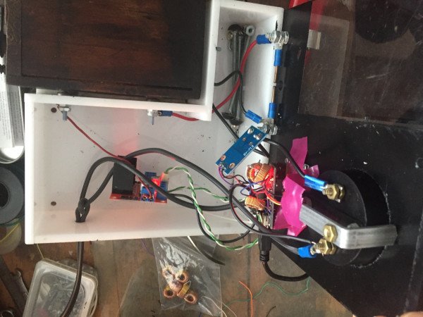

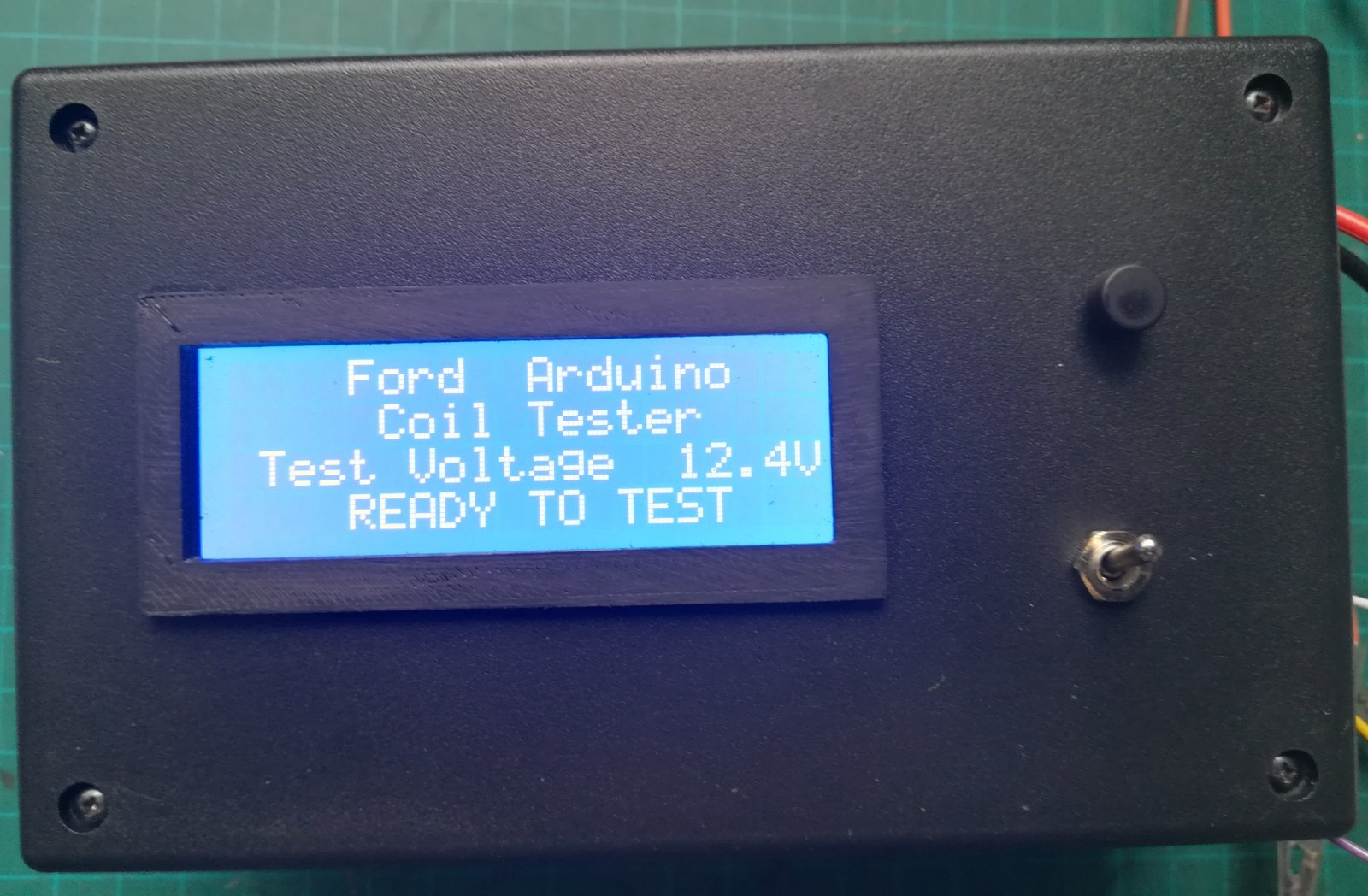

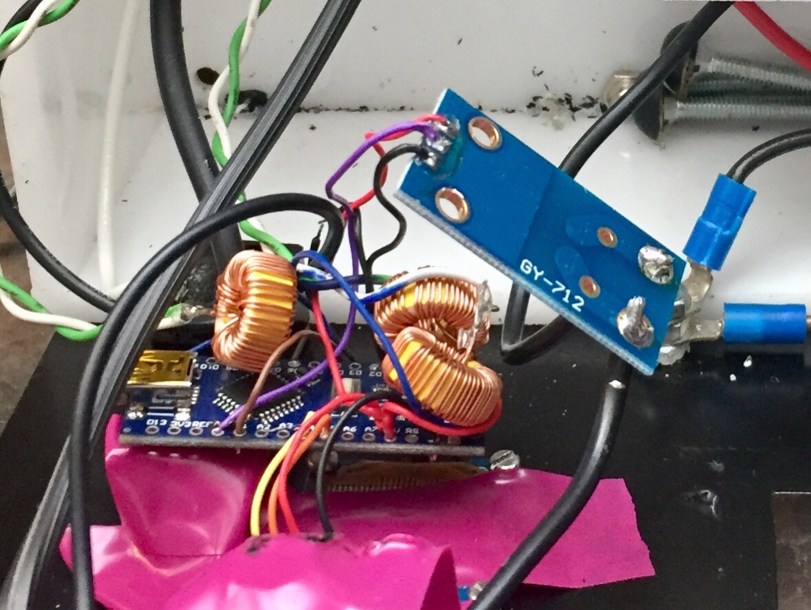

ACS712 & L298N- In the last few days I received ACS712 current chip and the L298N motor driver. So I was finally able to test your code to determine the standard deviation. (Prior to this I was using the MCCT and with the bounce on the switch it was not reliable.) I did use the the 20 amp current chip and changed the calculation from divide by 66 to divide by 100. I believe that the ACS712 is the way to go and we should not plan on using that CT in the future. I was not pleased with the ramp I received with the L298N chip. It became clear that the current was limiting (rounding off) and giving a waveform like Chris has above (see Jan 2nd). I connected two inputs/outputs in parallel on the driver chip got a sharper ramp as I desired (similar to Mike's post on Dec 21st). Eventually we may want to use a different driver, but I am really pleased with the results when I connect to outputs in parrallel for now.
RFI- When I do the multi test I loose USB connection with the PC sometimes. I think that noise interferes with the USB chip. It is likely that if I were able to clean up my wiring things would improve. At this point I am not too concerned because the micro-controller seems to keep running just fine. It is just an issue for me displaying stuff on the serial monitor on the PC.
LCD- I see that you are using the I2C to control the LCD. I wanted to confirm that you are connecting SDA to A4 and SCL to A5.

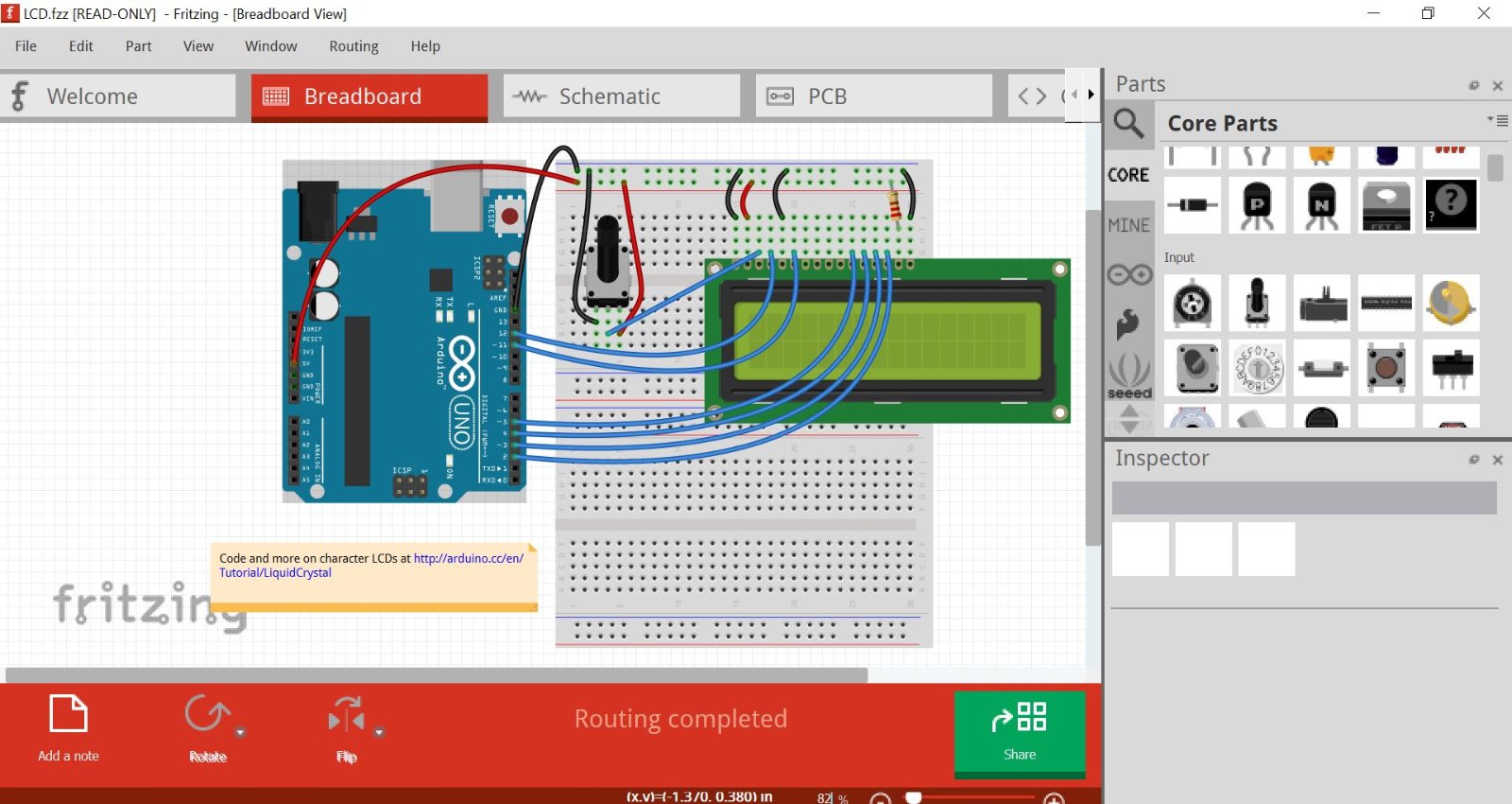

fritzing- I was looking at some youtube videos related to Arduino and came across some software called "fritzing". It allows you to make schematics, pictural diagrams and layout PCBs especially for Arduinos. It cost me around $8 to download. When we have a more finalized design I can draw up something. Here is an screen shot of the example LCD program (this is not I2C, so it is likely different than the wiring that you are using).
PCBs- Recently I found jlcpcb.com can make some very cheap PCB's. They have a special of $2 for small boards. I used them a couple weeks back. I had 10 2x2" boards made and it costed $18 including shipping and I had them in 1 week shipped from China. Additionally they can add SMT components for a fee. I was thinking as we settle on hardware this may be a way to go vs. multiple modules.
Matt

I felt it useful to to do a resistance test because I thought there could be a fault from leakage across the old coil box, or a leaky cap that might otherwise test ok.
In order to grasp how it works just consider the cap as a resistor (leak) and what you'll get is a simple resistive divider with the A1 pin of the Arduino measuring the result. Ordinarily I'd expect the 'ground resistor' (cap) to be infinite, so [once the cap is fully charged] it should present the full source voltage to A1. I hope that makes sense?
Yes I think you need to parallel the L298 outputs, you'll see I'm using a BTS7960 now... sorry, that's one of the things about public prototyping!
Likewise with the ACS712, I now believe it works better than the CT in this environment. With the latter I've had a few odd traces where I suspect there was no change in current so the output dropped to nil, even though there was current still being drawn (i.e. when the current draw was effectively DC). It's also much easier to calibrate than the CT since it has a standard known output.
I've passed my USB cable a couple of turns around a toroid, this reduces the connection issues you've noticed. If you use the unit completely standalone with the LCD it continues to run happily regardless of what's going on at the USB input. I expect that shortening the cable runs and boxing the unit would assist further, along with a little decoupling if needed.
Yes it's an i2C LCD (less wiring needed!), and you have the correct pin connections.
It would be nice to produce some wiring instructions and perhaps a PCB once the prototyping is finished. Martynn has kindly offered to draw some of this up but while we're changing things around that fritzing software you have looks useful.
As for a PCB I think if you were going down that track it may be best to solder on a simple FET with some flyback diodes etc for the switching? It would reduce the bulk somewhat, and maybe make the switching easier. Anyway that'd be a good project for you perhaps? Certainly I'm not big on PCB design these days and I've more than enough other things to do now!
Unfortunately I've still no steer as to whether shorted turns are a common thing with these coils or not? I'd hoped we may have had some responses, but perhaps no-one has come across the issue before, or has dismissed the coil as faulty for some other reason. Based on my earlier experience with LOPT's, and the issues that Chris' coil exhibited, I'd have thought it wouldn't be unheard of so I've been mulling over my ideas around a testing regime for this.
Once again it's less how to write the code or utilise the hardware so much as keeping the connections as simple as possible that's been the issue. I hope to have decided that in the next day or so. There are several ways to do it, none are inherently 'wrong', but I like to think of any possible impact a little further down the track before settling on things.

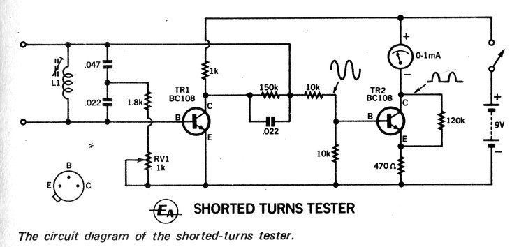

I have to say it's a long time since I've bothered to test for shorted turns. If the coil performs correctly in terms of adjusting to the correct dwell time and current, and produces a normal spark, I find that to be reliable enough.
Somewhere I have a tester for TV line output transformers (an EA project from the early 70's); I must see how it performs with a Ford coil.

Post by Matt in California » Thu Jan 16, 2020 1:19 am

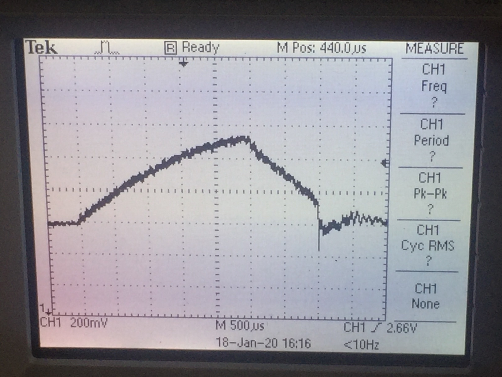

Yesterday I received this display and stayed up late making my $5 Oscilloscope (for the display only)!
Here is what I got on my Tektronixs real scope:
Here is what a good coil looks like on the 128x64 OLED display.
Again on a coil that has issues (double spark?):
You can see it on the cheap display:
I have some ideas on improvements, but as I said I stayed up to late last night. And even these results are satisfying!
Matt
Last edited by Matt in California on Thu Jan 16, 2020 1:30 am, edited 1 time in total.

Post by Matt in California » Thu Jan 16, 2020 1:30 am
Here is the multi-fire test results:
Here is when I forced a misfire (just to verify the display):
Enjoy,
Matt

I'm impressed with your CRO display. You're onto something there - it's perfect for the application. I'm tempted to build one into my existing tester making it a completely self contained instrument. Besides, there's really no need to use a lab quality CRO just to see the current ramp.

Post by Matt in California » Sat Jan 18, 2020 6:44 pm
I look forward to hearing experiences of using a Megger on coils. Obviously we want to find bad coils before putting lots of work into them!

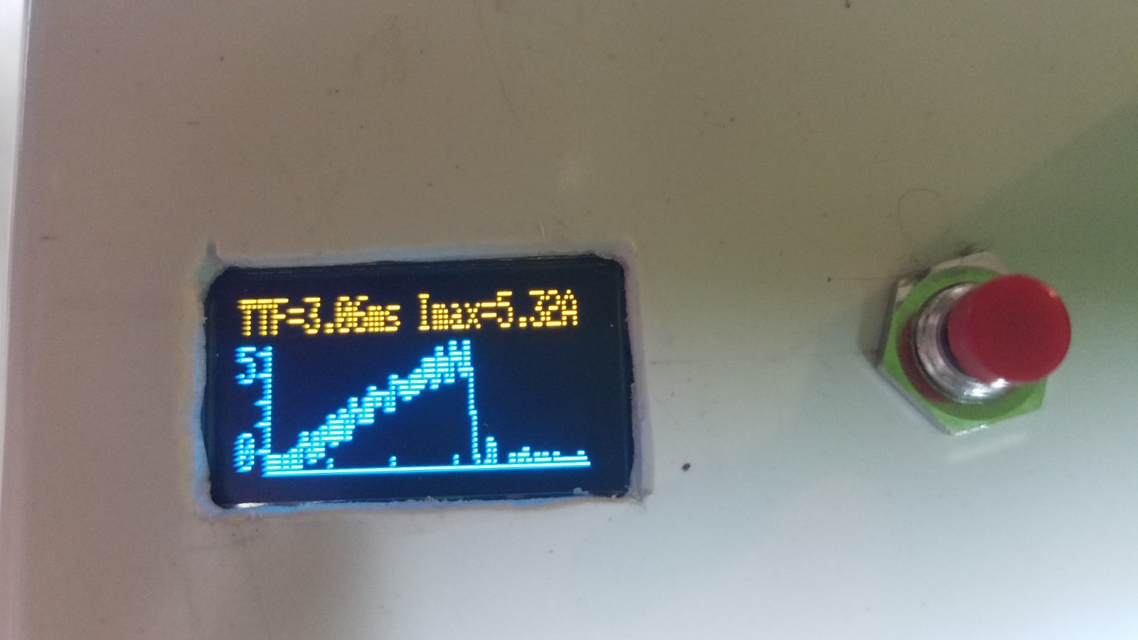

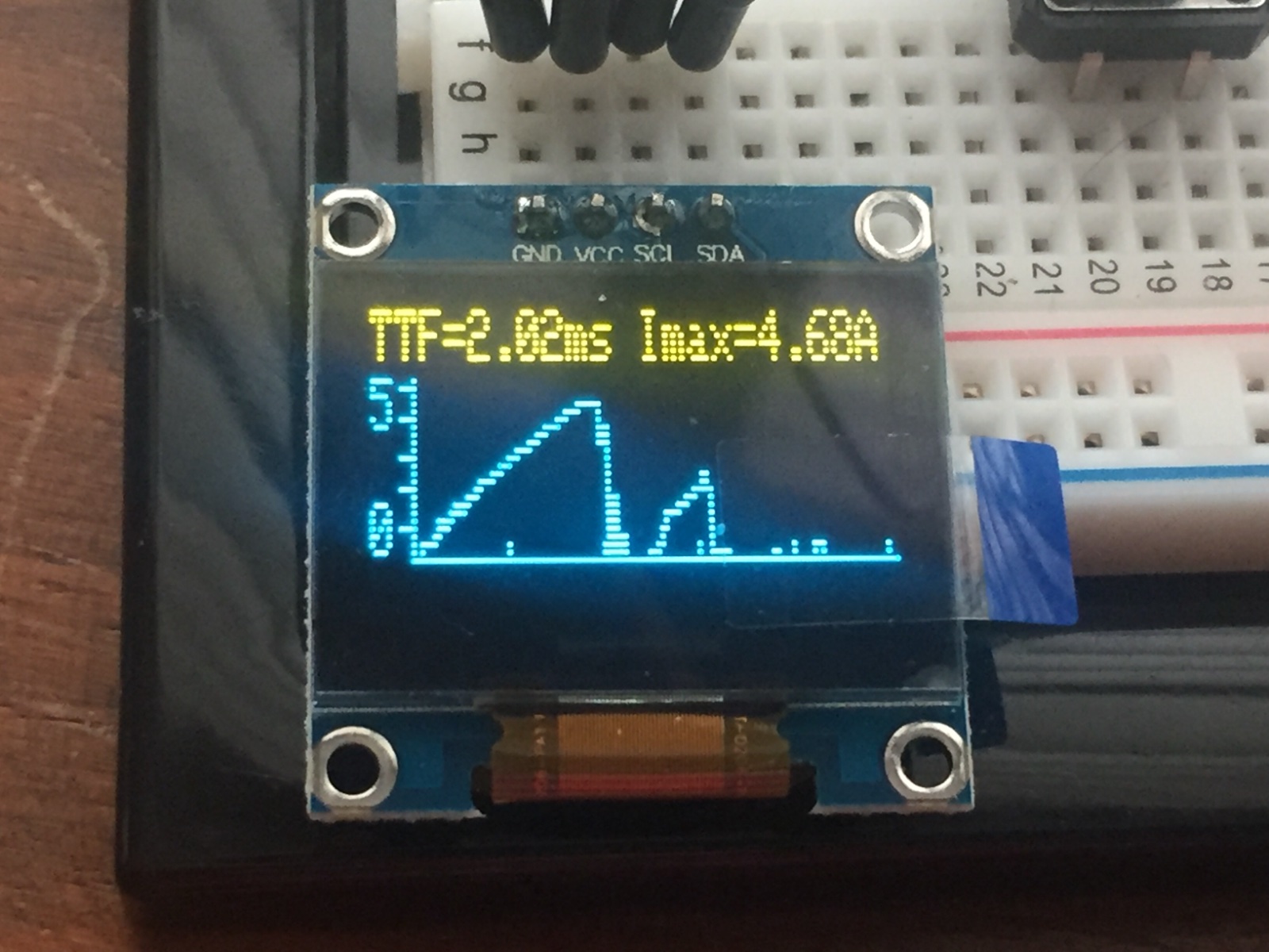

I worked on the Oscilloscope a bit. I needed to adjust things, so that I could see issues with bad coils.
Here is a coil with a double spark:
Here is a coil that was not sparking very well. But notice it is obviously getting plenty of current.
The reason it doesn't have a sharp drop on the back side of the ramp is because the points never open.
I am still working on the code, but if anyone is ready for the OLED IIC (I2C) Display code, I can post it here. Just let me know. I am looking into a larger display, but I the touchscreen that I got is not I2C and takes a lot of I/O pins. A larger touchscreen would be nice.
Anyway, I am now ready to try to make a match set of coils. I understand that we want 2ms dwell. But wanted to confirm the operating voltage and the desired current.
Matt

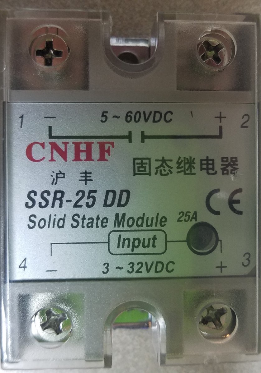

Someone contacted me regarding wiring up there own. Here are the parts that I am currently using:
  • Solid State Relay- I am using the L298N motor driver with two inputs/outputs connected in parallel. (Luke is using BTS7960.)
  • Current Sensor- I am using the ACS712-20Aamp chip/board.
  • OLED- I am using the0.92 inch 32X128 I2C display. This is a tiny, but powerful display. I would like to find a larger display because I want to make an Oscilloscope for another project, but in reality this tiny display is doing the job and could be idea for making a small coil tester.
  • Microcontroller- I am using a genuine Arduino Uno. I don't see any issue going smaller or using a generic as long as the voltage levels are correct for the peripherals (5 volts in my case).
Picture Schematic-Here is my attempt of making a schematic. I found that the Fritzing software does have a ton of different Arduino add-ons. Not necessarily generic ones, but close enough. In the future it would be nice to make a shield (a board to plug into Arduino) with the push button, solid state relay, current sensor IC and a header for the display. Here is my attempt:
If anyone sees any issues let me know I will fix them and update the picture above. Yes, you will need a battery larger than a 9 volt battery :roll:
I hope that this helps anyone attempting to build one of these. Obviously these are still in development, but I imagine more than one person who is lurking on the forum is attempting to get in the action.
Matt

Matt, nice job indeed. That oled screen form factor looks more like 128x64 rather than 128x32? If so I have one in my junk box so would be interesting to have a play if you are prepared to share your code? I have Lukes 1602 screen and his code here running at the moment, works well. Thanks John
Luke
Posts: 617
First Name: Luke
Last Name: P
Post by Luke » Sun Jan 19, 2020 7:01 am
Matt & John,
I use a Nano, it's a bit cheaper/smaller than the Uno, and you can solder directly to it if you want. It has the regulator just like an Uno so you can run it on 12V. Just commenting here - there's nothing wrong with the Uno!
With the diagram just bear in mind there's another switch to go in when I have a moment to review the code and post it. This to switch in the capacitor/leakage test. Sorry I've not got to that yet but as it's past 0100 here I'm not going to do that now!
I do intend trying a Nextion screen when one arrives for a different job. These are connected via serial and should allow some control back to the tester, as well as provide a reasonable display (they're available in several sizes). Downside is that they only have M$ based software to lay them out :x
So for me at least there's still some prototyping going on. While I think the code is working reasonably well - and it's pleasing to hear that from John too, thanks - I'd suggest if you wanted to make a board up it might be useful to hold off in case there are any more changes'/additions that come along. I should add that, in addition to the cap test, I include a source volt meter in this later code because it's important to know the supply voltage for the absolute timing value.

 *  Ability to use CT or ACS712 for current reading

  Arduino   device
  Ground    OLED ground
  +5VDC     Vcc
  A0    input for data read from curren sensor (5 VDC limit)
  A1
  A2
  A3
  A4    SDA (if no SDA pin)
  A5    SCL (if not SCL pin)
  1
  2
  3
  4
  5
  6     Output to Solid State Switch (MOSFET)
  7
  8     Pushbutton (other side connected to GND
  9
  10
  11
  12
  13
#define ver 0.91
// Include any required libraries
//#include <LiquidCrystal_I2C.h> // presently utilising the library from https://github.com/johnrickman/LiquidCrystal_I2C
#include <Adafruit_SSD1306.h>
#define OLED_RESET    4
#define SCREEN_WIDTH 128 //OLED Width
#define SCREEN_HEIGHT 32 //OLED Height
Adafruit_SSD1306 display(SCREEN_WIDTH,SCREEN_HEIGHT, &Wire, OLED_RESET);
// Set global variables etc
 unsigned long time_now = 0;  // use long in case micros count gets big
 unsigned int interval = 4000;           // interval at which to turn on (microseconds)
 const byte outPin = 6;  //output pin to ss relay for coil
 const byte swPin = 8; //input pin for switch, normally high
 byte testnum = 0; // use byte for mem reduce, assume testnum < 255
 long mVolts = 0.0;
 float amps = 0.0;
//Initialise the LCD
//LiquidCrystal_I2C lcd = LiquidCrystal_I2C(0x27, 16, 2); // set the address, columns and line
//set variables for collect_data function array
 const byte numReadings = 150; //max number of values in array, 150 = approx 3ms
 const byte numTests = 50; //number of test cycles in multi test
 unsigned int analogVals[numReadings][2]; // array name & columns
 unsigned int x = 0; // initialise array input
//set variables for multi_test function array
 unsigned int resultVals[numTests][2]; // array name
 unsigned int y = 0; // initialise array input
// set desired 'rpm' for multitest - facsimile of single coil running at this speed
 int rpm = 900;
 //int rpm = 1500;
//setup for fast ADC read
 #define cbi(sfr, bit) (_SFR_BYTE(sfr) &= ~_BV(bit))
 #define sbi(sfr, bit) (_SFR_BYTE(sfr) |= _BV(bit))
//setup for switch reading
 const unsigned long short_in = 60;
 const unsigned long  long_in = 600;
 unsigned long swTimer=0;
 boolean swPrevState = HIGH;
 boolean swPresentState;
//begin setup for prog proper
void setup()
    pinMode(swPin, INPUT_PULLUP); // set the switch pin as input and apply resistor to +5
    pinMode(outPin, OUTPUT);// define output pin
    sbi(ADCSRA, ADPS2); //more stuff for fast ADC read
    cbi(ADCSRA, ADPS1);
    cbi(ADCSRA, ADPS0);
    Serial.begin(115200); // open the serial port
    /*lcd.init(); // setup the LCD for printing
    lcd.backlight(); // turn on LCD backlight
    lcd.print (F("FACT v")); // initial text on lcd display at startup
    lcd.print (ver); // prints version number from define
    lcd.print (F(" LP_20")); // build number
    lcd.print (F("Ready to test?"));
    lcd.blink();
    //Serial.begin(9600);
    display.begin(SSD1306_SWITCHCAPVCC, 0x3C);
    display.clearDisplay();
    display.setTextSize(1);             // Normal 1:1 pixel scale
    display.setTextColor(WHITE, BLACK);        // Draw white text
    display.setCursor(0,0);             // Start at top-left corner
    display.println(F("Ford Arduino Coil Tst"));
    display.setTextSize(2);             // Draw 2X-scale text
    //display.setTextColor(SSD1306_WHITE, SSD1306_BLACK);
    display.print(F("FACT v")); display.println (ver);
    display.println(F(".96 OLED OSCILLOSCOPE"));
    display.display();

// uncomment for ACS712
       if ((val > 520) && (val < maxval) && (initialdecaytime == 0)) //detect initial time of current decay and write to 'initialdecaytime' ACS712
// uncomment for CT
//       if ((val > 100) && (val < maxval) && (initialdecaytime == 0)) //detect initial time of current decay and write to 'initialdecaytime' CT
//      if ((prev_val = maxval) && (val < prev_val) && (completedecaytime == 0)) //detect initial time of current decay and write to 'initialdecaytime'
          initialdecaytime = analogVals[i][1];
        if ((initialdecaytime != 0) && (completedecaytime == 0) && (val <= 511))  //get total time from initialise to complete decay to zero ACS712
// uncomment for CT
//        if ((initialdecaytime != 0) && (completedecaytime == 0) && (val <= 0))  //get total time from initialise to complete decay to zero CT
          completedecaytime = analogVals[i][1];

    // write results to LCD
    //lcd.clear();
    //lcd.setCursor (0,0); //set cursor first col, first row
    //lcd.print (F("Single test #"));
    //lcd.print (test);
    //lcd.setCursor (0,1); //set cursor first col, second row
    //lcd.print (F("TTF="));
    //lcd.print (float(ttf)/1000.00); // convert to ms
    //lcd.print (F("ms"));
    //lcd.print(F(" "));
    //lcd.print (amps);
    //lcd.print(F("A"));
    display.setCursor(0, 0);
    display.print("Single test #");
    display.println(test);
    display.print("TTF = ");
    display.print(float(ttf)/1000.00);
    display.println("ms");
    display.print(F("Max current = "));
    display.print(amps);
    display.println(F("A"));
    display.display();// now that the display buffer is built, display it*/
//analogVals[x][0] = analogRead(A0);
    //Start of O-Scope
    //for (x = 10; x <= 127; x++) {
    //  data[x] = (analogRead(READ_PIN) / 21.7659);
    for (x = 1; x <= 112; x++) {
       // digital value of max current in =660; 5= digital values of current range/#lines = 150/32 = 4.68
       display.drawLine(x+10 , ((660-analogVals[x-1][0]))/4.68, x+10 , (660-(analogVals[x][0]))/4.68, WHITE);
    // draw the axis, lables and tick marks
    for (int y = 0; y < 5; y++) {
      display.drawFastHLine(7, y * (32) / 7 + 9, 3, WHITE);
    for (int x = 0; x < 6; x++) {
      display.drawFastVLine(x*23+10, 29, 3, WHITE);
    display.setCursor(0, 24);
    display.println("0");
    display.setCursor(0, 8);
    display.println("5");
    //Yellow text at top
    //display.fillRect(0, 0,  127 , 14, WHITE);
    display.drawFastHLine(10, 31,  128 - 10, WHITE);
    display.drawFastVLine(10, 8,  32, WHITE);
    display.print("TTF=");
    display.print("ms ");
    display.print(F("Imax="));
    display.display();

   byte discard = 2; // first few results from multi-test show higher ttf than normal, discard to give more accurate result
   for(byte i = discard; i < numTests; i++) // get results from each test and print to serial
       testnum = (testnum + 1);
       Serial.print (F("*** Test number "));
       Serial.print (testnum);
       Serial.println (F(" ***"));
       Serial.print (F("Total cycle time (to fire) = "));
//       Serial.print (float((resultVals[i][0])/1000.00)); // convert to ms
       msec_ttf = ((resultVals[i][0])/1000.00); // convert to ms
       results_sum += msec_ttf;
       if (msec_ttf > results_max)
           results_max = msec_ttf;
       if (msec_ttf < results_min)
           results_min = msec_ttf;
       Serial.print (msec_ttf);
       Serial.println (F("msec"));
// uncomment two lines for ACS712
       mVolts = ((resultVals[i][1]) / 1024.0) * 5000.0; // raw analog read val to millvolts
       //amps = ((mVolts - 2500.0)/185.0); // millivolts to amps (utilise scale factor for ACS sensor range 5A chip
       amps = ((mVolts - 2500.0)/100.0); // millivolts to amps (utilise scale factor for ACS sensor range 20A chip

    Serial.print (F("Range = "));
    Serial.print (results_max - results_min);
    Serial.println (F("mSec"));
    Serial.print (F("Degrees of variation at "));
    Serial.print (rpm);
    Serial.print (F(" RPM = "));
    Serial.print ((results_max - results_min)/(float(60000 / rpm)/360));
    Serial.println (F(" degree(s)"));
    display.print(F("M="));
    display.print(results_mean);
    display.print(F("ms  ("));
    display.print(results_min);
    display.print(F("-"));
    display.print(results_max);
    display.println(F(")"));
    display.print(F("SD="));
    display.print(results_std_dev);
    display.print(F("; Dwell ="));
    display.print((results_max - results_min)/(float(60000 / rpm)/360));
    display.println((char)167); // let's print the degree symbol!
    display.setCursor(0, 16);
    display.print(F("Max Current ="));
    display.println(F("amps"));
    if (miss)
        //lcd.print(F("***MISFIRE***"));
        display.println(F("***MISFIRE***"));

You will see for the most part I just commented out the code that Luke make and put my own in.

Version update, responses
Post by Luke » Mon Jan 20, 2020 4:48 am
Jeff,
My memories of etching PCB's are less 'fond' than yours methinks! I seem to recall adding acid to the solution to speed things up (and heating it) :shock: but the bit I really didn't like was drilling all the holes, now that was particularly painful.
I too have wondered what Henry would think. Sometimes I feel that as a consummate innovator and experimenter he would approve, but at other times I recollect he really didn't like anyone messing with his beloved T - so I've never reached a conclusion :|
Matt,
We might need to sort out a contributing arrangement so things don't get out of kilter?
With the OLED/LCD display etc it may also be a good idea to initially #define the display perhaps, that way it'd be easier for anyone who wants to replicate the project and wishes to use a 16x2 or 20x4 LCD, or Xx128 OLED display (or whatever else). What do you think?
Just for the moment I'll keep to my versioning with this next piece of fundamental code as I'd already mostly completed it before your contribution arrived. You can then intro your contribution to it as you see best, and we'll work out what to do for the future in email.
When my other displays arrive (unfortunately they'll take several weeks to get here) I'll put up whatever comes out of the Nextion work. You are right of course that they're more costly, thereby messing up my original claim on the cost of this little tester, but I suppose we could just call that version 2 or something ;)

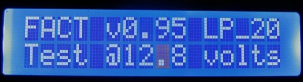

Version 0.95
This version introduces testing for capacitor value and leakage of the cap or across the box. This is a useful check to run through before first testing a coil as it will determine whether it's worth going further and/or it may confirm certain characteristics of the firing test (excessive sparking at the points etc).
The tester will also display the test voltage in use when first turned on. Given some of the things we've discovered I think it may be worthwhile for some to test their coils at different voltages, but more importantly this allows flexible adjustment of a target TTF based on the input voltage.
Remember that a lower voltage returns a longer TTF, and if we assume it's a reasonably linear relationship it should be a simple thing to automatically calculate and include the target time within the code and display as necessary. This display could take the form of presenting the target time alongside the test time, or internally comparing it with the actual test time and declaring the coil a pass or fail - or some variation on this.
At this point I've shied away from being so definitive but it may be time to consider it now? JohnH, I seem to recall you saying that the optimum time at 12V was 2msec, and at 6V it was something around 3.3msec? Was that dead on 12V (ie. not 13.8 or whatever?), and do you still consider these times to be optimum?
Connecting it up
Here's a quick/rudimentary block diagram of how to connect things up.
I view the tester as still in prototype so this could change somewhat, and whatever screen, switcher, and current sense you use could affect the connections you'll need, however it should be enough to get a keen person underway
Before you power it up I suggest you check for any wiring mistakes (mine included!), there's definately no warranty here!
Some more detail below.
Capacitor test
Cap test is via resistor from D13 to A2, then from A2 to one side of the coil input, the other side to ground. I used a 487k resistor, which is why that value appears in the code, but it could be anything reasonable (100's of k's). You can just change the code to whatever value you wish to use. I happen to have some odd value resistors and this one fitted the bill for this task.
When this test is run the connection to the high-current switching device needs to be cut, and an input on the Arduino grounded to tell it which test is to be conducted. To this end I used a double-throw triple-pole toggle switch that takes the two wires to the coil and connects them either to the two pins above (A2 + GND), or the switching device. It also grounds pin D5, telling the Arduino we're performing a capacitor test.
It's important to get the switching right because otherwise A2 could receive some unwanted inputs well above its capacity!
In order to run the test the toggle switch needs to be in the correct position, and the coil points held open via an insulated device (pen etc, or you could just stick some plastic between the points). Once ready just press the main switch once.
I've previously shown LCD screen shots you'd expect here. There is no change to them.
Voltage test
Voltage test conducted via a resistive divider from +ve & -ve in to pin A7 (A7 being the centre point where the two resistors connect to each other). The higher value resistor goes to +ve, the lower value to -ve. The ratio should be around 3:1 or 4:1, and be in the 10's of k's or more. Again I just happened to use what I had on hand, and you can set the values you're using in the code, as you'll see.
Voltage will be displayed by the initial startup screen. If you change the input supply and want to re-check just reset the Arduino (or if you turned it off to change it will correctly display the new supply voltage).
At some point this will probably update itself as changes occur. Here's a shot of the the present initial screen.
Operation
As the code is at present the system should continue to work if either, or both, of these new test facilities are not physically connected. IOW if you just upload this code it should work, although the initial screen wouldn't display the correct voltage.
On that, I've not included some of the niceties that one otherwise might if this were for a more wide-ranging test unit. In this case we've got a relatively homogeneous device under test, with an anticipated capacitor value and leakage, time to fire, and current draw, and we use a limited input voltage range. As a result we have expected outcomes within a certain range and anything outside of that can simply be treated as foreign - but at present it may give an 'odd' reading in some cases rather than nicely zero something, or declaring it void.
These things can be addressed as part of a final tidy-up, once the dust has settled on the main function(s) of the tester and it's running more or less as we'd like.
As always please let me know if you run across any bugs, have some useful input on what we might expect from our tests, improvements to contribute etc:

 *  (1) turn on Model T coil for [interval] milliseconds (typically 4-5 msec)
 *  (2) measure the current max value
 *  (3) measure time from 0 to max val (rise/ramp time)
 *  (4) measure time from max val to min val (decay time)

// voltmeter + resistor divider details
  float input_volts = 0.0;
  float interim_val = 0.0;
  float R1 = 32400.0; // resistor to ground
  float R2 = 120000.0; // resistor to input supply
void setup()
    pinMode(cap_chg_pin, OUTPUT);// define output pin
    pinMode (cap_swPin, INPUT_PULLUP);
    cbi(ADCSRA, ADPS1);
    cbi(ADCSRA, ADPS0);
    // let's get the input voltage to display
    int a7val = analogRead(A7);
    interim_val = (a7val*5.0)/1024.0;
    input_volts = interim_val / (R1/(R1+R2));
    // begin display detail
    lcd.print (F("Test @"));
    lcd.print (input_volts,1); // print voltage to 1 decimal place
    lcd.print (F(" volts"));
    lcd.blink();
    lcd.createChar(0, omega);

//--- Function to do a single fire test on a coil ---//
void single_test()
    int maxv, ttf, test; // declare variables to use
    mVolts = 0.0;
    collect_data(&maxv, &ttf, &test);  // get data from collect_data function
    //collect_data(&maxv, &ttf);
    mVolts = (maxv / 1024.0) * 5000.0; // raw analog read val to millvolts
    amps = ((mVolts - 2500.0)/66.0); // millivolts to amps (utilise scale factor for ACS sensor range
    // uncomment for CT
    // amps = (maxv * .0222); // millivolts to amps (utilise scale factor for CT
    // write results to serial port
    Serial.print (test);
    Serial.print (float(ttf)/1000.00); // convert to ms
    lcd.clear();
    lcd.print (test);
// DEBUG    Serial.println (maxv);
// DEBUG    Serial.println (mVolts);
    Serial.print (F("Maximum current = "));
    Serial.print (amps);
    Serial.println (F("A"));
    Serial.println();
    lcd.print(F(" "));
    lcd.print (amps);
    lcd.print(F("A"));
//--- Function to do a multi-fire test on a coil as if running in vehicle ---//
void multi_test()
    // do some calcs on rpm as needed for delay (four-stroke, so single cyl ign fires every second cycle therefore div 2)
    byte rpmdelay = ((60000 / rpm)*2) - (interval/1000);  // attempts to roughly account for time in data_collect process ('interval') - byte means not much slower than 500RPM
    y=0;  // reset array
    // begin proper
    for(byte i = 0; i < numTests; i++)  // number of test firings
       resultVals[y][0] = (ttf); //1st col of result array gets ttf
       resultVals[y][1] = (maxv); // 2nd col of result array gets max current
       y++; //increment array
/* use for debugging output from collect_data function
    Serial.print ("*** Test number ");
    Serial.println (" ***");
    Serial.print ("2Maximum current = ");
    Serial.print (long(maxv) * 120.5);
    Serial.println ("mA");
    Serial.print ("2Decay time = ");
    Serial.print (ttf);
    Serial.println ("usec");
    Serial.println();
       delay(rpmdelay); // sets 'rpm' delay between each test firing,
   testnum = 0;
   float results_sum = 0;
   float results_std_dev = 0;
   float msec_ttf = 0;
   float results_mean = 0;
   float results_var = 0;
   float results_max = 0;
   float results_min = 10;
   boolean miss = 0;
// uncomment for CT
//       amps = (long(resultVals[i][1]) * 0.02222);
//       Serial.println (mVolts);
    results_mean = (results_sum / (numTests - discard)); //get mean of array results for ttf ***using testnum cost of discard
    for(byte i = 2; i < numTests; i++)
        //results_var += pow(results_mean - (float((resultVals[i][0])/1000.00)), 2); // get variance
        results_var += pow(results_mean - (((resultVals[i][0])/1000.00)), 2); // get variance
        results_std_dev = sqrt(results_var/(numTests - discard)); // get std deviation ***using testnum cost of discard instead numTests
        if (results_min ==0)  // if we have a 0 for ttf it suggests firing issues
         miss = 1;
    Serial.println ();
    Serial.print (F("Mean time to fire = "));
    Serial.print (results_mean);
    Serial.print (F("Standard deviation = "));
    Serial.print (results_std_dev);
    Serial.print (F("Results Max = "));
    Serial.print (results_max);
    Serial.print (F("Results Min = "));
    Serial.print (results_min);
    Serial.print (F("mSec"));
    if (miss)
     Serial.println (F(" *** MISFIRE ***"));
    else
     Serial.println();
    Serial.print (rpm);
    // LCD print
    lcd.clear();
    lcd.print(F("ms"));
    if (miss)
    else
        lcd.print(F("-"));
        lcd.print(F("  "));
        Serial.println();
        lcd.print(F(" "));
        lcd.print (amps);
        lcd.print(F("A"));

//--- Function to check capacitor value and resistance ---//
void cap_test()
    mVolts = 0;
    int cap_time = 0;
    int r_volts = 0;
    long r_val = 487000; // charge resistor value in ohms
    float cap_val = 0.0;
    long leak = 0;
    digitalWrite(cap_chg_pin, LOW);
    lcd.clear();
    lcd.print (F("Capacitor test"));
    lcd.print (F("in progress..."));
    delay (90); //ensure the cap is discharged via charge pin low

             //testnum = (testnum + 1);
             single_test();
          if ((currentMillis - swTimer >= long_in)) // sw long press
          // the long press was detected
             Serial.println ();
             Serial.println (F("- Multi-fire test -"));
             Serial.println ();
             lcd.clear();
             lcd.print(rpm);
             lcd.print(F("RPM multifire"));
             multi_test();
        swPrevState = swPresentState; // has state changed?
if (cap_swPinState == LOW)
    swPresentState = digitalRead(swPin); // what's the switch doing
    if (swPresentState != swPrevState) // if not same as prev then...
       delay(20); //debounce delay
       swPresentState = digitalRead(swPin); // check again after debounce delay to be sure
       if (swPresentState == LOW) // if switch is still on then it's real
           swTimer = millis(); // set timer from on
       if (swPresentState == HIGH) // sw not on now
          unsigned long currentMillis = millis();
          //if ((currentMillis - swTimer >= 60) && !(currentMillis - swTimer >= 600)) // sw short press
          if ((currentMillis - swTimer >= short_in) && !(currentMillis - swTimer >= long_in)) // sw short press
             Serial.println (F("Cap test"));
             cap_test();
[/doe]

Post by JohnH » Mon Jan 20, 2020 7:07 pm
Luke,
The test voltages I use are 6 and 12V. I suppose that for more 'real world' testing the 6V should be closer to 7V, since the battery will be under charge when the engine is actually running. The regulation of the power supply in my tester is not perfect anyway, being just a simple zener diode and emitter follower circuit. It's quite adequate for the purpose, but not as good as a three terminal regulator IC.
The ideal dwell time to fire periods were determined by observing how long it took for the current waveform to flatten out. Beyond this time the coil begins to saturate. The times I chose 3.5ms at 6V, and 2ms at 12V, were determined after examining several different coils. Of course, chances are one coil might begin to saturate at 3.3ms and another at 3.7ms, but it isn't that critical. The important thing is the firing time is set to be the same for a set of coils at whatever test voltage is used.
The ECCT uses a regulated switchmode power supply providing 12V and is set to 2ms firing time.

John,
Quite agree it's the consistency across coils that matters most, but thanks especially for your views on absolute time.
It was some time ago that you wrote your article and I'd wondered if you'd discovered anything in the interim. Clearly you've tested a lot of coils and would have a very good idea on where they would typically sit ttf-wise, so it's good to have that confirmed, along with the voltages you use.
With this in mind I can't see why the ultimate saturation time (ideal ttf) wouldn't be (inversely) linear to voltage so I think it is probably worth including a calc to give a target time in the code, according to whatever test voltage is used. At this time I'll assume 3.5msec for 6.0V bottom limit and 2msec for 12.0V, and whatever it works out to be between.
That said from the little testing I've done I suspect it's a little arbitrary anyway; the single-shot tests do not always seem to meet with the same ttf for the same coil, despite no change in conditions between tests. I've come to the conclusion that it's just not possible for them to be particularly precise given the nature/age of the design, so we need to work with them and allow a little leeway. How much is too much [leeway] is something I've yet to conclude.
Partly to deal with this I may look at some sort of frequency table histogram or scatter plot for the multifire test. This should give an easily grasped visual cue as to how consistent an individual coil is - some of the numbers the system presently outputs may be a little esoteric to some.

As far as the tester is concerned, with the way it's wired up at present you could simply supply 30V (or whatever) to the input of the switching device and it would record the events normally. Both the BTS7960 and the L298 would handle that ok.
John (and Chris),
You've echoed some earlier comments of mine around the absolute firing voltage and how the ramp of the magneto waveform will interact. And you're right re the waveform itself, Jim (jab35) pointed me to an earlier thread (with images) on this very thing - it's quite 'interesting' isn't it!
There are a couple of things from my perspective. Firstly the timer is still in the circuit when operating on the car itself (the HCCT is different, which was central to the conversation between Jim and me), so there will still be a hard switch on and off at some point. Where the magneto ramp is at that point is determinable as the advance is changed - but it's arbitrary in terms of real-life operation.
Secondly I've found in the limited testing I've done that there is ttf variability between coils at different voltages - IOW they don't all react to voltage change the same.
You would have better knowledge of that than me, but to my mind these two things make the need or desire to generate a triangle or sine wave in order to test coils much more of academic interest than practical. The things are so imprecise anyway that I doubt there would be any advantage in doing this for a coil tester in the field.
That's not to say it's not interesting or worthwhile in that academic setting. Jim and I have had some discussion around this, he's particularly interested in comparing the HCCT system to the electronic methodology utilised such as in this unit and Mike K's.
In terms of making something up to do it I don't see it'd be particularly difficult. I'd probably use a function generator, output that via a suitable cct to generate the requisite AC waveform with sufficient current and use the 'FACT' code, or oscilloscope, to see what went on from there. However there's only so many things one can do...

I've been staggered at the variability in inductance of the Ford coils, so far I've yet to find any two within what I'd consider to be a reasonable proximity of another. This may in part be a function of the very few coils I've been able to check (<10), regardless I would not have anticipated quite the range I've found to date. I confess to being a little intrigued, but that's a subject for another day...
Supporting your comments to Jim I note that a few days ago we set four coils at ~2msec ttf (12V) on the 'FACT', then checked them on a HCCT.
Two of the coils showed a current draw of around 1.6A on the HCCT meter, the other two 1.3A, ie. there was ~200-300mA average current difference between them despite their typical ttf being just a few usec apart.
After this no adjustments were made from the HCCT test and when installed in the vehicle it ran well with the 'FACT' set coils. The also owner commented that, having taken it for a reasonable test drive, he felt the four we had set for another vehicle the week prior had made that run better than previously.
While this was clearly a somewhat subjective statement, as opposed to the quantitative testing you did, it was nevertheless pleasing to hear and at least partially vindicated some of the time and effort spent on the project :-)

However there's another thing that arises around the discussion on inductance that's been exercising my (and others) mind over the past little while. I expect you and possibly John H may have better insight and might usefully comment.
The discussion has centred around the difference in current readings on an HCCT from coils set via the ttf method. We accept that the coils will (within reason) fire at a given time at a given voltage but when placed in the HCCT some coils will show quite different average current readings from others.
I have posited that this may be explained through inductive reactance and impedance. Jim and others have suggested that a coil with a lower inductance will give a higher current reading on the HCCT, which is generally supported by the theory (XL = 2*pi*f*L, Z (roughly) = XL+R, Z=E/I and so I = E/Z).
However of course it's not that easy with a Ford coil. The primary is switched in and out (which will affect average current readings), there's a capacitor involved when the points are opened, there's a secondary also connected at one point, and there's the frequency/shape of the AC supply to contend with too...
All that said I am still of the view that this is the most likely explanation, given the whole current lagging voltage thing that underlays it all (and which is obviously in action given the various 'scope waveforms we have of rising current before the coil fires etc).
So that's the first thing of interest, and which your view (and that of anybody else) would be appreciated.
The second thing is that since frequency and voltage will change (on mag in car - and HCCT) then coils of different inductance may fire at different times as this f/V is altered, even if set to be the same ttf at a specific voltage and pulse.
I've yet to get data to specifically support or disprove this, but I have previously noted variability in timing across coils at different voltages. This may be down to inductance, or it may not, I'm less sure of the causation around voltage change than frequency, but nevertheless it does happen.
If this is the case then what it tells me is that in order for good magneto operation on a vehicle then coils should be matched inductively as much as possible, before setting them (either method). I'm reminded now that Tom mentioned earlier he was matching coils on Q etc in order to achieve optimum performance, so there's some prior evidence to support this I think.

Luke kindly had a look at a selection of my coils yesterday. Wonder of wonders, no two were alike :-) (out of 14).
I was bemused to find that of the 4 coils pulled from Albert (I drove him into the garage 6 months ago but not been out since) 3 would not work at all, neither on Luke's tester or Chris' HCCT! How was that! 3/4 failure by just sitting! Has anyone else had such an experience? What possibly could be behind that?

  • Setting coils via ttf method is done to ensure that all of the coils in a set of four will fire at the same time, notwithstanding observations I've made earlier around voltage variability.
  • The target ttf has been determined empirically through observing the current rise time in coils from 0 to saturation level.
  • Target ttf is circa 2msec at 12V, 3,5msec at 6V, and would be longer again at 4.7V*
  • There is no point in holding a coil on for any longer than needed (past saturation), you'd simply convert the input energy to heat from thereon in.
  • If you measured a coil in an averaging way (as the HCCT does) then it would show ever increasing current as you increased it's ttf (all other parameters being equal).
Ipso facto setting coil ttf should not affect detrimentally affect current draw.
