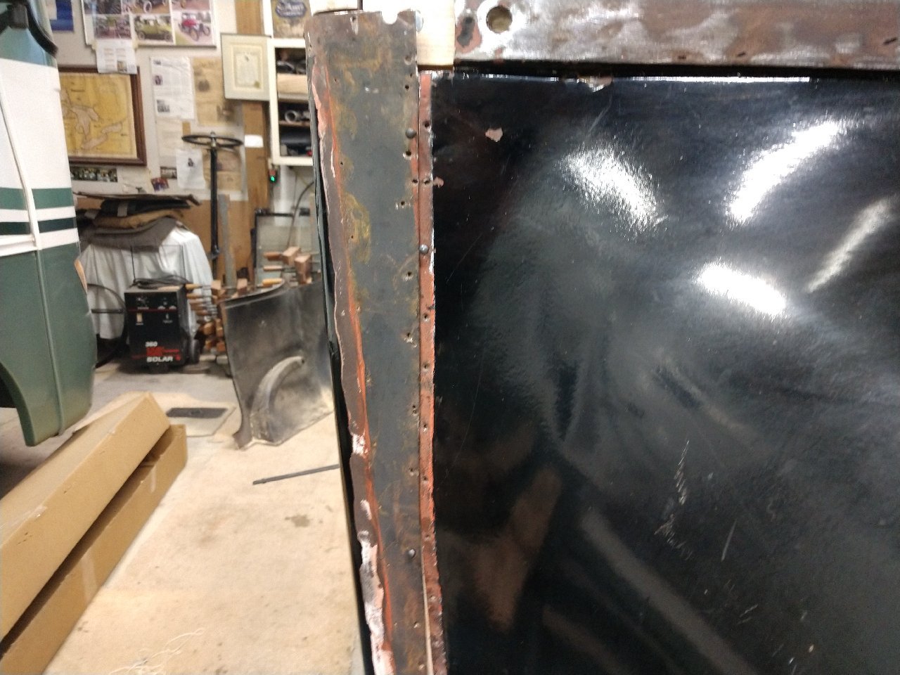

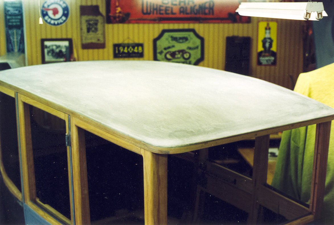

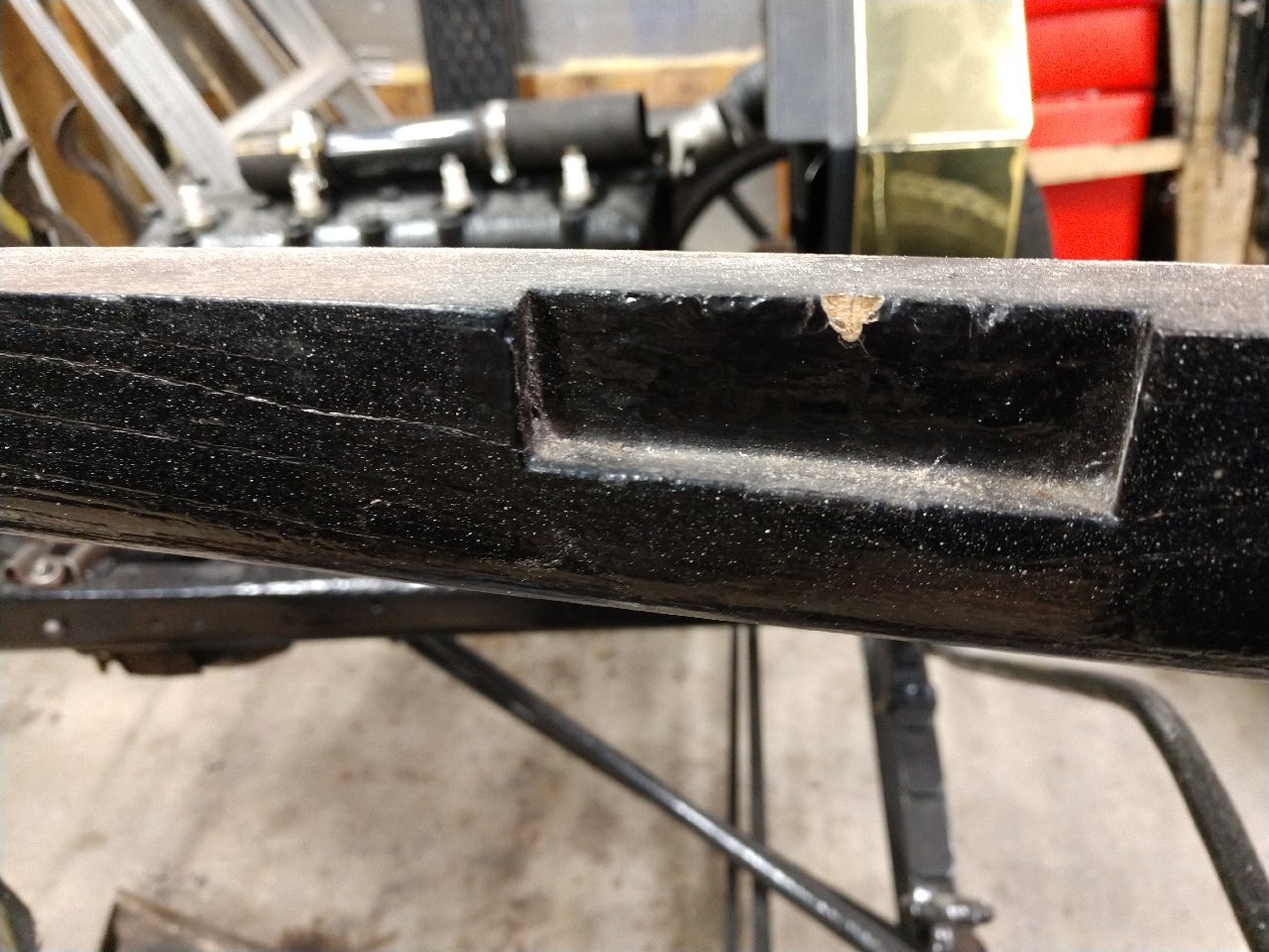

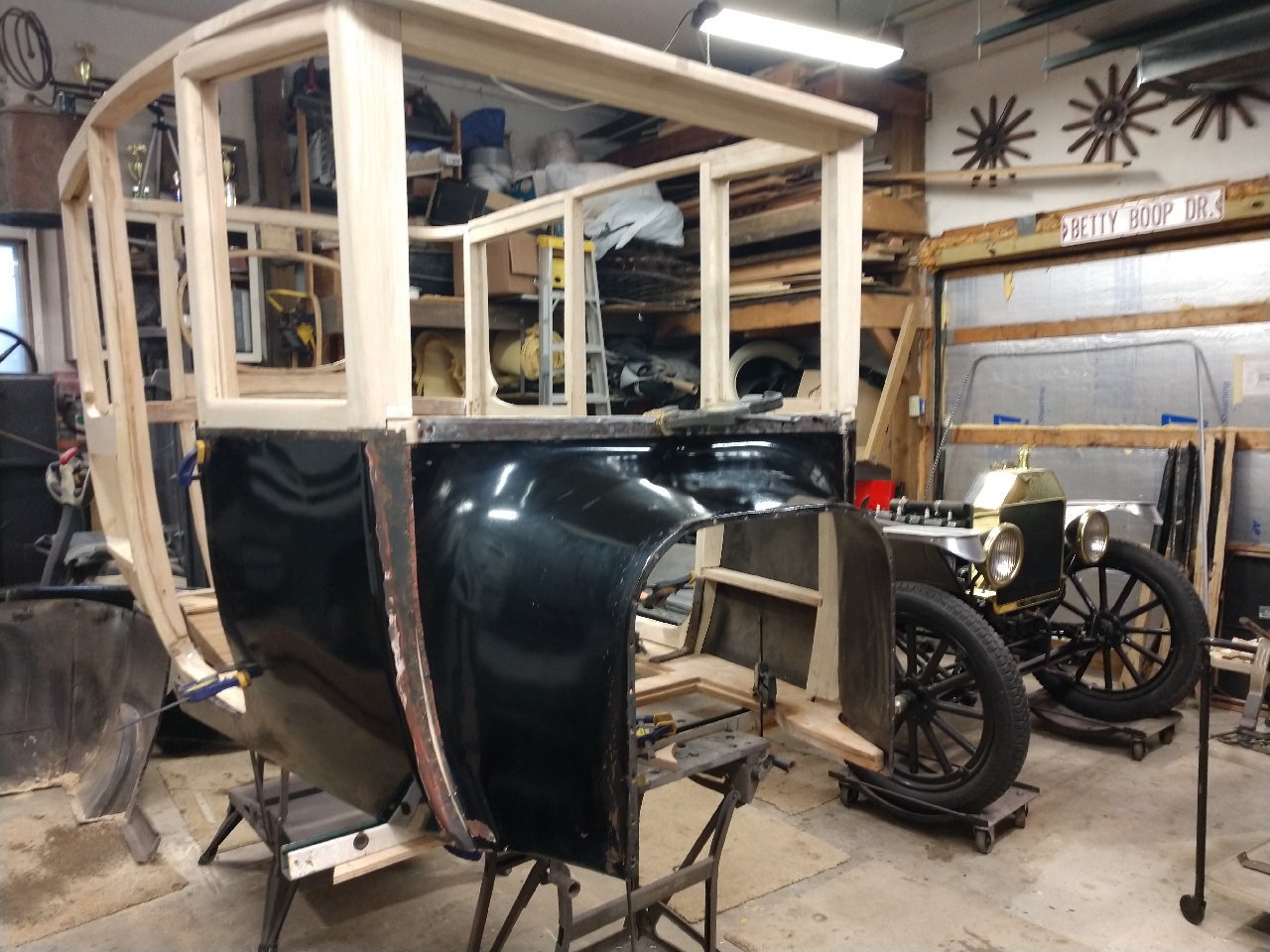

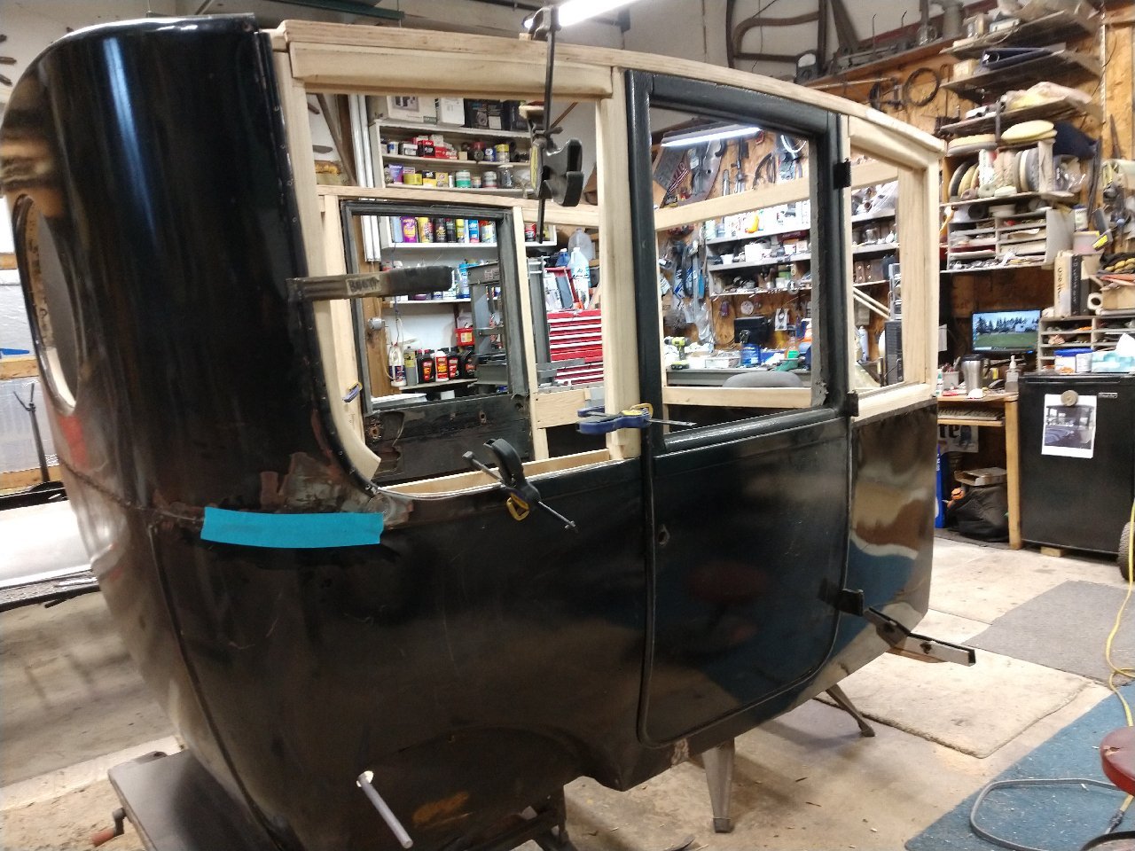

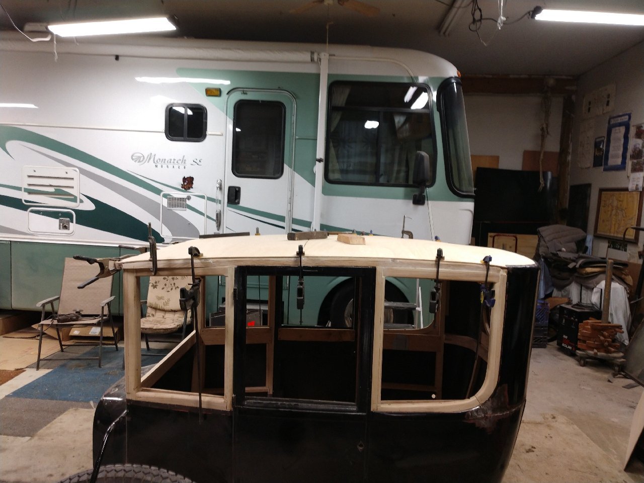

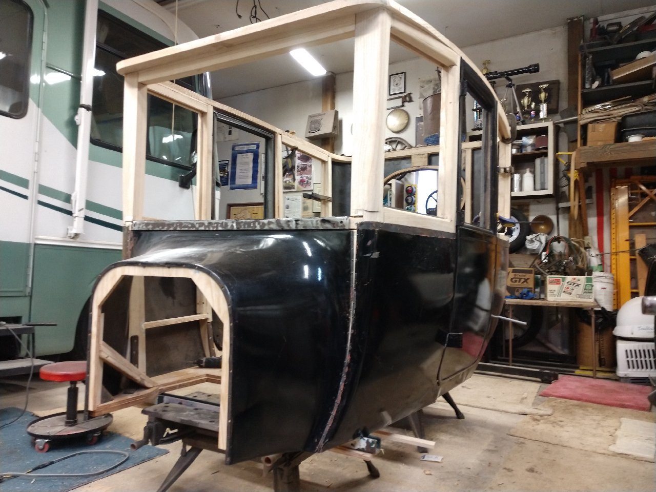

So the driver door has this very precise cutout at the center top. What would this be for? No screw holes to indicate anything ever being mounted there....
Wayne, i'm on EST and I also have a habit of getting up at 0430-0500. Plus the wife gets up earlier than me. So whats a guy to do?
Mr Pair o Keet, that is a fine looking job you did there !! Where's my M&M's ??

Don,
I didn't have a notch in my door at the top but one on the side that it had to align with a bumper to help hold the door in place when closed. I guess it helped with sagging. Do you think that's what it may be?
OR
It where the electric motor for the window opener sits
OR
It's a hiding place for M&M's
OR
OR

I dunno, as you can see there ain't one dang M&M ….. This is on the outside of the door.

Don,
Is there a corresponding notch in the framing above the door?
Since the bodies were hoisted onto the frames, Maybe, this is a "registration" notch to properly align the lifting device for balance and tilting during the installation of the body?
Love your Work, Don.
Terry
Terry

Hi Terry, I don't have the original top rails to know that. It is only on the drivers side door, the passenger door doesn't have it.
Just another ???
Just another ???
- Posts: 4408
Re: '16 Centerdoor restore...
All I know is that I sure don't know?????

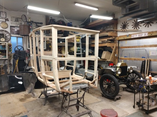

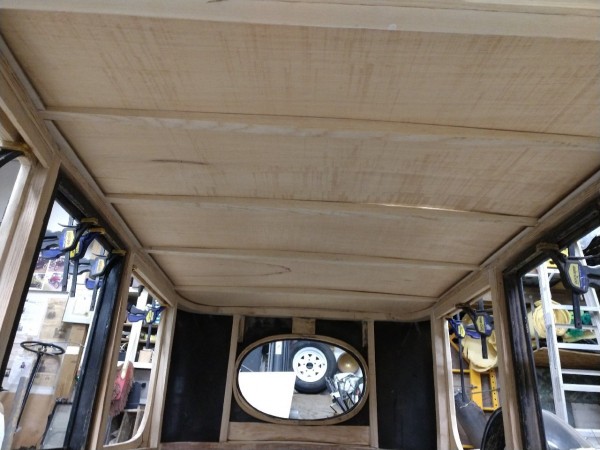

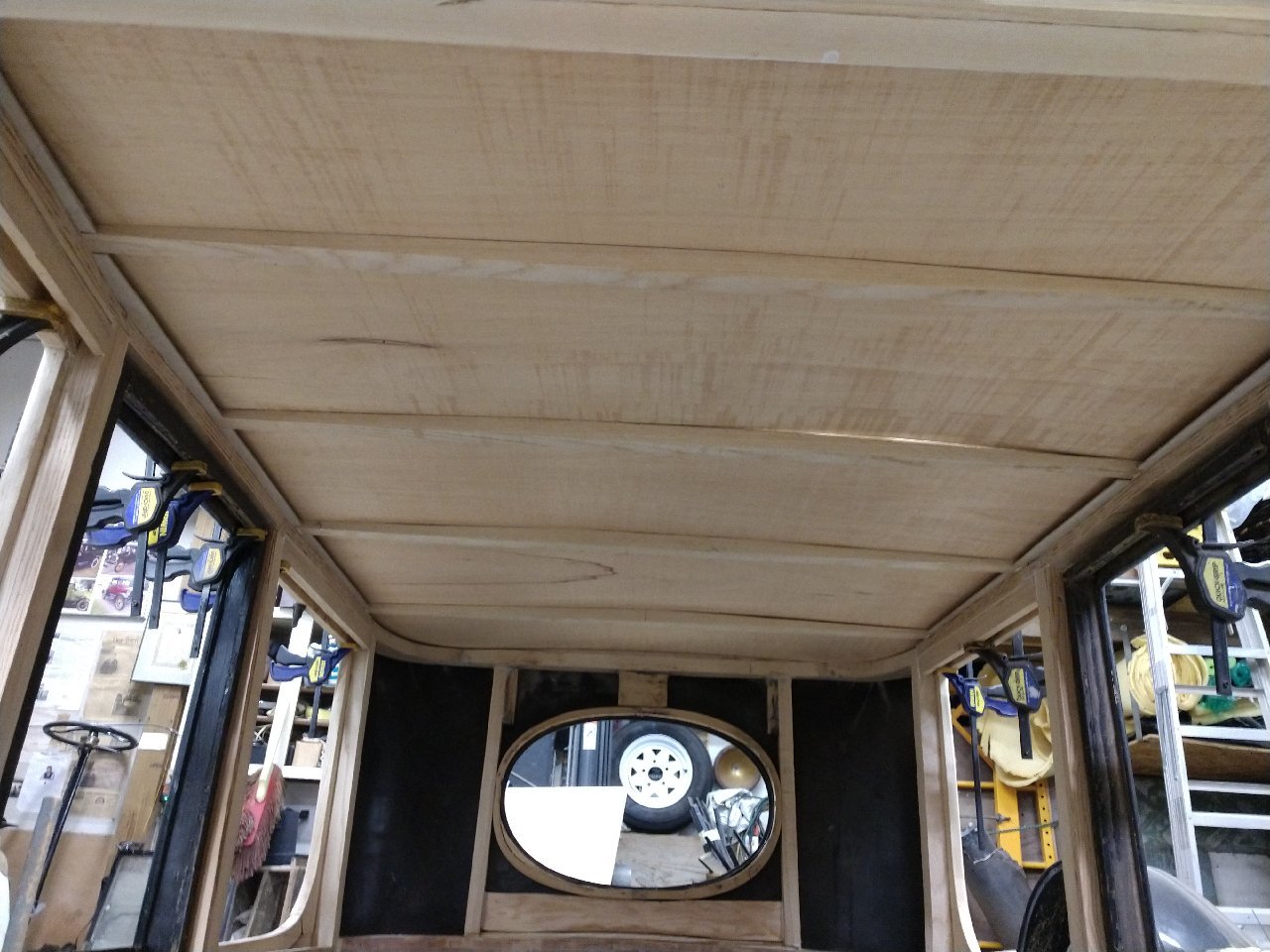

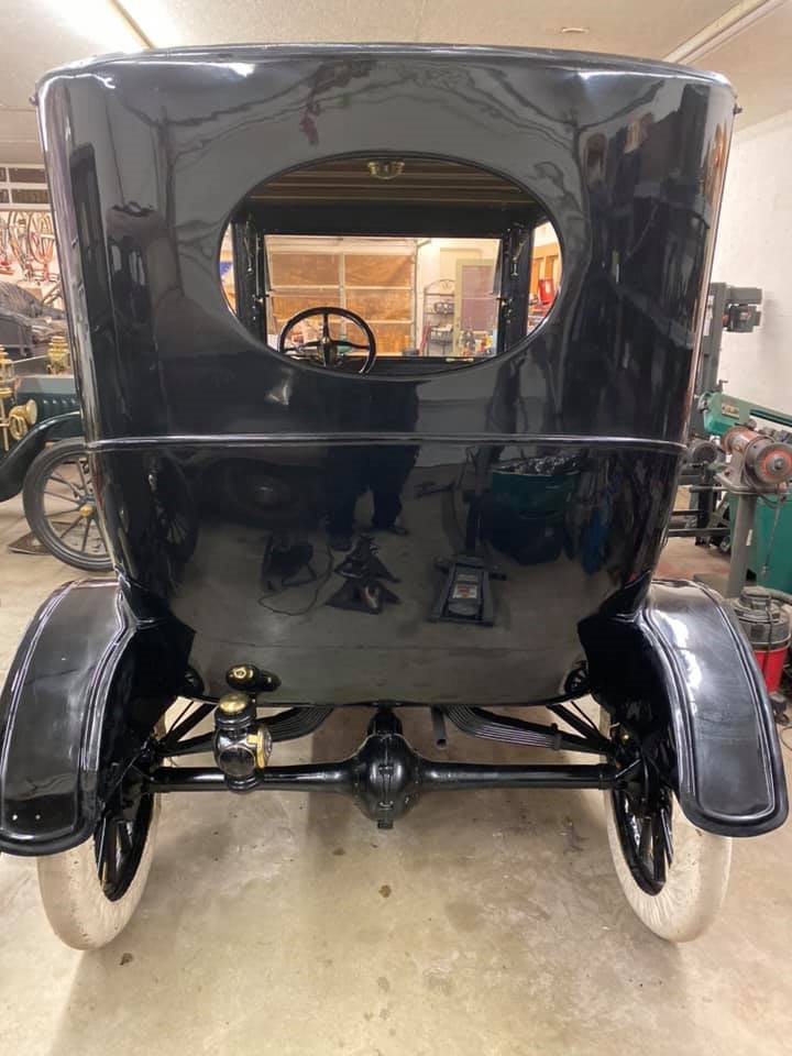

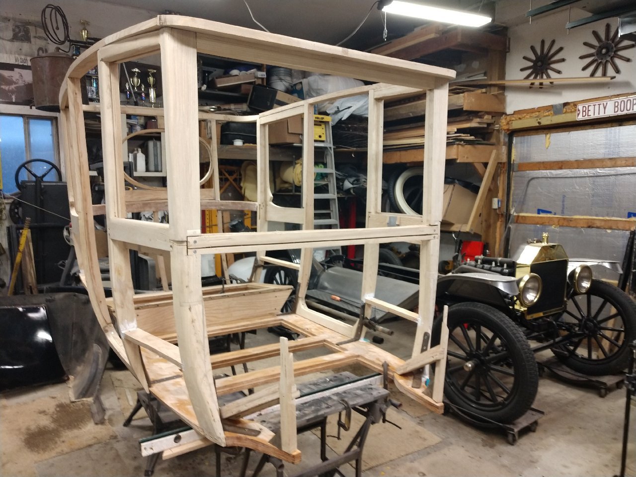

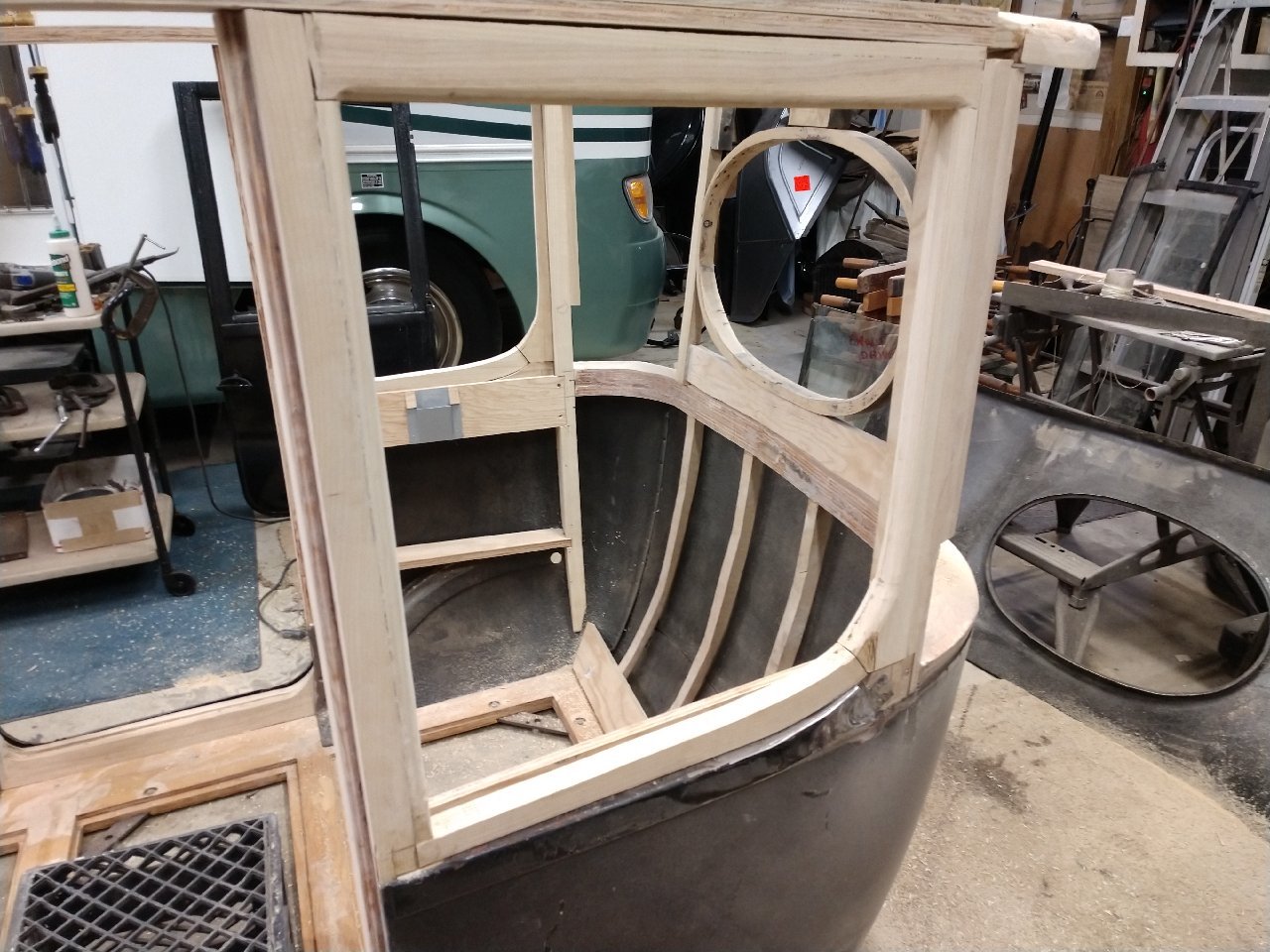

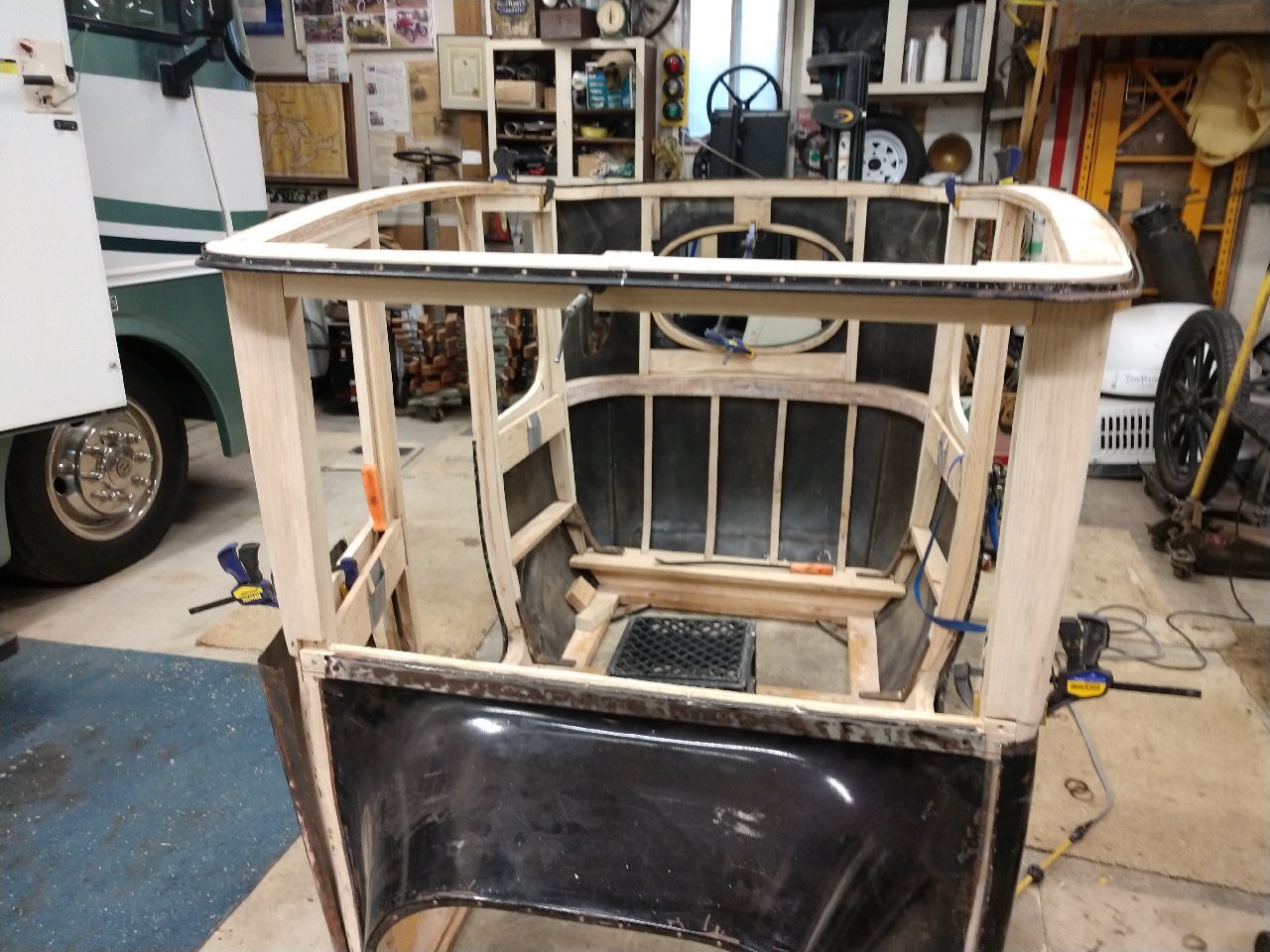

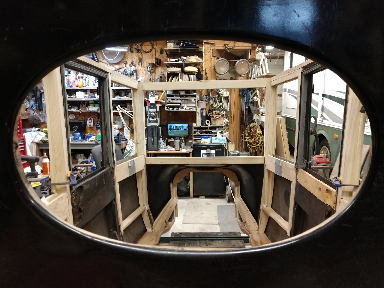

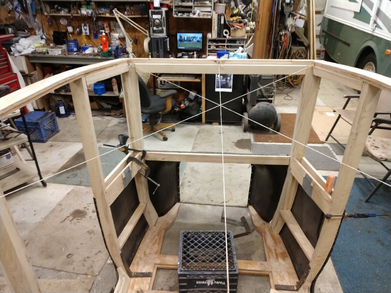

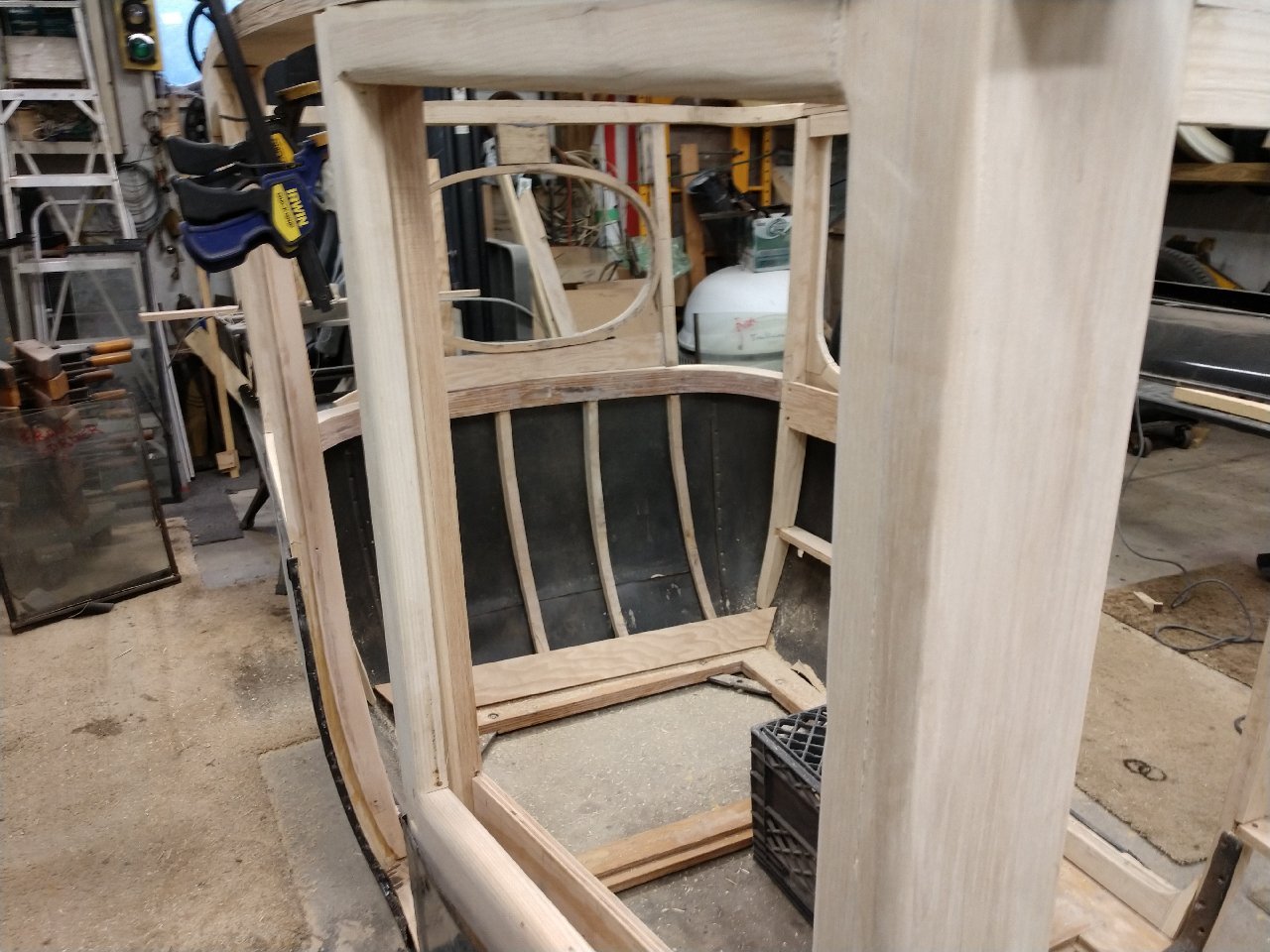

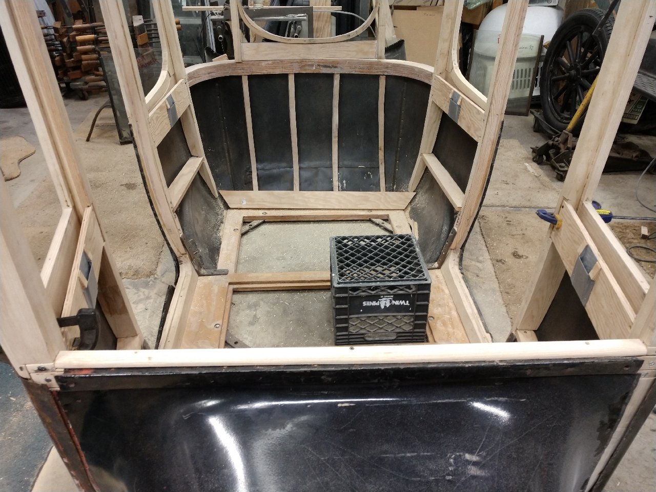

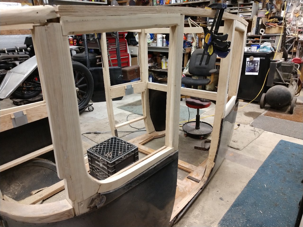

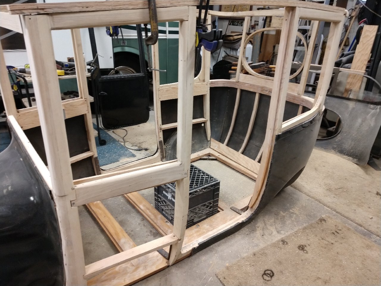

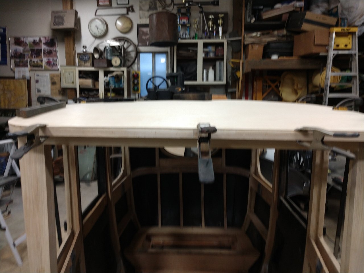

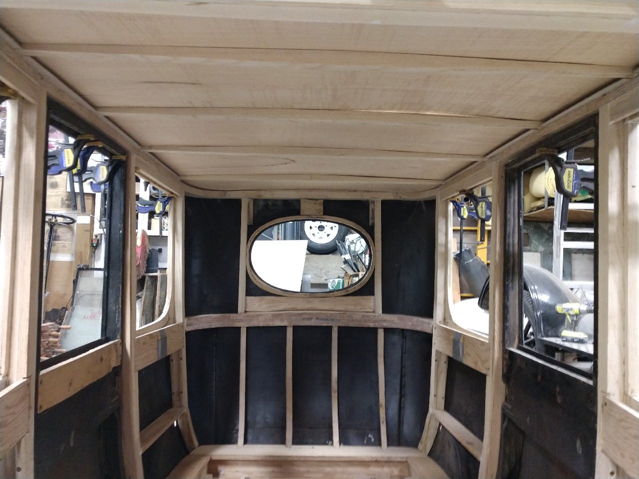

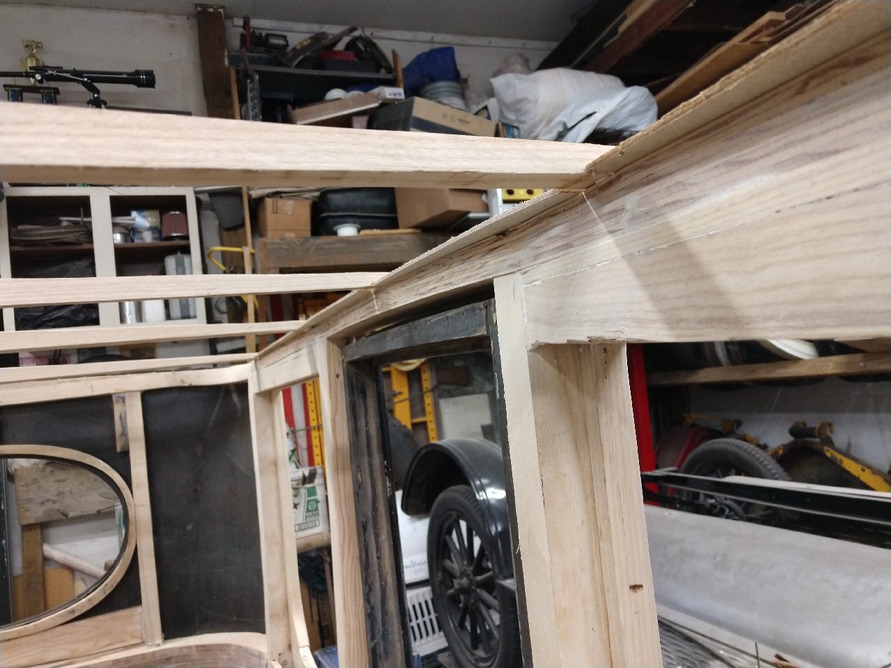

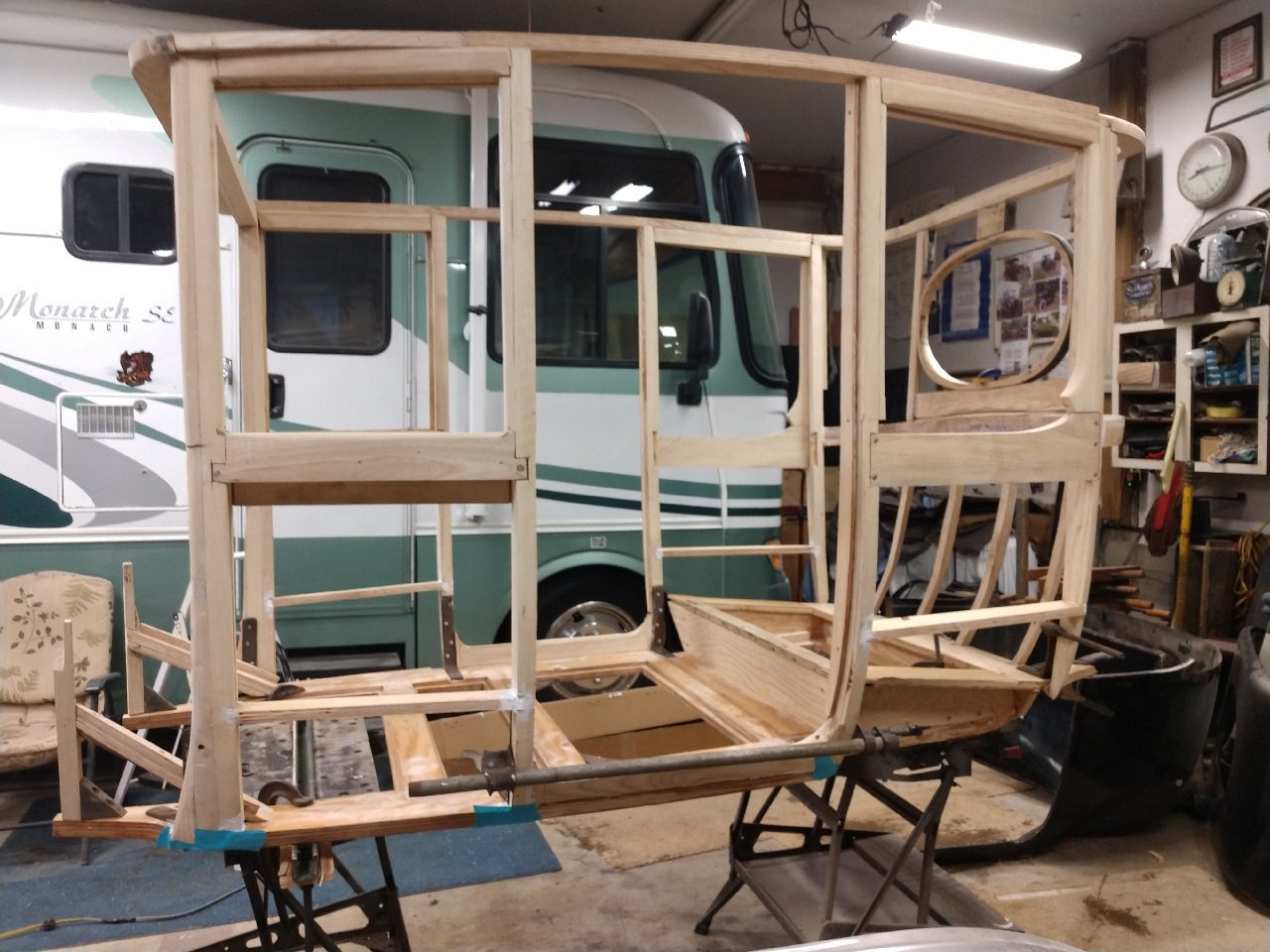

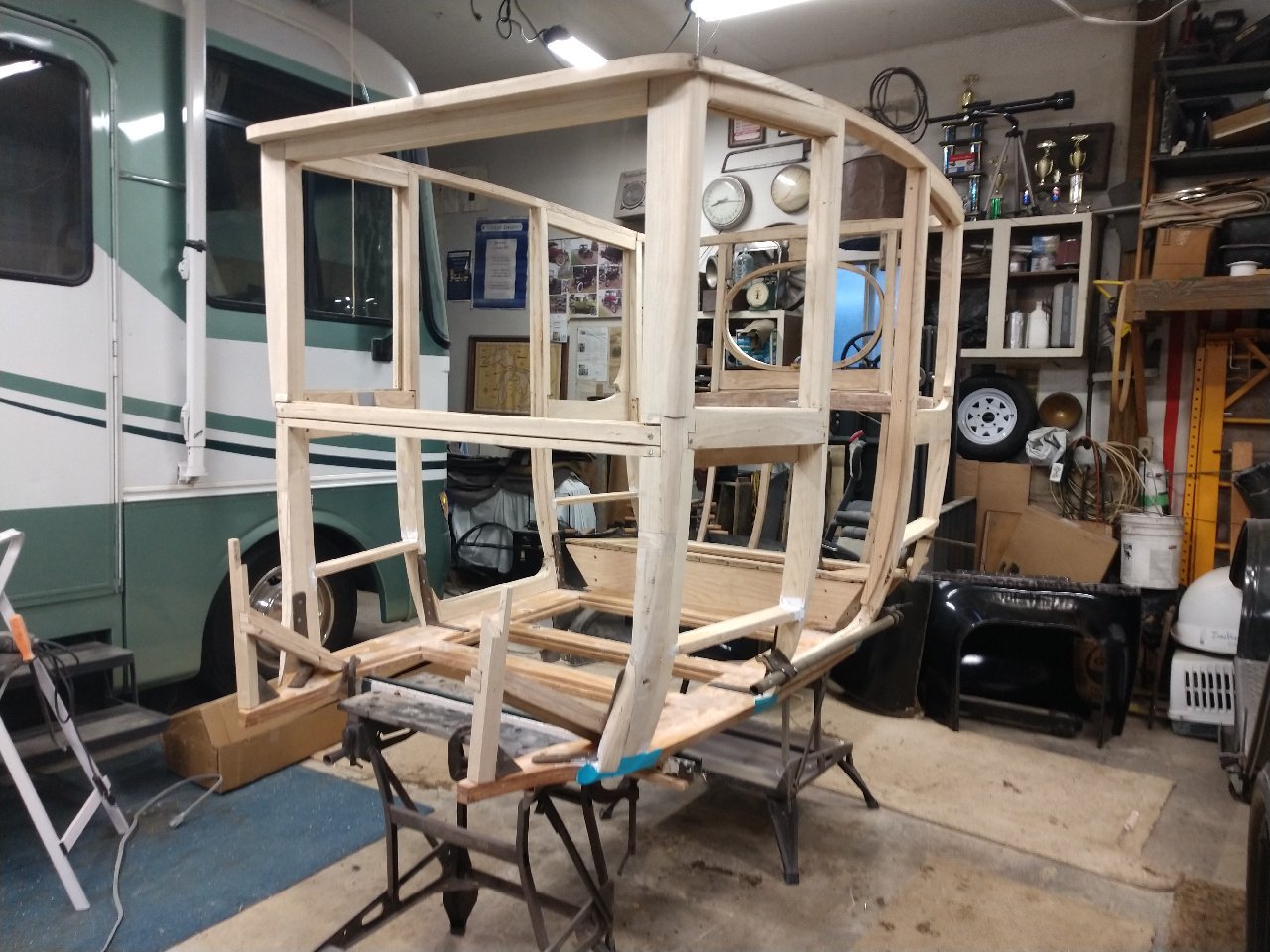

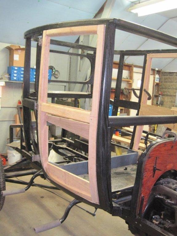

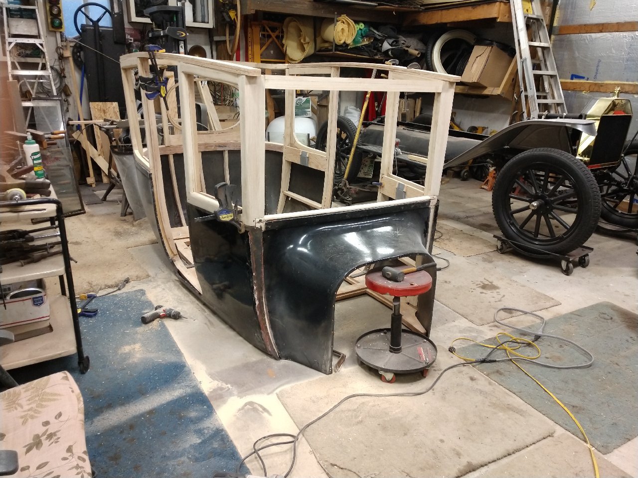

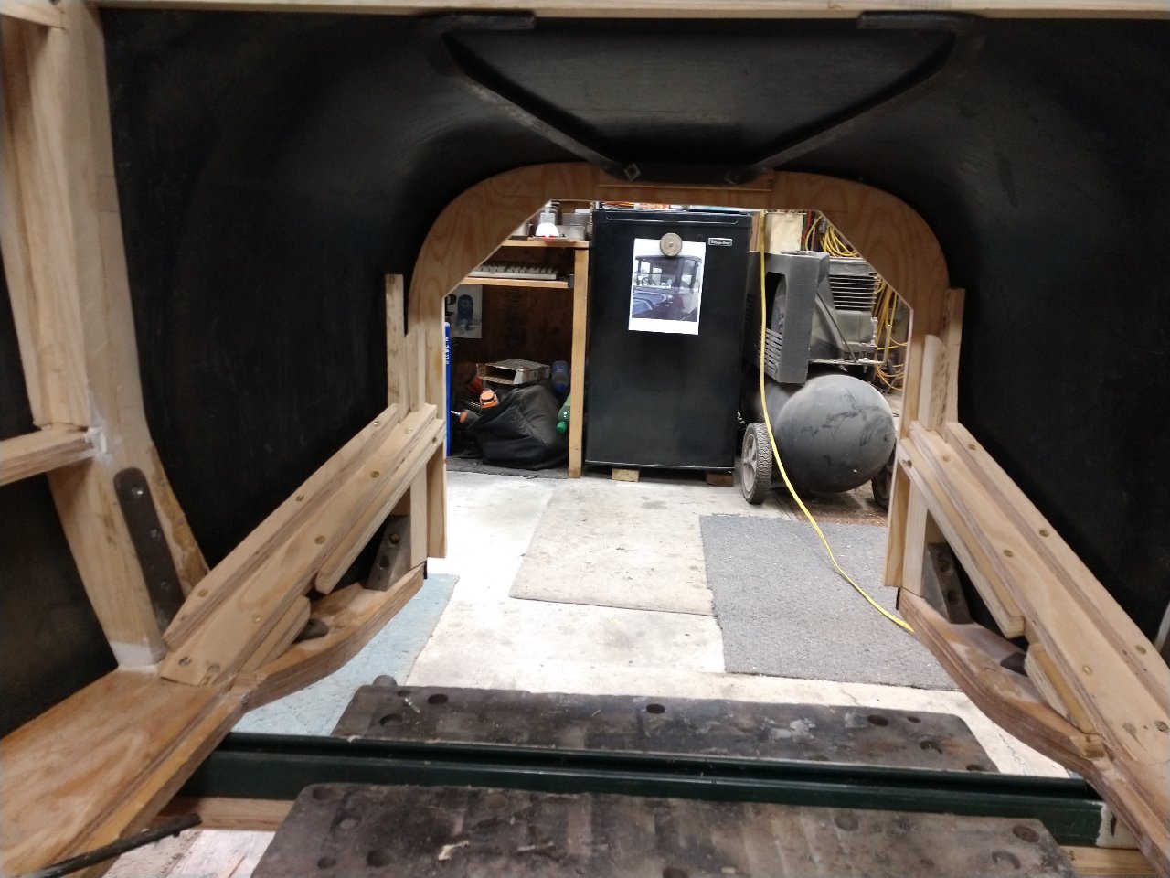

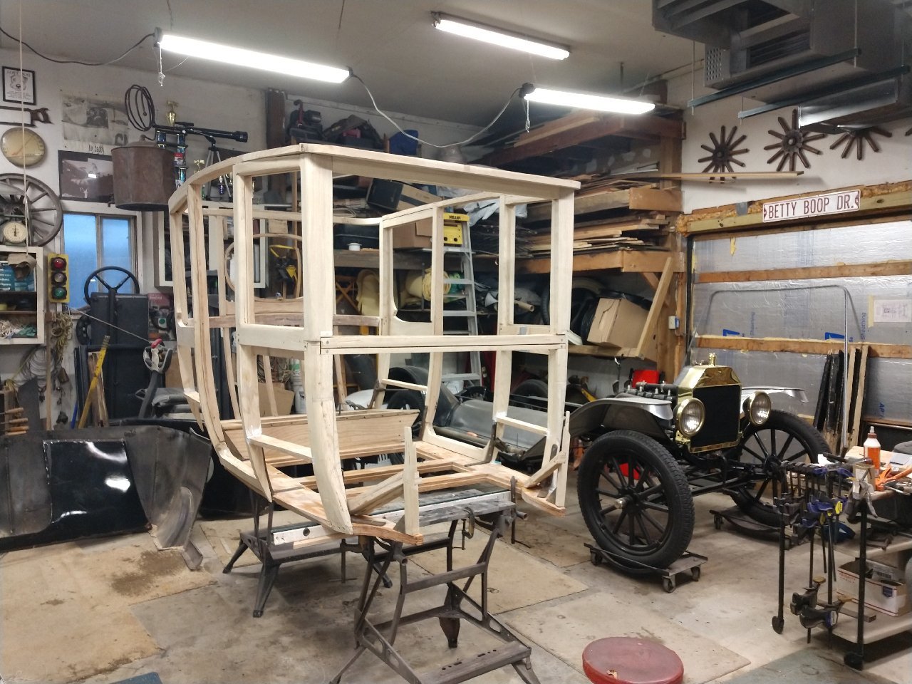

Its starting to look like a Centerdoor. Still nothing is fastened but its time is coming.

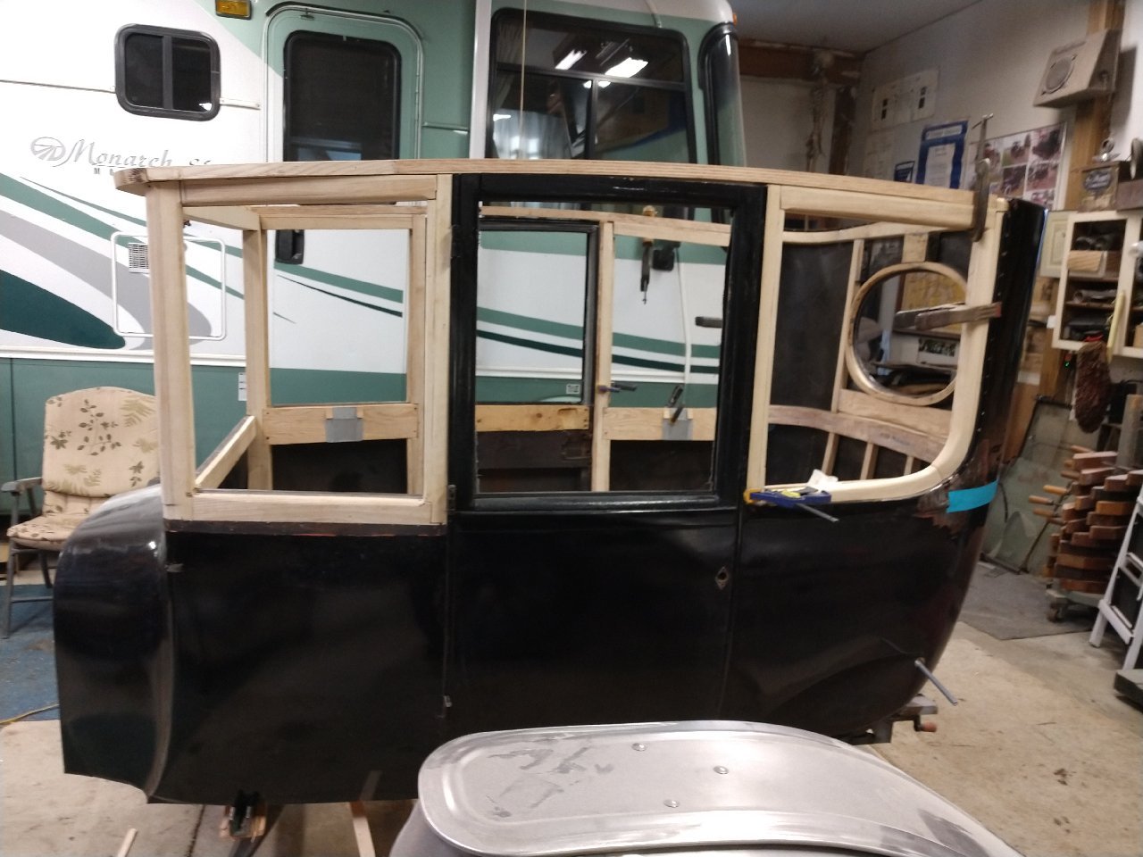

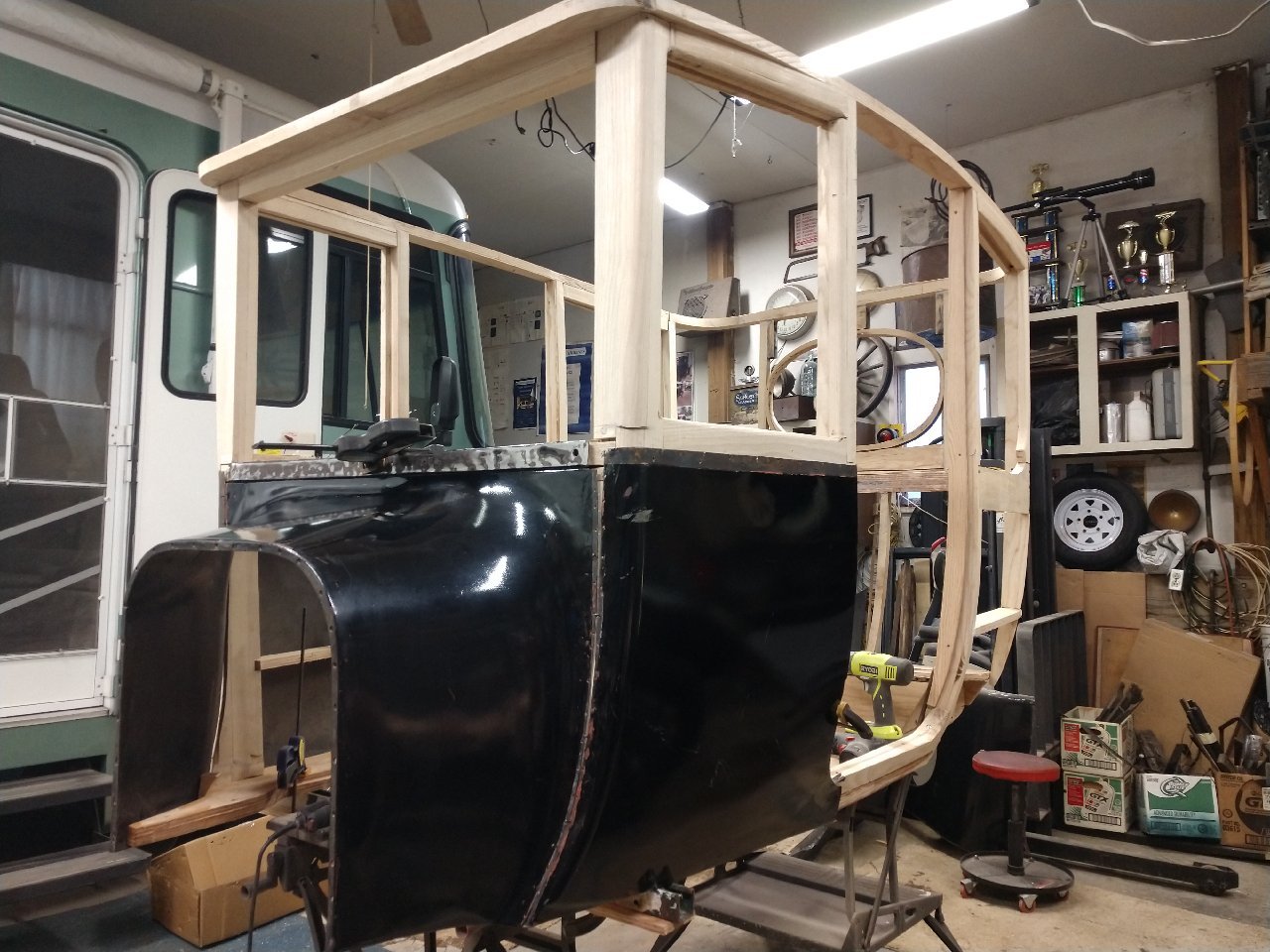

mtntee20
- Posts: 708
- First Name: Terry & Sharon
- Last Name: Miller
- Location: Westminster, CO
Hi Don,
Love your work. Looks Great.

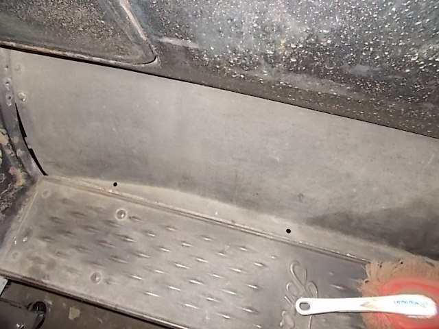

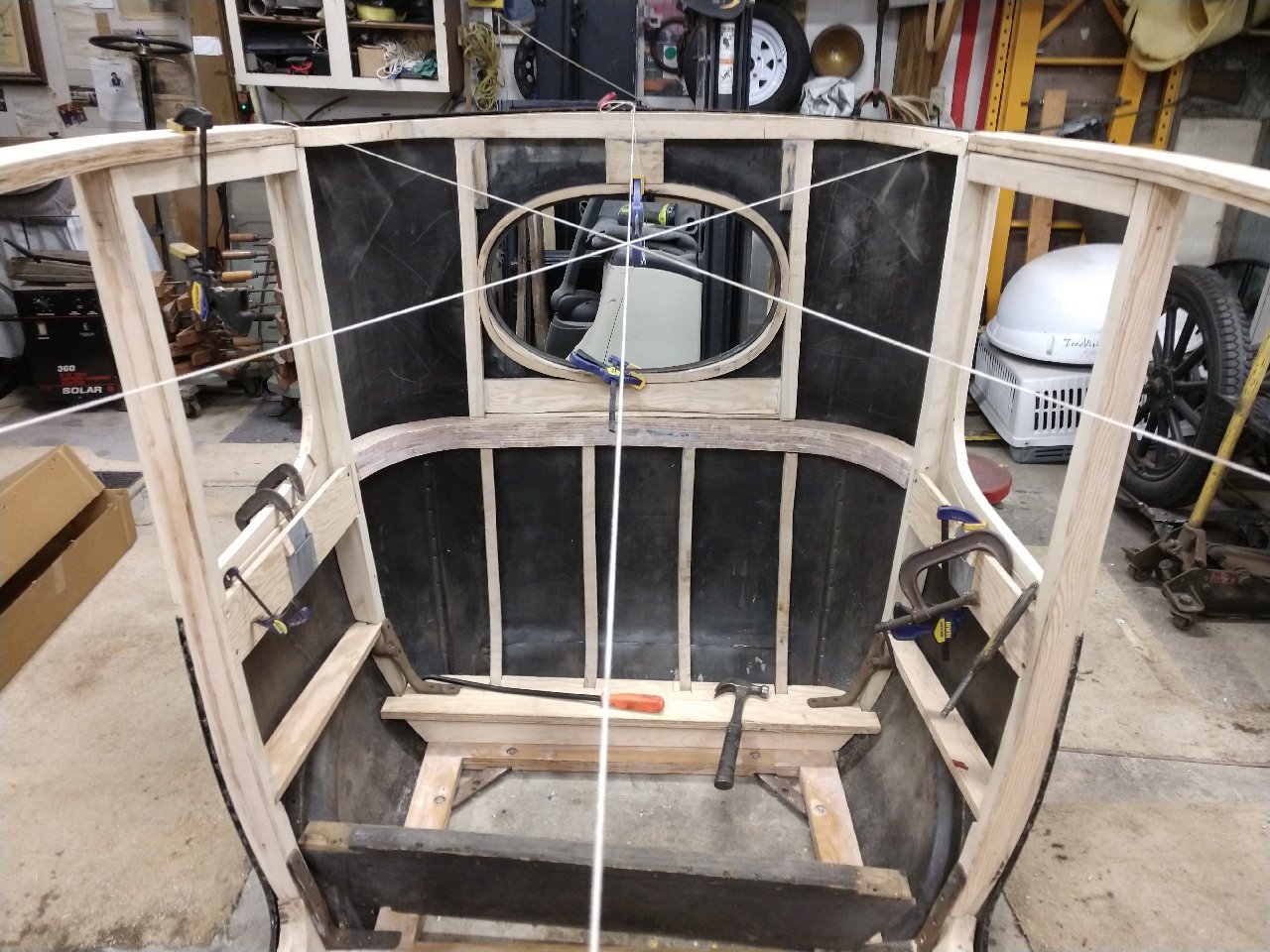

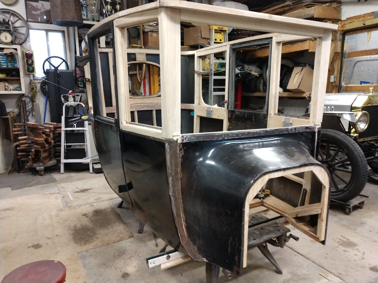

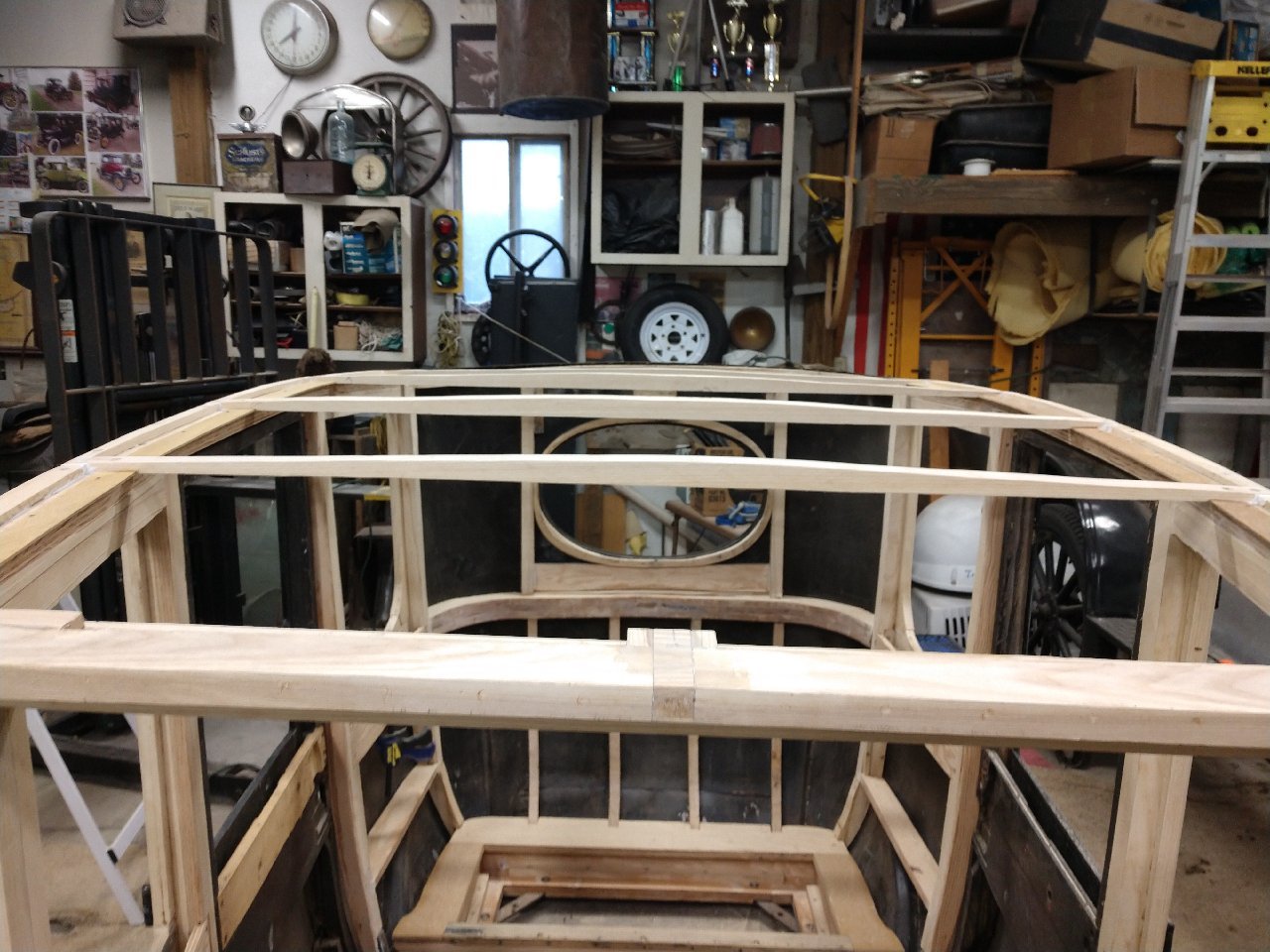

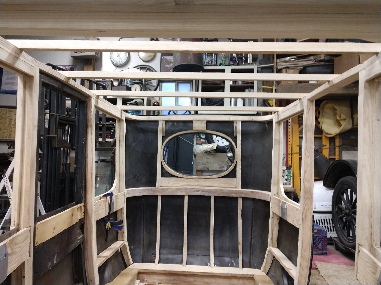

Question: In your last photo, I see a hole in the rear quarter panel. I expect that hole if for the fender mounting bracket. This bracket is straight, threaded on the inside to go through a D-pillar bracket with a nut to mount. In your photo, the D-pillar looks very similar to our 19-20 but I don't see your D-pillar brackets. I can post a photo of our D-pillar brackets and fender mounting bracket if you would like.
Thanks for posting all of the photos.
Good Luck,
Terry Miller
Good Luck,
Terry Miller
FordorGalore
Topic author - Posts: 430
- Joined: Fri May 03, 2019 8:20 am
- First Name: fore
- Last Name: door
- * REQUIRED* Type and Year of Model Ts owned: 1922 centerdoor 1927 fordor 1916 centerdoor
- Location: Nowhere Michigan
Thank you Terry, I do have the "D" pillar bracket and fender mount. I just haven't gotten to that point yet. I really appreciate your offer!! Happy New Year !!

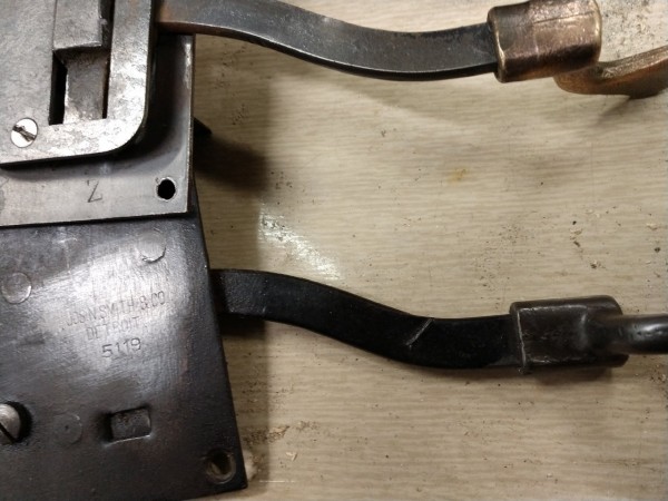

Cleaning and lubing the door latches. The passenger side is brass cast handle with the letter "Z" stamped on it. The drivers side is cast iron with the name "JOS N SMITH & CO Detroit 5119 ". Just curious as to which one would be correct?

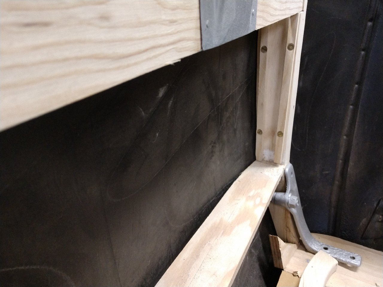

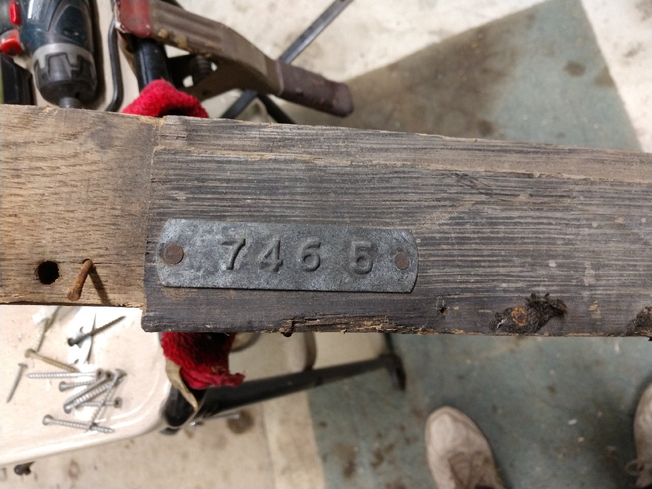

Eureka !! Found this on the original piece of the rear seat riser. Anyone have any knowledge of this ID plate? I know I don't....

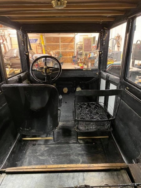

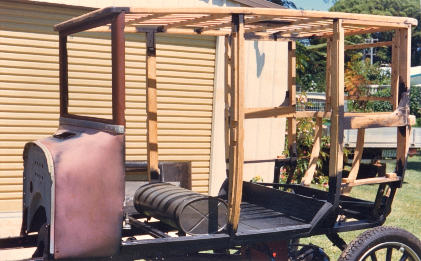

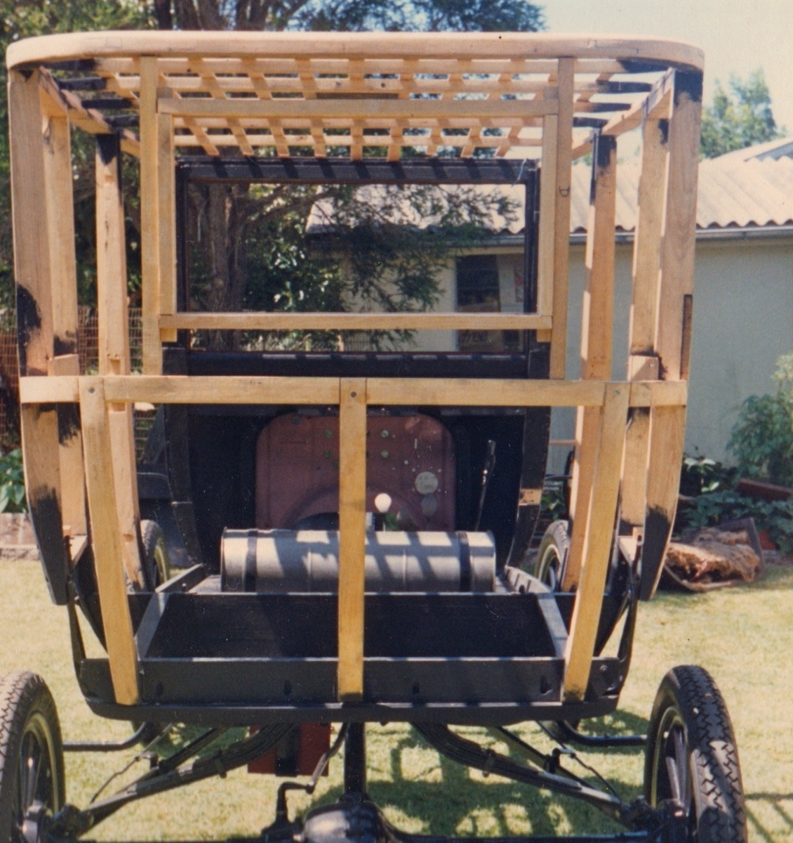

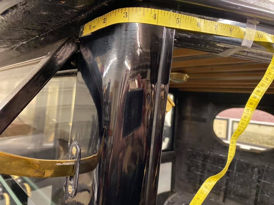

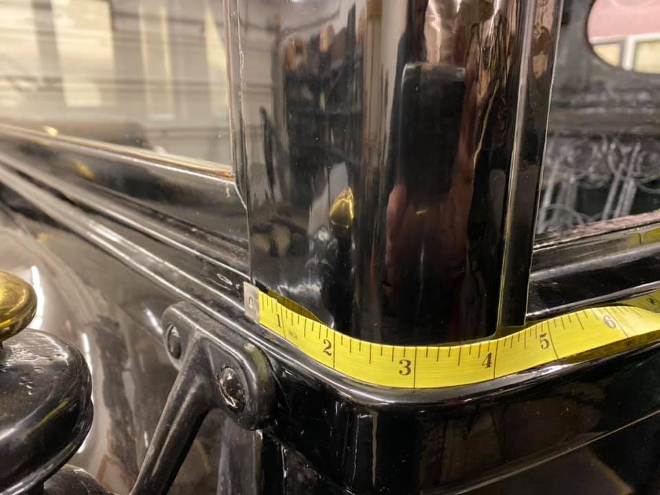

Hap Tucker's 1915 Centerdoor. The owner was kind enough to measure the pillars and they do indeed have a flair at the top.

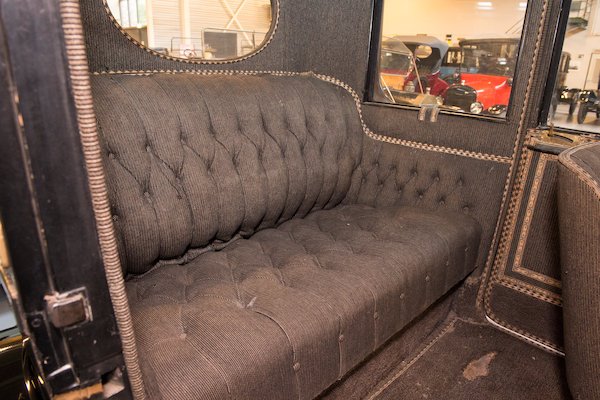

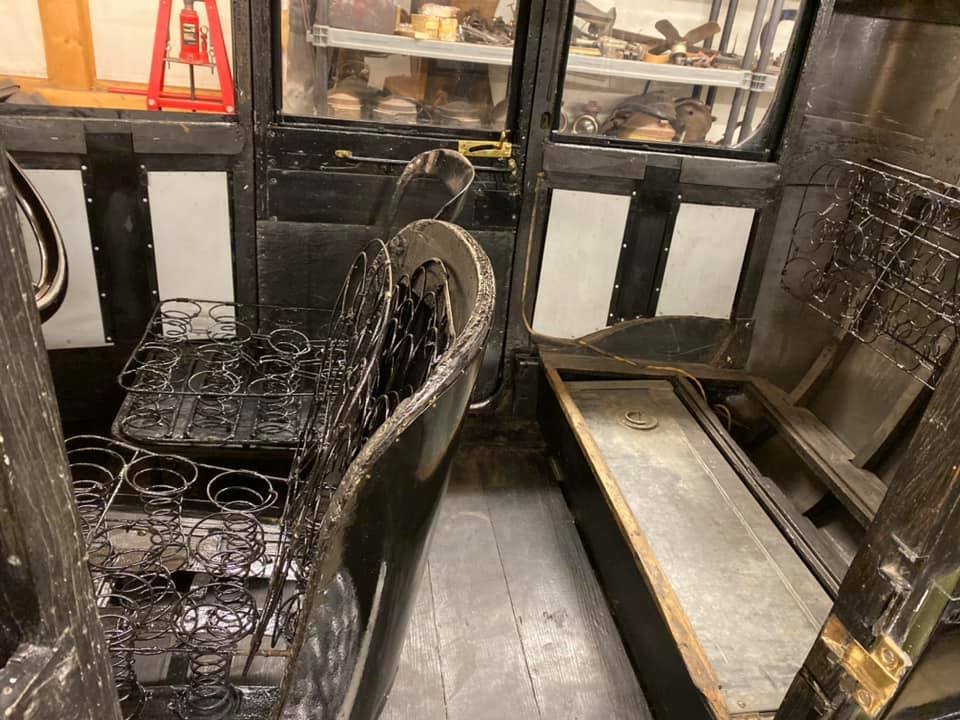

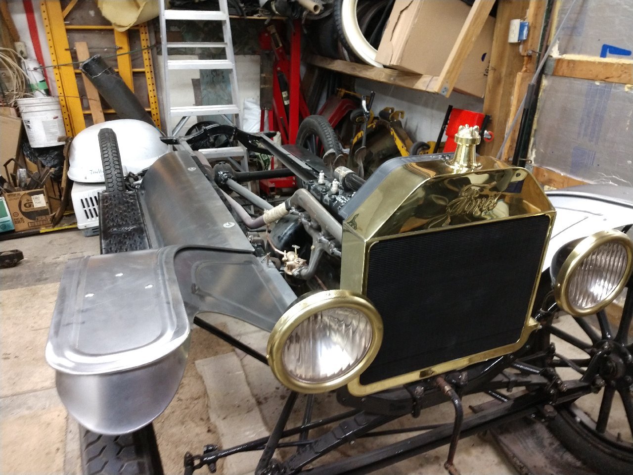

Some more pictures of Hap's 1915, Robert was very gracious with providing me the pictures. Note the massive "A" pillars on that beast. It settles my worries about how mine was working out, or lack of working out.

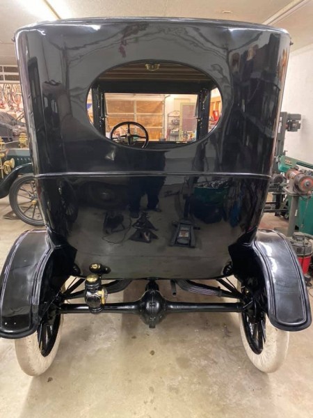

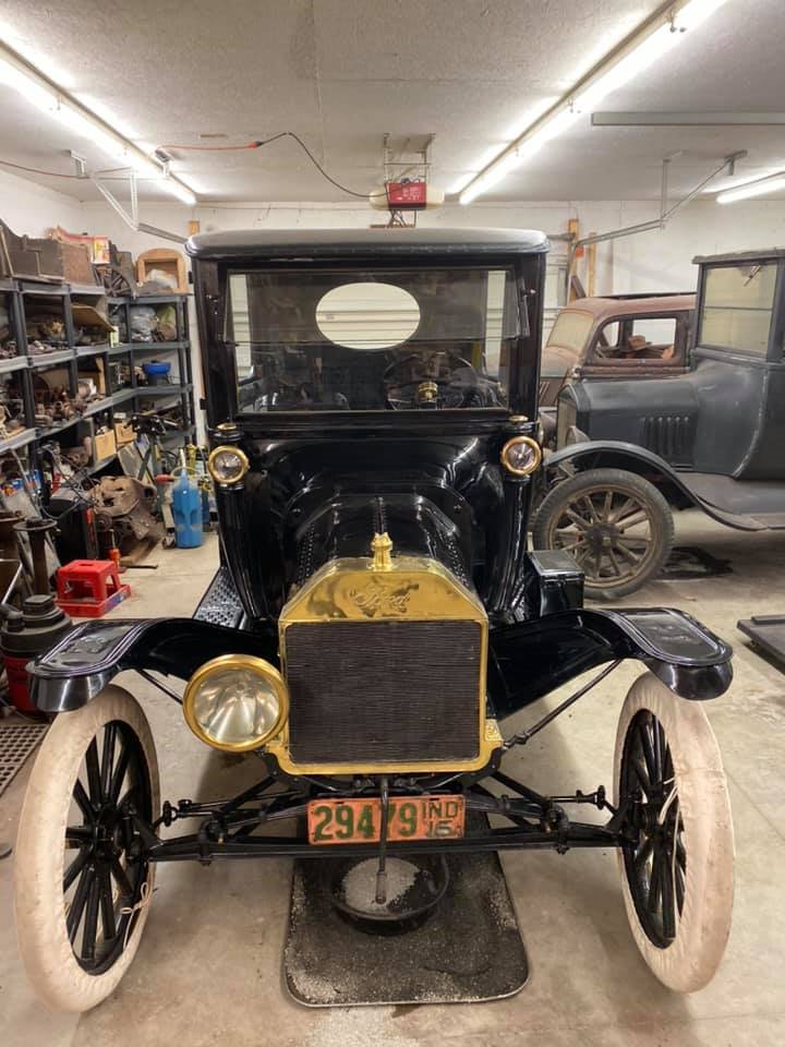

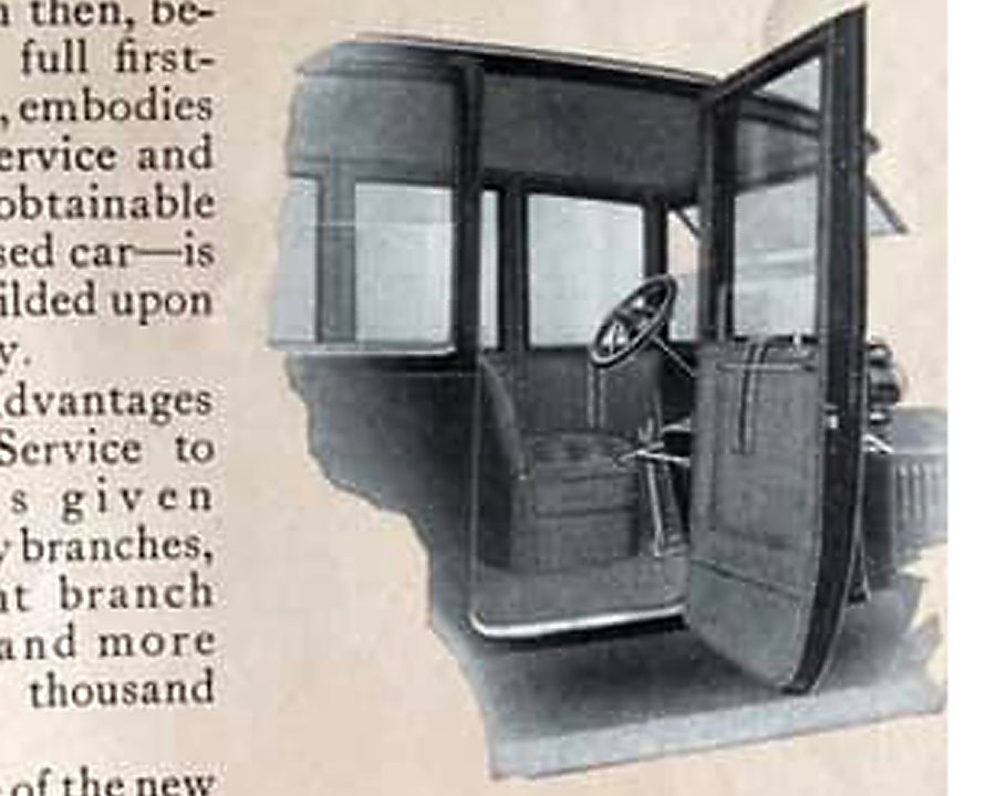

Thanks to Robert we have solid proof that Ford did indeed make early 1916 brass centerdoors !

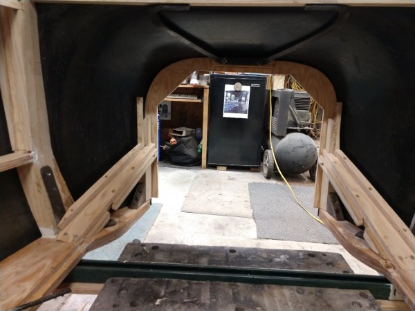

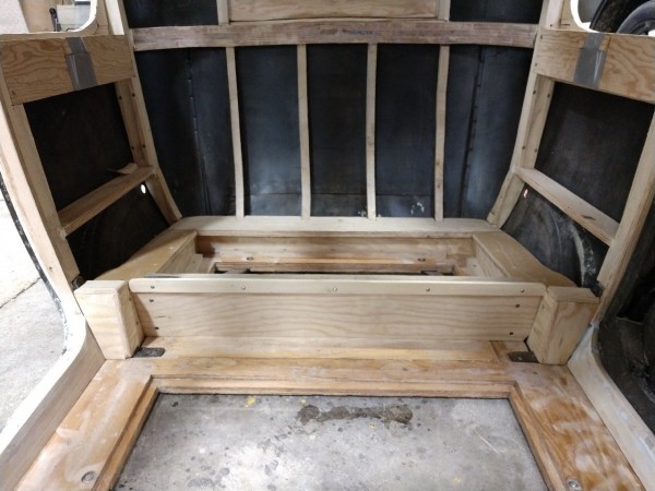

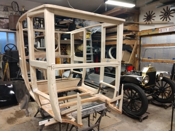

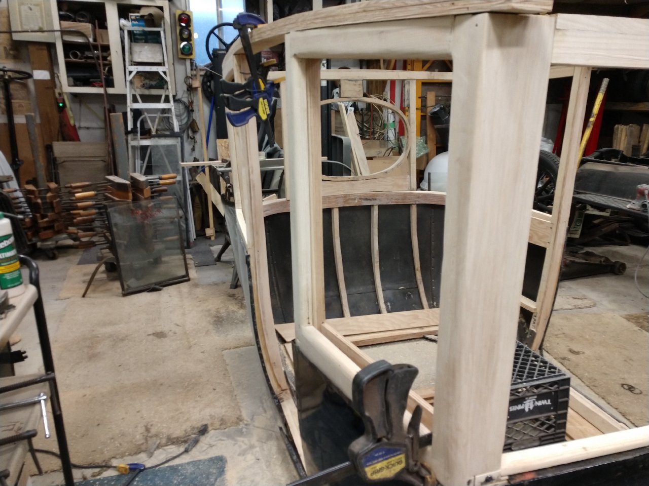

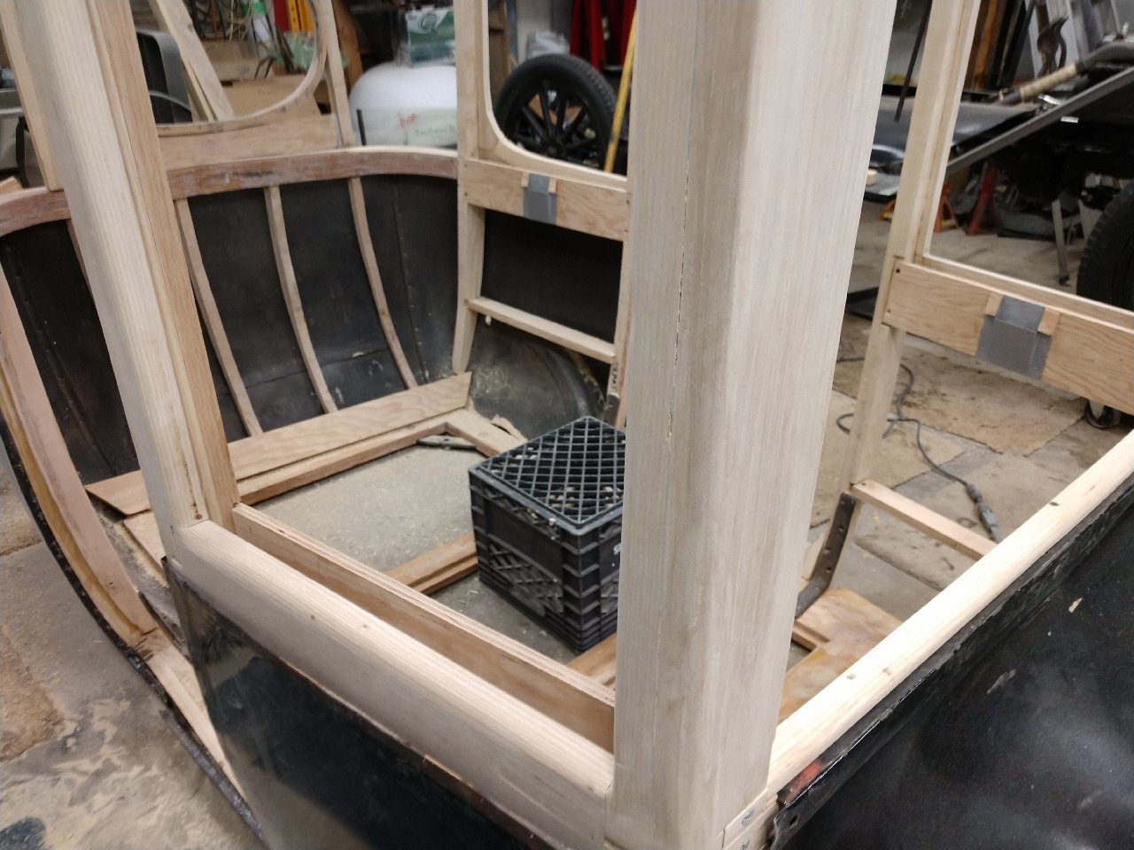

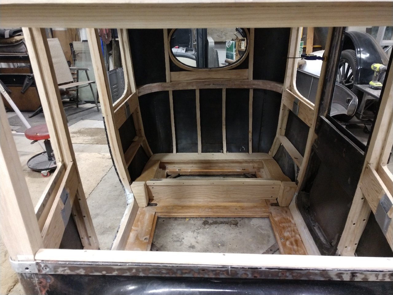

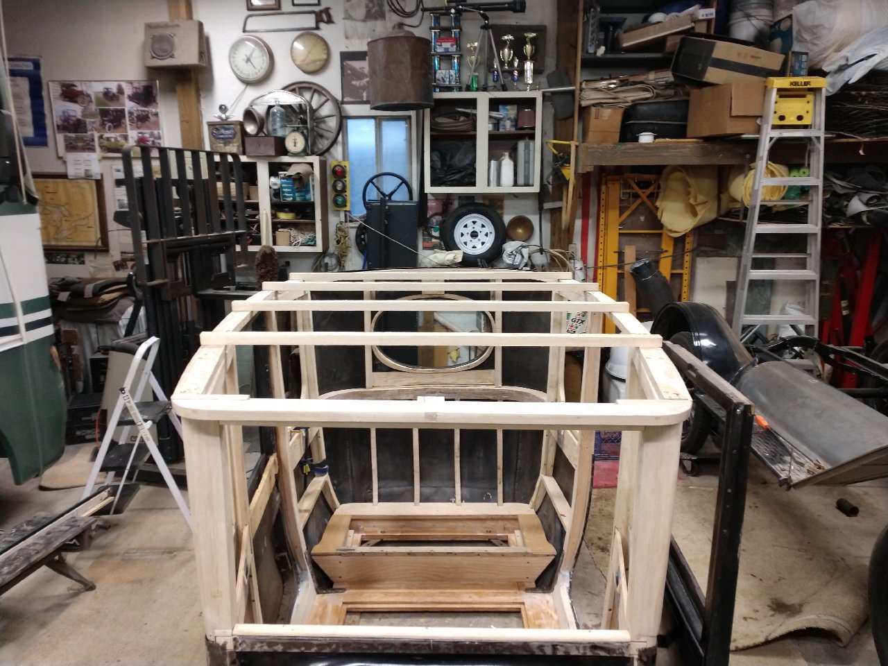

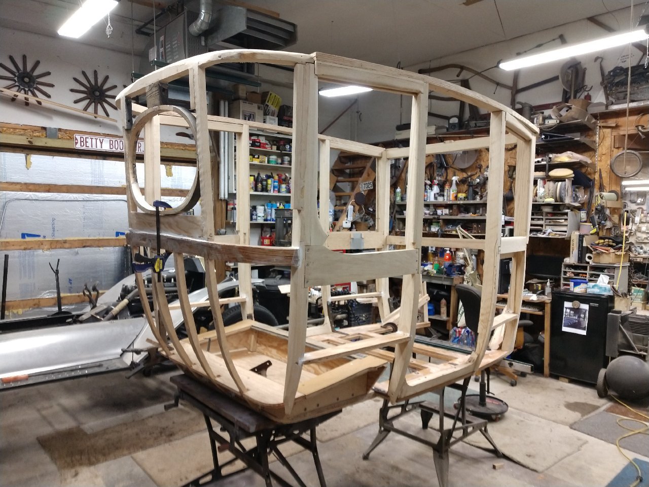

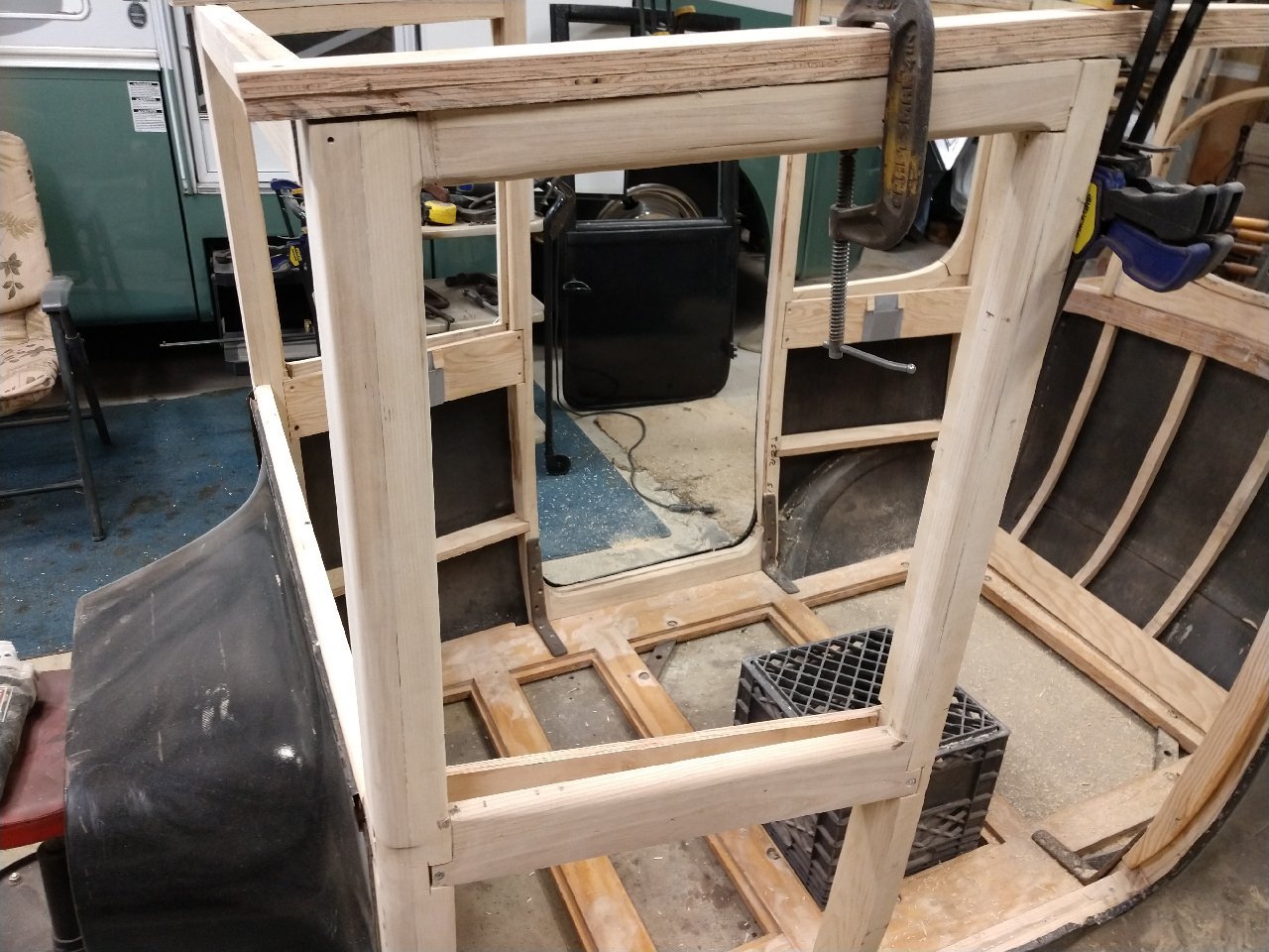

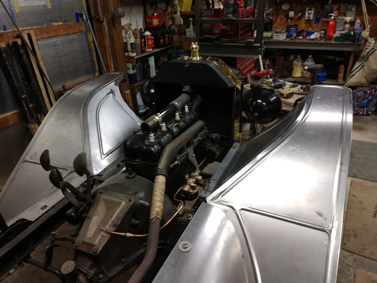

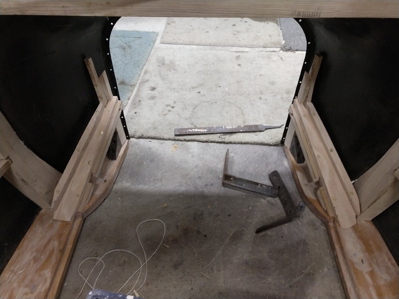

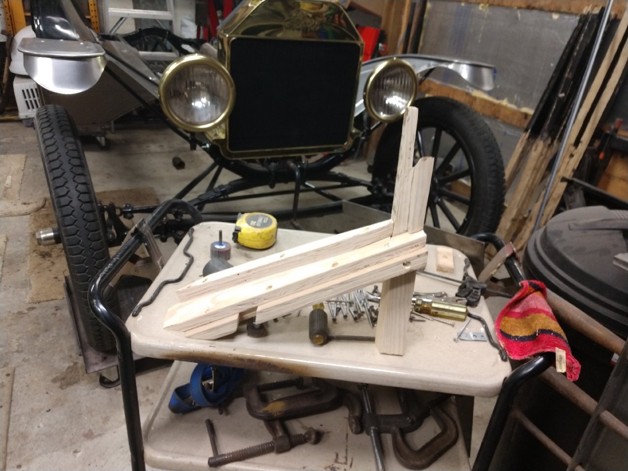

Hey Dennis, I worked on the front cowl this morning and starting building the rear seat riser. I didn't take any pictures today but once there is some noticeable change I will. Thanks for your interest. db

Finally and at last! Maybe the question of whether or not such '16 models were built can be put to rest.
I do not fault Bruce McCalley in any way whatsoever. He did as much as anyone, and WAY more than most, in furthering research into the model T's history! That he was never able to find solid evidence to the early existence of 1916 model center-doors was not a fault. It was a fact of the dismal state of the recorded history when he started his quest. I got interested in researching the history early on because of the obvious idiocy of many things I was being told by people that thought they knew the T's history (like the fellow that swore the '14 rear end in his '23 runabout was the factory original!). Bruce did say in some of his writings that he had not yet seen anything that proved a '16 style center-door sedan was built by Ford. He did not say that there was any certainty that they were NOT built. Unfortunately, a lot of people assumed that he said they were NOT built and ran with that assumption.
These images posted are the best I have seen showing the '16 style car in sales literature. I had seen several images many years ago that indicated such a '16 was offered, and therefore likely built. However those previously seen images were not detailed enough to be sure of the differences between the two years.
I do wonder, and ask, is there anything on the original literature piece (or source?) that clearly gives a date? Would those be an early '16 model year piece? Or a later '16 model year piece? One of the pieces I saw years ago showed what looked to be the '16 style center-door sedan, and was dated August of 1915. So that always made me believe that the '16 style was offered very early in the '16 model year.

Wayne I haven't found a date on the brochure, I was going by the brass front end and the gas tank under the drivers seat. This actually came from the owner of Hap Tucker's 1915. Robert has been extremely helpful answering my questions about the pillars and such. He sent this via FaceBook to me and I just about filled my Depends !! It has the identical interior design as my early '16. And as just dumb luck would have it the dimensions on his "A" pillars and the amount of taper ….. I was within a 1/16" match at the top and bottom. No brag, just fact.

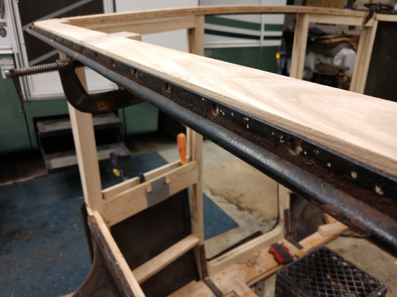

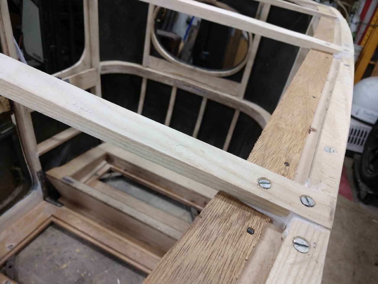

Working on the top rails and checking the distance of the overhang. I'm using the rain gutter for a guide on both. The gutter seems to be happy about it. Still NOTHING is fastened or finished here. Just having fun with it.
- Posts: 4408
Looking good!
It's not only the talent and perseverance to do this project but taking time to shoot great photos that makes this so wonderful to me. These can be so beneficial to others that follow. Denny and others shared their Coupe photos when I was struggling with mine. It was such a wealth of information.
And just plain fun to see the progress.
Thanks again for these.

Thank you Rich, this is my favorite part of these restores. So after working on the "A" pillars and front header and top rails, I thought I should probably check my work again. It appears I am having a good start to a brand new day !!

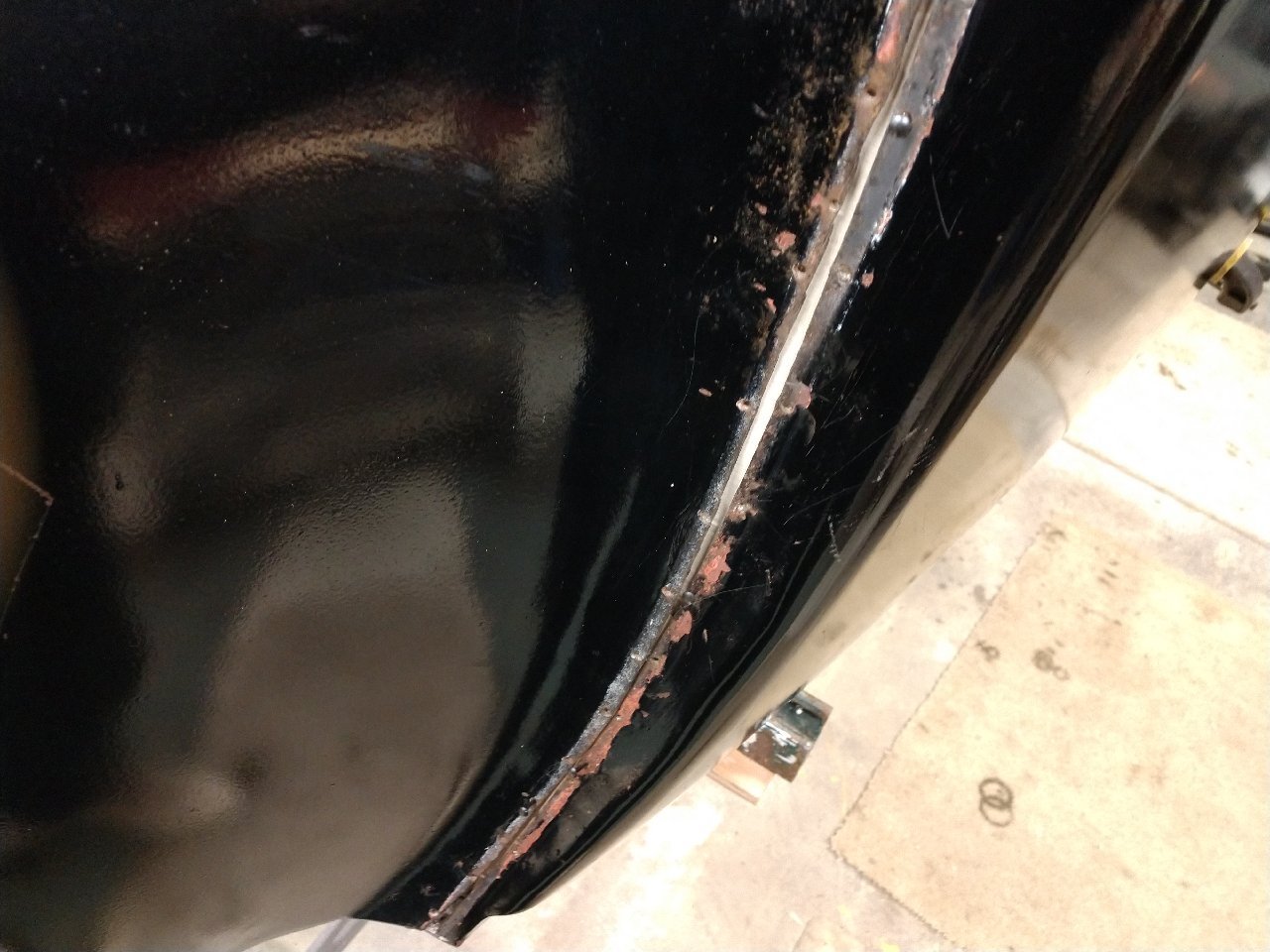

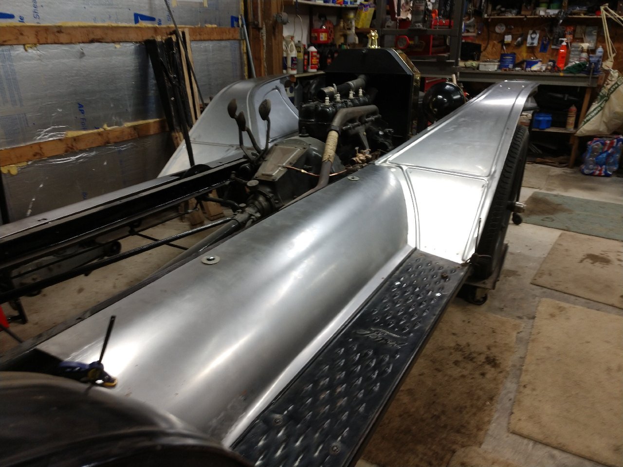

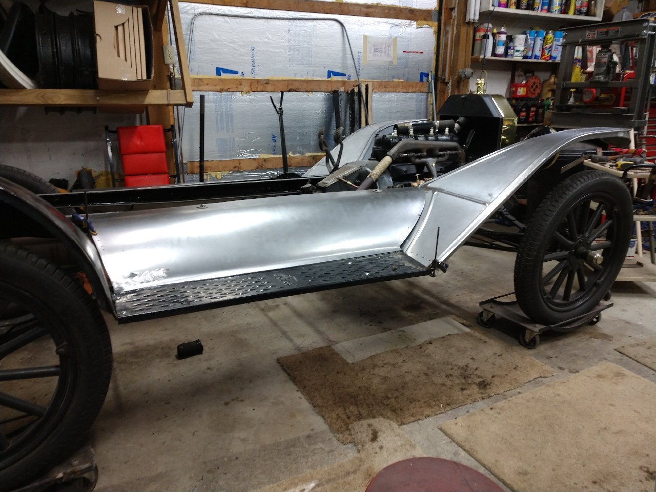

Don, I question your splash aprons. Should they not have a bump out in the rear to clear the brake rods? My 17 has this and I understand the 15 and 16 also should have this.
FordorGalore
- First Name: fore
- Last Name: door
Hi Jim, I just have the aprons clamped on with the rear fender and there seems to be plenty of clearance. I also looked at pictures of Hap Tuckers old '15 and that doesn't have any hump on the splash aprons that I can see. So I checked out other said '16's picture and no noticeable hump. But, if you feel this is incorrect I will do some asking around and see what comes up. Thank you !!
- Posts: 2549
- Last Name: Strange
- Location: Hillsboro, MO
- Board Member Since: 2013
The MTFCI Judging Standards, Seventh Edition, says that splash shields (aprons) for 1915 had an "Embossed Curve" at the back end.
For 1916, it says that splash shields (aprons) had an "Embossed Curve" at the back end and that by August 1916 the shield was modified to follow the lines of the new crowned fenders (whatever that means).
For 1917, it says that the stamping for the "Embossed Curve" was eliminated around August of 1917.
According to the MTFCA Encyclopedia:
1912-1916
Aprons now tapered gently to the rear fender from a point about 10” from the rear fender, reducing the apparent bulge.

Similar to 1916 but patterned to fit new fenders. In early 1917 the aprons were modified to smoothly taper from front to rear, with no bulge at the rear.
Hope this helps.

;These photos should show these splash aprons,
- Posts: 4408
Reproduction side aprons have never been made exactly correct. It isn't something that needs to be really concerned about. No restored T using reproduction side aprons is really right, which means most '15/'16 Ts we get to see on tours and shows. Those actually look closer to correct than most of them are. Just a part of the real world we live in.
That '16 c-door is looking better and better!

The aprons have the same shape as Jim shows. I will try to get a good picture of it. I do have to say it isn't as defined as Jim's.

Two days making these little floorboard risers !! TWO DAYS !!!!! Nine Billion and 3 angles to cut and match. Snippy little boogers ! Keep in mind nothing is fastened or absolute with this ole gal yet. Just having fun with it. Oh, that's 9,000,000,003 !!!

Looks like a brain teaser. Im watching in awe.
- Posts: 4408
I am munching on M&Ms as I read this!
Hello,my name is Wayne, and I am a chocoholic.
Looking good Don B !
All those little details can take SO-O much time, yet can be quite satisfying to get right!

On to the tuning stage. Thought I would check the fit of the cowl and front side panels. I'm thinking this is about as good as its going to get. Still nothing is fastened in the final sense.

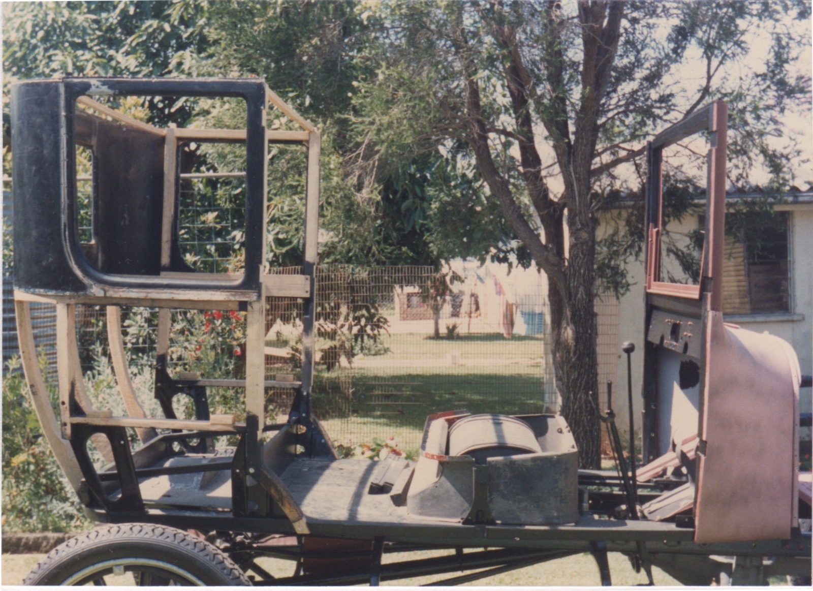

Got this picture in the mail today from my friend Dan Killicut Syracuse Ny. Looks to be a early '16 !! Opinions ??

Looks like a '16 to me! Not only that, in this picture, you can see what type of bracket holds the sidelamps, and how it angles down from up high.

Wayne, I think this picture is an exact match of a early '16. My '16 has the exact windshield setup. I'm not sure but those rear fenders don't look flat to me? The flat '15's have a different look to them...

Don,

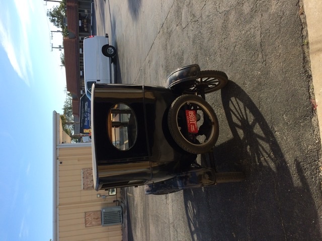

Please excuse me if it's of no use to you but here's a couple of similar views from a local car that appeared yesterday.
Year is prob your 1919 equivalent so may not be the same (I've no idea of any differences!), but if you want any other views please let me know and I'll see what I can do.
Hi Luke, the dilemma I am having with the rear window is this. The "D" pillar has to be wide enough for the window. The metal skin around the tub and the oval rear window will only come together with a certain amount of tilt. The belt line trim has to follow the rear window skin. So, when its all fitted I get the similar if not exact shape as the 1915 rear widow trim. Its wider at the belt line and tapers off as it reaches the top of the rear side window. The picture of Hap Tuckers 1915 is what I have with this early '16. I am open to suggestions or corrections but this is what I have found.

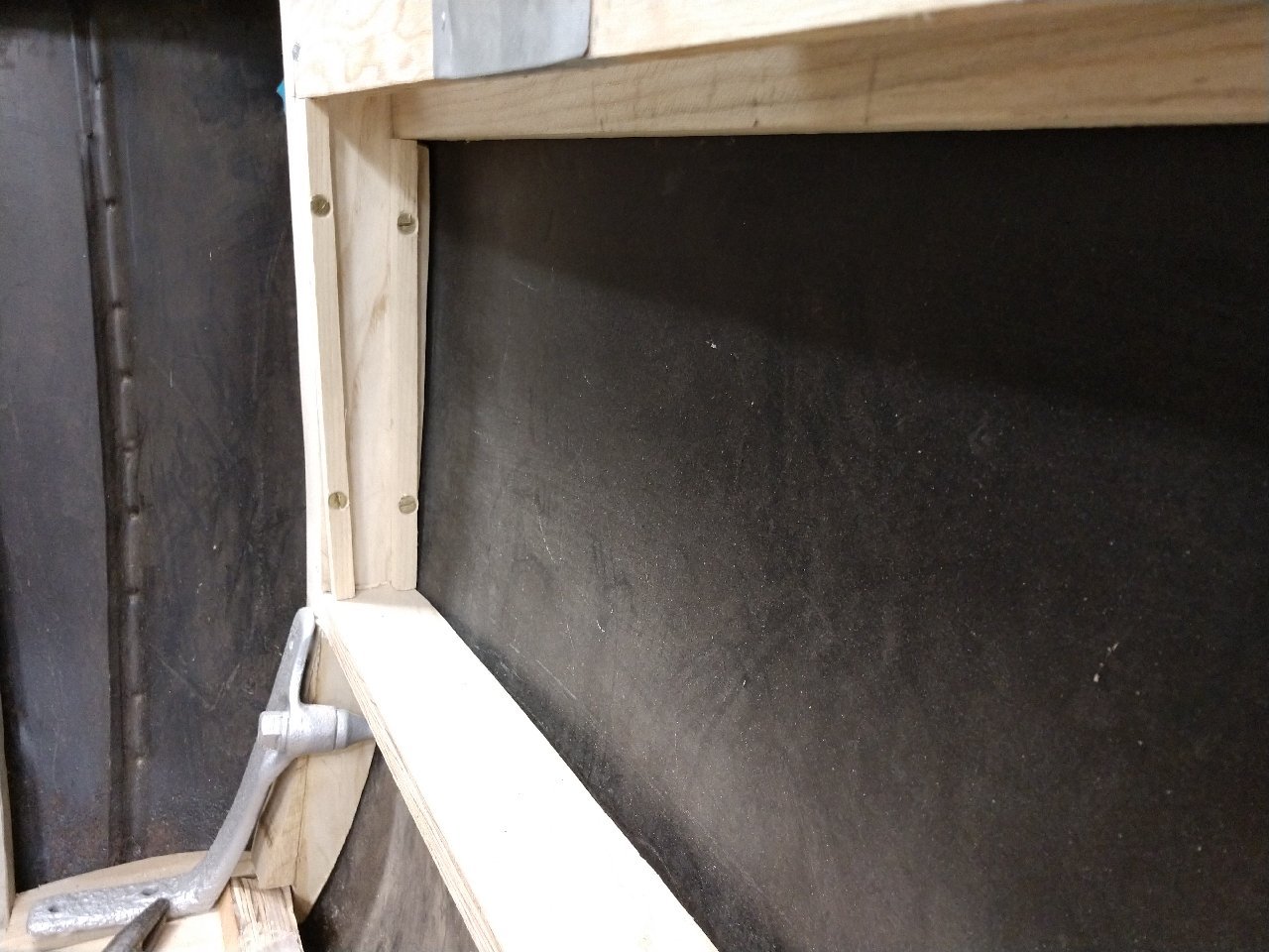

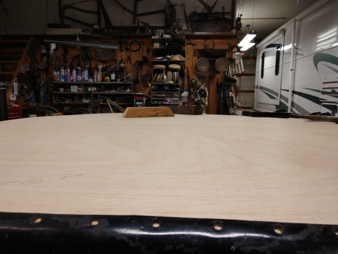

Just finished nailing the steel to the framing. So far, so good on the fitment. I'm doing the fitting from the bottom up. Without patterns this just seemed to make the most sense. So the doors are set and I can get to work on the top next. I will save the body work for down the road.
FordorGalore
- First Name: fore
- Last Name: door
- Posts: 4408
Amazing how fast you are, and with doing such a daunting puzzle!
What can I say? But again it is looking SO-O nice!

She is looking FANTASTIC! You're doing a great job.
I have a couple questions: The white smears at some joints, is that the 3M 5200 adhesive? and Second: The window lift belt retainers/clips you have installed, are they new or did you have them from the old body? If they are new, where did you get them? I do not have any of them and will need them when I try to replicate your rebuild perfection.
Thank You for sharing and answering questions.
Good Luck,
Terry
Good Luck,
Terry

Thank you guys I appreciate the kind words !! MtnTee20 those are all original except one. I had to make it from scratch but it wasn't a big deal. They all look new because I painted them with Rustbullet Automotive Gray.
FordorGalore
- First Name: fore
- Last Name: door
Terry, yes the white smears is 5200. I used it on all the wood joints, a little dab will do ya. Someday long after I'm gone someone will cuss the fact they have to deal with it, but oh well.

The top wood is going pretty good so far. I made some headliner staple guides out of 1/8" RV scrap paneling. This really makes it easy to install the headliner and get a nice clean straight line.

I like the idea of the headliner edging. This project is moving right along.

Billdizer, prepare to be amazed. The genius in Don's work is not in his tooling, it's between his ears, just behind his forehead. He's the world's shortest giant!

I was pleased to see slot headed screws in the above photo. That is attention to detail. Quite often these days you will see Phillips head screws even in places that show! The above screws won't even be seen until someday another caretaker might need to do work there.

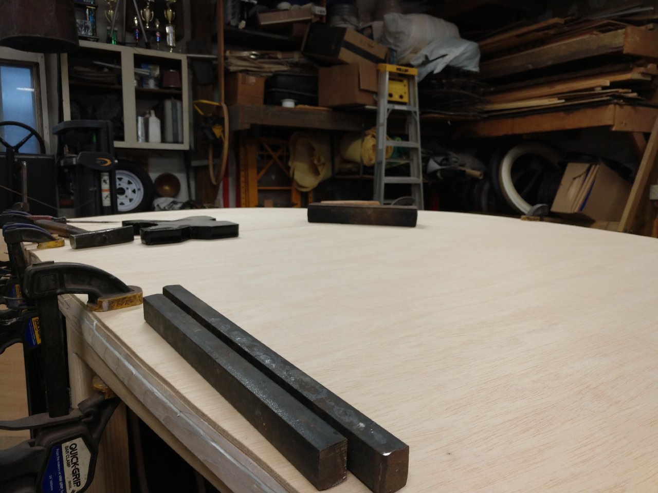

Thanks Ed, but my head is swollen now.... So, today I decided to begin the top skin. I'm not sure if I have enough curve in the top. What do you think?

Bob McD, I may not be the best expert on these, but I did do quite a bit of research on the earlier center-door sedans about 25 years ago. As I understand it, basically, no restored c-door today has a roof built as they were in the '10s. The body suppliers (there were two or three of them for the c-door) used a formed roof piece made out of something similar to Masonite. It was similar to what some body suppliers sold to other automobile manufacturers in the early '10s, that became known as "the paper mache' " bodies. I believe that a couple models of Reo, and I have heard of one surviving Cartercar that used such bodies. Survivors of such cars are quite rare, because they simply didn't hold up well in the weather regardless of where they were. The same issue affected the center-door sedans. Most of them, the roof began to go bad after only a few years, while the car was still new enough that many owners had a local top shop (nearly every town over a few hundred people had one) repair the car's roof. Usually that repair involved replacing the formed paperboard with some other conventional replacement, including standard top material (either grained or smooth). Many times the top shop or past owner added rain gutters, sometimes not.
The Ford center-door top piece had the rain gutter formed as a part of the roof. And the roof was smooth and quite shiny! While good era photographs actually looking down onto the roof of a c-door are rare, I have seen a couple of them over the years. I heard of one car surviving in Califunny about fifteen years ago, but I never saw it, or any other myself. In a past discussion on this forum, I think two people chimed in that (at that time) owned a c-door with the original roof. So I guess there are a few of them around yet.
Restorers usually just redo the top as repaired by some top shop or past owner. When I restored my '16, that was what I did. Mine was a nicely intact body, with a still nice paint job from a '50s "restoration", so redoing the top was easy. Don B has a much tougher row to hoe, cannot replace the top exactly like original, and no real "right" way to do it.

I do wish I had more detailed information on this. But nothing seems to be out there. Here is a picture of the C-door tops and I am using it for what its worth.

Don, the photo of the centre doors in the factory production line is interesting. The tops on those bodies look much more curved, both from the front to back, and more noticeably from side to side. Those tops have quite a considerable compound curve. Perhaps the original cardboard/masonite material could be massaged to conform to that shape, but I cannot see a sheet of plywood doing the same. The curve front to back may be easily achieved, but the side to side curve not so. If you clamp it down that will add to the load on the rather spindly cross pieces, making them loose the curve cut into them.
But in the scheme of things, it probably is not important to the function of the top. Some fullness can be added by including a padding material under whatever top material you use. Over the timber slat tops I make on wooden bodies, I use 1/4" dacron sheeting from a quilting supplies shop. It is thin enough not to make the top look padded, but does make the slats disappear on the finished top.
I am in awe of your work on the framing. I had a complete set of original patterns when I did my wide body roadster, and that was hard enough. Your project is many orders of magnitude more challenging and difficult than mine. Well done.

Allen, take a good look at the left row and the third and fifth tops. They look flatter to me. If you really look at the line there are differences or at least "appear" to be differences. It could be just the camera effect, I don't know...

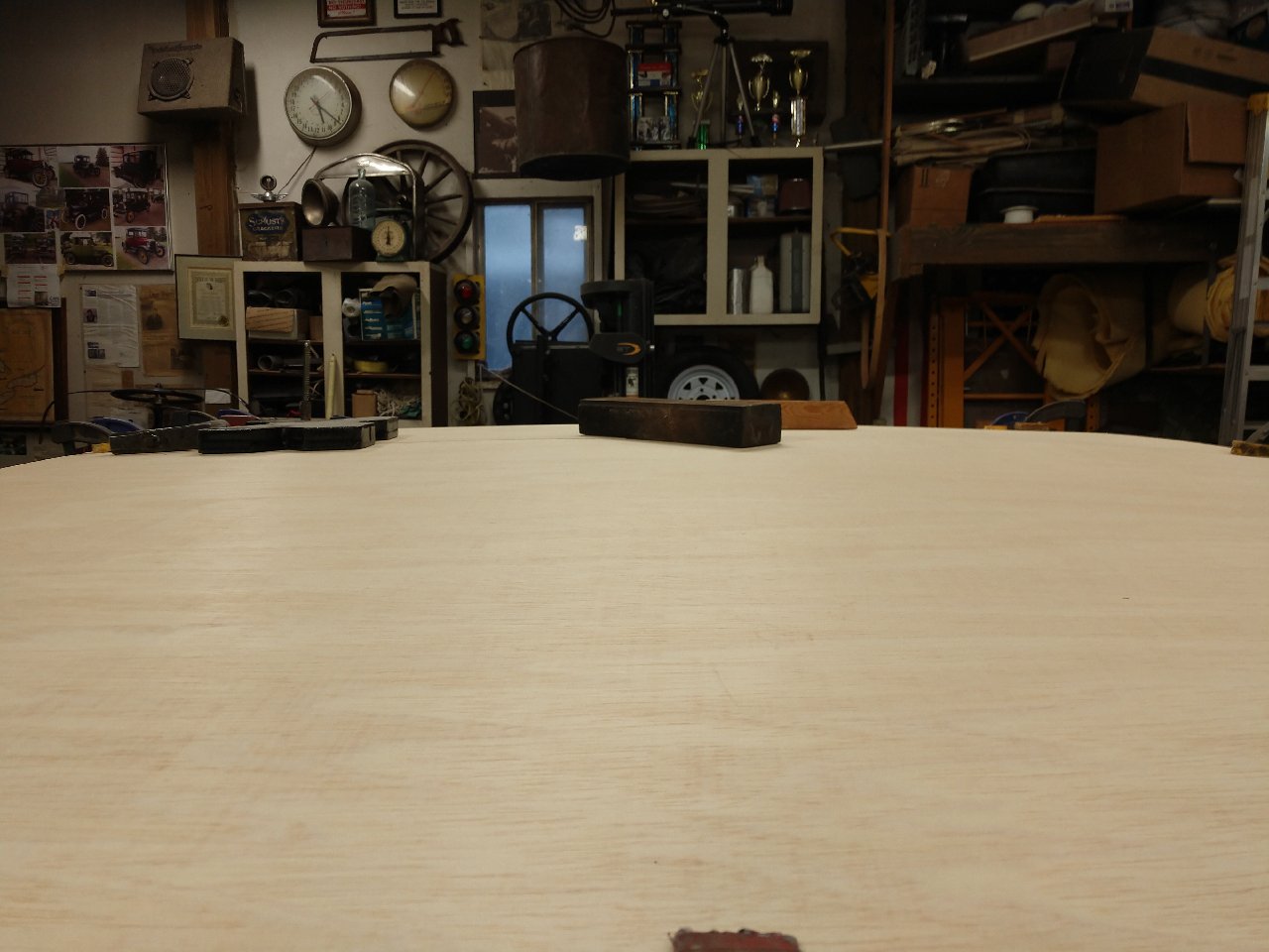

Don, This is my 1920 sedan roof. I used Masonite to cover the bows. It took the compound curves nicely. It is sealed with West Systems epoxy and sanded ready for primer and gloss black paint. No padding or covering as original. Les
FordorGalore
- First Name: fore
- Last Name: door
Les, i'm doing basically the same thing. Just that i'm using 1/4" marine plywood. It takes the bows nicely without any downward pressure but I do cut it oversize and let it find its own path. Then the fiberglass matting and WEST and she should last another 100yrs.

I knew about the Masonite but thought it was just used as a support for the top material. Interesting!

Ok, so the rear seat riser was a puzzle. The huge gap at the end of the riser kick panel needed something. I looked at Hap's '15 and noticed what appeared to be end caps to fill the gap and hide the deep fender well. I had the original riser kick panel for a pattern but, do you think I'm close with this? Is there something I'm missing here? The original riser kick panel was 3" short on both ends of covering the steel wheel well...

Wow. Regarding the before photos at the beginning of this thread... The former owner must have majored in “Woodworking with a Hatchet, 101”. Definitely should have invested in a table saw, chopsaw and jigsaw and a how-to book on how to use them.
At least he tried to keep it as original as he was capable of doing and didn’t chop it into a hot rod. For that, I am grateful to him. Now it is in very capable hands. Jim Patrick

Thank you Kathy and Jim, my friend from down under Warwick Landy may have the best explanation. He suggested that this seat riser may have been sized for the earlier rear gas tank. It may be a conversion from the rear tank to the seat tank. It makes sense to me but I need input from others if this car is going to have any historical accuracy to it. Please help me get this right~
- Posts: 4408
I have said before, but do not mind saying again. That my "supposedly" real early '16 center-door sedan and a good friend's "supposedly" real early '16 Canadian center-door sedan were the only two center-door sedans I looked at (and I looked at about twenty of all years!) with a rear seat riser like ours had. His Canadian sedan still had its original under-the-rear-seat gasoline tank still installed from the Canadian factory! (A previous owner had installed a front seat and tank from a later center-door sedan because of the fuel flow issues in that rear seat tank.) The hypothesis at the time was that his of course did have the gasoline tank under the rear seat originally, and my car's body was early enough that it followed the pattern of the real '15s and the rear seat was set up to carry the gasoline tank before the change to the front seat made that unnecessary.
Unfortunately, I do not have any photos of the rear seat, or drawings of how the riser was different from anything that followed. So I cannot help out much on getting this detail right. I simply do not remember enough of the detail either. I was quite displeased with the two owners that followed, and mostly put the car out of my mind after I sold it.
All in all? I would say you are on the right track!

The one minor detail I do remember, different from how you did yours? The upright lip that keeps the seat cushion from sliding forward on mine was a simple piece of strap steel.

Yes Wayne, those bookends are coming out. I just got off the phone with Mike Husted and he found a picture of a 1916 that clearly shows carpet covering the gap. Oh well, not a big deal to make it right and that's why I rely on the good folks that know. Here is the picture Mike found. What a wonderful friend to have, I can't say enough about that guy.
