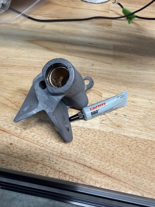

Just got some pars in from Lang's. The first thing I'm going to tackle is the steering shaft bushing. I think I also may need a new Pitman arm and Key. It seems to be loose but I'll be able to check it better when I get it out. When I move the steering wheel very slightly I can see the shaft moving but not the pitman arm until the steering wheel moves a lot more.
The other thing I want to do is check the real axel. I used a borescope and I think I can see a bronze thrust washer on one side. I also received a lot of broken rear end parts and some Old style thrust washers that leads me to believe that they changed the washers out. I still want to take it apart and confirm everything was done right.
I'm not sure what these small disks are in the bag with the outside grease seals.
I also got these.
It says these are shims? This is the rest of the gasket kit.
I also got these.

The small metal plugs are for the late rux shifter shaft.
The red are the center axle thrust fiber washers.
Yes, Shims. They are for spacing the DS out a bit if needed for a little extra gear clearance.

Thanks John! I get it now. I knew about the fiber disks but I didn't know the Drive Shaft had that fine of an adjustment. I have a stock rear so I guess I won't need the small disks. Once I pull it apart I'll see what else I need.speedytinc wrote: ↑Mon Jan 12, 2026 8:06 pmThe small metal plugs are for the late rux shifter shaft.

The small metal plugs are used on the rear axle housing where the aluminum cap goes. There is a small hole that allows the sleeve dimple to seat into. They go into those holes, one on each side. When installed they will make a good surface for the aluminum cap (O-ring) to seal against.

Thanks so much Don. For the parts as well. I've got the rear axel book as well as the video.Tparts wrote: ↑Mon Jan 12, 2026 10:02 pmThe small metal plugs are used on the rear axle housing where the aluminum cap goes. There is a small hole that allows the sleeve dimple to seat into. They go into those holes, one on each side. When installed they will make a good surface for the aluminum cap (O-ring) to seal against.

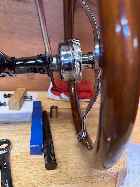

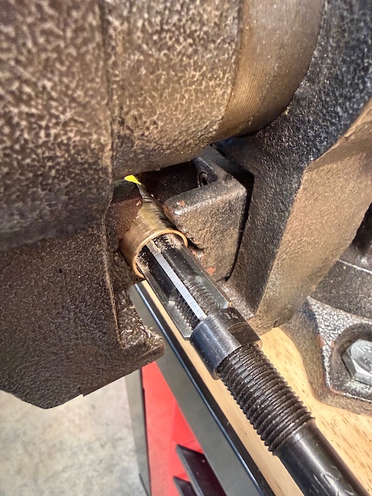

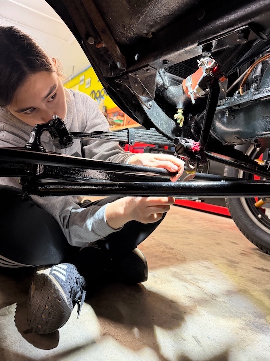

Well we started to get the steering column out.
Mopar_man
Topic author - Posts: 1195
- First Name: Robert
- Last Name: Govoni
Re: Getting Rattles Back On The Road

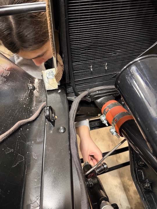

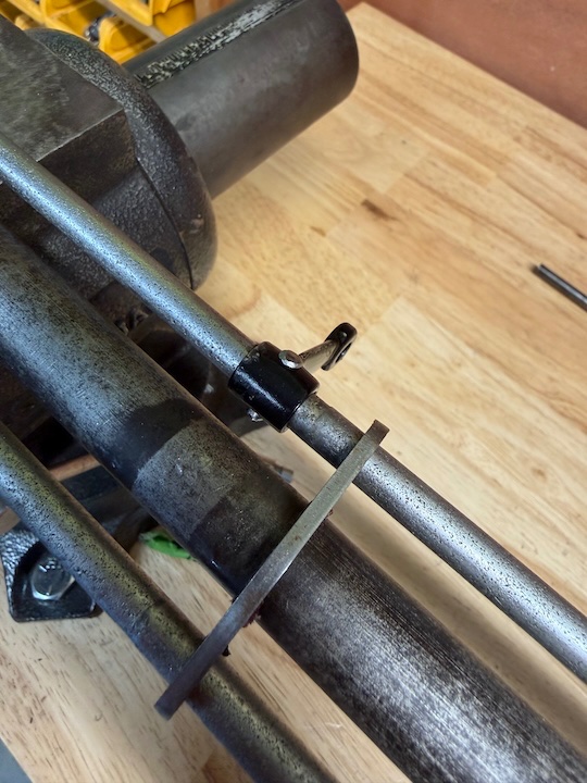

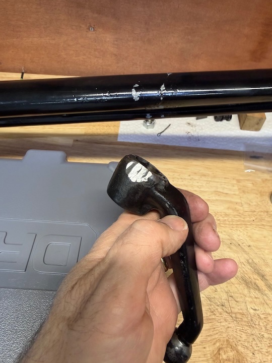

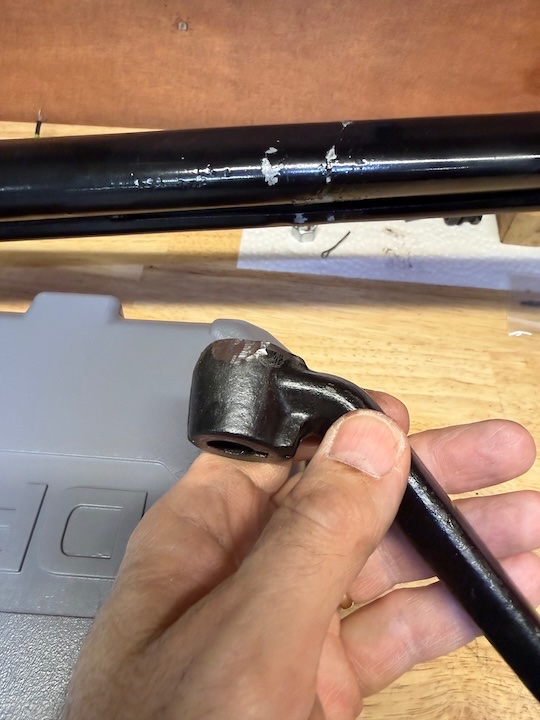

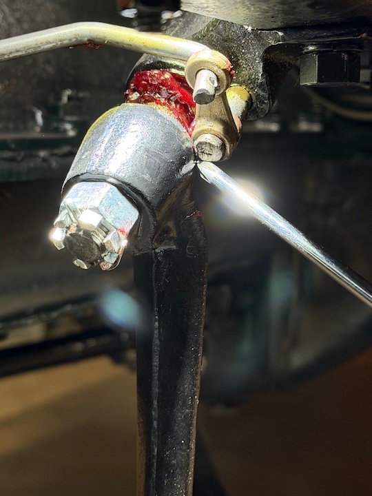

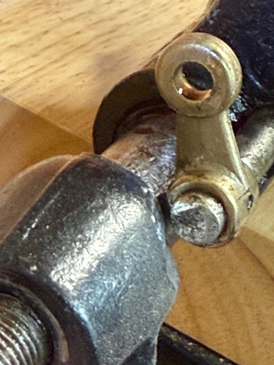

Looking more at the steering and in trying to get the slop out of every joint we found one of the adjustable cap on the drag link could be tightened.
I also discovered some movement where the pitman arm connects to the steering shaft. The solution for this is to tighten the nut. I admit when I put it on I didn't really crank on the nut. Come to find out the pitman arm is all the way up on the shaft and hitting the lever for the timing rod. I've heard of some people grinding the top of the arm so it can be tightened higher on the steering shaft. Is this an option? I sure would like to keep my original shaft.
I'm pointing to it with the screwdriver. You can see where it is rubbing.
- Posts: 8688
Can you space the spark lever up toward the steering wheel?
- Posts: 5295
A little clearance grinding wont hurt a thing.
I have not run into your problem. Is this a new repop pitman arm?
Is the spark rod a repop?
Looks like there is lots of room to shorten the rod, move the lever up & redrill for the pin.
Mopar_man
- Last Name: Govoni
It's a repo spark rod and lever but everything else is original.speedytinc wrote: ↑Sat Jan 17, 2026 7:26 pmA little clearance grinding wont hurt a thing.
- Posts: 5295
Well, there you go.Mopar_man wrote: ↑Sat Jan 17, 2026 8:02 pmIt's a repo spark rod and lever but everything else is original.speedytinc wrote: ↑Sat Jan 17, 2026 7:26 pmA little clearance grinding wont hurt a thing.

We got the steering column out today.
Here is a video of my issue. Thank you to all the suggestions that I've got so far. I'm still leaning toward grinding part of the pitman arm to clear the spark lever and rod. Check out the video
https://youtu.be/ePeYVbzhZwA

Looking at your pictures in a previous post, I think your clearance problem is that you have your steering column installed wrong. I have run into that problem myself a couple of times. You have it mounted on the inside of the cowl. It should be on the outside. Here are a couple of pictures, one that has never been removed and the one in my coupe. I have also found reproduction pitman arms that I had to grind clearance on. Also, have heard of guys shortening the shaft to repair the taper and key slot.

That may be tru. Thanks. The clearance I need is at the bottom where the pitman arm attaches. I bet you're right about where it attaches to the firewall.Scott C. wrote: ↑Sun Jan 18, 2026 6:15 pmLooking at your pictures in a previous post, I think your clearance problem is that you have your steering column installed wrong. I have run into that problem myself a couple of times. You have it mounted on the inside of the cowl. It should be on the outside. Here are a couple of pictures, one that has never been removed and the one in my coupe. I have also found reproduction pitman arms that I had to grind clearance on. Also, have heard of guys shortening the shaft to repair the taper and key slot.

Take a rubber mallet to the spark/throttle quadrant and pound it toward the steering wheel should remedy the issue. Rotate the levelers back and forth while striking and lift toward steering wheel. Been there done that to many times!
- Posts: 8688
Wear on the quadrant notches and the "tooth" on the levers will allow the control rod to move closer to the pitman arm. Bending the quadrants slightly toward the steering wheel will move the rods back where they belong. You could also put a short length of rubber hose on the lever where it rides on the quadrant and glue it in place. That will move the rods back 1/8" or so and prevent them from moving on their own if the quadrants are worn smooth or the springs are weak, as most are.

Installing it correctly will compress the control rod springs letting the shaft set lower and give you more clearance. It has solved the problem for me twice. You might still need to do as Hank suggests also and raise the quadrant if it's not enough.
- Posts: 8688
Wear is one thing, incorrect assembly is another. Correcting the assembly will probably correct the problem. My quadrants are worn almost smooth, but the levers stay put anyway. I need to shim the wood filler at the lower steering shaft bearing, since the spark rod contacts the hood shelf.
- Posts: 5295
I am calling BS on the control rod springs. They are mounted on the columb. Makes NO difference/effect on which side of the firewall the column is mounted.
As far as mounting. You got me second guessing myself. So, I looked @ past posts & my own T.
The column mounts inside the FW, same as all the earlier T's. If mounted incorrectly (on the front) its obvious by the fit of the lower trim piece.
Its bent in such a way it fits correctly when the column is on the back side. I see that the trim piece doesnt fit correctly in the 2nd photo.
Hank posits a good idea if the quadrant is bent down. However bending the quadrant to fix another slightly incorrect repop part isnt the answer. The answer is to fix the repop part. A comparison with an original part equipped Late T might be useful.
If you think about it, moving the column wont effect the spark rod & pitman arm clearance. It would change the amount of steering shaft & retard rod distance from the steering shaft mounting bracket.
As far as the claim that a T is original with the column mounted to the front side, that would be hard to prove that the column wasnt removed sometime in the past 98 years & put back wrong, unless you have a true Rip Van Winkle 27 T. No disrespect intended.

Maybe I am wrong on the spring compression. However, I am not BSing anyone. If you move the mount downward from the inside to the outside and the mounting bracket at the bottom stays in the same location, the steering shaft will stick further out of the bracket.

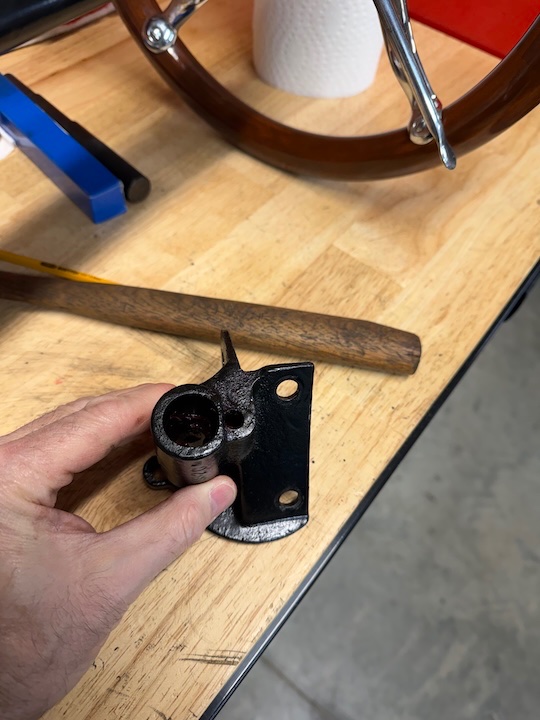

Thanks everyone. I'm going to take a look at the Quadrant and see if it's already bent down causing the rod to be lower. I think the issue with the bracket on the firewall will sort itself out. If I put it on the engine side it may make the pitman arm too far forward and not line up with the drag link. as far as I can tell the pitman arm is original. the spark lever is not.
- Posts: 5295
The steering shaft & the retard lever will still be hitting each other. No change where the interference problem lies.Scott C. wrote: ↑Sun Jan 18, 2026 9:04 pmMaybe I am wrong on the spring compression. However, I am not BSing anyone. If you move the mount downward from the inside to the outside and the mounting bracket at the bottom stays in the same location, the steering shaft will stick further out of the bracket.
Agreed.
- Posts: 8688
It's common for the quadrants and levers to be well-worn where they contact one another. That wear allows the the control rods and anything attached to them to move toward the pitman arm. My steering column jacket is bolted to the driver side of the firewall.

If you were actually successful in moving the pitman arm up the steering shaft that far (I'm not suggesting either, that you should or should not), would the castellated nut still align with the cotter pin.

Not sure just yet. I don't think I'll have to move it that much to get it tight.
Mopar_man
- Last Name: Govoni

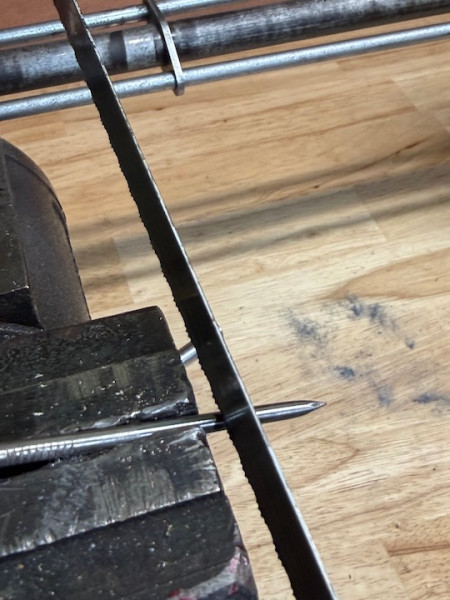

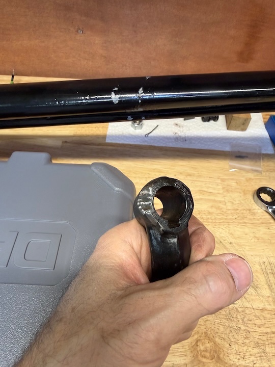

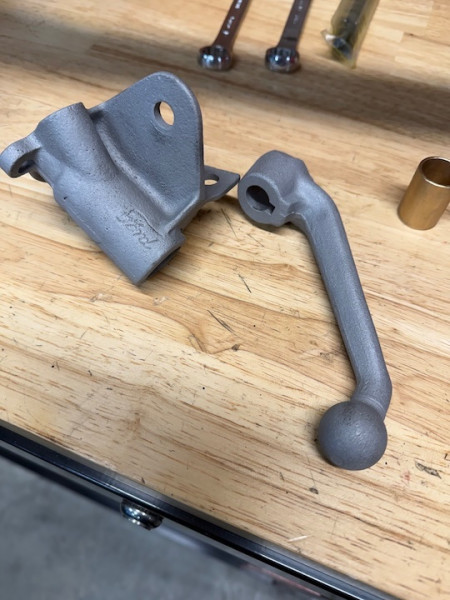

Well I took a look at all the recommendations and decided to look at my quadrant first. It looks like I could bend it a bit and I may still do that.
The pitman arm I have must be a reproduction because FORD is not written on it anywhere. so I decided to grind it a bit as well.
That seems to give me some room.
It may look like I took a lot off the arm but I think the pictures look like more than it is. Next up is going to be the rivets for the spark and gas levers. I need to get them a lot tighter.
Scott C.
- Posts: 864
- Last Name: Clements
- Location: Waynetown Indiana
Make sure that you ground off enough to clear at full rotation in both directions of both arms.

Robert
The quadrant arc at the top of the column, on the notch surfaces, is supposed to be a flat plane perpendicular in all directions from the steering shaft.
This helps keep the controls from wandering up or down while driving.
Maybe it's the picture, but it looks like the timing side notched surface is a ramp.
It can take several times to get it all correct.
Being assembled and pretty makes getting it right a lot tougher.
Mike
Mike

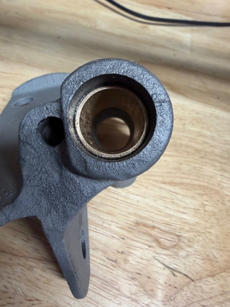

Well I got the bracket off tonight and look no bushing. I should have caught that when I took it apart the last time.
I think my bracket is worn out take a look at the video and you'll see that the bushing slides in way too easy. My brother said I may be able to use JB Weld and get it to stick in the bracket. What do you all say?
https://www.youtube.com/shorts/GBdh5dSrs5c
I'm going to also replace the rivets that hold the Spark and Gas levers with a thicker one made from a nail.
https://www.youtube.com/shorts/P06x-_YAJLc

Use some bearing retainer to lock the bushings in place if they are loose
https://www.napaonline.com/en/p/NCB37424
or equivalent
Just make sure you are installing it in the bottom of the bracket when you install it.
And yes make sure the control levers do not wiggle on the shafts.
You could also braze the holes shut and redrill them the correct size.
If you do that you can move the hole up to get better alignment also.
Ultimately we have to fix OEM part issues, 100 years of "experience" plus all the "mistakes" made on reproduction parts to make things right.
Model T's are not Plug -n- Play items.
Mike

Mike when you say the bottom of the bracket........ in the video I have it in the correct end right? The hole is way too small on the other side and would also block the hole where the grease goes in from the grease cup. Does the loctite fill in the gap?Mike Silbert wrote: ↑Tue Feb 03, 2026 10:05 pmUse some bearing retainer to lock the bushings in place if they are loose

- Posts: 4502
You can buy a bushing with a larger outside diameter, then cut it down to size it for a proper press fit with the bracket. It will take some machining and accurate measurements to get it right.

I watched your video several times and was still almost sure you were installing it on the correct end.
It was moving around and your hands were blocking features so I was not 100 sure it was the correct end.
Or maybe I was slower because it was getting tired.
Either way as long as you are installing it in the bottom you are fine.
It is only meant to go between the bushing in the housing.
Mike

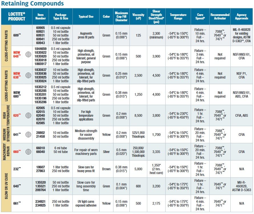

Mike, Thanks! I just ordered some Loctite 660. I'm going to give it a try. I bet it will hold. It's not like the shaft is spinning although going over bumps while turning may make it loose. Anything will be an improvement over no bushing at all.
- Posts: 6828
You've already ordered the 660, but you might wish to peruse this PDF where you can easily compare side by side the viscosity and application(s) for each retaining compound.
660 is a thixotropic paste and I'm going to guess that from your video you don't have the wear that is necessary for this stuff to flow into. 680 will fill up to .015" gap and has a little "body" to it such that it will generally stay put but will also still wick into smaller spaces.
Make SURE your bushing is a solid bronze or brass bushing and is not a sintered bronze matrix. Those are infused with oil and do not like pounding like it will see on the road and the oil will compromise the bond some.
https://www.mecampbell.com/media/pdf/lo ... Pyu4Ntbde3
Mike Silbert
- Posts: 376
- Joined: Sat Feb 08, 2020 11:30 pm
- First Name: Mike
- Last Name: Silbert
- Location: Sykesville Md
Scott is correct.
660 is for gaps greater than 0.020" and badly worn parts.
For such a large gap it is thick and would act like PC7 or JBWeld.
I don't know what your gap is but 0.020" is 7 pieces of paper or 24 gauge sheet metal (think modern car thickness) .
I suspect your gap is not that large.
At work we used to have a row of different Loctite bottles for different tasks and jobs.
Plus a row of 3M products.
There is a reason that they make so many different products.
I think (guess) that the 640 for sliding fits might be a better choice but I can not be sure.
Measure your parts to check to see what is correct, then locate the correct one.
Fun with chemistry...

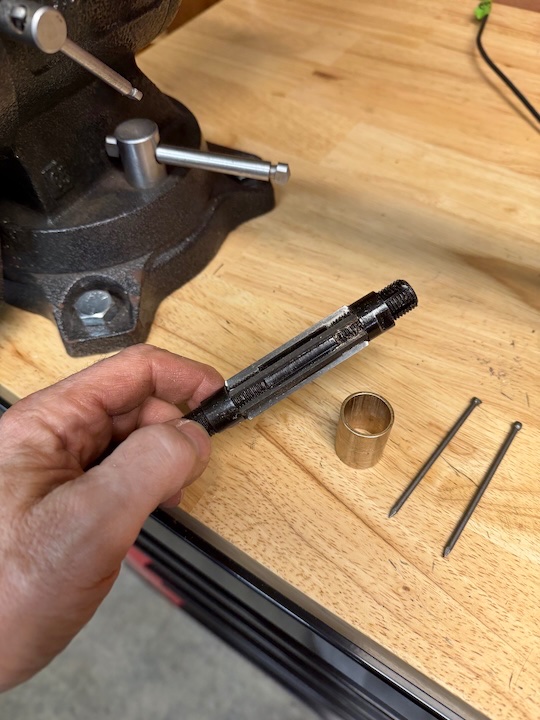

Got some work done today.
Cleaned up the pitman arm and steering bracket.
got the bushing reamed to fit. I wanted to do this out of the bracket so when I use the Loctite 660 to hold it in place I'm not putting a lot of force on it.
The steering shaft, like most, is slightly worn so I reamed the bushing to fit and it will have a little play once it's in. This will be a lot better than no bushing like before. Ha!! Here is a video I made showing what I did. Next will be the pins that hold in the spark and gas levers.
https://youtube.com/shorts/0yc7TUqiLNQ
- Posts: 8688
Reaming the bushing in a vise may give you an egg-shaped bushing. If the shaft is worn, it may not be an issue, if you can keep the bushing in the bracket. Another possible fix would be to make a Delrin bushing. You could probably get a good fit that way.

I checked it. The bushing is still round. I had a light grip in the vice. I'm going to see if the bushing stays in place with the Loctite. If it doesn't work I'll end up getting another bracket. Thanks for the idea of the Delrin bushing.

If you are going to do some lathe work, buy the bushing that is 1" on the outside
Turn the oversized bushing to fit the box
1909-1925 Steering bushing is 1"x3/4"x1 1/4"
1926-1927 Steering Bushing is 7/8"x3/4"x1 1/4"
But this only works if you have a lathe with the required tooling and know how to use it.
It can be a lot of work for a few thousandths of an inch.
We all have different machines, tools, experience, skills, and styles of builds and repairs.
The trick is finding the method that best matches the job to the available resources and owner/repair(man or women).
Getting a good quality, long lasting repair is really all that matters.
Mike

Well the Loctite came in and I got the bushing seated.
I was able to drive it in with my bushing driver the last 1/8 of an inch.
- Posts: 7316
Should the bushing go that deep into the bracket? If so, you may get a better fit on non worn section of the shaft closer to the pitman arm by fitting the bush flush with the end of the bracket. Either that or using a longer bush.
Mopar_man
- Last Name: Govoni
I'm thinking no. Shouldn't be that deep. The bracket is worn from not having a bushing in it. I tapped it down with a bushing driver. The bushing is now on the internal lip in the bracket. I reamed it to fit the non worn part of the shaft. I'm going to give this a go and see how it works. If it causes an issue I'll end up getting a replacement bracket.

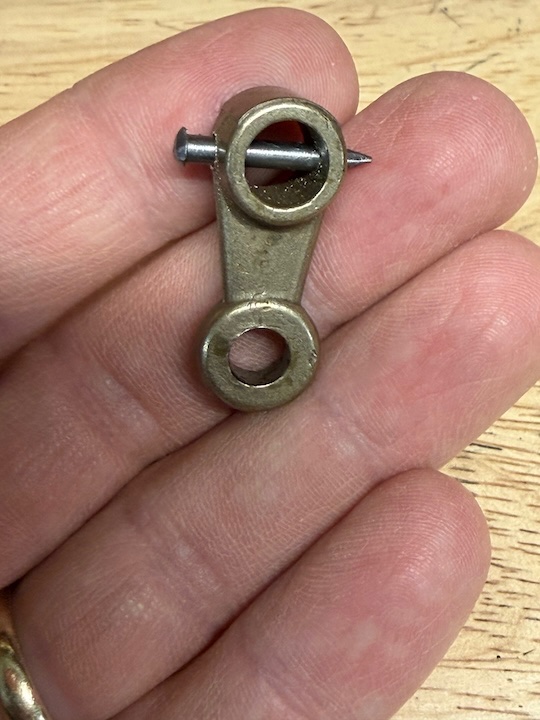

- Last Name: Govoni

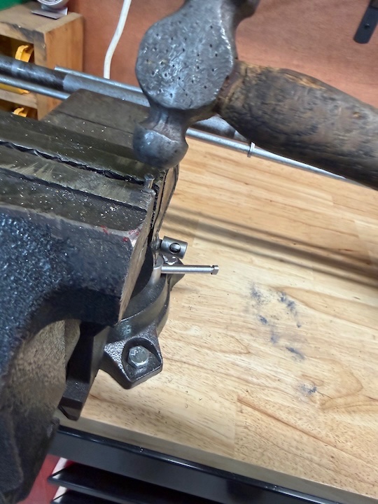

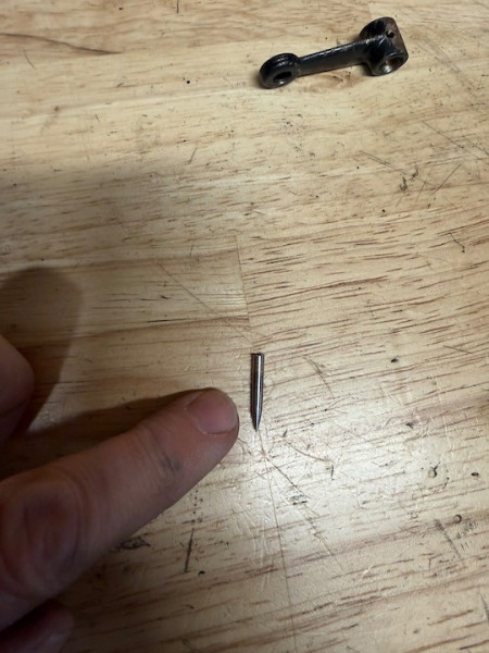

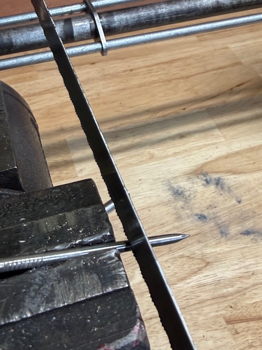

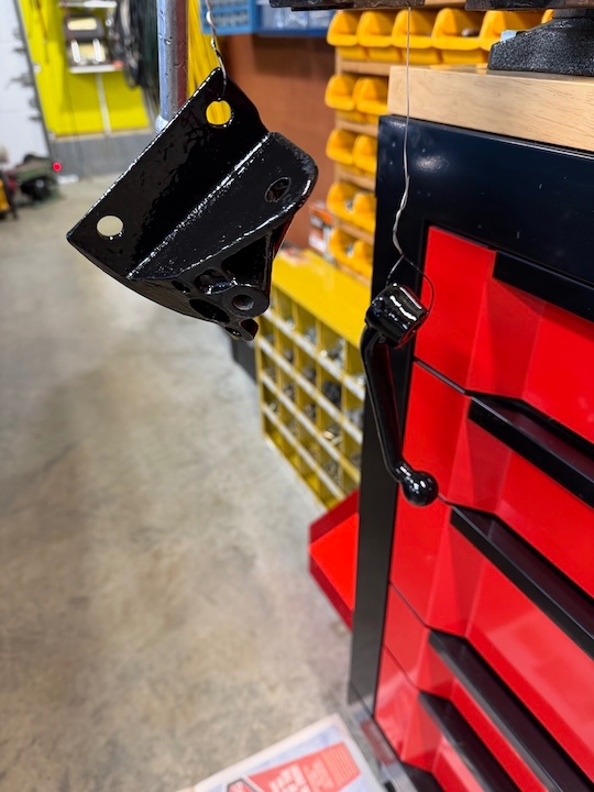

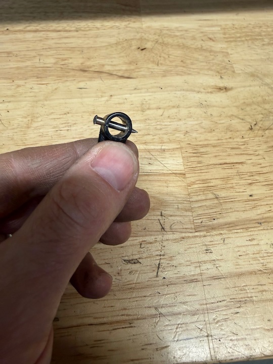

Got some parts painted.
Then I sanded down a nail to fit the worn out holes and made a rivet.

See how things work out. I would consider putting in an additional bushing to fill that last bit. Shortened as needed.Mopar_man wrote: ↑Wed Feb 11, 2026 11:22 pmI'm thinking no. Shouldn't be that deep. The bracket is worn from not having a bushing in it. I tapped it down with a bushing driver. The bushing is now on the internal lip in the bracket. I reamed it to fit the non worn part of the shaft. I'm going to give this a go and see how it works. If it causes an issue I'll end up getting a replacement bracket.
Mopar_man
- Last Name: Govoni
That may be a good idea. Thanks!!!!Jerry VanOoteghem wrote: ↑Wed Feb 18, 2026 10:54 amSee how things work out. I would consider putting in an additional bushing to fill that last bit. Shortened as needed.Mopar_man wrote: ↑Wed Feb 11, 2026 11:22 pmI'm thinking no. Shouldn't be that deep. The bracket is worn from not having a bushing in it. I tapped it down with a bushing driver. The bushing is now on the internal lip in the bracket. I reamed it to fit the non worn part of the shaft. I'm going to give this a go and see how it works. If it causes an issue I'll end up getting a replacement bracket.

Made another custom rivet. I know it's a small task but it was fun after spending the day at the office.
Mopar_man
- Last Name: Govoni
We got it together!
The rivet I made worked well. Both levers are nice and tight.
Angie greased up the steering bracket.
Then she fitted it to the steering shaft.
The whole column is now in and much better. I may have to put a thicker block of wood on the side of the shaft because it flexes a bit there. I also found that one of my spindle arms was loose so I tightened it and then checked every joint.
