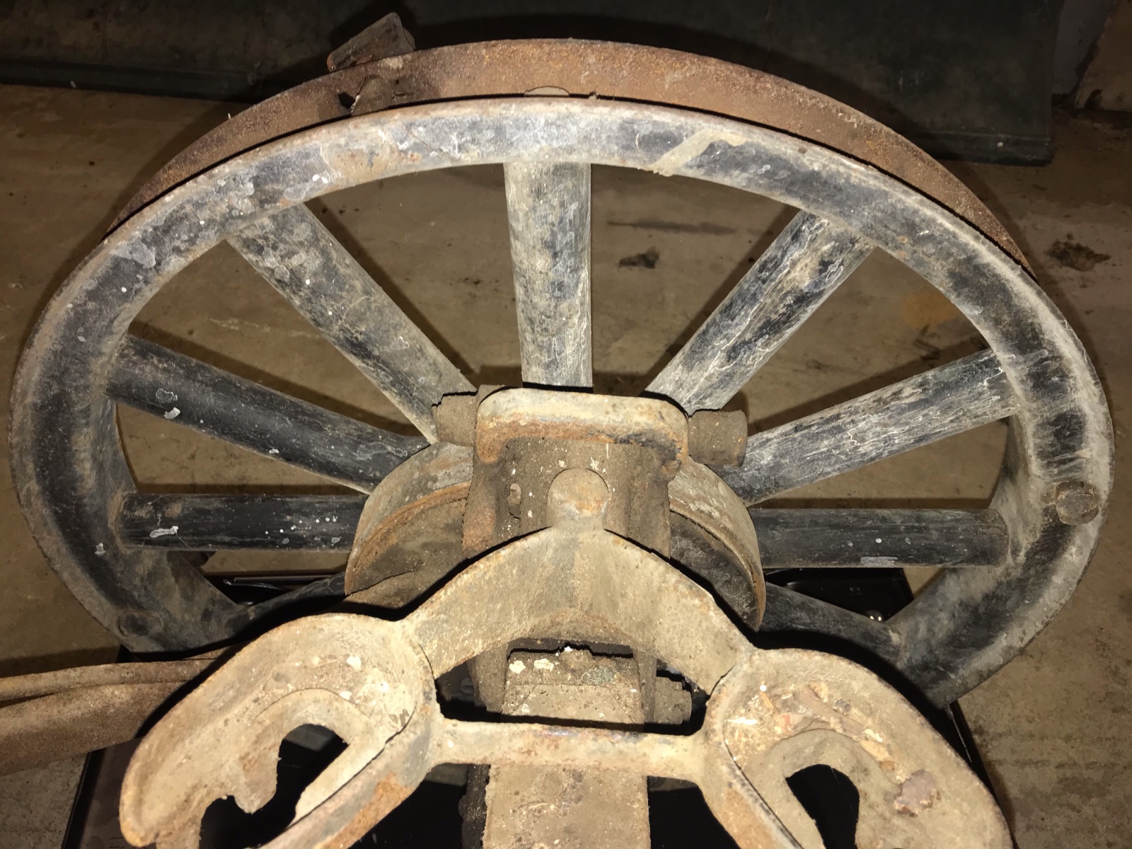

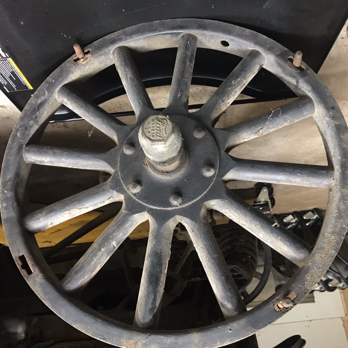

Did any of the Ford 21 inch wood wheels come with loose lugs looks like maybe early Chevrolet, But?
Topic author - Posts: 5510
Did any 21 inch Ford wood wheel have loose lugs type rims? I know some 30 inch and the rear TT did. I am trying to help someone that has 21 inch wood wheels that am thinking are Chevrolet transplants so want to be sure.
The wheels look like this one at least in the fellow area;
https://www.ebay.com/itm/1919-1920-1923 ... SwKphcN3ie
I have only seen photos of his rear wheel and it looks to have a Ford hub cap on it.

Re: Did any of the 21 inch wood wheels come with loose lugs looks like maybe early Chevrolet, But?

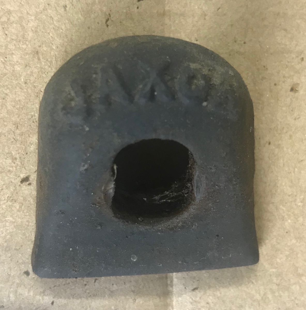

Yes. I know for sure Jackson made some. My uncles 26 touring has a set on it.
- Posts: 7182
Not on our Canadian production.
Jackson or Jaxon?

Re: Did any of the Ford 21 inch wood wheels come with loose lugs looks like maybe early Chevrolet, But?
I think both were used. Jackson was the company name and the lugs had Jaxon on them.

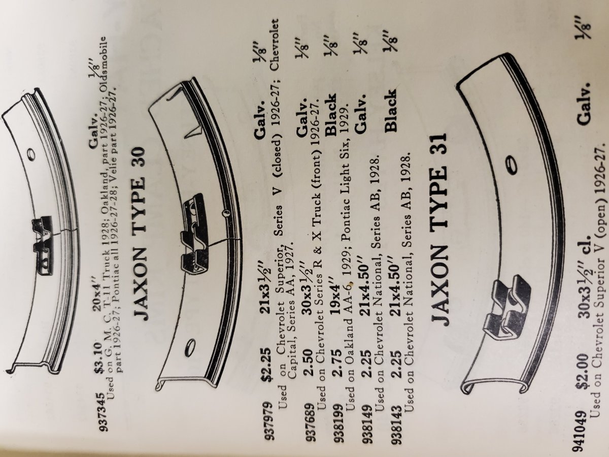

Jaxon supplied wheels to primarily GM and maybe some other car makers, but as far as I know, not Ford. The 3 makers of wheels in the book "Model T Ford, the car that changed the world" are listed for the 30" wheels, there are no makers listed for the 21". I did check the 1928 parts book to see if there was any information on 21" loose lug wheels, rims, there is none. The 21" would have been an option for 1925 up. From the information in that book, the 24 would have come with 30" wheels with no option for the 21" unless I missed it. If the DVD has more information, I do not have access to it. As I told Milford in his ad or email message, it would not be first to have the Chevrolet 21" wheels put on a Model T.

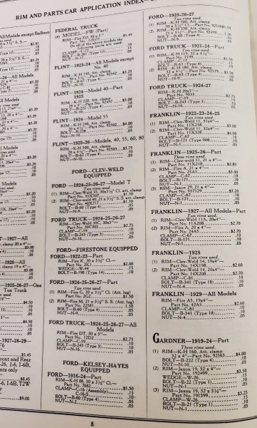

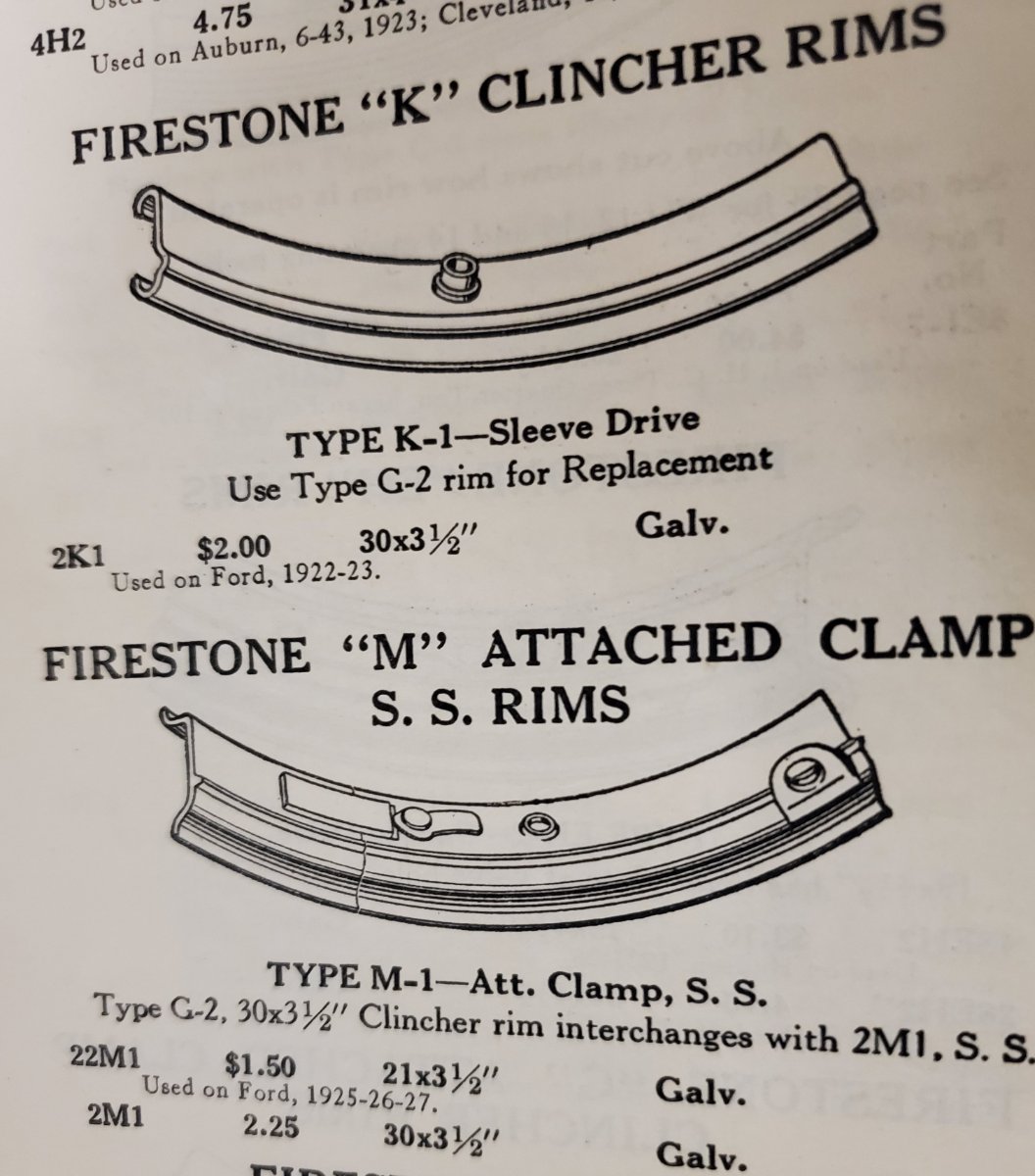

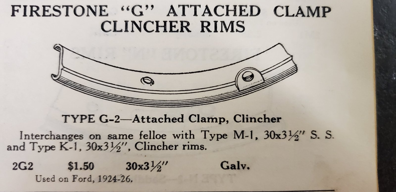

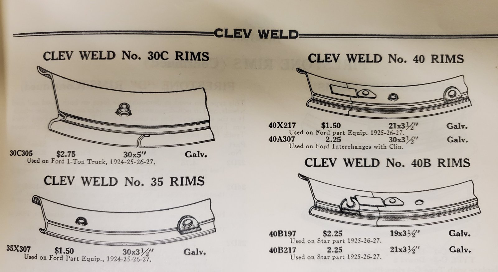

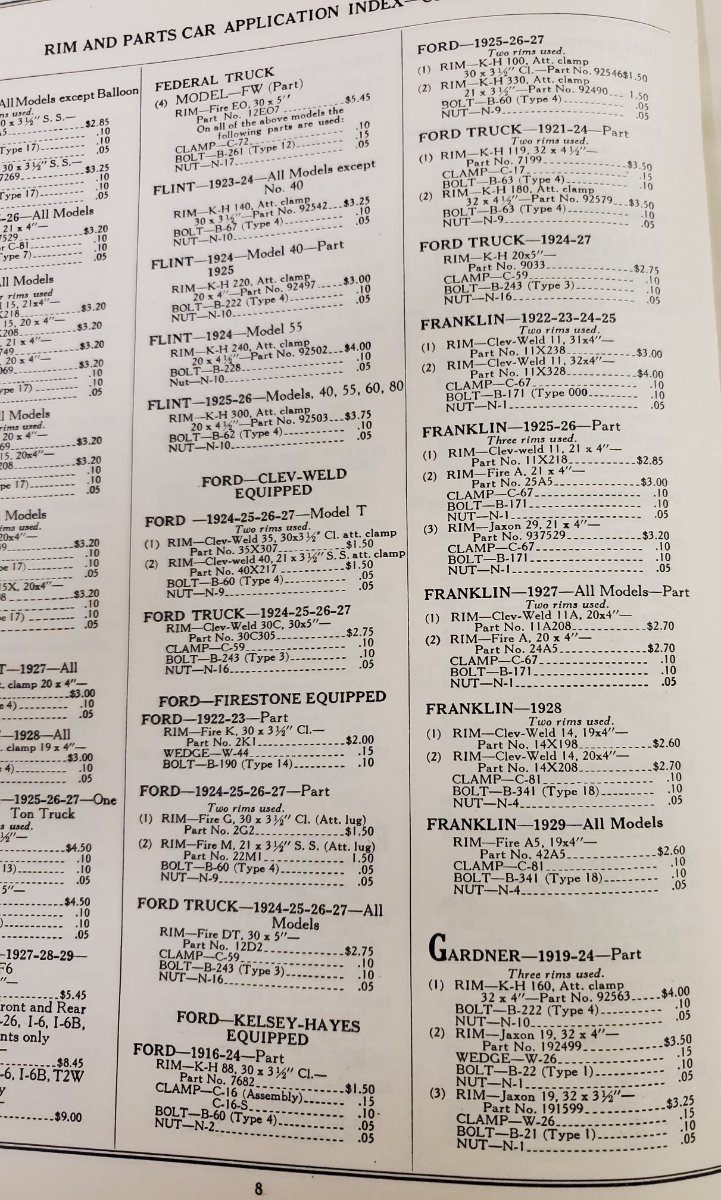

The other way to come at this question is from the part supplier end. Attached copies are from the 1929 "Official Catalog of Genuine Wheels, Rims and Parts" published by the National Wheel and Rim Association. Rim photos in the following posting.
Speedsterguy2
- Posts: 42
- Joined: Tue Jan 08, 2019 1:58 am
- Last Name: Knapp
- * REQUIRED* Type and Year of Model Ts owned: 1919 Speedster (project)
- Location: Wilsonville, Oregon

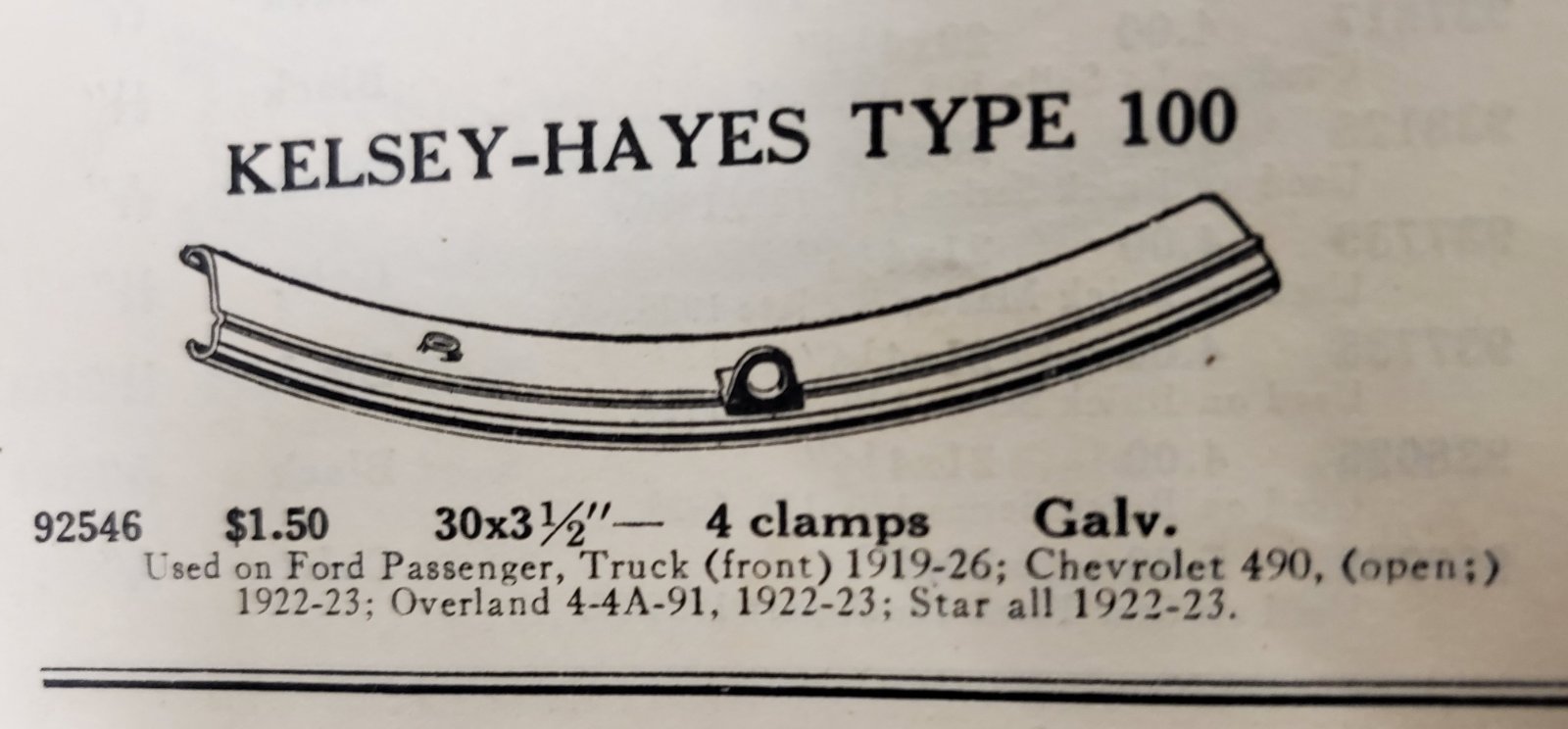

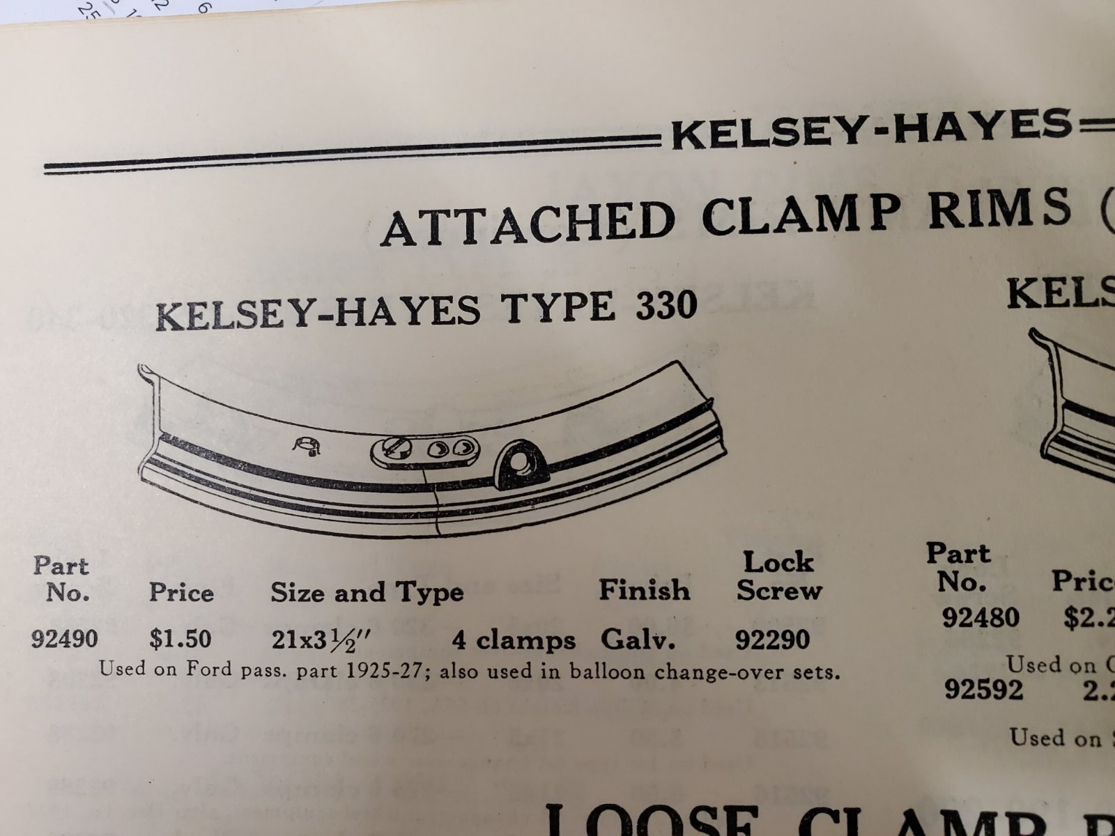

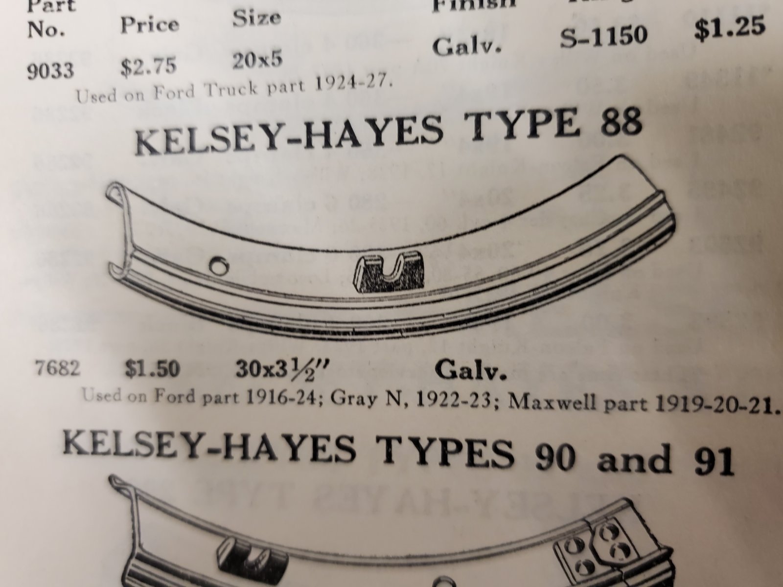

And here are the Cleve Weld, Firestone and Kelsey-Hayes rims:

Tim thank you for the information. What does it show for 21" Chevrolet wheels? Say 1919 to 1928. Part of this is trying to figure out what rims are needed for the wheels that are on Milford's coupe. I am fairly sure from what photos I have see, that they are Chevrolet wheels.
OK. The same catalog shows 33 different rims for 20 different Chevrolet models between 1919 and 1929. All were made by Jaxon or Kelsey-Hayes. However, there is only one loose lug rim in 21 x 4.5. That is a Jaxon Type 30 rim. (click on photo and it will turn right way up)
Big thanks again Tim. maybe by 26/27 Chevrolet was using the same #30 rims on both the wood wheel and disk wheel.

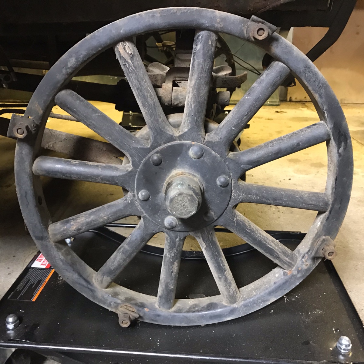

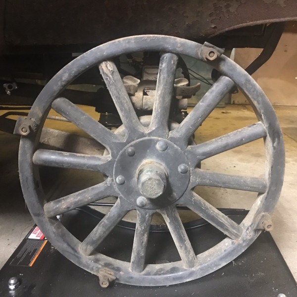

Mine look like the Type 30. Interesting that they are on a Ford. It has Model T hubcaps. Better pics coming soon.

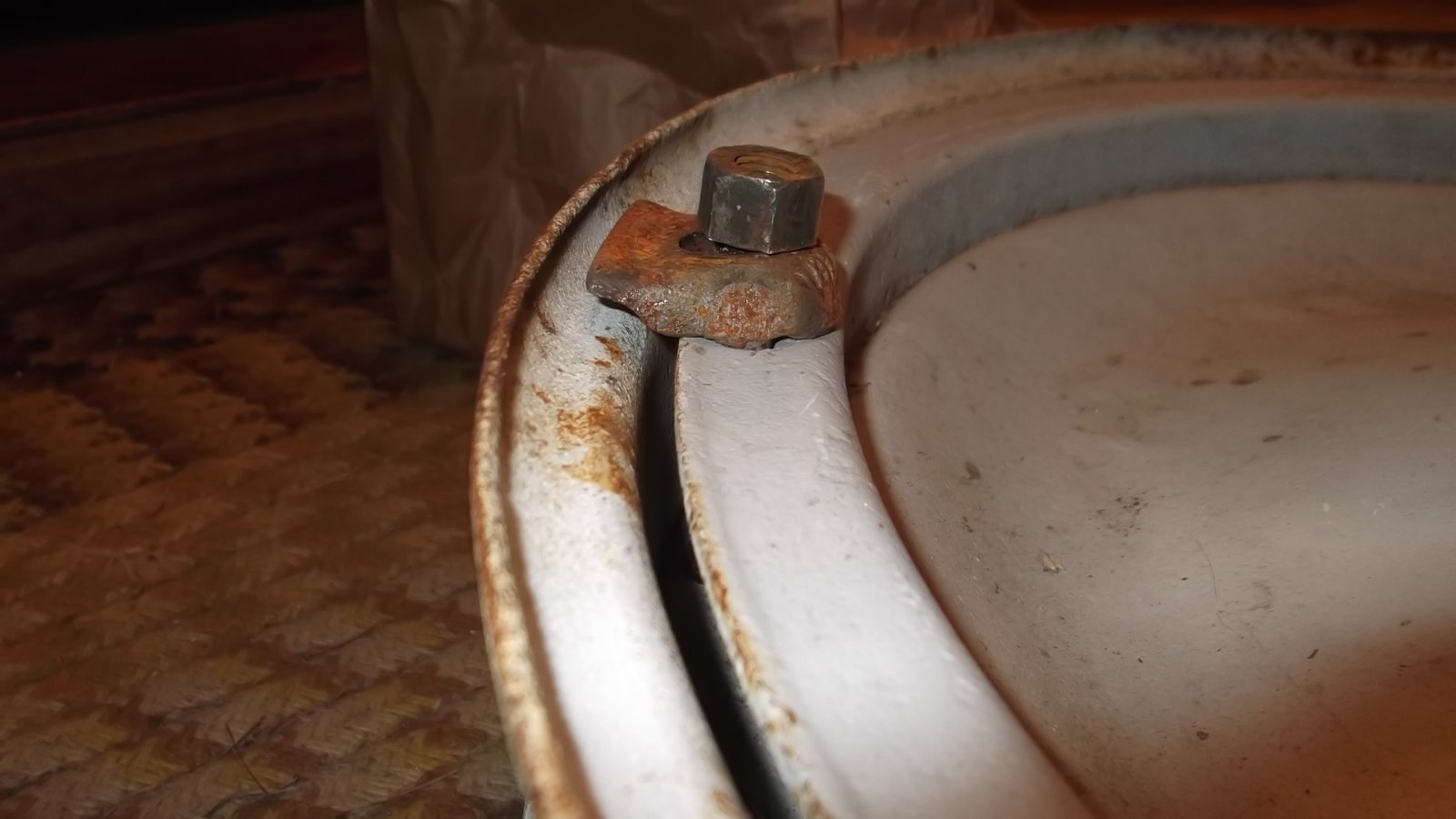

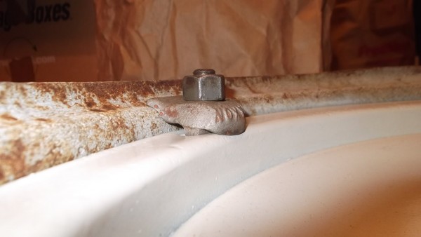

Here are a couple of other photos of the wheel. Unfortunately, I cut off one edge of the wheel, but I don't think it has a notch cut out of it like the ones in the EBay ad.

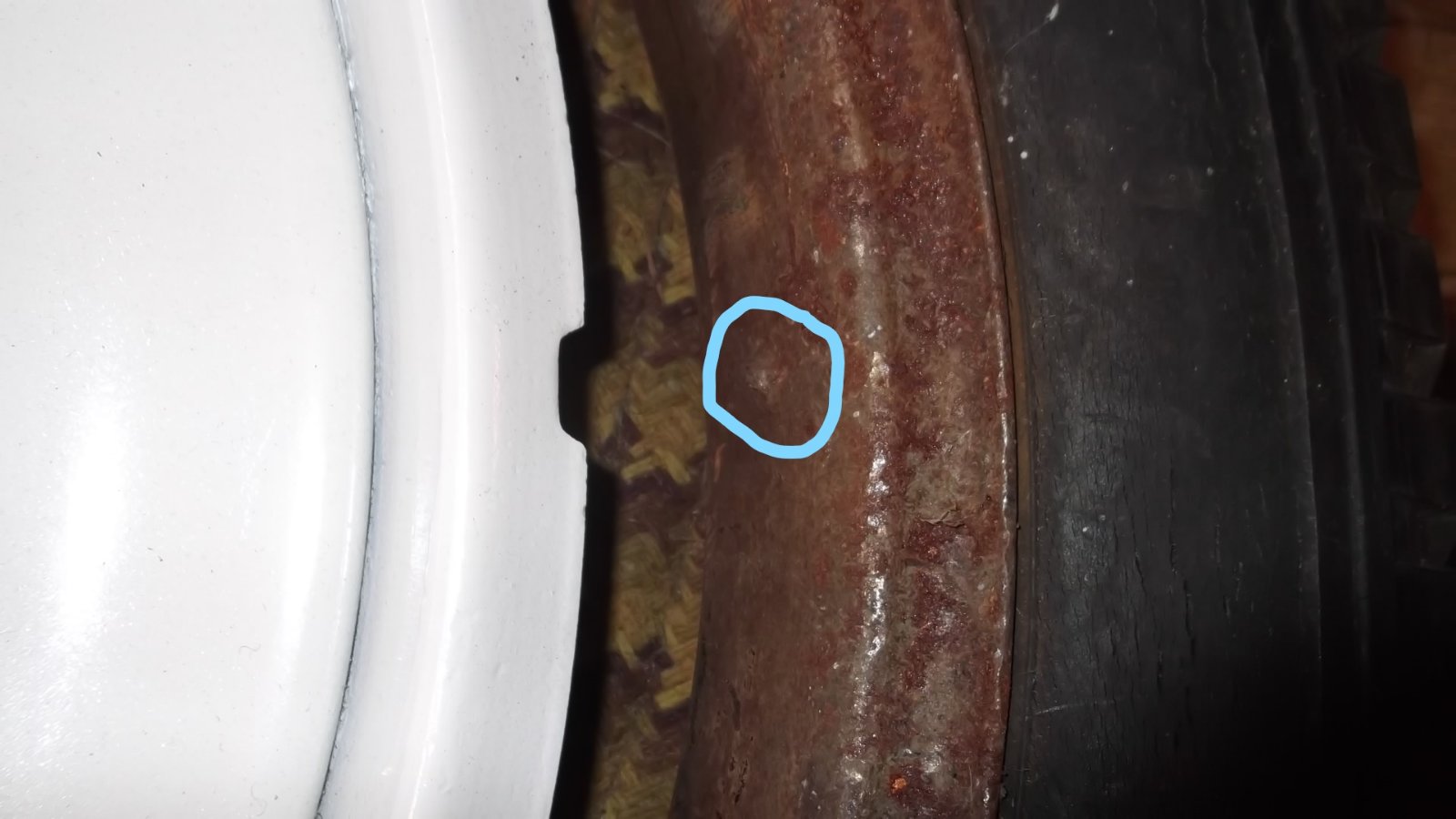

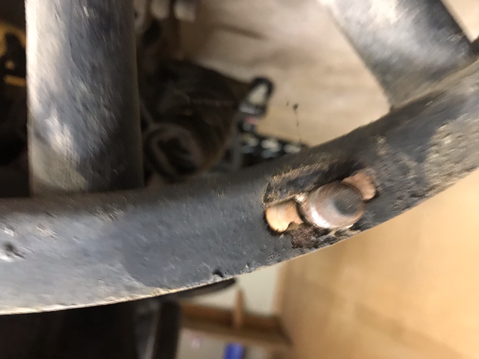

Ok looking good so far. Do the fellows have a notch about 180ish from the latch holding the ends together?

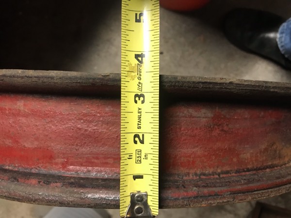

Here is a photo of the narrower 26/27 rim on a 28 wheel with the wider fellow.

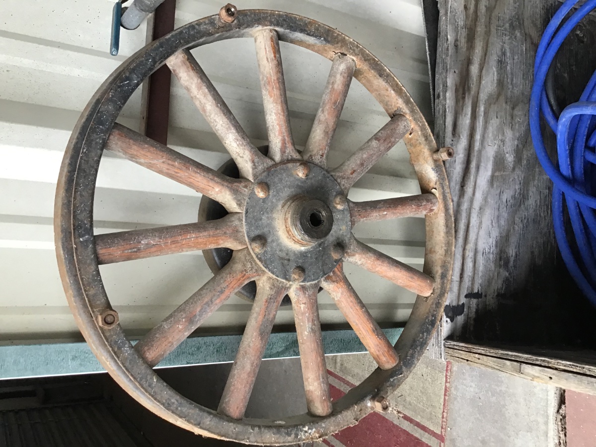

Here are some other pics of the whole wheel. No notch that I can see.

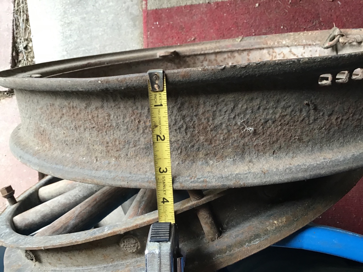

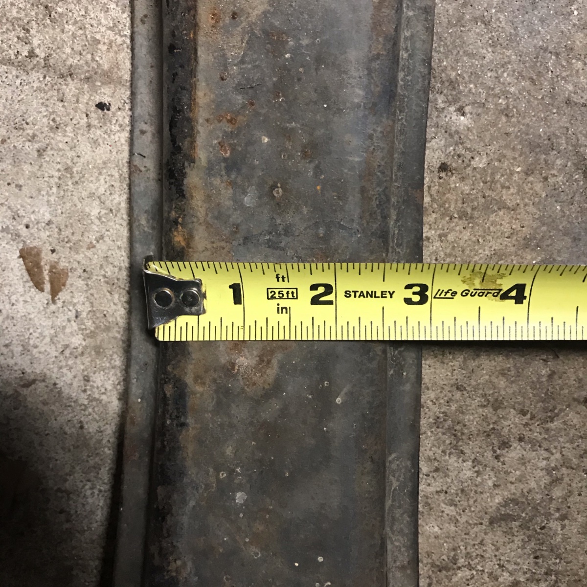

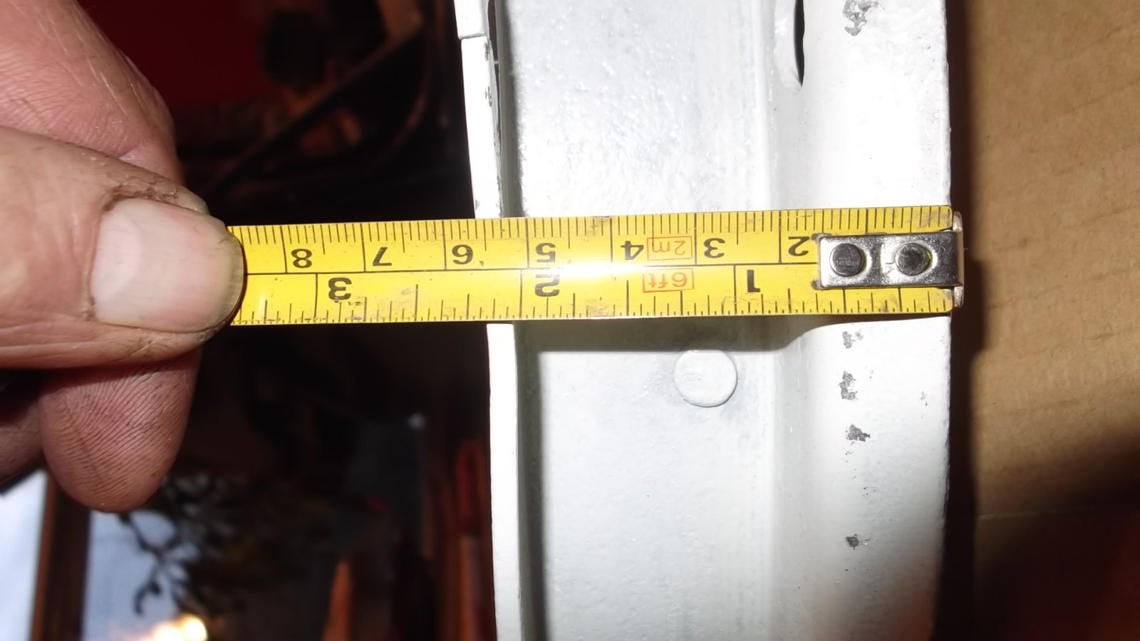

Milford, my first suggestion at this point is to find a set of proper wheels and rims for you car, the 30X3-1/2's.
Looking back over the photos I am seeing a mixed bag of parts, maybe.
In your ad for the rims, the photo shows one with the dimple which should be the 26/27 style that would need a notch in the fellow like I showed above. In your above photos, the first rim you show with the tape is 2-3/4 to 3" across the back, but from the other side is about 3-1/2" and the wheel shows no notch. Were they the same rim? The 1928 did not have the notch or dimple.
If you wish to continue with the wheels on the car:
Measure across the top of all 4 fellows and rims. Dose not matter where they are on the car just the measurements. Are all the rims/fellows about the same width?
Side by side; narrower 26/27 and wider 28 rims; While I am no expert, I am learning more as I go along. Nice thing about Ford in the era they were mostly standardized, well except for rims and wheels but that is another story at this point.

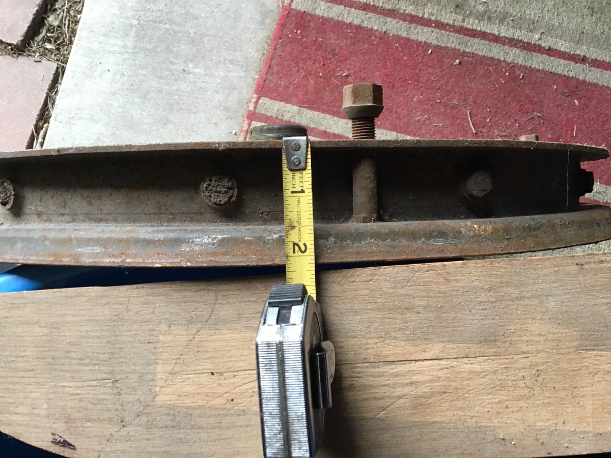

- Posts: 4642
Just for comparison purposes here of some pics of a 21” Ford wheel and split rim. Looking at the Ford and Chev differences the most noticeable is the notch in the chev felloe for the lugs. The bolt hole is probably the same size in both fellows.
Other than that the wheels look pretty close.
If the fellow on the 1926/27 Chevrolet wheels are both the same, wood or disk, the Ford 21" rim will not fit on the 1926/27 21" Chevrolet wheel for those years, been there, tried that
The ridge on the Ford or Chevrolet fixed lug rim will not let them go on and the fixed lug holes do not line up.
I have a number of 21" rims, both Ford and Chevrolet, mounted fixed lug type. They range in width of about 3-1/4 to 3-1/2 inches which would be the right size. I was going thru the process of grinding off the ridge on one of the not so good ones. You have to remove the lugs and plug weld the holes then try to keep the ridge you are grinding down at an even height. To keep the rim from moving on the wheel, a locating lock is needed on the rim. The rim I tried this with, things were just not lining up, the lock needed to be on top of the latch assembly basically and would not let the rim bolt to pass thru as is, still working on it. (working with 26/27 disk wheels with spacers on Ford hubs) The approx. 1925-26 Chevrolet wood wheel used 21" rims with fixed lugs like the 26/27 Ford, same except the valve stem hole is in different locations, but these wheels that we are trying to help with are not the 25/27. Those I have rims for!

One thing that puzzles me is the rear hubs. As you may be able to see from one of the photos, everything looks pretty good to my eye. I would think that maybe the Jaxon wheels wouldn't fit there? I have a Model T buddy coming over tomorrow and maybe he has some ideas. I will also try one of my 21" Model T rims and see how they fit.
I didn't pay much for this car, but I don't want to get too upside down on it if I can avoid that.

Milford you might try the antique Chev website and see if someone has the correct rims for your wheels. Don’t exactly know the name of the site but they do have one I think.
Another way you can go with wheels is to buy the wheel adapters for 28-29 Model A wheels to T hubs. Decent used Model A wheels aren’t real expensive like the 26-27 T wire wheels are. Since you have 21” tires they would fit the 21” Model A wheels. Lang’s sells the adapters and occasionally they show up on the classifieds.
The thing about old or classic cars is that you have to pay to play and if your like me sometimes you have to pay a little more than you want to! I have a 63 Ford Galaxie hardtop that I learned that lesson the hard way!
