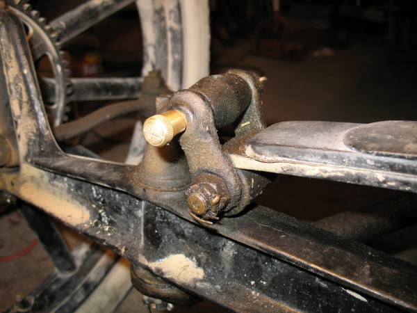

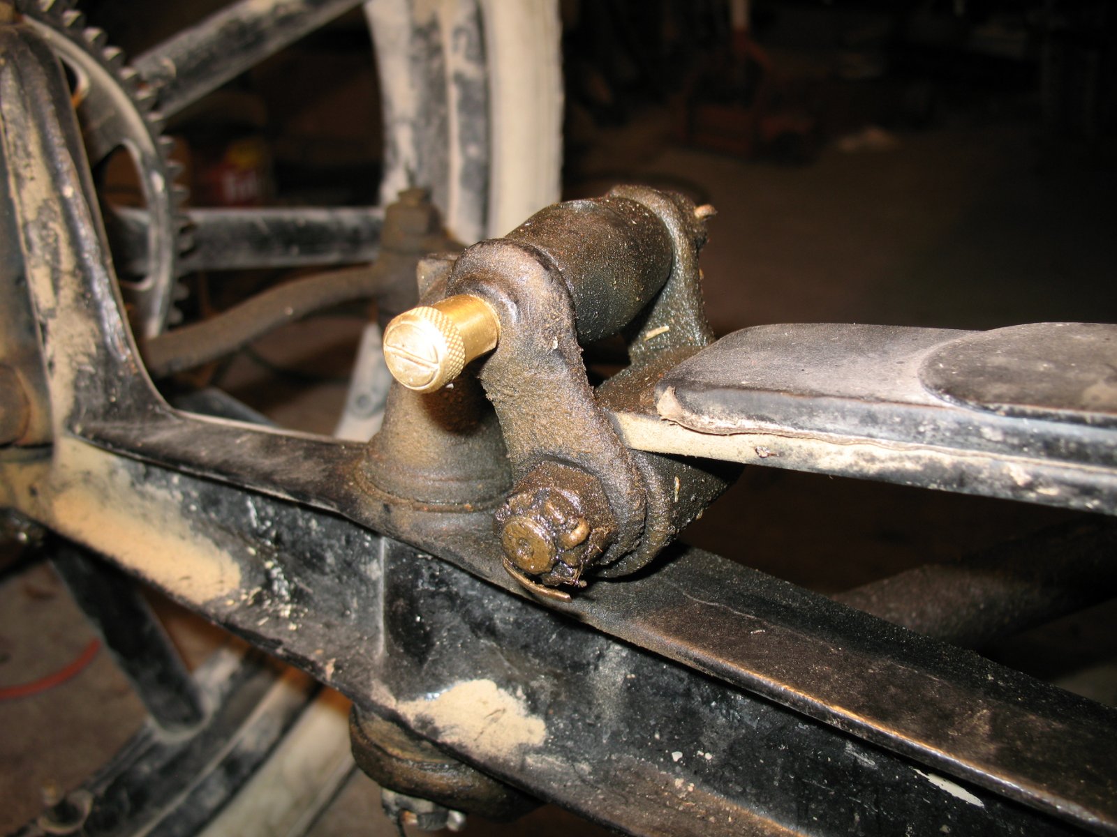

This is an oiler. It takes oil, not grease, just like the later flip-top oilers. I use chain saw oil on the theory that it will last longer than lighter oils. As you can see, it oozes out onto the surrounding territory. That's fine with me.

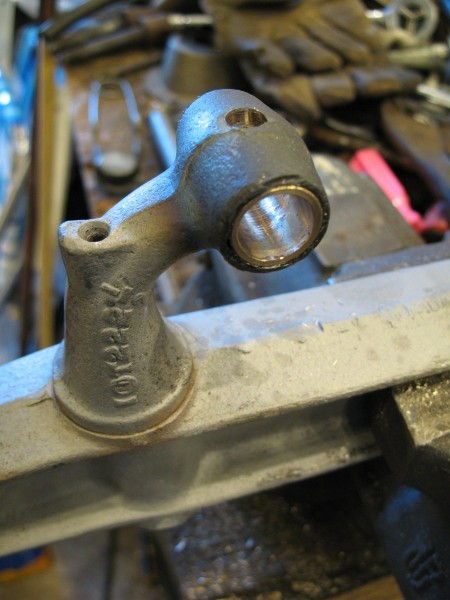

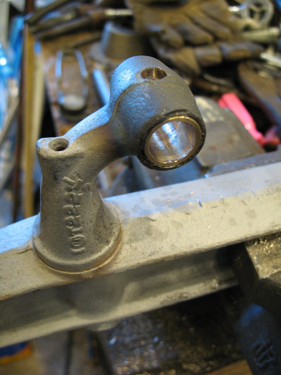

I use bronze bushings. I'd rather wear out bushings than shackles.

Yes, it seeps slowly. But it seeps. In my first picture you can see that it has seeped out onto the perch and the nut and the shackle. I like that.
