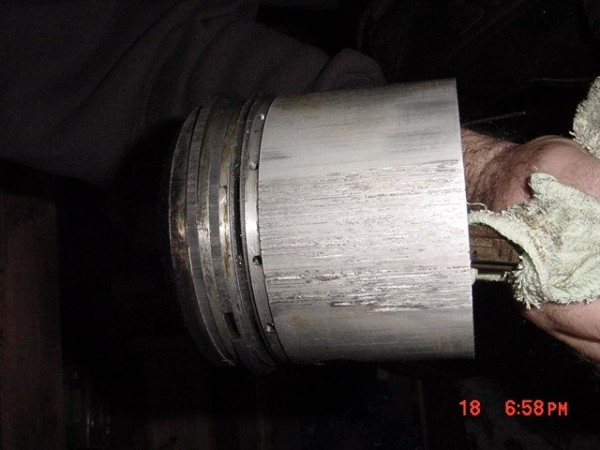

I bought a rebuilt engine,never ran,put it in my T, ran it 20 minutes total,and this was what number 3 and 4 looked like.
Scars the cylinders if ran to long. I buffed off the pistons, honed the cylinders and she is running fine now
