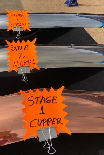

On ferrous metal the plating process is copper layer, then nickel. To chrome, the chromium is layered over the nickel as oxidation prevention. The chrome gives the whiter shine to nickel layer.
Yes those oval medallions were nickel, the steel clamps behind were painted, have seen original oval pieces with nickel remains.

Had a very good friend that had a small chrome plating business in Chicago when I still lived in that area back in the '60's. Maybe the process has changed somewhat since then, but here's what I learned from him at the time:
As a favor, he chrome plated a radiator shell for me back then, but only on the condition that I would paint the back of the radiator shell with rustoleum. He explained that while this did take a long time, metal is actually somewhat porous, and he said that given enough time, and with wet corrosive conditions like the salt brine from winter snow removal in Chicago, he said that even the best chrome plating job will eventually start to deteriorate somewhat from the back if not painted.
Also, he said that the most important polishing step in the process was the initial polishing of the metal being chrome plated. Then copper plate that was polished, then the nickel plating that was also polished, and lastly, the chrome, which is mostly to protect the nickel. All that polishing is what makes the process so dirty and also so expensive,.....for what it's worth,......harold

Well, I see I was quoted here, so guess I'll chime in. "back in the day" the nickel had to be polished to become shiny. the best plating starts with a copper plating, that gets polished to remove as many imperfections as possible, AND to provide better adhesion to the base metal. I find the Chromium Bumper add interesting as it indicates a nickel plate, then copper, then nickel and finally Chrome. Maybe on spring steel the nickel bonds better than the copper, and the copper is used to fill the imperfections?
As to corrosion resistance, the Chrome, I was told, is more resistant to corrosion and a harder surface, so it's more resistant to being polished over the years. Chrome is almost clear, with a blue tint, which is why you get the color changes when it goes over the nickel.
Now as a "proof" of the need to polish the nickel way back when, if you've ever seen an original Model A bumper bar (I think the T's may show this too), although they are Chrome plated, the only polished surface is the very face, and half-way around the rolled end. the other areas are not polished, but a bit dull. If you are dong a very high point show car, or are really picky about stuff, the way to do this nowadays is to make certain the nickel layer is extra thick, mask the face off and gently blast the edges and back to dull down the nickel, then back to the plater for the chrome layer. EXPENSIVE, yes!
Of course, if you have your own plating set-up, this is much easier to have done. I have a friend with a Caswell set up who does the nickel on our DB cars, and the stuff is gorgeous--and very thick too.

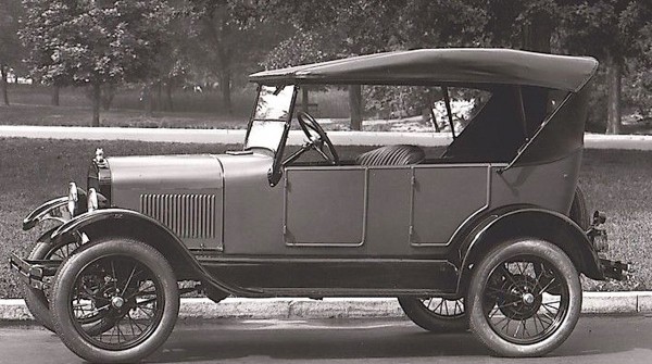

This photo is Ford, dated Aug 13, 1926 for the 1927 models, too bad the straight on view keeps from seeing the accessory bumpers, but is a good photo of them installed on this touring.
Thanks for taking the effort to check Ford prints, nice info to know about the bars and clamp finishes.
